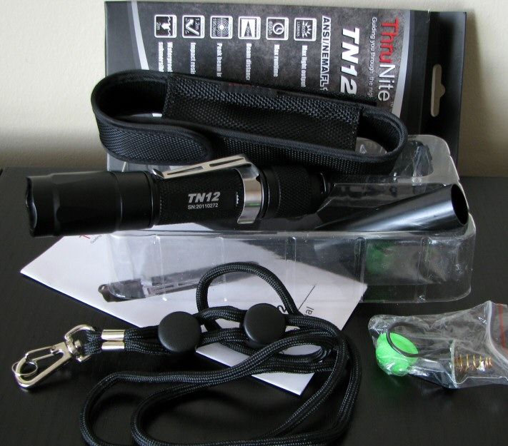

    Packaging includes a good number of extras in both cases – along with the light, you get a decent quality holster and wrist lanyard, extra o-rings and spare tailcap switch, GITD switch boot cover, stainless steel pocket clip, 2xCR123A battery plastic tube (to prevent rattle), and manual.

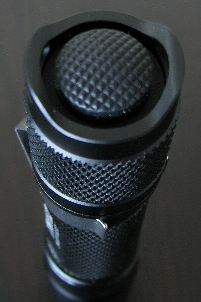

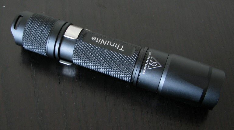

    Overall build and dimensions are fairly compact for this class light. Light uses knurling of reasonable aggressiveness on the body and tailcap, providing excellent grip. Anodizing is matte black. Labels are bright white against the black background.
    The light can tailstand, but is a bit wobbly if not clicked on. The light has a slightly beveled bezel opening.

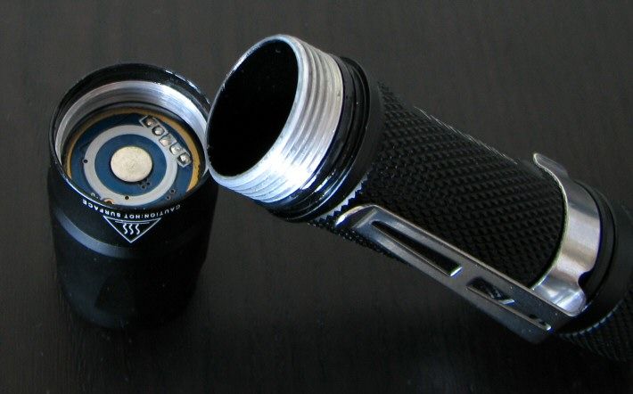

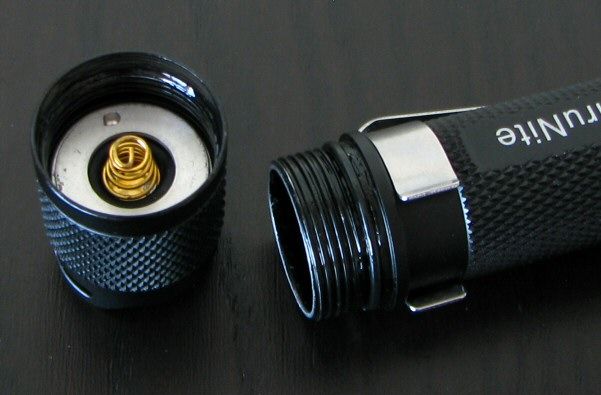

    Light uses standard-cut screw threads, anodized for lock-out.
    The lights use a forward clicky switch for on/off, and head twists for mode control. Press and hold the clicky for momentary, press and release for constant on (i.e. click on).
    Mode switching is controlled by a loosen-tighten twist of the head. With the head tight against the body, you get the memorized output mode. Do a rapid loosen-tighten switch to advance to the next output mode. Sequence is Firefly – Lo – Med – Hi –Strobe, in repeating sequence. Light has memory, and retains the last setting used after turning off and back on.
    For a more detailed examination of the build and user interface, please see my video overview:

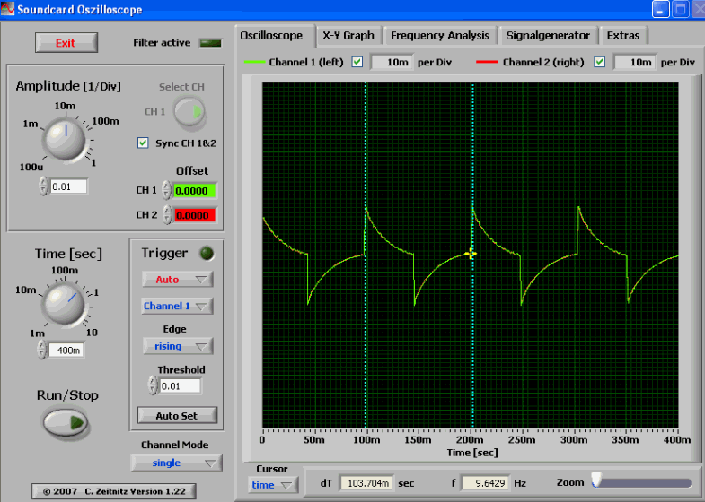

    PWM/Strobe
    Like the other members of Thrunite family, there is no sign of PWM that I can see, at any output level. I believe the light is current-controlled as claimed.
    Strobe was measured at a fairly typical fast 9.6 Hz.

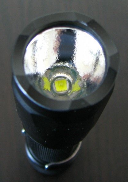

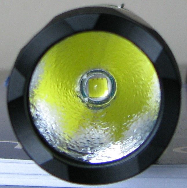

    The TN12 uses a fairly deep (but narrow) reflector for a light this size. Reflector is textured with a light OP (orange peel) finish. Cool white XM-L emitter was well centered on my sample.

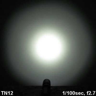

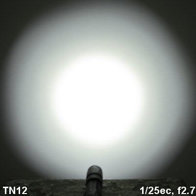

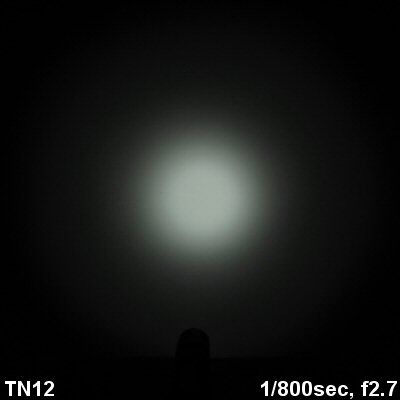

    And now, what you have all been waiting for. All lights are on 1x18650, about ~0.75 meter from a white wall (with the camera ~1.25 meters back from the wall). Automatic white balance on the camera, to minimize tint differences.
    Spillbeam is not as wide as some of the other lights (which typically have shallower reflectors). However, throw is better than typical.

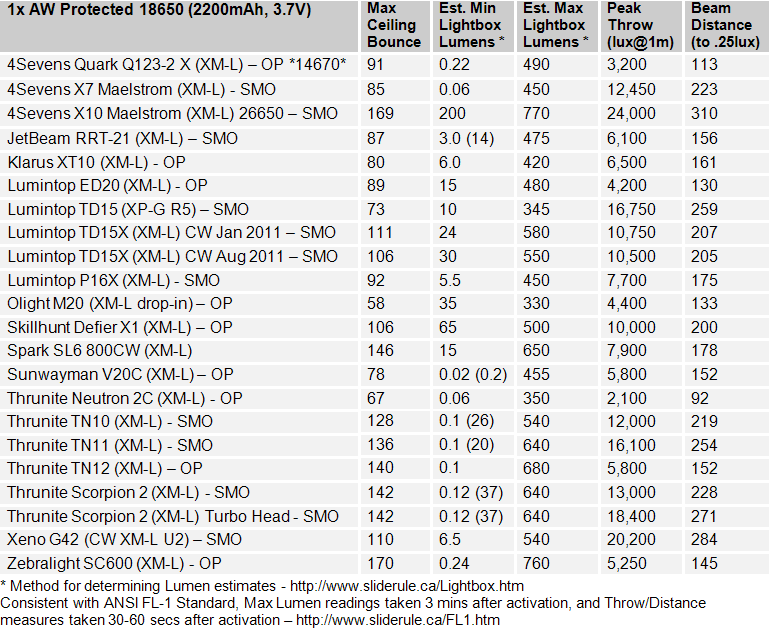

    My summary tables are reported in a manner consistent with the ANSI FL-1 standard for flashlight testing. Please see http://www.sliderule.ca/FL1.htm for a description of the terms used in these tables.
    The TN12 is remarkably bright for a light this size, on all battery sources. It is actually fairly comparable on Max to the Thrunite Scorpion V2 and TN11. Firefly mode is as low as other Thrunite Firefly modes as well.
    Throw is consistent for a light this size, driven to these levels.

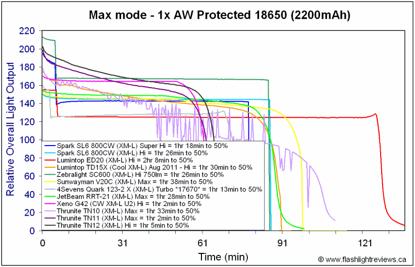

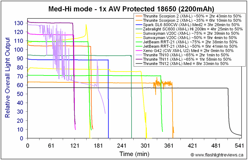

    Output/Runtime Comparison:
    First, a direct comparison of all Thrunite models on 1x18650
    On 1x18650, my TN12 actually measures slightly higher than my Scorpion V2 and TN10, but is otherwise identical.

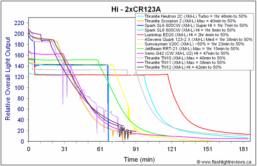

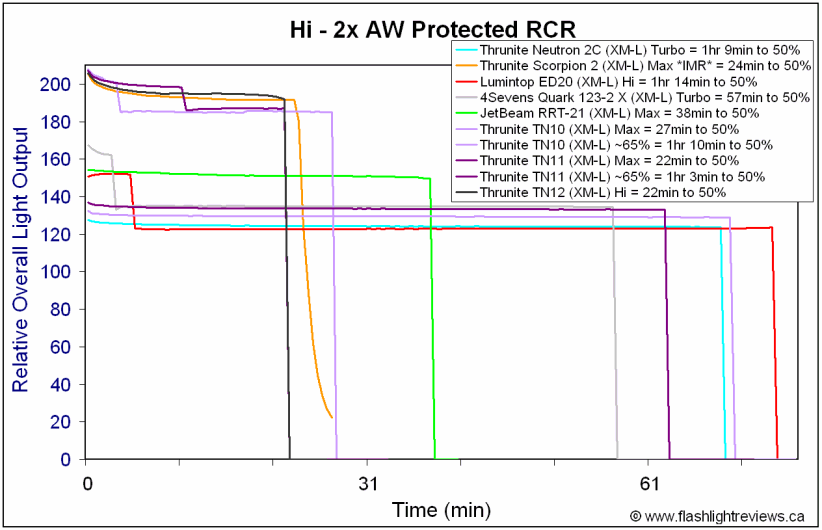

    On 2x sources, the TN12 is driven about the same on Hi/Max as the Scorpion V2, TN10 and TN11.
    This is likely to be a problem on 2xCR123A. On the Thrunite Scorpion V2, most primary CR123A cells tripped their built-in PTC resistors during sustained runs at comparable drive levels, even with external cooling applied (see a detailed discussion here). That light didn't have a circuit step-down feature, so the most likely explanation was that the CR123A battery built-in safety PTC resistors were engaging (to limit the current, and thus lower the output and heat). Note that different brands of CR123As have different chemistries/sensitivities, as discussed in that battery thread.
    Thrunite informs me that the TN12 has a thermal protection feature designed to protect the circuit from excessive temperature (i.e. greater than 80 degress Celsius at the PCB). However, given that the CR123A runtimes in HKJ's TN12 testing look a lot like what we observed for the Scorpion V2, it seems likely that something similar could be going on here. The reason you don't see this in my runtimes above is that all my tests are done under a cooling fan, and I know from previous experience that the Titanium Innovations cells I use are slower to heat up and trip their PTCs than Duracell or Panasonic cells. That said, when I opened the light after the above Hi 2xCR123A test, both my Titanium Innovations cells had their labels completely ripped apart at the seams (!).
    Given the similar pattern being observed on extended 2xCR123A Hi runs here, it seems entirely possible that you could trip your CR123A's PTC resistors before the TN12 circuit thermal throttling engages. As such, I recommend you don't run the TN12 on Hi on 2xCR123A for longer than ~5 mins or so.
    The light is driven to extremely high levels on Max, which is a concern for 2xCR123A. Although the light has a built-in temperature sensor to throttle down and protect the circuit from excessive heat, it is possible that you may still trip the PTC safety circuits of your primary CR123A cells before that happens (see commentary above). I recommend you do NOT run the TN12 on Hi on 2xCR123A for longer than ~5 mins continuously.

    Main post updated with some additional information on the Hi mode 2xCR123A issue.
    Thrunite confirms that the TN12 has a thermal protection feature designed to protect the circuit from excessive temperature (i.e. greater than 80 degress Celsius at the PCB). However, the state of my Titanium Innovations cells after the run above - and the TN12 runtimes in HKJ's excellent review - looks a lot like what we observed with the Scorpion V2 (discussed in detailed in this battery thread).
    That light didn't have a circuit step-down feature, so the most likely explanation there was that the CR123A battery built-in safety PTC resistors were engaging (to limit the current, and thus lower the output and heat). Note that different brands of CR123As have different chemistries/sensitivities, as discussed in detail in that battery thread.
    Given the same pattern being observed on extended 2xCR123A Hi runs here, it seems entirely possible that you could trip your CR123A's PTC resistors before the TN12 circuit thermal throttling engages. As such, I recommend you don't run the TN12 on Hi on 2xCR123A for longer than ~5 mins or so.

    To be clear, 2xCR123A is fully supported by Thrunite in the TN12. It is just my experience with other lights driven at this level that you may see PTC engagement on sustained operation. The TN12 circuit is rated to take the heat (with a throttling feature to protect the circuit if necessary). But you clearly would want to avoid pushing the cells to the point that their PTC's engage (i.e. the PTC should be seen as a last ditch stop-gap against catastrophic battery failure).
    This is obviously highly variable (e.g., I didn't see it on my Titanium Innovations CR123A run, but HKJ did on his Panasonic run in the TN12). I have seen PTC engagement occur on a number of lights now, and it does seem to occur earlier on the made-in-the-USA cells (but this is probably a good thing - shows a more conservative approach to battery safety).
    As a result, I am now recommending you limit sustained operation on highly driven 2xCR123A XM-L lights (like the TN12 or Scorpion V2) on max to 5-10 mins. Similarly, I recommend limiting highly-driven 4xCR123A lights to 10-20mins (for SST50-based lights) and 20-30mins for XM-L-based lights. Those recommendations are based on the earliest time points I've seen PTCs engage. As always, you should use your best judgement as to what is reasonable in your hands.

    WoW .... that TN12 hot-spot is pretty broad ..... I like it .

    Something is NOT adding up!
    The Manufacturers specs. in the beginning of this review and on all the dealers websites that are selling this light are as follows:
    Beam distance = 205m 19536 cd
    Your measurments
    Beam distance= 152m 5800 cd ??
    I think I read your measurements right! Who is right?

    Has anyone been able to get inside the head of this light ?
    is it easy ?

    Quote Originally Posted by DAN92 View Post
    You can change the clip's original steel TN12. I replaced it with a belt clip for flashlight Fenix ​​LD20.
    My Thrunite.
    from left to right, clip Thrunite TN12, Fenix ​​LD20, Fenix ​​LD21.
    can these clips be purchased from somewhere?
