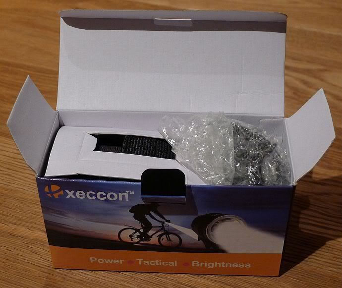

    The S12 was packaged very well in a polystyrene box.
    Inside the retail packaging was in pristine condition and nicely presented.

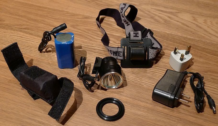

    What is in the box:
    The S12 consists of the lamp assembly with integral handlebar mount, the battery pack inside a cordura pouch for mounting onto the bike, two large o-rings used to mount the lamp and a headlamp convertor to allow you to wear the S12 as a headlamp. Also included are a mains power charger and plug adaptor for your country.

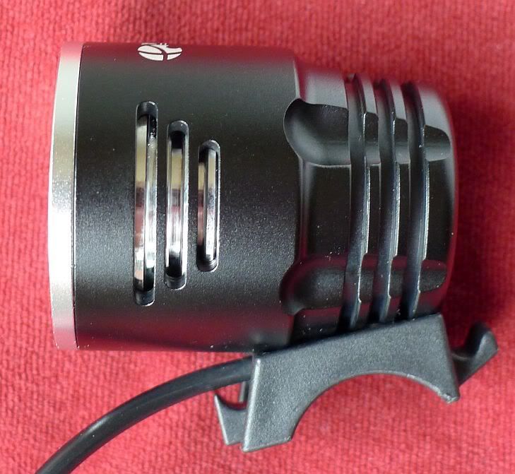

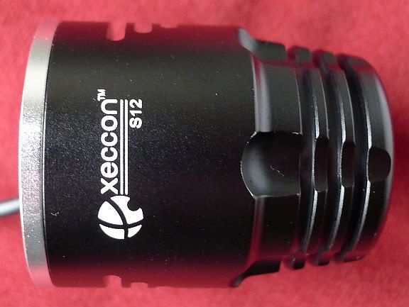

    The lamp assembly has lots of machining detail and has vents that expose some internal heatsink fins.

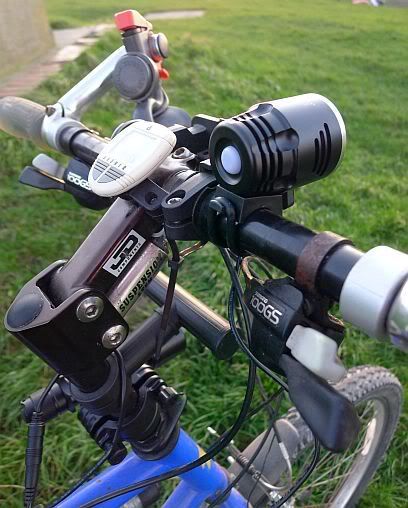

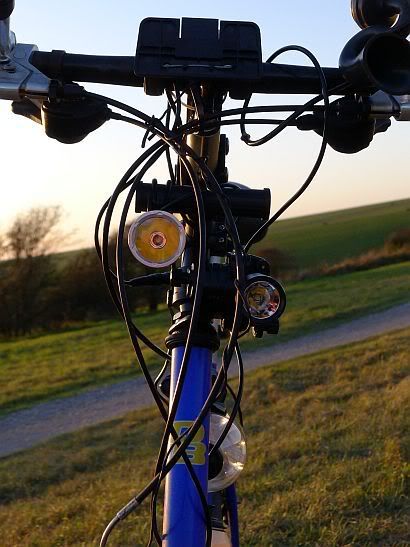

    My testing bicycle is a fully rigid old-school Diamond Back Camarillo. To save my hands on rough trails I use an unusual ‘suspension stem’ which allows the handlebars to move up and down. As the handlebars move, it is not possible to mount a light directly on the handlebars as is will be bouncing around all the time. Instead I have a T-mount fixed to the extended stem, giving a solid mounting point that turns with the handlebars.
    Detail of the mount using the large o-ring to secure the lamp. I have mounted the lamp under the bar as this suited my requirements.
    Viewed from the side
    And from the front (there is a Fenix TK21 on the right)

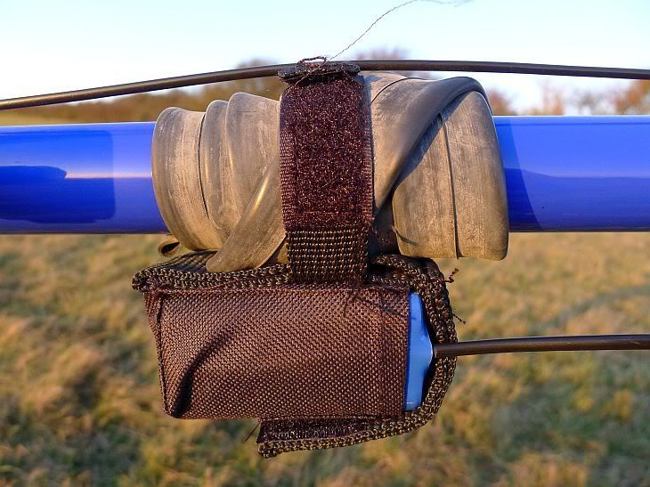

    The strap for the battery pack was unfortunately not very flexible and would not mount securely when I attempted to attach it directly to the frame tube as the strap’s minimum length was too long. As a quick fix I wrapped a length of old inner tube around the frame to make the mounting point thicker. This actually worked very well.
    Just to show the S12 in the more conventional mounted position, here I have mounted it to the handlebar directly

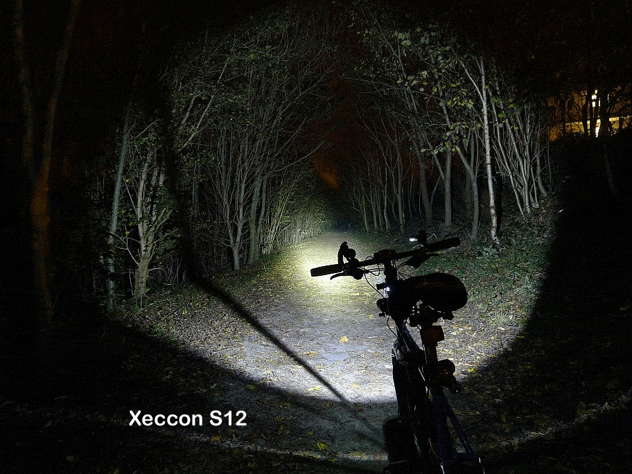

    Shown here is a direct comparison of the S12’s beam to the Fenix TK21 used as a good reference XML light.
    When riding in unlit areas you want plenty of spill to light up the area close to the rider. The S12’s beam has good throw, but also a good spill. The comparison shot below clearly shows how much more the area close to the rider is lit, but still lighting well into the distance

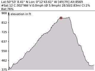

    My standard test route involves a ride up to a local scenic viewpoint, with a short section of street-lit road followed by unlit tarmac pathways and tracks, and a climb of 479ft/146m over the three miles there. The return downhill journey allows for speeds up to 30mph over rough ground providing a severe test of shock resistance as the bike is fully rigid so has no suspension to soak up the shock.
    Using some GPS logging software I recorded the route altitude profile
