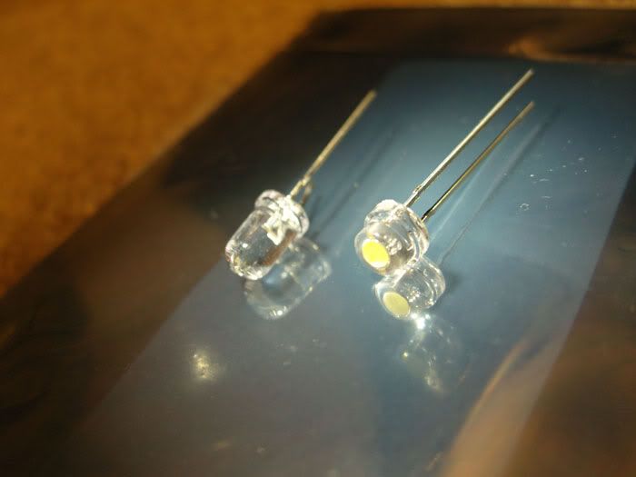

    These 5mm LEDs are spec'd at 5000K/ CRI 90.
    Normal 5mm (left), and 5000K/90 CRI 5mm(right)

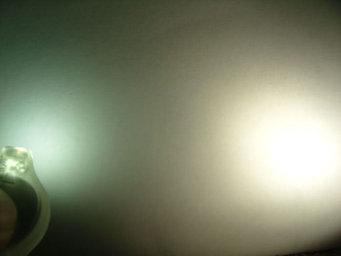

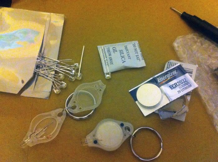

    I replaced coin cell light with the new LED to do simple comparison
    5000K CRI 90 (left) and regular 5mm (right)
    This new 5mm LED has a decent tint, very neutral yet there is a slight green cast.
    The color rendering is better than the normal 5mm LED but it does not seem to be high in the CRI department according to my eyes. Regardless it seems to be a very good replacement for the normal blue-ish 5mm.

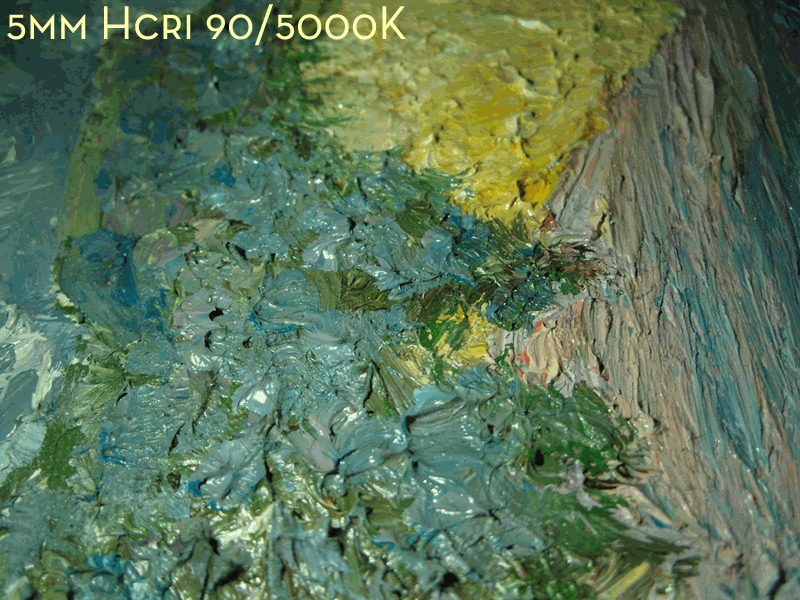

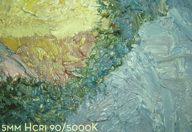

    Here we have the new 5mm 5000K/90 CRI (left) vs the Nichia 119 4500K/92 CRI (right)
    Here is two oil painting examples to show the color rendition of the new 5mm vs. the Nichia 119 HCRI.
    In closing, when comparing this new 5mm to a normal blue-ish 5mm, the new 5mm seems to give a much better quality of light.
    When comparing this new 5mm to the Nichia 119 HCRI, it becomes obvious that the new 5mm is not as high in color rendering as the Nichia 119.
    Then again IMO, the Nichia 119 HCRI is in a class by itself.
