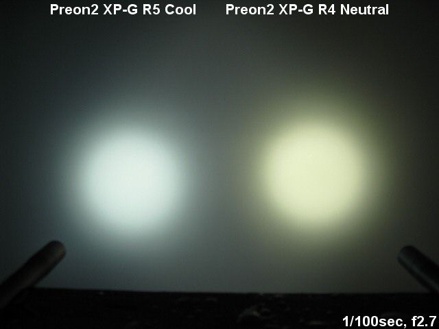

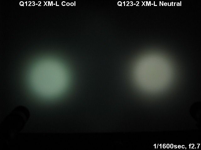

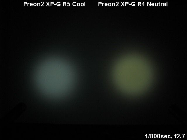

    BEAMSHOTS
    Preon 2 XP-G R4 Neutral
    Quark 123-2-X XM-L Neutral (output bin unknown)

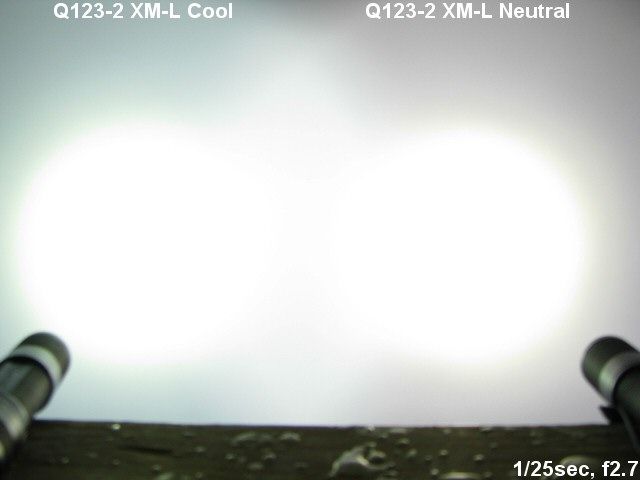

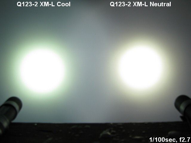

    As I discussed in an earlier 4Sevens Mini tint comparison thread, photographing tint bins is a real challenge. Commonly, most people use their camera's "sunlight" white balance for beamshots (which is ~5200K in the case of my Canon). As you can tell from the approximate temperature ranges given above, this is not bad for Cool White/Neutral White comparisons. But be aware that it does tend to disadvantage Warm White (and incandescents, for that matter) - they tend to look quite orange at ~5200K white balance.
    With that in mind, here are some white wall beamshots, about 1m from the wall. All lights on 2x battery sources, on their highest output setting.
    Preon 2 (2xNiMH)
    Quark 123-2-X (2xRCR)
    I personally find these Neutral whites to be quite pleasing, especially the Q123-2-X Neutral (of course, your preferences and tastes may vary). These Neutrals are not as "pinky" as some Neutrals I've seen, although the Preon 2 Neutral sample is a bit "yellowy". Note that I find my Preon 2 Cool white to be a fairly premium tint, but my Quark 123-2-X Cool white has a definite greenish cast.

    Below are animated GIFs that show how each Neutral light looks in comparison to its Cool cousin. To make these animated comparisons easier to compare across lights, I've left the Quark 123-2-X lights on Hi instead of Turbo (i.e. closer to the Preon 2's Max mode)
    And here are some comparisons showing each of the two Neutrals and Cools compared to each other:
    Again, all of the above are done with a "sunlight" white balance (~5200K). Keep in mind that in real life, our brains do their own "white balancing" depending on the source of light.

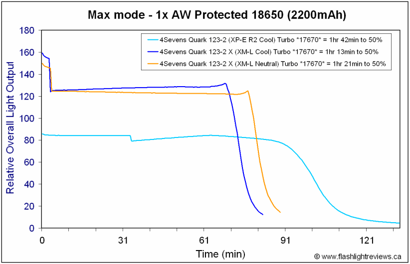

    OUTPUT/RUNTIMES:
    For more info on my testing methods, plus more information on each of these lights, please see my earlier 4Sevens Quark 123-2-X review and Preon 2 review.
    The output level of the Preon 2 Neutral seems to be pretty much identical to my cool white, despite the slightly lower output bin (R4 for the Neutral, R5 for the Cool). Runtime seems comparable on Max.
    As expected, the output level of the Quark 123-2X Neutral is slightly lower than my recent Cool white sample. But again, runtimes on Max are pretty comparable. As such, I think you can stick with all the detailed runtime data from my earlier reviews (i.e. I won't be redoing them all).
    At the end of day – given the similar output and runtimes shown above - it really comes down to what your personal tint preference is. For that, I hope you found the photo comparisons helpful.

    Quote Originally Posted by kreisler View Post
    thanks for your efforts.
    coolwhite tends to be called blueish, and ..etc..
    here i would say that all tints look greenish, especially the NeutralWhite. how come?
    ( your comparison photos are GIF's. GIF is a lossless format as long as the color depth is not greater than 8 bit. PNG is a lossless format no matter how deep the color goes. the GIF artifacts are very visible in the photos so. )
    true, but PNGs get real big real fast insofar as file size goes. GIF works well enough I'd say
    Default
    Both true. I use GIF because it supports animation, which is incredibly valuable in this context. It also keeps file size reasonable - higher bit depth lossless formats would be huge.
    The distortion effects have to do with the method of downgrading to 8-bit. The nearest color method used here makes them grainy, but doesn't produce distracting compression patterns during animation (the way other methods do).
    Long story short, this method produces fairly accurate color reproduction at a small size, supported by all browsers and vbulletin formats.

    The NW Quark "X" 123˛ is rated 360 lms on Max.
    Does using one 17670 (3.6v) instead of two 16340 (7.2v) drop it down to 130 lms on Max ?
    This Quark has a buck driver (3~9v), so I didn't think it mattered ?
    I would like to run the NW Quark "X" 123˛ on a single-cell 123-body with an AW IMR16340,
    anybody know around what the Max lms should be ?
    Thanks for all the reviews SB!

    Quote Originally Posted by GordoJones88 View Post
    You may want to read Selfbuilts review on the Quark 123x2 X, you will actually see SB measures 520lmn using CR123 and 490lms using a single cell at 4.2v (same as your 4.2v 17670). So actually 4sevens did us a favor and underrated this "X" lineup, a nice surprise more than a favor I guess.
    Take about 7% off those measurements for the Neutral version and that should give you an idea of the output you'll see, that should be somewhere around 450 lumens give or take.
    Selfbuilts Quark X review
    http://www.candlepowerforums.com/vb/...SHOTS-and-more!
    My flashlight collection HERE
    Default Re: 4Sevens Neutral White tints - Preon 2 & Quark 123-2-X - Comparison to Cool White
    No, because my relative output scale on the y-axis is NOT in lumens. I can estimate lumens based on the analysis described here.
    If I do that, I get ~450 lumens for the Q123-2-X Neutral at ANSI FL-1's 3-min time point. As jhc37013 mentions above, that is not too far off from the ~490 lumens I reported for the cool white version of this light, on this battery source.
    Note that all the new -X lights drop off in output right after 3 mins into the run, to ~350 lumens for both the neutral and cool white samples of the 123-2-x in my testing.
    Should be the same as the 17670 above, since the voltage is the same.
    * The title 1x AW Protected 18650 (2200mAh) is extraneous from the old review.
    Yes, I forgot to change the graph title from the template file I use. It should say 17670 in this specific case.
