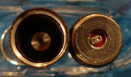

    Looking inside:
    With the head removed you can see the positive and negative contacts of the Ti. The Ti does not have a normal spring, instead having a circular foam pad on the positive terminal which pushes the battery terminal away from the contact as you unscrew the head to turn it off. I will be curious to see how well this holds up in the long term.
    Shown here with the head removed and brass threads visible

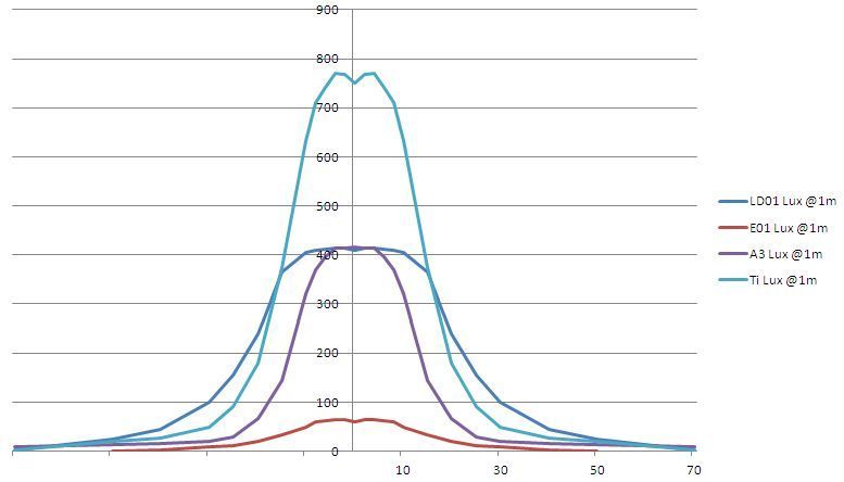

    As in a previous review, I decided to try and quantify the actual beam profile. There are probably many flaws in my method, but it is simple and easy to carry out and seems to provide a good enough comparison.
    The method used was to put the light on the edge of a table 1m from a wall, with a tape measure on the wall. The zero of the scale is placed in the centre of the hotspot and a lux meter is then positioned at points along the scale, with the measurements recorded. Beam shots are often taken with the light shining on a flat white wall, so this method is simply measuring the actual intensity across the beam on a flat surface, not the spherical light emission.
    The results are then plotted on a graph.
    For the best throw you want to see a sharp peak with less of the distracting spill. For the best flood light the trace should be pretty flat.
    Here the Ti is shown next to the Fenix LD01, E01 and iTP A3. You can clearly see how the Ti has a much brighter hotspot.
    Taking this a little further, I calculated an approximate factor to apply to the lux measurements, as each measurement gets further from the centre of the beam, it corresponds to a larger area onto which the light is falling. It seems to me that this should also be taken into consideration, so I applied these area corrections and came up with this odd looking graph.
    The key quantity here is the area under the graph line. This should correspond to the total light output. Here you can see the diffuser has put more light energy into the spill and widened the hotspot.
    The Ti, despite having a brighter hotspot and better throw, has less total output than the LD01 although more than the A3.

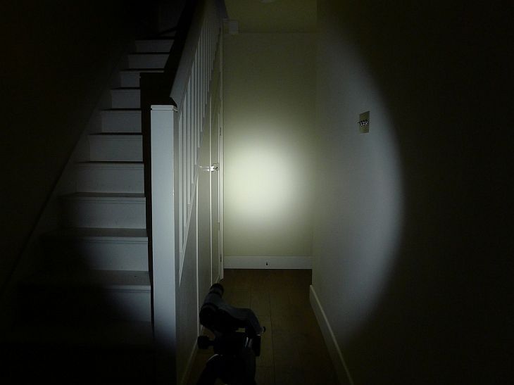

    PART 3 – The beam
    The beam is very well formed with strong hotspot but reasonable spill as well.
    Firefly is a great low low output and here is show next to (from left to right) the Zebralight SC51, Quark AA Regular, Thrunite Ti and Photon Freedom Micro all in lowest output mode.
