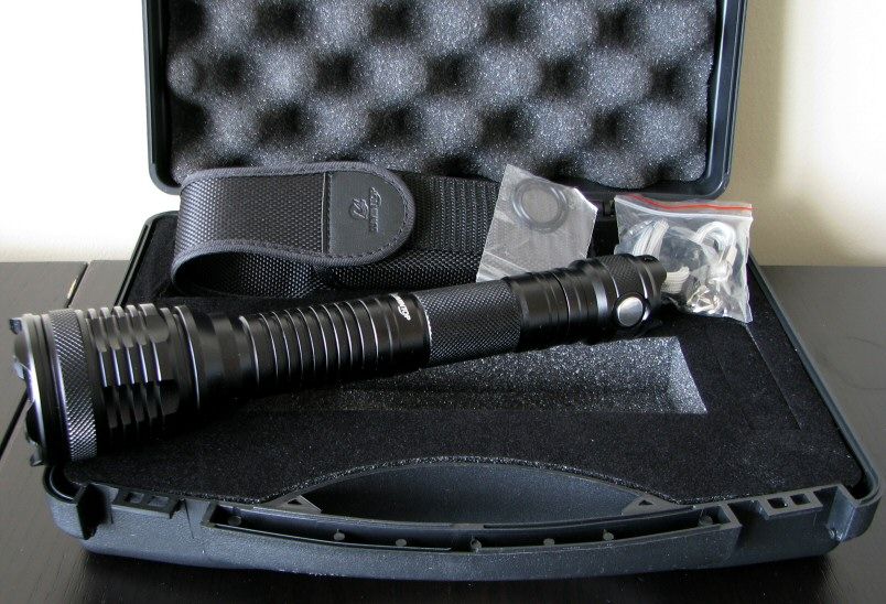

    Packaging is a presentation-style plastic display case with cut-out foam (similar to some Olight models). Inside, you will find the light, spare o-rings, good quality wrist strap lanyard and belt holster. The manual/spec chart is printed on the back of the case.

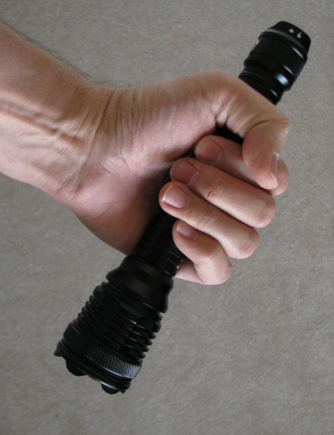

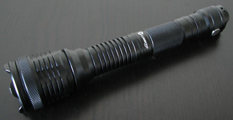

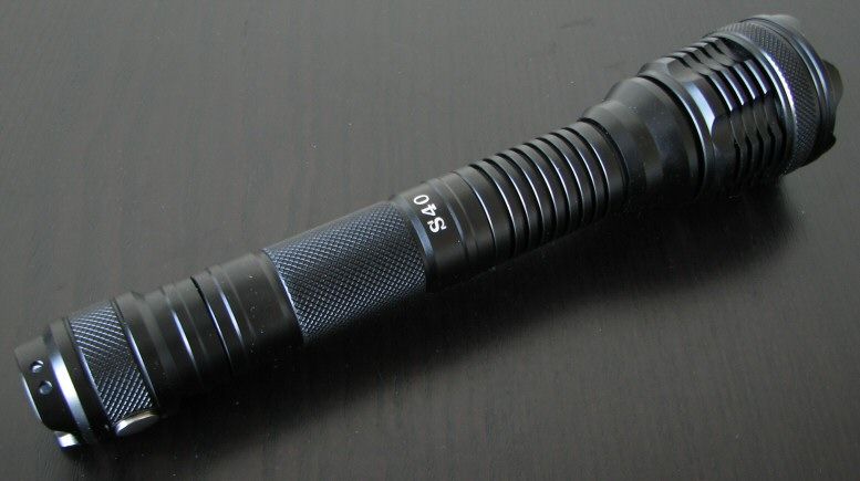

    Build feels fairly solid, with above average body and head wall thickness.
    The S40 has a glossy black anodizing, with no chips or damage on my sample. Knurling is present on the tailcap, mid-section and head of the light, but is not very aggressive. Overall grip is reasonable, thanks to the additional ridge elements. Lettering is minimal, and bright white against the black background.

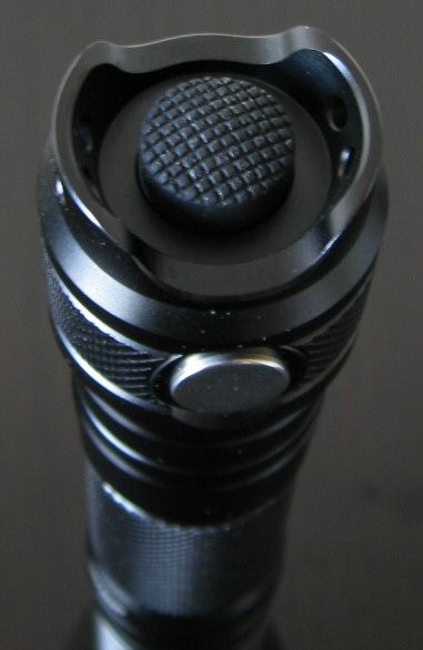

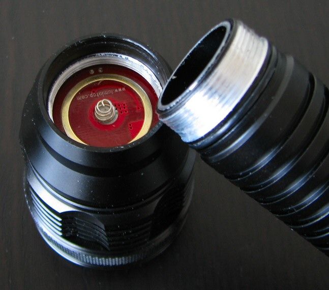

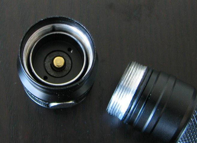

    Tailcap screw threads are traditionally cut, and are not anodized (so no lock-out is possible). Light can tailstand, although it is wobbly if the switch is clicked off.
    The secondary side-switch has a smooth silver finish, and would be hard to locate by feel with gloves on (although the color makes it visually distinctive, if there is enough ambient light to see it). The tailcap interior shows a secondary metal sleeve, that makes contact with a matching region of the battery tube.
    There is a scalloped aluminum bezel ring on the head.
    There is a small spring on the positive contact plate in the head, so flat-top batteries should work fine (my Redilast cells 2900mAh all worked fine).
    Note that the light can roll fairly easily.
    The S40 has a dual-control interface. Turn the light On/Off by the tailcap forward clicky switch - press for momentary on, click and release for constant on.
    Mode switching is controlled by the electronic tailcap side switch. Press and release to change modes. Mode sequence is Lo > Med > Hi, in repeating order. Light has mode memory, and returns to this setting after turning Off/On.
    To activate strobe, press and hold the side switch for more than 3 secs. To exit strobe, press-release or press-hold the side switch to return to the last memorized level.

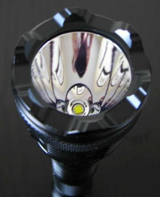

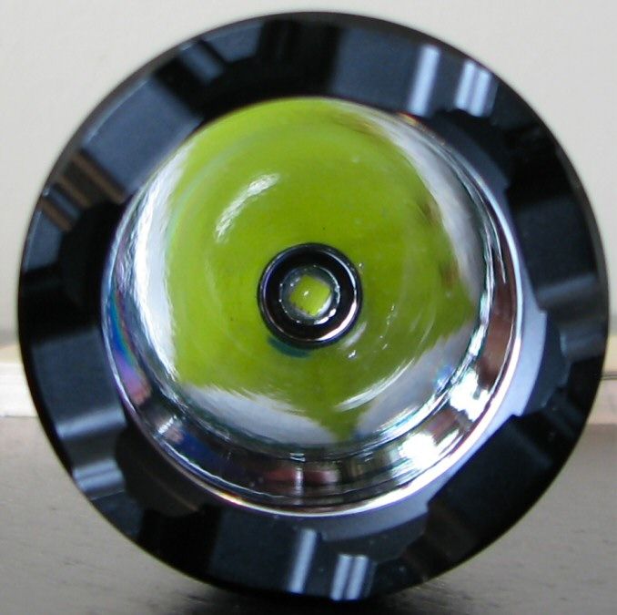

    The S40 has a smooth reflector, with a well centered Cool White XM-L emitter on my sample. The overall reflector dimensions look intermediate to my Lumintop TD15X and JetBeam BC40/RRT-15, so I would expect intermediate levels of throw here. The head seems rather thick-walled.

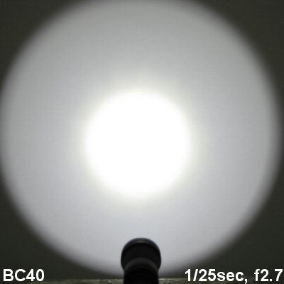

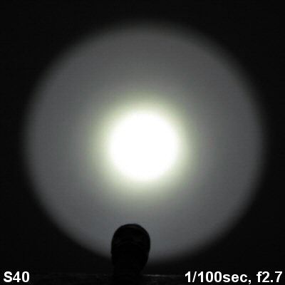

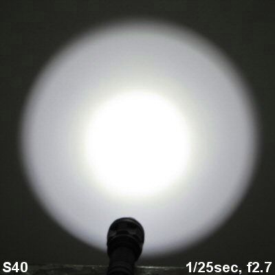

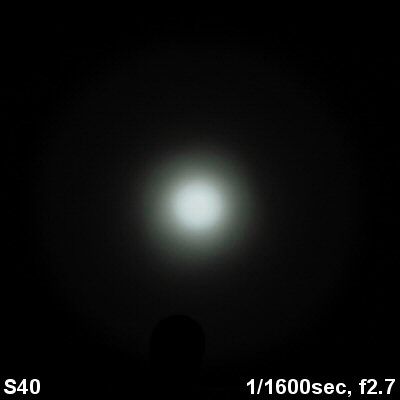

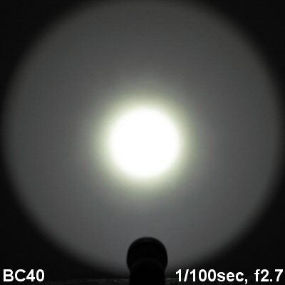

    And now the white-wall beamshots. All lights are on 2x AW protected 18650. Lights are about ~0.75 meter from a white wall (with the camera ~1.25 meters back from the wall). Automatic white balance on the camera, to minimize tint differences.
    Beam profile is as you would expect, with reasonable throw. Spillbeam width is a bit narrower than some other lights (more in keeping with typical "thrower" lights, like the Thrunite Catapult)

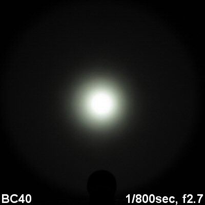

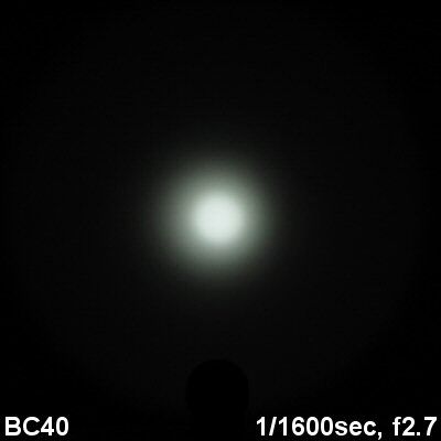

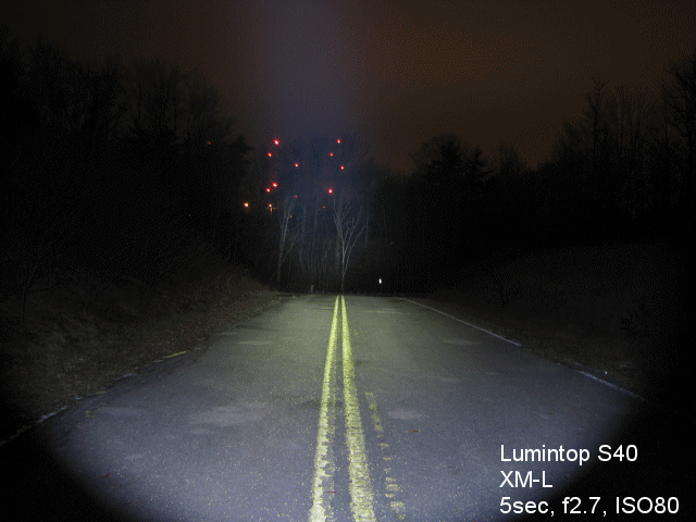

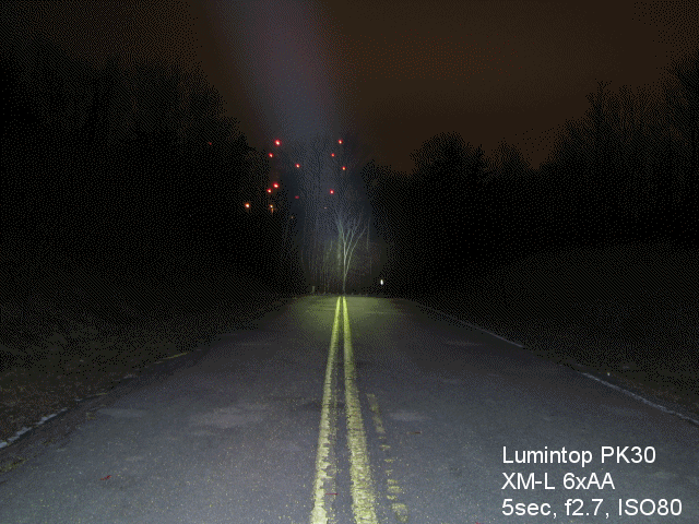

    And now for the outdoor shots. These beamshots were done in the style of my earlier 100-yard round-up review. Please see that thread for a discussion of the topography (i.e. the road dips in the distance, to better show you the corona in the mid-ground). We are also in early winter here now, so I was lucky to get these in without snow on the ground.
    As expected, the S40 doesn't throw as far as the Lumintop PK30 (which has a much larger reflector focused for throw).
    The S40 is a closer match in overall size to the JetBeam BC40, but the smaller reflector on the S40 reduces the throw somewhat. Sorry, I was little off-center for the S40 pic.

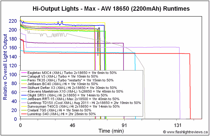

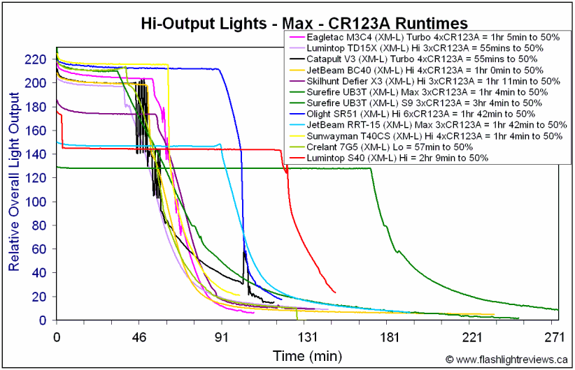

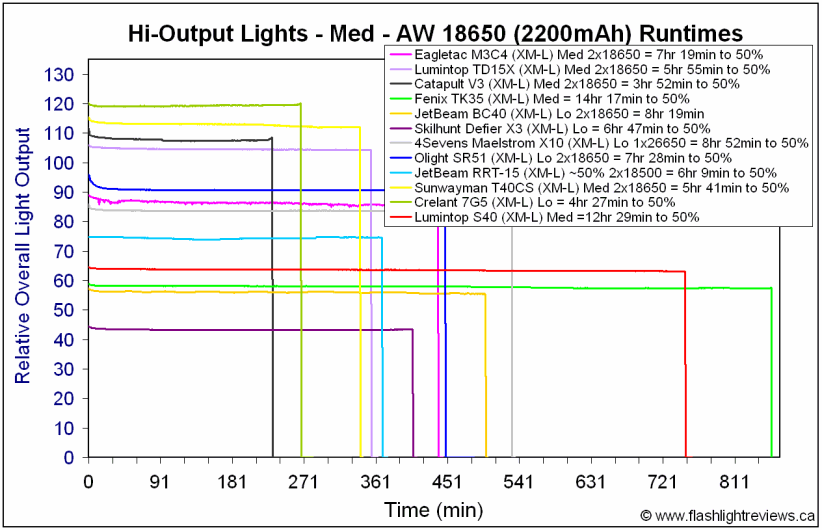

    Max output of the S40 is lower than the rated spec of 720 lumens (i.e. closer to ~600 estimated lumens in my testing). Note also that output drops after 3 mins of runtime, to a regulated ~460 estimated lumens. See my runtime graphs below for more information.
    Throw is reasonable for the size reflector – intermediate to the Lumintop TD15X and JetBeam BC40, as expected. But again, the rated ANSI FL-1 specs (30,822cd and 320m beam distance) seem overstated for my sample (actually measured at 16,500cd and 257m).
    Output/Runtime Comparison:
    Although max overall output is lower than most other lights in this class, runtime is very good at all levels tested. Performance is generally quite similar to the Lumintop TD15X.
    Although Med/Hi mode lumen output levels seem lower than published specs, runtimes are higher than reported (and consistent with a good quality current-controlled light).
    Note the drop-off in max output after the first three minutes of runtime. Recent TD15X lights have a similar circuit feature.
    Side mode-changing switch is smooth, and may be hard to locate by feel alone.
