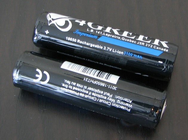

    I have recently been sent a number of 4GREER 3100mAh protected 18650 batteries for review.
    4GREER informs me that these 3100mAh batteries were specially made, based on the popular Panasonic NCR18650A internal cell. The protection circuit, protection plate, as well as high-top contact plate and packaging, are all unique for the 4GREER brand. They have also emphasized to me their optimization for performance in extreme weather conditions, both in very cold and hot climates.
    For those of you who are not familiar with 4GREER (which apparently stands for "4 Genuine, Robust, Efficient, Excellence, Reliable" products), they are a Canadian company that manufacturers batteries and flashlights. They have been around for about 3 years now, and specialize in products aimed at law enforcement, military, medical, etc. I had previously examined their earlier 2400mAh cells.

    4GREER reports the following characteristics for these cells:
    • Nominal Voltage: 3.7V
    • Fully charged, without load, voltage should read 4.18V DC
    • Nominal Capacity (min.): 3050mAh
    • Nominal Capacity (typ.): 3100mAh
    • Diameter (Max): 18.6mm
    • Length (Max): 69.2mm
    • Approx.Weight: 48g
    • MSRP: $24

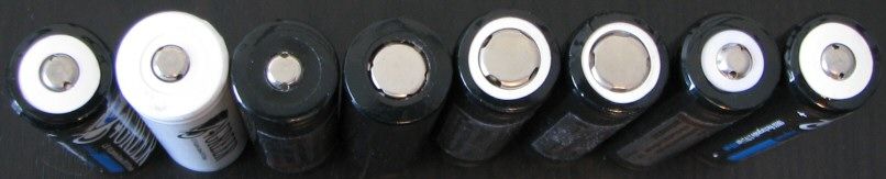

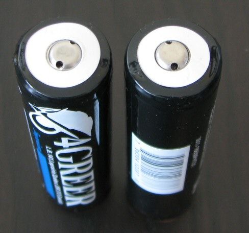

    As you can see, these 4GREER 3100mAh cells have a small button top, and should therefore work fine in lights that have a physical reverse-polarity protection feature (or that otherwise need raised rops). How do they compare to other cells?
    From left to right, 4GREER 3100mAh, 4GREER 2400mAh, AW 2200mAh, AW 2600mAh, Redilast 2600mAh, Redilast 2900mAh, Xtar 3100mAh, 4GREER 3100mAh.
    The purpose of the above is to show you the height and button-top differences of the 4GREER cells compared to others I own. The older AW 2200mAh cells and the Eagletac 2400mAh cells have the classic small button-top, and are of course shorter than these newer high-capacity cells. The older 4GREER 2400mAh have a traditional small button top, and are quite tall for their class. The AW 2600mAh cells have flat-tops that don’t project beyond the wrapping. The Redilast 2600mAh and 2900mAh cells have a wide raised top (i.e. wide button-top). The Xtar 3100mAh (also built around the Panasonic NCR18650A) has a small button-top.
    Here is how they all compare in weight and height (average of multiple samples given):
    • AW 18650 2200mAh small button-top – 45.9g, 67.4mm
    • AW 18650 2600mAh flat-top – 46.4g, 67.8mm
    • EagleTac 2400mAh small button-top – 46.7g, 68.8mm
    • 4GREER 2400mAh small button-top - 48.6g, 69.2mm
    • Redilast 2600mAh wide button-top – 47.2g, 68.5mm
    • Redilast 2900mAh wide button-top – 45.7g, 68.9mm
    • Xtar 3100mAh small button-top – 46.3g, 68.6mm
    • 4GREER 3100mAh small button-top – 45.7g, 69.0mm
    The 4GREER cells are a reasonable length for 3100mAh cells with a button top – I am glad to see they are shorter than the earlier 2400mAh cells.

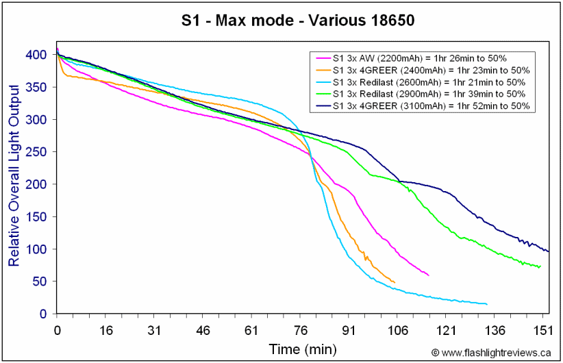

    To see how they compare in a light that cannot maintain flat stabilization at high drive currents, below are runtimes for 3x 18650 cells in the Xtar S1:
    The 4GREER 3100mAh runtimes look remarkably similar to the Redilast 2900mAh, just with proportionately greater runtime, as you would expect.

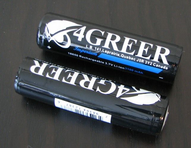

    Again, I don’t know what the internal construction of the cells are like, but my 4GREER samples seem of consistent and good quality in their external presentation (i.e. no bulging contact surfaces, centered raised-tops, etc.).
