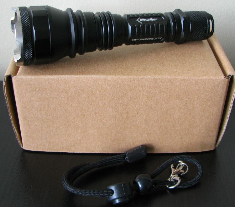

    The sample came in a traditional cardboard box with cut-out cardboard packing inserts, and a good quality wrist lanyard. Only a single-stage tailcap came with my sample, but I understand they plan to offer a multi-mode tailcap comparable to the one in my NWK750 review.

    The overall styling is similar to the NWK750, but on a much smaller scale. Build feels high quality and solid – slightly larger and heavier than typical for this class. The head is definitely larger than most lights, with a deep smooth reflector for maximum throw.

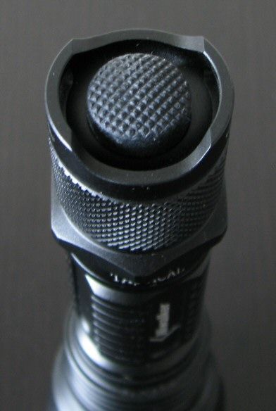

    Anodizing is a matte black finish, with no nicks or scratches on my sample. There is some knurling on the light, in bands on the tailcap and below the bezel, but it is not very aggressive. Main grip features come from a series of concentric ridges along the body. Lettering is bright white against the background (although there is a font change on the tailcap).

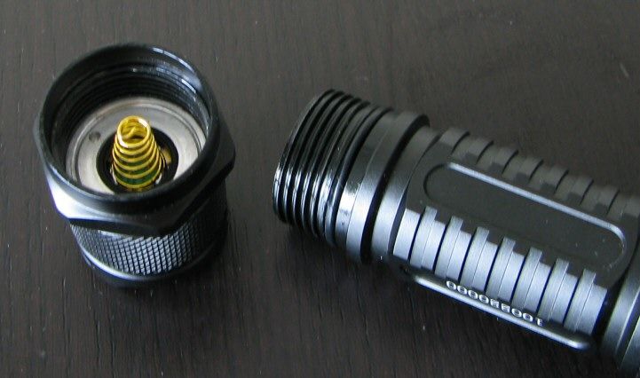

    There are clip/lanyard attachment points on the tailcap, and the light can tailstand. Screw threads are anodized for tailcap lockout. Although the threads are standard triangular cut, they seem fairly thick and of good quality.

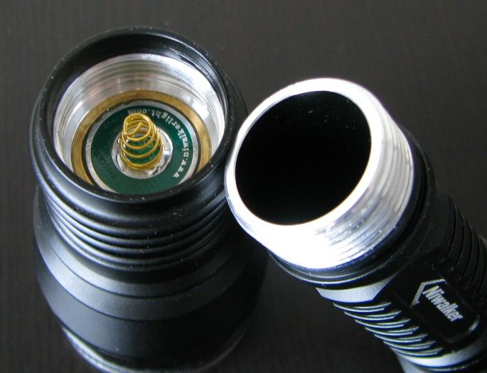

    Light has a beveled stainless steel bezel ring. There is a spring in the head, allowing you to use the newer high-capacity flat-top 18650 cells. All my flat-top 18650 cells worked fine in the light.
    Like the NWK750, the 220 is expected to come with two tailcap options – a standard single-stage forward clicky "tactical" switch (shown above), and an optional reverse-clicky multi-mode "general" purpose switch. An engineering sample of the current multi-mode tailcap design was presented in my NWK750 review – they plan to standardize a common final shipping version between the two models. Last I heard, this multi-mode switch should consist of the choice of two sets of output modes (see below for a description).
    The standard switch is simplicity itself – it is a forward tailcap clicky, so press for momentary on, click and release for locked on.

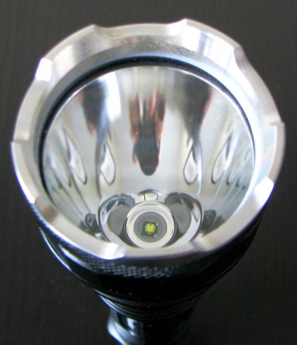

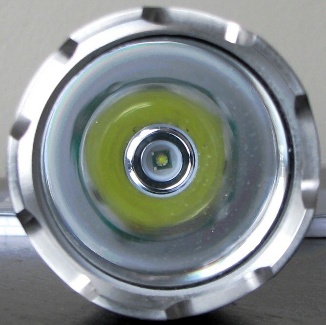

    The NWK220 uses a Cool White XP-E emitter, well centered on my sample (with a white centering disc around it). Reflector is smooth finish and extremely deep – one of the deepest I've seen in a light this size (likely accounting for the overall length of the NWK220). Throw is likely to be very good, with a small well-defined hotspot.

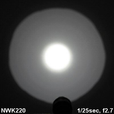

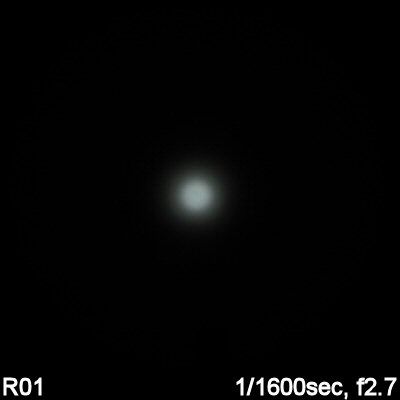

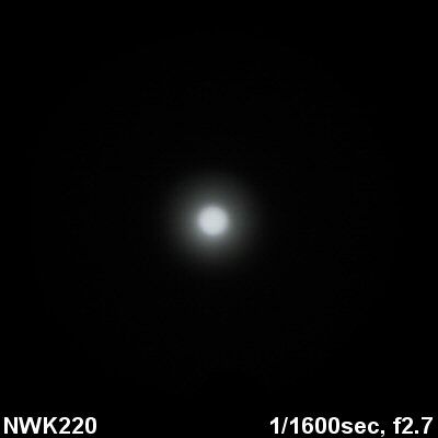

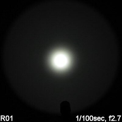

    And now, what you have all been waiting for. All lights are on 1xAW protected 18650, about ~0.75 meter from a white wall (with the camera ~1.25 meters back from the wall). Automatic white balance on the camera, to minimize tint differences.
    As expected, the light has a very small and tight hotspot. Throw is excellent for the class, but overall output is lower than some of the more recent XP-G or XM-L lights.

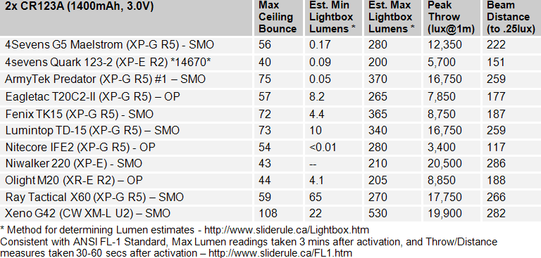

    My summary tables are reported in a manner consistent with the ANSI FL-1 standard for flashlight testing. Please see http://www.sliderule.ca/FL1.htm for a description of the terms used in these tables.
    Niwalker's ANSI FL-1 output specs seem to be very accurate for this light. Throw is excellent for the class.

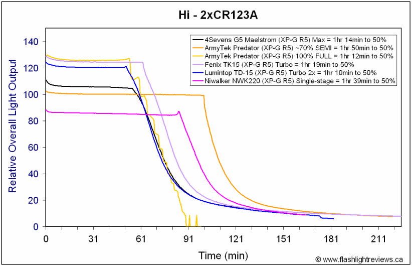

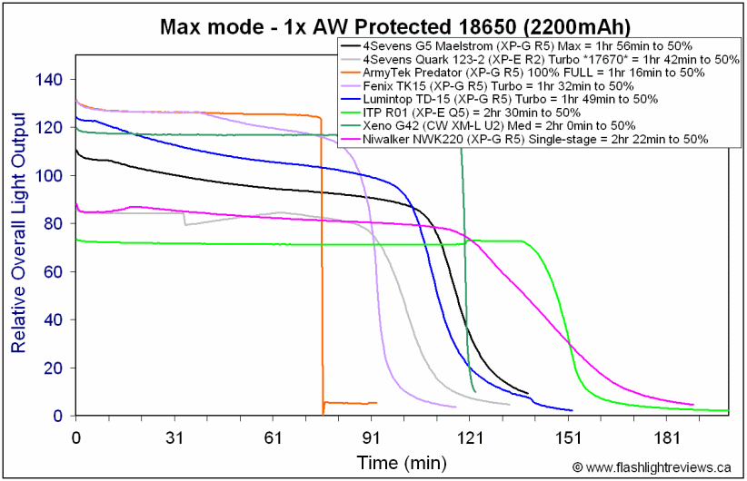

    Output/Runtime Comparison:
    I have only have the single-stage switch to examine, but output and runtime seem exactly what you would expect for a typical XP-E-based light on 1x18650.
    On 2x battery sources, runtimes seem a little on the low side for the output level.

    In keeping with the XP-E emitter and large deep reflector, the hotspot is smaller and brighter than most lights in this class. But max output is lower than all the XP-G lights I've tested in this size light.
