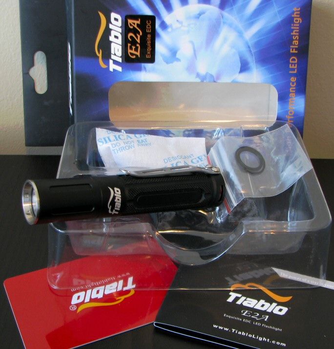

    Packaging is similar across the Tiablo line. Inside the traditional cardboard case you will find a plastic insert holding the light, stainless steel clip (attached by two screws), manual, warranty card, and extra o-rings.

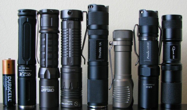

    From left to right: Duracell alkaline; Tiablo E2A; Crelant 7G1; Sunwayman V10A; Thrunite Neutron 1A; Zebralight SC51; Fenix LD10-R4; 4Sevens QAA.
    All dimensions are given with no battery installed:
    Tiablo E2A: Weight: 45.7g, Length: 101.2mm, Width (bezel): 19.9mm
    Lumintop Silver Fox: Weight: 98.1g, Length: 94.2mm, Width (bezel): 21.7mm, Width (grip-ring): 25.8mm
    Sunwayman V10A: Weight: 58.1g, Length 100.6mm, Width (bezel): 23.1mm
    Thrunite Neutron 1A: Weight: 60.4g, Length: 105.6mm, Width (bezel): 22.0mm
    Xeno E03:: Weight: 48.1g, Length 96.7mm, Width (bezel): 21.5mm
    Overall dimensions are in keeping with the 1xAA class, although the E2A is narrower than most lights by a good two millimeters or more.

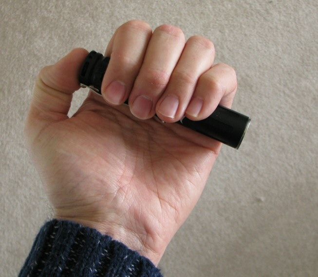

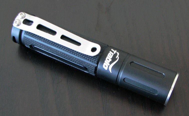

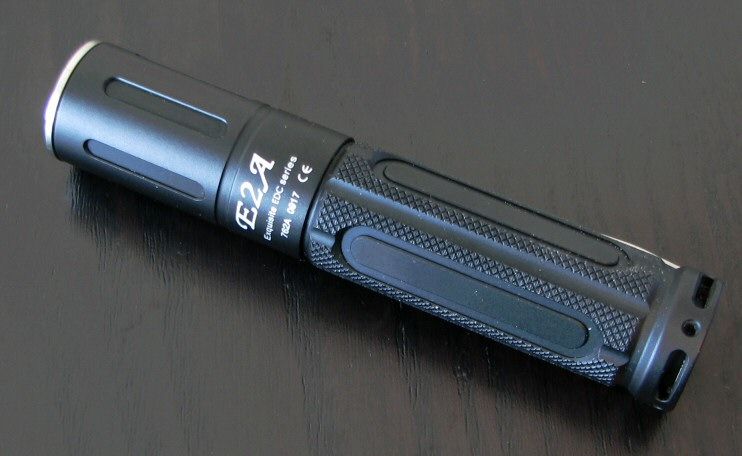

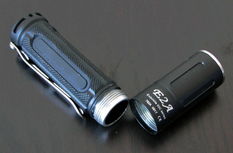

    Overall build is decent, with a fluted/ridged body tube that has knurling of good aggressiveness. There are also some flutes on the head, to help with grip (i.e. can loosen/tighten the head one-handed, if you keep the threads clean). Grip is definitely better than average, especially with the clip attached (but would be fine even without it). Anodizing is a matte black finish, with no nicks or damage on my sample. Labels are bright white against the black background.
    The clip – while securely fashioned - seems pretty soft for stainless steel, and may bend easily.
    Light has a flat stainless steel bezel ring.

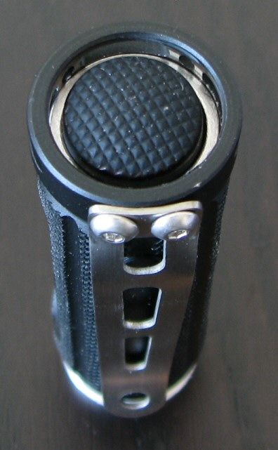

    The light can tailstand (although there was a bit of wobble on my sample). Light seems to have a stainless steel base around the boot cover. There are lanyard attached points along the tail ring. Switch is a traditional reverse clicky, and easy to access with any finger or thumb.

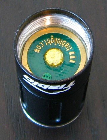

    The is a slightly raised positive contact disc in the head, so flat-top cells should work fine.
    Screw threads are not anodized, so no lock out is possible. Light uses a two-stage mode structure, with the head tightened or loosened giving access to different modes (see below).
    I found the thread action a little rough on my sample, but this can be improved with proper lubing.

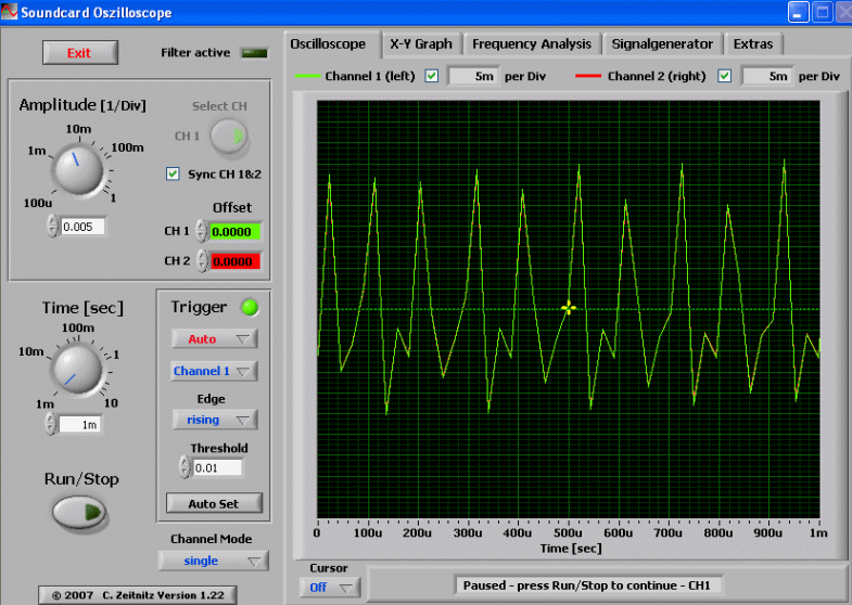

    PWM/Strobe
    Consistent with the manufacturer's specs, I was not able to detect any sign of PWM on the E2A. There was some high frequency noise detectable on the Lo mode, as shown below:
    The third oscilloscope trace shows a high ~10 kHz frequency between spikes. Whatever this circuit noise is, it is not detectable in actual use.
    There was some low frequency noise noticeable on the Hi mode (shown above), but this again was not detectable in actual use.

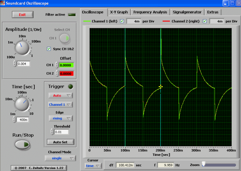

    Strobe was a fairly typical "tactical" 10 Hz.

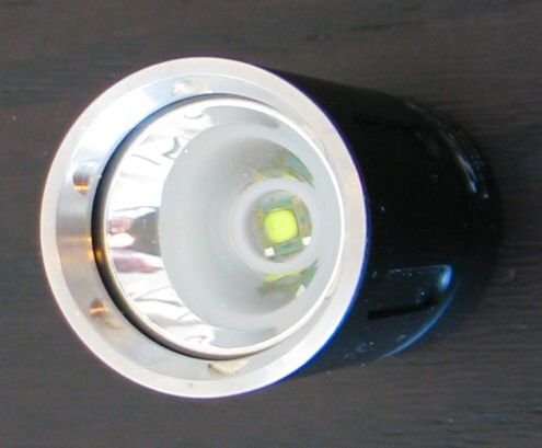

    The E2A uses a Cool White XP-G emitter (R5 output bin reported). Emitter was well centered on my sample, which a white centering disc visible beneath the reflector. Reflector is fairly deep and smooth finish, which is likely to produce reasonable throw for the XP-G class.

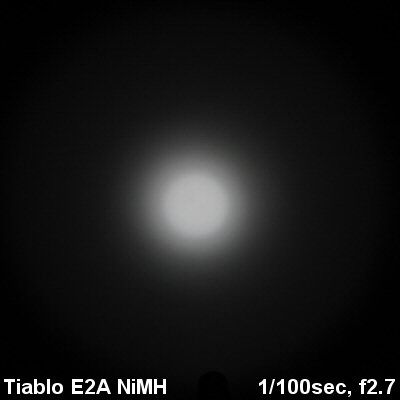

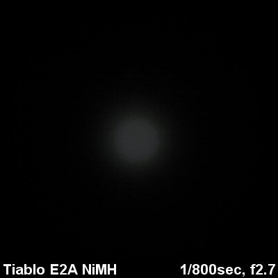

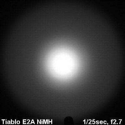

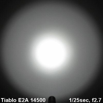

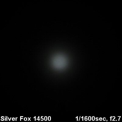

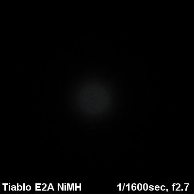

    Which brings me to the white-wall beamshots. All lights are on Hi on 1xAA Sanyo Eneloop or 1x14500 AW protected Li-ion, about ~0.75 meter from a white wall (with the camera ~1.25 meters back from the wall). Automatic white balance on the camera, to minimize tint differences.
    Comparison of 1xEneloop-based lights:
    Comparison of 1x14500-based lights:
    I found the beam pattern of the E2A to be quite good for a 1xAA EDC – very similar to my Sunwayman V10A (although the E2A isn't as bright on standard batteries).

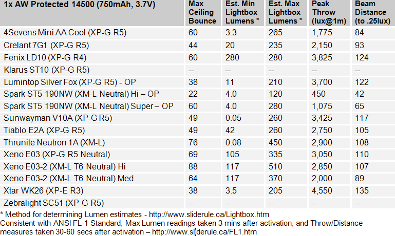

    My summary tables are reported in a manner consistent with the ANSI FL-1 standard for flashlight testing. Please see http://www.sliderule.ca/FL1.htm for a description of the terms used in these tables.
    Overall output on standard batteries is definitely toward the low end of the XP-G R5 class (i.e. about the level of the 4Sevens Mini AA). On 1x14500, the E2A performs at a typical level for this class.
    Note that reported ANSI FL-1 output measures seem quite reasonable, although might be a little overstated for Max output on standard batteries.

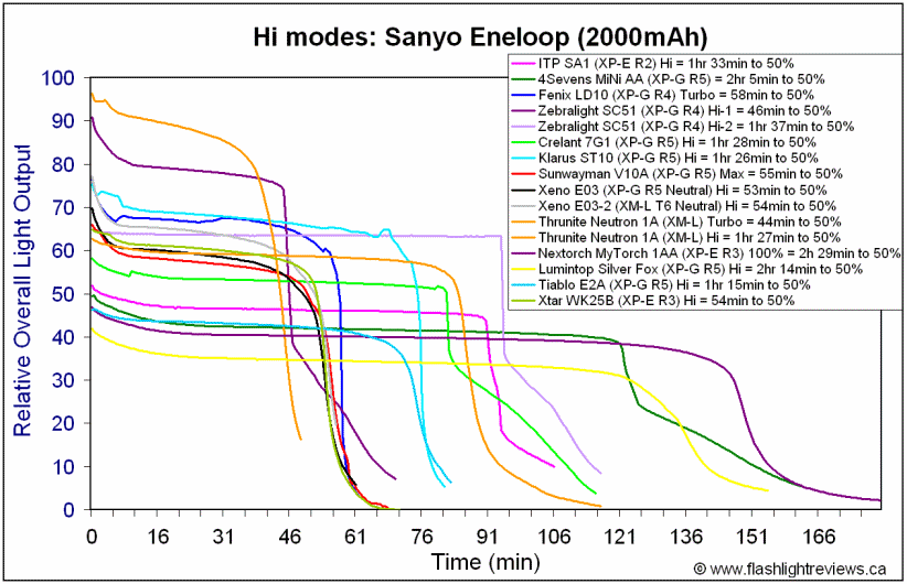

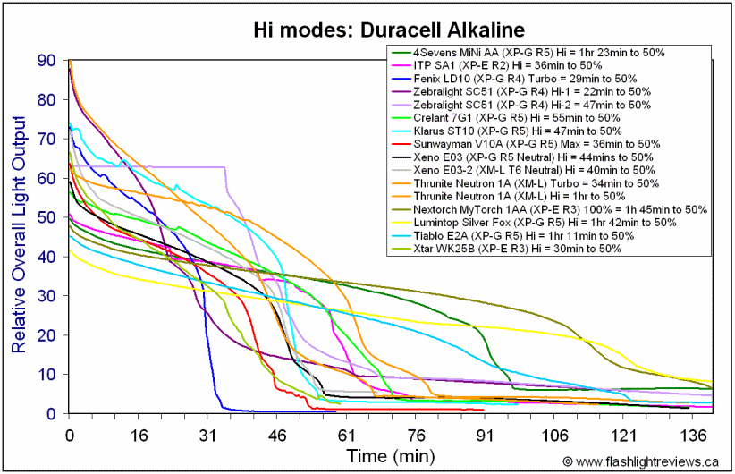

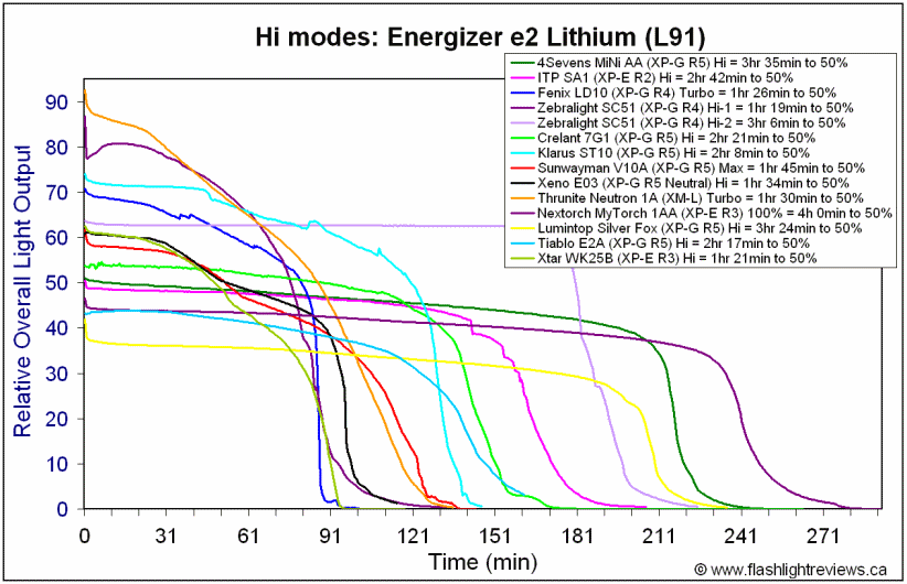

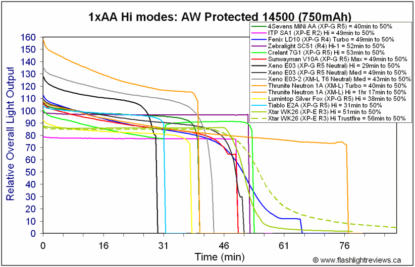

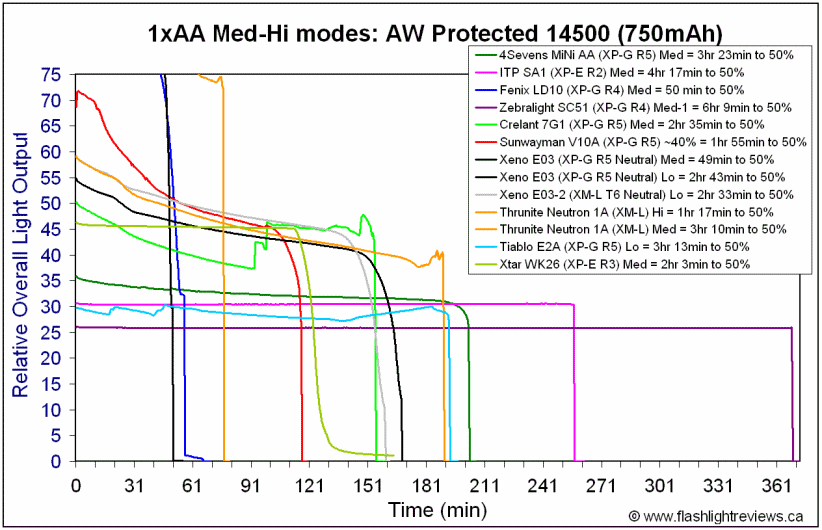

    Output/Runtime Comparison:
    The E2A appears to suffer from relatively low output/runtime efficiency on standard batteries, compared to other lights in the XP-G R5 class.
    On 1x14500, the E2A now performs more in keeping with some other lights in this class (e.g., similar output/runtime profile to the 4Sevens Mini AA).
    Reported ANSI FL-1 runtime specs for the E2A actually seem a bit conservative – runtimes matched or exceeded the reported specs in my testing.
