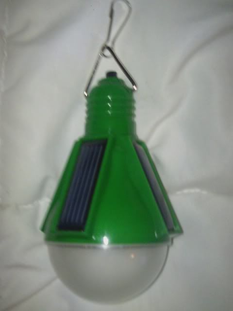

    Nokero N100 Solar Led Bulb(Un-Modded) and here is a general picture of the Nokero N100:
    It comes with a clip to hang it where you please. I have just taken a small ball magnet to hang it from any metal surface.
    Then there is a single push button for on (auto) or off(just to charge the internal battery). When on it will turn off the light and charge the internal cell just like your typical solar garden lights but much brighter, of course.

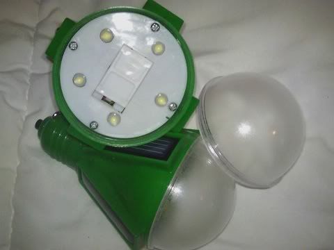

    Second pic is with the frosted screw cover off. You can see the five LEDs put off white light in the 6000K + range as its looks rather greenish/blue to me.
    Then you can see the sliding battery door to allow change of battery. This is handy of you just want to put your own cell or just use it as a AA NiMh charger.

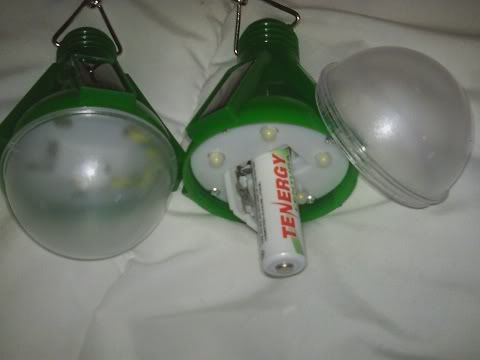

    Third pic is with the battery out and showing the general size as its rather compact for a bright light and is smaller than a e26/e27 size fixture. They say not to screw it in as it will not fit a standard fixture.

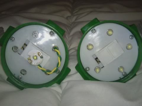

    Forth pic of the un-modded Nokero N100. The tint is a little blue/green and is your typical white light output. This is a shot for general reference as this is going to light a 10ft x 10ft space pretty good as enough to read a book or whatnot.

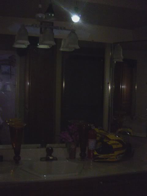

    Fifth pic is showing the modded light(I took out all the 5mm LEDs and had put in a Cree XP-G R5). Then put a little extra wire so I can bend it out of the way for battery removal.
    It lights up my bathroom great and when un-modded it puts out approximately 13.5 Lumens(Manufacturer Spec) and when modded its about 40+ Lumens(cree XP-G @ 150mA = 58+ lumens). I would say its around 30-40 lumens of nice diffused light. You are going to loose some of the light with the orange peel diffuser lens.

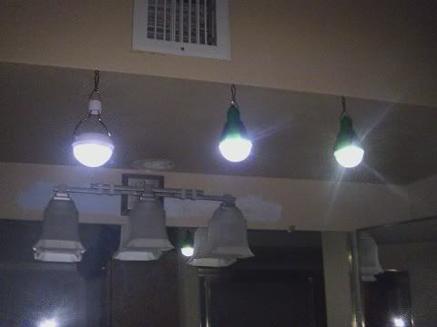

    Then here is all three lights together.
    From left to right
    (Nokero N200, Nokero N100(Modded with Cree XP-G R5), then the Nokero N100(Un-Modded)
    The Nokero N200 on the far left is on the low setting and is very bright for having four 5mm frosted warm LEDs which will last 16+hrs on low and 8+ hrs on high.
    Then the other two N100's are on their only setting which will last 16+ hrs(The cell these all came with was a 1000mah AA NiMh battery so life can be doubled with any LSD AA battery.

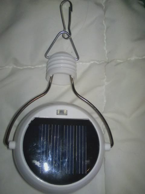

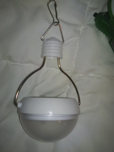

    This thing is bright and has a 3 position slide switch for 2- off- 1 modes. @ is high and 1 is low. This model allows for the single poly silicon panel to be adjusted for maximum light capture or positioning the light in any direction.
    Here is a pic of the light as you can see the head swivels and comes with a clip for easy attachment. I have also put a ball magnet on the clip as it allows for easy attachment to a metal surface.
    Then here is a pic with the head moved so you can see the single solar panel and waterproof 3 position switch(2-off-1) or (Hi-off-low).

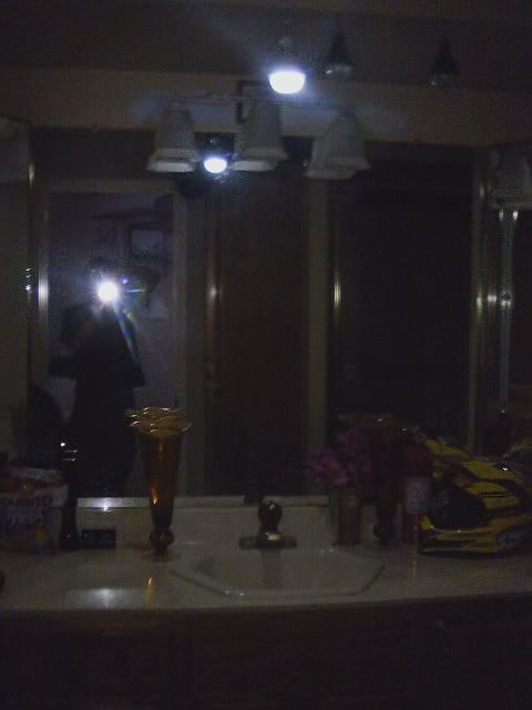

    Then here is the last pic to show how bright it is by itself. This is by far the best bang for the buck of the two but love them both. They are light, compact and require no further investment as the sun is abundant here in Arizona.
    Then for the last pic is all three of them together again as to show you that they all put out 30+ lumens of flood and will last a couple nights on.
