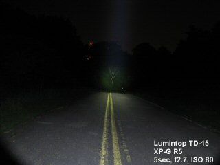

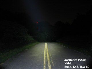

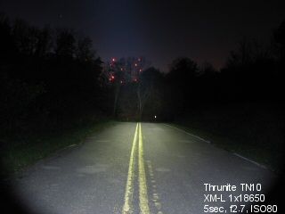

    I have picked a location that seems reasonably well suited to this task - a closed and deserted service road. Here is an aerial view taken from Google maps:
    There is a straight line from my position (pictogram) along the road, to a copse of tree located 100 yards away. There is a dead birch tree right at the red arrow-head that is a convenient marker for the photos. I’ve also highlighted a point 30 yards from my position (blue arrow). The reason for this is shown on the side schematic for this area:
    As this road goes along a ravine, and there is a significant elevation drop beginning about 30 yards in. The road makes a hard right turn as it winds down the ravine. Here is a control shot in daylight:
    This shot is taken at eye level, and I have centered the camera on the dead birch tree at the center of the copse of trees at 100 yards (red arrow). The blue arrow indicates the point at 30 yards beyond which the road "falls out of view" as it dips down.
    I have angled the flashlights directly above the camera, focused on the center of that dead birch tree. Because of the positioning, this means that a good amount of the hotspot's corona should light up the road up to that ~30 yard mark. You will thus be able to see not only the center beam throw at 100 yards, but the corona and wider spillbeam in the foreground just in front of the camera.
    Note: Although you can't see them in the daylight shot, there are a series of communication towers located in a clearing ~650 yards away. The red aerial warning lights on these towers will show up as distant red dots in the background of the night time shots. There's also a photo-reflective sign along the bottom portion of the road that you will notice in the flashlight shots.
    Unless otherwise indicated, all lights were run on Max, on the highest rechargeable battery option the light would take. The camera settings are optimized to show off the hotspots specifically (i.e., the pics look considerably under-exposed relative to what I subjectively saw during shooting). The pics use a 5 sec exposure, f2.7, ISO 80, automatic white balance (to minimize tint differences, which can be distracting).
