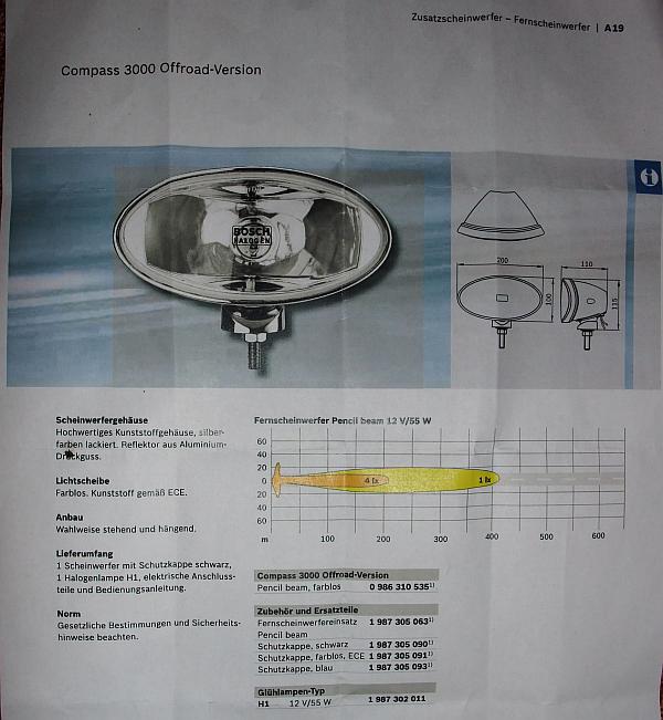

    Now in winter, I am driving very much in the dark, thus I wanted more punch for my high beam.
    Because of size I opted for the Bosch Compass Offroad Version Pencil beam light:
    that scale is in meters
    (but has nothing to do with reality)
    Now I got it and did a quick on-the-fly try but its depressing.
    When I turn on my car's high, it really does not matter if that pencil beam is on, or off; it can barely be seen any more.
    The reach of the beam is also next to nothing.
    Did I expect too much?
    Is there something considerably better at a comparable size?
    PS: I am driving a citroen xantia, so a 10 year old car of no special expensive make.
    No reason its lights should be something better than usual

    I think you'll get more bang for your buck updating your existing lights. Are the lenses cloudy? What voltage does the bulb see when you measure at the bulb's socket? Fixing these things will give better results than bolting things on.
    I see that the Bosch paperwork is in German. Which country are you in? Also, 4 lux is quite dim; appearing about twice as bright as a full moon's light.

    Such a reading is very inaccurate. What one must do is see the actual voltage loss in operation, in accordance with the instructions here.
    For a "pencil beam", I expect that aim is important. You may have the lamps aimed too high.
    4 lux at 200 meters isn't all *that* bad, is it?

    well, the main lights actually do not seem to be "bad" in any way,
    I obviously just thought (hoped?) that these pencil beams were extremely better - which they are not.
    f.e. both light "area" in front of car as well as reach of just one of my highs are so much better than this new supplemental light ...
    thats why I am asking, if I probably am just wrong on the output of the Bosch (or Hella, or ...) additional lights.
    ... cant mount the really big ones (Navigator / Luminator) because of size
    PS: atm the Compass is on the fly wired from the cigarette lighter with a short cable (15 A safety). Only powered up while engine is running.
    Dont think that setup costs so much output, to notice a difference to the real, fixed installation.

    Quote Originally Posted by yellow View Post
    It may cost you more voltage than you think. However, AnAppleSnail was probably referring to the voltage loss of the factory headlamps.
    Default Re: auxilary head light - disappointment
    An easy way to test the lamps is to connect one straight to the battery and test it out. The cable may be rated for 15 amps, but I bet your cigarette lighter isn't. Wire the lights into the car either piggy backed/triggered off of your high beam ckt, or via a switch. Use a relay or wire rated for the amperage.

    Quote Originally Posted by viper37 View Post
    That would help reduce losses greatly.
    A 55W bulb would only draw about 4.3A at 12.8V, so that's not exactly the problem. If the lamp were exceeding the capacity of the cigar lighter circuit, the fuse *should* blow. However, the fuse may sometimes exceed the capacity of the wiring so it acts more like a "slo-blo" fuse than a fast one.
    There's a big part of your problem. A cigarette lighter isn't picky about voltage drop, and cigarette lighter plugs are wired accordingly. Hook up your light properly and get back to us. Make sure you run an adequate ground. Remember, voltage drop vs. light output is not a linear scale, a 10% drop in voltage = 46% drop in light output. Doesn't take much voltage drop to really rob you of lumens.
    Pencil-beam lamps really aren't well suited to the kind of lighting task you had in mind. They produce a very narrow beam and yes, it will be very difficult to tell they're switched on; most of the light is being sent much further down the road than will be useful on public roads. Also, because of the tight, narrow beam, aim is absolutely critical. You would have been much happier with the driving (not pencil) beam lamps, 0 986 310 522 (and even happier still with the HID version, 0 986 310 572, but those are very expensive).

    Unless you unwittingly showed us page A19, instead of the very similar A18 of the Bosch catalogue, your lights are probably illegal to use on public roads near you. Or have they recently gotten re-labeled with a l.i. rating of up to 50? If someone sold you unlabeled ones as car equipment, not rally equipment, you may be able to get your money back.
