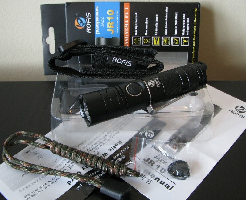

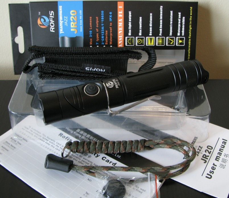

    Packaging includes a good number of extras in both cases – along with the light, you get a decent quality holster (reminds me of the early Fenix TK-series ones), paracord-style wrist lanyard, extra o-rings and boot cover, stainless steel clip (attached), manual and warranty card.

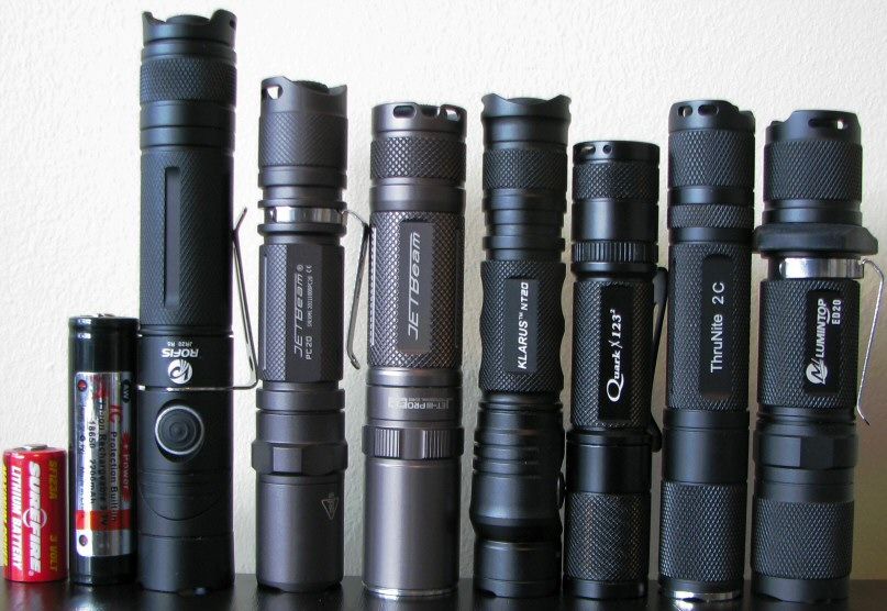

    From left to right: Surefire CR123A, AW protected 18650; Rofis JR20; Jetbeam PC20, Jet-III ST; Klarus NT20; 4Sevens Quark 123-X; Thrunite Neutron 2C; Lumintop ED20.
    Rofis JR20: Weight 907.g, Length (max): 144.4mm (angled): 136.6mm, Width (bezel): 24.8mm
    Lumintop ED20: Weight 84.4g, Length 121.6mm, Width (bezel) 25.2mm
    Spark SL6: Weight 77.8g, Length: 125.5mm, Width (bezel) 30.9mm
    Thrunite TN12: Weight: 64.0g, Length: 126.9mm, Width (bezel): 24.1mm

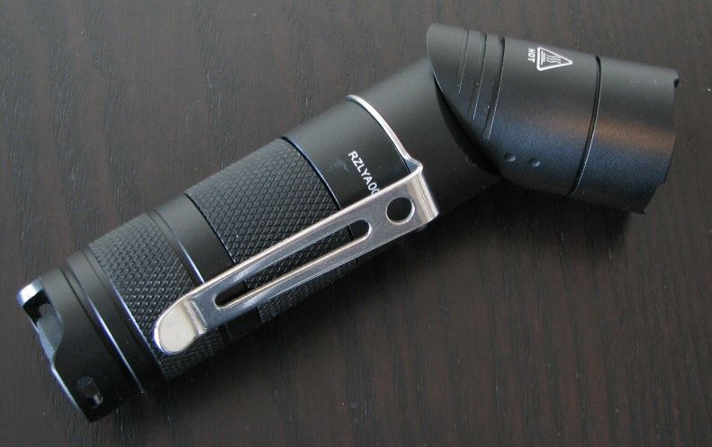

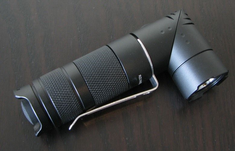

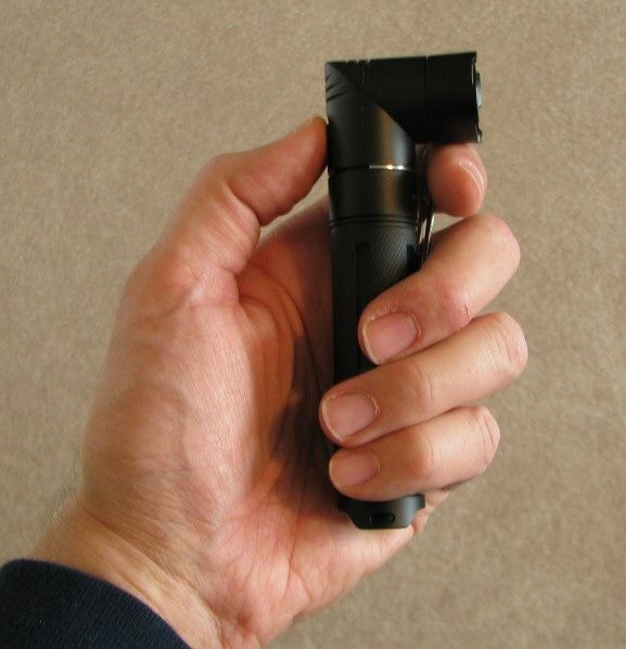

    Here is how the light looks in angled-head mode:

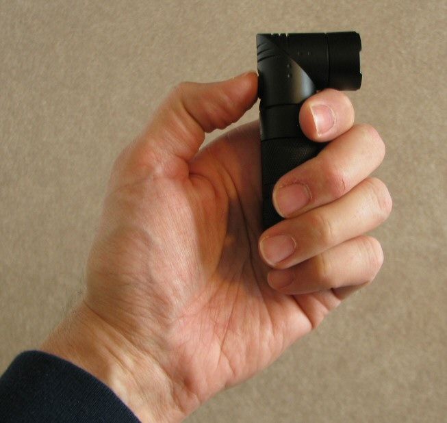

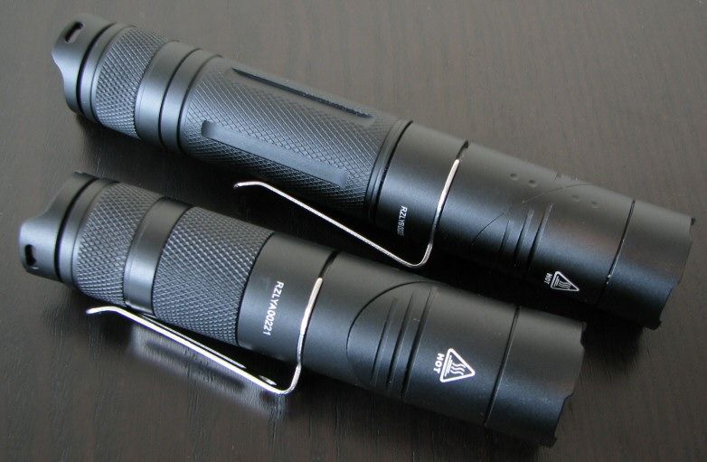

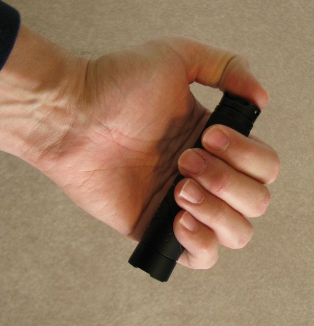

    The Rofis lights are clearly longer than typical lights in their respective classes, due to the angle-head rotating mechanism.

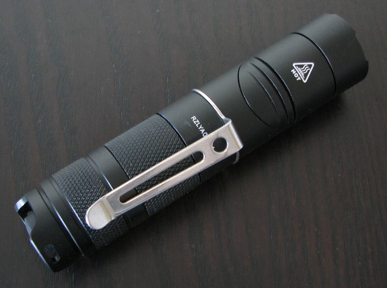

    The build of these Rofis lights is surprisingly robust – these are two of the most solid lights I've seen in their respective "slim-lined" classes. The overall construction (e.g. wall thickness, etc.) seem thicker and more solid than traditional lights this size. The best way I can describe it as somewhere between the standard Fenix LDx0/PDx0 series lights and the Fenix TK series lights.
    The lights have knurling of significant aggressiveness along their battery tubes and tailcaps, providing good grip. Anodizing is a matte black and seems thick (i.e. no dings or scratches on my samples). Labels are bright white against the black background.

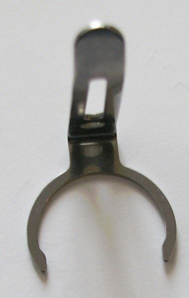

    Bundled clips fit on very firmly, and are stronger than most clips I've come across in these classes. Interesting, the clip is reversible – you can attach it around the base of the tailcap for head-down, deep-pocket carry.
    Tailcap switch is a forward clicky, with traditional traverse and firm click. Even with the tailstanding flanges, I found it easy to access with any finger or thumb. The head mode-changing switch is an electronic switch, with a good click-feel for this type of switch.
    Lights can tailstand, but may be slightly wobbly (better than most, though). Note that tailstanding also works when in the angle-head position (weight distribution is fine).

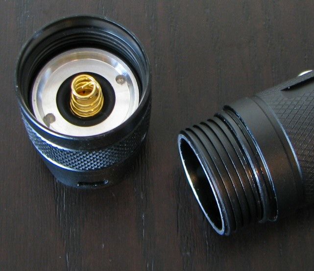

    Lights use high quality square-cut screw threads, anodized for lock-out.
    There is a spring in the head, so flat-top cells can be used.

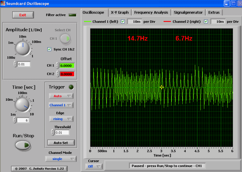

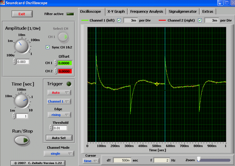

    PWM/Strobe
    There is no sign of PWM, at any output level. I believe the lights are current-controlled.
    Strobe is an alternating strobe, switching between 14.7 Hz and 6.7 Hz (for 2 secs and 1.7 secs, respectively, in a repeating loop). Certainly
    Beacon mode is one flash every half a second (i.e., 2 Hz).

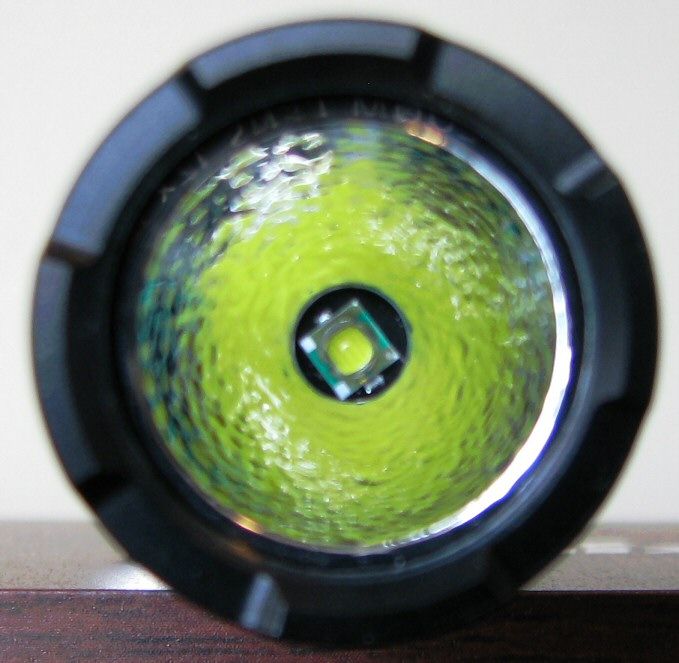

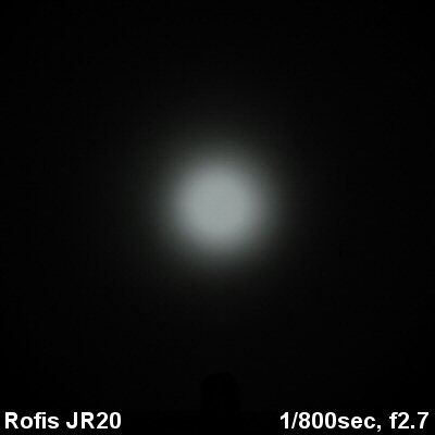

    The Rofis lights share a common reflector, Medium Orange Peel (MOP) finish. XP-G Cool White XM-L emitters were both slightly off-center in my samples, but it didn't seem to affect the beam significantly.
    JR10:
    All lights are on AW protected RCR, about ~0.75 meter from a white wall (with the camera ~1.25 meters back from the wall). Automatic white balance on the camera, to minimize tint differences.
    JR20:

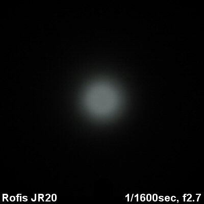

    For white-wall beamshots, all lights are on 1x18650, about ~0.75 meter from a white wall (with the camera ~1.25 meters back from the wall). Automatic white balance on the camera, to minimize tint differences.

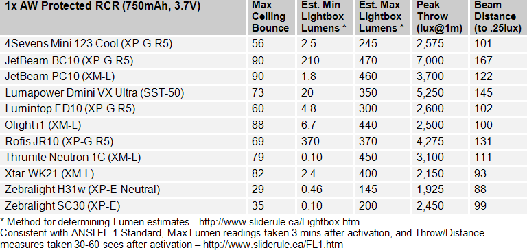

    My summary tables are reported in a manner consistent with the ANSI FL-1 standard for flashlight testing. Please see http://www.sliderule.ca/FL1.htm for a description of the terms used in these tables.
    JR10:

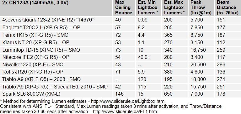

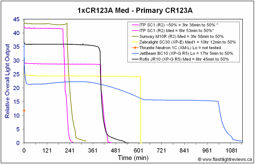

    Max output is quite high for a XP-G-equipped 1xCR123A light – among the highest I've seen. Output on 1xRCR is very bright – but note that you lose all the defined lower modes on this battery. This is very similar to what you see on the Fenix PD20 circuit.
    A few quirks – I notice that the Lo mode was indistinguishable from Med on a fresh 1xCR123A. As the battery lost some capacity, the Lo mode became clearly identifiable. Note also that as the battery continues to drop in capacity, you will eventually lose the Turbo mode (i.e. becomes indistinguishable from Hi).
    Max output seems higher in my testing than in the reported specs, but max throw was a little lower in my testing.
    JR20:
    Good output level range on all cells. I am glad to see the body tube bore width is wide enough to accommodate protected 18650 cells. I didn't test 2xRCR as it is not explicitly supported in the battery specs, but the voltage range spec suggests that they should work (as long as you keep your cells to <4.2V).
    Max output again seems higher in my testing than the reported specs, but max throw was bang on.

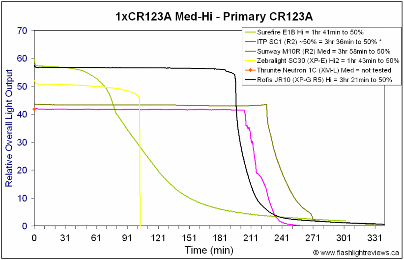

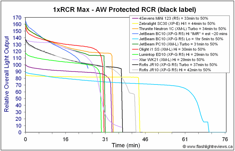

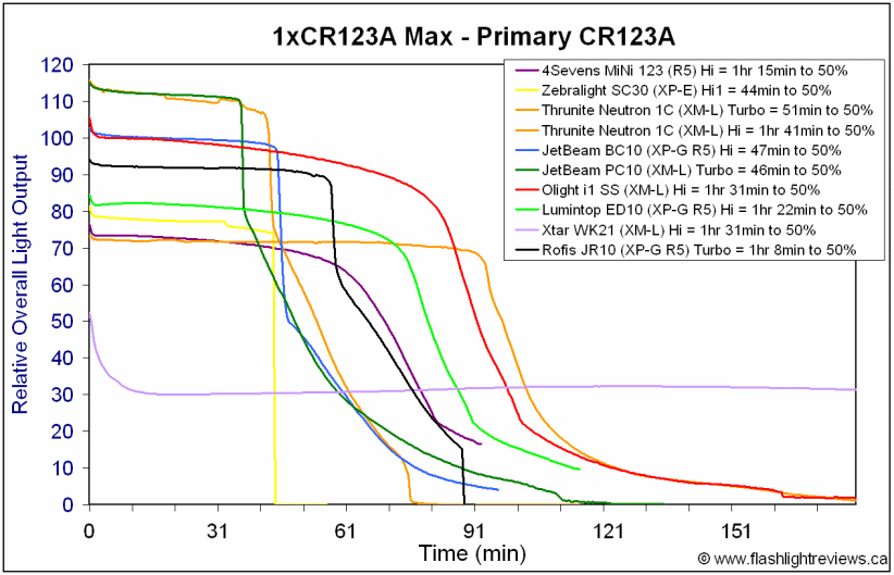

    Output/Runtime Comparison:
    JR10:
    The JR10 is clearly a highly efficient light on 1xCR123A, with good regulation. Max output is quite high for a XP-G R5-equipped light.
    On 1xRCR, you will see there is no difference between any of the output modes initially. For example, between Hi and Turbo, you will see the only difference is how the circuit responds at the end very end of the run.

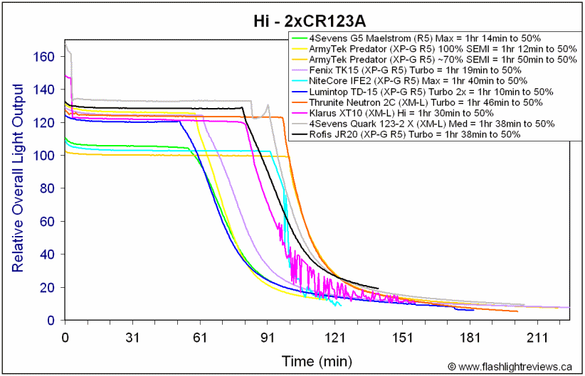

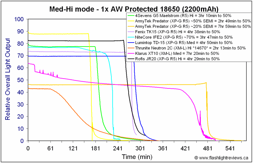

    JR20:
    The Turbo 18650 runtime is simply outstanding – I don't know how Rofis managed that on an XP-G R5. The Med and Hi modes are similarly top-of-class, although the difference to other good current-controlled lights isn't as pronounced as it is on Turbo.
    Performance on 2xCR123A is very good, certainly in keeping with other well-performing lights.
    The JR10 does not fully support 1xRCR. Like the Fenix PD20, you get only Turbo mode initially on all levels, until the battery is nearly drained.
    On a fresh CR123A, you may lose the Lo mode initially on the JR10. Similarly, you may lose the ability to enter Turbo mode as the cell runs down.
    The JR20 doesn't explictly support 2xRCR, but these batteries should work if you make sure to keep the cells <4.2V each (i.e. max voltage range is up to 8.4V).
    Lights are longer than typical in their respective classes, due to the angle-head mechanisms.
    The Rofis JR10 and JR20 are very impressive lights. The build is surprisingly robust for the size, and the lights feature an innovative rotating angle-head design that I have not seen before. Performance is excellent, with output/runtime efficiency on par with (or exceeding) the best current-controlled circuits I've seen.
    Let's start with the build – the attention to detail is impressive, in all aspects of the lights. From the switch feel, knurling, body thickness, screw threading – even the sturdy and reversible clip – everything seems well thought-out and well executed. I particularly like that the JR20 can easily accommodate protected 18650 cells.
    But of course, what stands out is the innovative rotating angle-head design. I was a bit dubious of this concept when I first heard of it, but Rofis has executed it well. The heads are appropriately stiff, and do not slide around accidentally. I'm not sure how the mechanics of this works, but I experienced no issues in my testing. There aren't a lot of angle-head lights on the market, so I'm sure the added flexibility here will be well appreciated.

    Is there some sort of detent that locks the head in the straight & angle position?
    This reminded me of the en.wikipedia.org/wiki/Rubik's_Snake
    Flashaholic* tobrien's Avatar
    Dec 2005
    Georgia Highway 441
    4,861
    Default Re: Rofis JR10 (1xCR123A) & JR20 (1x18650/2xCR123A) Angle-head XP-G R5 Reviews: RUNTM
    btw, is that clip like the Quark series clip? minus the mechanism that screws over the 'arms' to hold it in? or is it like the Sunwayman L10x series clips where you have to unscrew the head to remove the clip?
    6,936
    Quote Originally Posted by MichaelW View Post
    There may be a very slight detent when it reaches the two extremes, but it is nothing firm. The overall action is fairly evenly stiff along the whole traverse
    The Rofis clip is fairly distinctive. While of the clip-on style, they hold infinitely better than the SWM clips:
    As you can see, the ends of the arms have a ridged end, to better grasp on to the body. The arms are also thin and deep, instead of wide and and shallow, like most clip-on clips.
    thanks for those pics man, i apologize i'm late seeing your response. i still haven't picked one of these up but they're in my list
