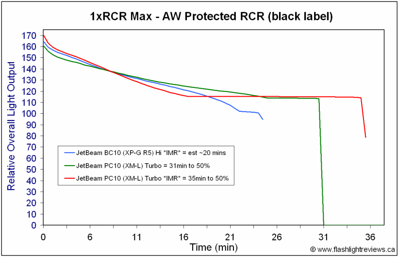

    Note: Updated to show the IMR-RCR run, which has slightly higher output initially than a standard ICR-based RCR.
    UPDATE February 29, 2012: To clarify the relative output levels on various battery sources on the PC10, here is a summary table showing estimated lumen outputs over time:

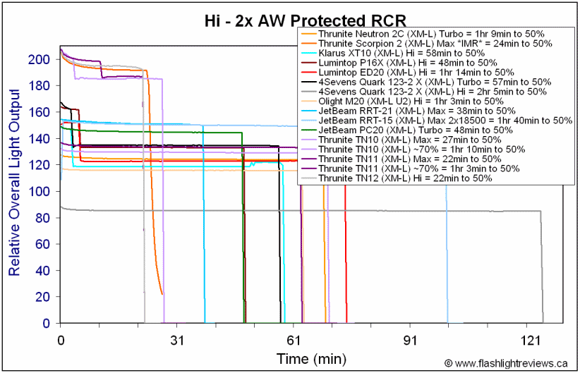

    From left to right: Surefire CR123A, AW protected 18650; Rofis JR20; Jetbeam PC20, Jet-III ST; Klarus NT20; 4Sevens Quark 123-X; Thrunite Neutron 2C; Lumintop ED20.
    Jetbeam PC10: Weight: 60.0g, Length: 127.5mm, Width (bezel): 22.6mm
    Lumintop ED20: Weight 84.4g, Length 121.6mm, Width (bezel) 25.2mm
    Spark SL6: Weight 77.8g, Length: 125.5mm, Width (bezel) 30.9mm
    Thrunite TN12: Weight: 64.0g, Length: 126.9mm, Width (bezel): 24.1mm
    Note: most of the above runtimes are on 1x18650 – only a few are on the lower capacity 1x17670 battery.

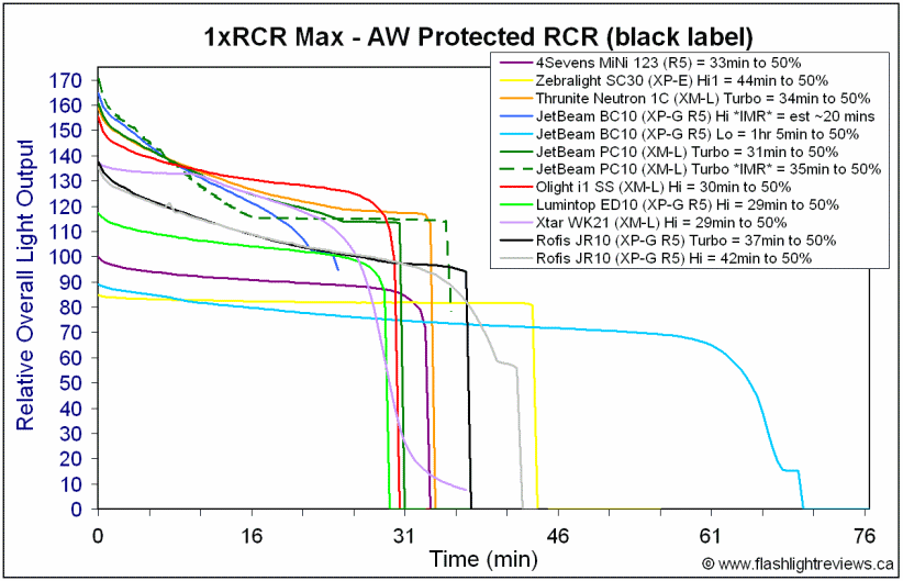

    • Performance of the PC10 was in keeping with the most heavily-driven lights in my collection – on both 1xCR123A and 1xRCR, for both output and runtime. However, I find the reported output specs unrealistic for this light - it appears to be based on initial activation on IMR-RCR, not ANSI FL-1 as reported. I suspect the PA10 is similarly inflated.
    • Performance of the PC20 was in keeping with other lights in this size/class, both for output and runtime on all battery sources. The reported ANSI FL-1 output specs actually seem to be an under-estimate compared to what I observed.
    • The performance PA20 was a pretty close match for the BA20 on Turbo, as expected. The reported ANSI FL-1 output specs seem bang on.

    Yes, I can confirm there is no difference in output between Hi and Turbo in my lightbox.
    I wouldn't have expected much difference in output between IMR and regular ICR chemistry, as the PC10 circuit should interpret the common nominal 3.7V voltage (~4.2V fully charged) the same way. But there does seem to be a bump in initial outut and current draw on IMR.
    Here are my tailcap current draws. These are lower than the source your reported, but that may reflect more resistance inside my meter (10-yr old Uni-T UT60A):
    PC10 Turbo - AW protected RCR 3.7V (ICR) - 4.16V off Pila: 1.39A
    PC10 Turbo - AW unprotected IMR 3.7V (IMR) - 4.16V off Pila: 1.60A
    Note that since the light is not regulated at these levels, output will drop quickly. What I would expect to see is a slight difference in the output/runtime pattern, due to the difference between IMR and standard ICR chemistry.
    I will do an IMR runtime today and post later.
    http://www.thaicpf.com/webboard/index.php?topic=3286.0
    Scroll down to see a pic of the RCR vs IMR difference in light output.
    It would be interesting to see your test data with an AW IMR 16340.
    I've looked at those photos, and honestly can't see much of a difference between the standard ICR and IMR 16340 photos near the end (due to the beam center having shifted slightly). It's hard to know what is due to output, and what is due to the higher angle on the IMR shot.
    I agree there is certainly a huge difference between nominative 3.0V RCR (I'm going to guess IFR = LiFeP04) and 3.7V RCR (ICR) - as you would expect from the large voltage difference in fully changed cells.

    Actually, each individual member of this series performs exactly as I would expect for that particular battery type and emitter. It is just that Jetbeam is confusing in how it labels the output.
    So, for the PC20 and PA20, you are getting actual ANSI FL-1 measures at 3 mins into the run, on the specified primary cells. But for the PC10 (and presumably PA10), Jetbeam seems to be reporting initial output on Li-ion rechargeables. These are clearly NOT ANSI FL-1 (which requires use of the stated primary cell at 3 mins).
    The other confusing thing is that we are used to seeing common heads among 1xCR123A, 1xAA and 2xAA lights in these sorts of "families". In those cases, output is always comparable for a given voltage source. With each member here having its own customized circuit, each light can instead perform directly in-line to comparably driven individual model lights from other makers.
    Simply put, the inidividual lights here are more easily compared to other lights of their respective classes than they are to the other members of the same PA/PC family.

    I don't expect there will be much difference in output, as the PC10 circuit will interpret the common nominative 3.7V voltage (~4.2V fully charged) the same way.
    I was under the impression that the PC10 was regulated with an RCR while the PA10 isn't regulated with a 14500 hence the 100 lumen rating difference by JetBEAM.
    Are you able to confirm the PC10 definitely isn't regulated when running an RCR?
    Ok, I've updated the main PC10 RCR graph with the IMR results (dotted line) in the main post. It can be hard to see, so here's a blow up of the Jetbeam lights (with IMR as a solid red line):
    There is a definite shift in the runtime pattern on IMR vs standard (ICR) chemistry - the light is brighter initially, but it drops off faster to the regulated ~320 lumen level of the 1xCR123A.
    Here is a table that summarize this in estimated lumens:
    So, it looks to me like the JetBeam reported lumen value for this light ("550 lumens") refers to initial activation on IMR-RCR.
    Quote Originally Posted by Chicken Drumstick View Post
    The graph above is fairly clear - while the PC10 may be "regulated" on RCR, it is certainly not flat stabilization initially. It only reaches flat regulation once it drops down to the flat-regulated level of 1xCR123A (i.e. ~320 lumens in my testing).
    As to what the actual lumen values are at each level, that's hard to say - my estimates are just that, based on the method I developed (see this link from the review).
    But as for the ANSI FL-1, it seems clear than the PC10 and PA10 are NOT using ANSI FL-1 standards (whereas the PC20 and PA20 are). I don't know why the discrepancy, but the PC10 and PA10 should be re-labeled to make it clear what those numbers are actually referring to.
