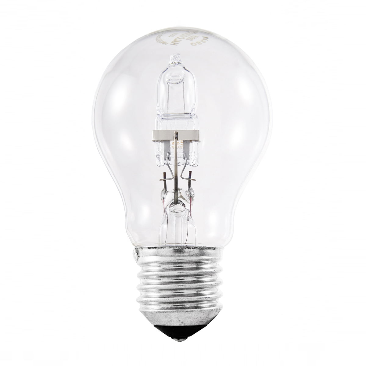

    Quote Originally Posted by inetdog View Post
    But be careful about the electrical code requirements on luminaries installed in clothes closets. Particularly given the high temperature of a halogen bulb.
    Common halogen replacement bulb (double enveloped) can be used like any other incandescent bulb. The hot inner halogen capsule is inside a protective outer glass bulb. These have become very common now. Perhaps you have not noticed?

    If you are referring to lifespan, I can not remember the last time I have had to change the bulbs in any place in the house where it does not get left on for long. If the light is on less than 20 minutes per day, I doubt you will have to worry about it.
    I have some 2000 and 2250 hour medium base halogen bulbs, both in regular (A19) bulb form and pear shaped (BT15). These longer life halogens may be difficult to find, depending on your region, but they cost less than third of the cheapest LED bulb. http://www.elightbulbs.com/catpics/philips/60054lg.jpg (230v)
    http://www.lighting-gallery.net/gall...l_SANY3047.JPG (USA)
    It will be a long long time before one of these bulbs burns out if it is just being used in a closet, and will never get left on and forgotten about (because of the motion switch). I doubt you would live to see it. There is a bunch of energy saving hype going around, and not all of it makes economical sense in every situation. But if you just want the latest cool technology, go ahead. You said yourself you wanted good color rendering. Newer is not always better.
    In case you have not noticed, I am a bit of a halogen fan. The point of this thread is that, if you were thinking about getting the L-prize just because of the CRI and longer life, a good halogen may make more sense. Especially if you would have to resort to a Y adapter otherwise.
