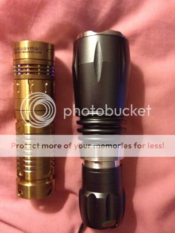

    Quote Originally Posted by mohanjude View Post
    Saabluster - this is what I have been waiting for. My experiment with a DEFT EDC...
    Next to be shortened will be LR+ - runs perfectly well on a 18350 850ma battery. No reduction in brightness to the naked eye.
    Lets see it in your hand...I'm guessing approx 4 inches.
    Hey without the grip rings it looks like a lightsaber!

  4. #124
    Default Re: DEFT-edc LR+ 72K cd!!
    Well I'm glad you finally got what you wanted. I think I prefer the look of the full length body but that cut-down version is even more pocketable for sure.

  9. #129
    I am really loving my DEFT shortie... It works for at least an hour. Since I use it for short bursts it least me a whole week in real use before recharging.
    My next project is take the Titanium highly polished body from Lumens factory Seraph shorten it and transplant the internals...
    Saabluster the internals are epoxied in some kind of resin... Any chance I could send you the Ti body for it to be transplanted for a fee?
    The only thing that can be reused is the LED pill. To remove the driver requires it to be destroyed. There is no other way. I can do the mod for you though.
