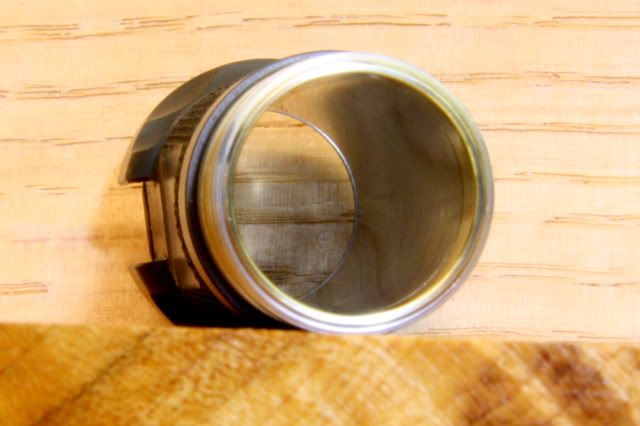

    From the factory the tube contains a central divider:
    Boring removes the central divider and easily allows the use of a 17mm cell:
    Milky can confirm whether his L1 modded head can be re-modded for use with 18mm, but I know he can do this for the L2 head. The issue with 18mm in both the L1 & the L2 is the O-ring groove at the tail - the 18mm bore has to end before that reduced diameter section (orange line is the negative end of the battery):
    This "short bore" causes the positive end of the battery to interfere with full seating of the head. Milky then re-mods the head so that it works with the new battery location.

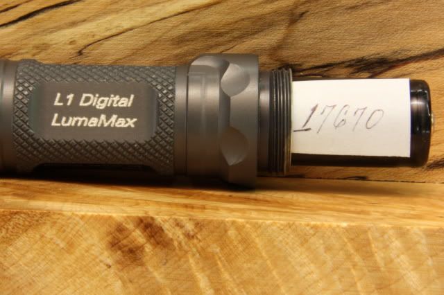

    Can you bore out the latest Generation 6 standard L1 to take 17670 battery?
    precisionworks's Avatar
    Apr 2007
    Benton Illinois
    5,592
    Default Re: Boring service for SurefireŽ and other aluminum or titanium lights
    That's a good question. Can you describe how the Gen6 is different from prior L1 models? Here's some info posted in the "old" and now closed boring thread, perhaps that may help:
    SF L1 Digital LumaMax.
    When SF manufactures this model, they bore in from each end & leave a centralized partition (or tube divider) which works fine for 1XCR123 ... but doesn't allow using a 17670 or 2XCR123.
    The L1 got a special fixture machined so it could be secured in the lathe, then it was bored & honed:
    SF installs a brass sleeve at the tail end, similar to the stainless sleeve in a U2 except that the brass is dead soft & easy to bore through:
    The L1 is now ready for more power:

    I am not sure what the internal differences are between the various generations. Would someone knowledgeable chime in please.
    I just wanted to know if I can bore my stock standard L1 from the Gen 6 Cree to take a higher capacity 17670 battery.
    Thanks.

    Quote Originally Posted by Benchiew View Post
    Found these images in an old For Sale thread in The Marketplace:
    L1 Gen6 on left L1 Gen5 on right
    If there's enough length left to accommodate a battery 67mm long then yes, it can be bored. IIRC the Gen5 & Gen4 are both the same "longer" length and the Gen6, Gen3 and Gen2 are all the same shorter length. But I do not know which one is shown in the prior images.

    The Gen6 L1 can accommodate a battery of about 48mm long after boring. An 18500 did not fit afterwards.
    That is great information to have, TYVM
    If I understand this correctly only the Gen4 & Gen5 have the length needed for 18500/17670.
