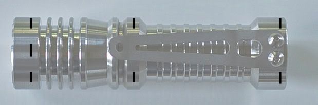

    Default Re: Tritium slot machining & installation
    A number of emails come in with questions about trit slots on a McGizmo Haiku. The image below shows the best locations for slots:
    Either 1.5x5mm or 2x6mm work well.
    Head - either 6 or 8 slots
    Collar & tail - either 5 or 7 slots.
    Cost for 1.5x5mm slots in titanium is $24 each. The 2x6mm slots are $44 each. If 10 or more slots are milled at one time there's cost savings of 10%.

    Each slot required 20 milling passes (500 in total). The small end mill is lowered only 0.1mm per pass which keeps the chip load on the tool at a moderate level.
    I'll be eager to see images after Step 2 & Step 3 are completed.

    My Haiku and Tri-EDC just returned to me and I installed the trits.
    Thanks Barry for the perfect work, all slots are where they should be and they are all exactly the same, in one word : perfect!
