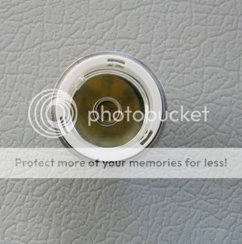

    View of the module from the top and typical beam shot
    You can still see a bit of a doughnut hole in this picture but most of the time we can focus all or most of it out.

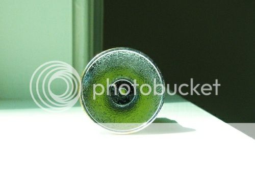

    This is a picture of the reflector made for the Cree XPE XPG This gives a very smooth and concentrated hotspot.
    New OPTICS Modules for XRE only
