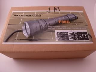

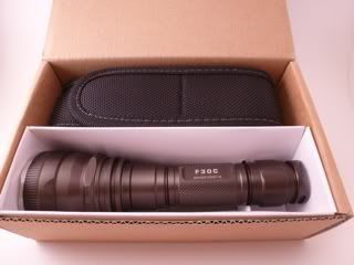

    The F30C came packaged in this cardboard box with a sticker on the front. The letters "JM" are in marker and probably won't be on the production version, they are my initials .

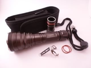

    Inside you find the light in a nice cardboard cradle, with all the accessories stuffed inside the holster.
    Here's all the included accessories: extension tube, holster, lanyard, clip, and two o-rings. My review sample also included a rough draft of a user's manual printed on a piece of 8.5x11 plain white pater, which I believe will be updated to something more polished in the production version.

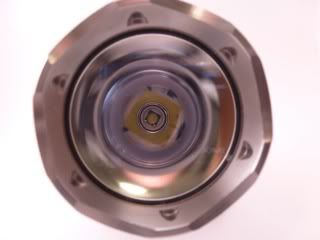

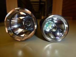

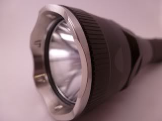

    The F30C uses a Cree XM-L emitter, T6 bin. The LED is well centered in a smooth reflector, which optimizes the throw of the light, but tends to add rings or other artifacts to the beam. It has a stainless steel, crenelated bezel with some indentations cut out of the inner slant. The crenelations are useful for seeing if the light is on when it's standing head down, or for striking an enemy. The indentations cut along the inside are purely for style.

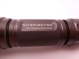

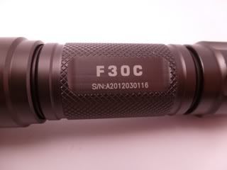

    The body has two flats cut into it, one on each side. One side has the Nitefighter branding, the other side has the model number. The lettering is clearly printed and professional-looking.

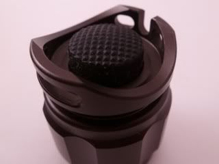

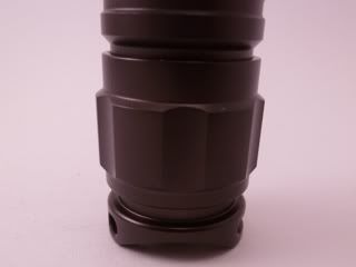

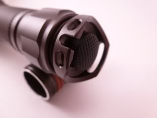

    The F30C has a cutout-style tail cap, which allows easy access to the switch (from two sides) while still making the light able to tail stand. You can also see that the tail cap has one long hole cut out of one side, and two small holes plus a notch cut out out of the other side. This allows for a large variety of ways to use a lanyard, either the one included or your own style, while still retaining the ability to tail stand if you desire it. Also, the main section of the tail has several large grooves cut into it, giving very good grip on the tail end.
    The switch is a forward-clicky style switch, which means that you can press it half way for momentary on, or press it all the way and it will click into a constant-on position.
    As mentioned, the F30C can tail stand. However, it's not a completely stable tail stand, because of the sides cut out, so you'll need a very flat surface, and be careful not to bump it.

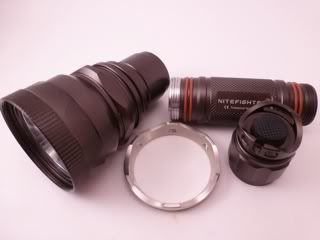

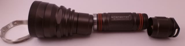

    Now it's time to take it apart.

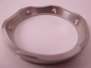

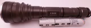

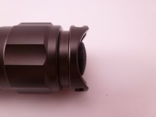

    As you can see, the crenelated bezel is removable, and other than that, nothing else comes apart easily without the use of tools, except at the separation between the head, body, and tail. The F30C uses double o-rings for extra certainty of protection against water, and claims water-resistance to IPX-8 standard (protected from immersion in water beyond 1 meter, not tested for resistance to dust/particles). You can see the results of my submersion testing in the "Performance" section.
    Not pictured above: 16340 extender

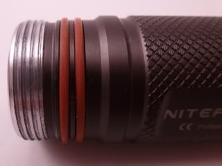

    The crenelated bezel can be unscrewed from the head without too much effort. This leaves the possibility of changing out bezels if desired (for example, a "non-agressive" bezel).

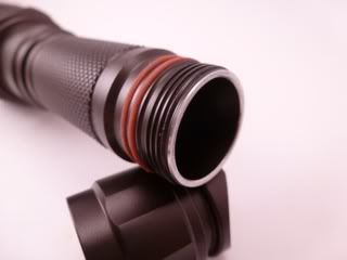

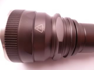

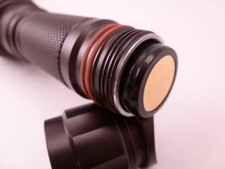

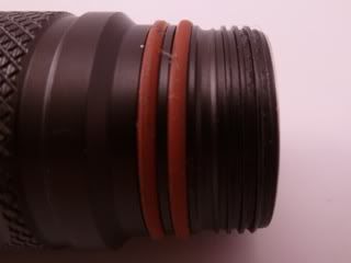

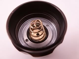

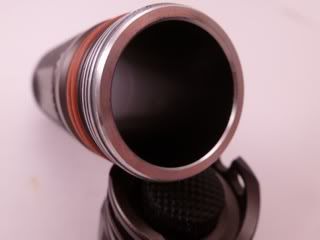

    The threads between the head and body are not anodized, because they are part of the electrical circuit, and because of the user interface (which includes loosening or tightening the head), need to make electrical contact even when the head is not tightened fully. A spring in the head serves as the contact for the positive battery terminal, which protects the battery during impacts, and also ensures the use of either button-top or flat-top cells.
    All of the body threads are thick and square-cut, which is generally the most robust design, and make screwing or unscrewing the parts easiest. The threads at the read of the body are anodized on the outside, and un-anodized on the rear face, because the tail only needs electrical connection when fully tightened. Anodizing threads helps them last longer, so, if changing batteries frequently, I would advise using removing the tail from the body, instead of the head. Also, you can see here that the walls of the body are respectably thick.

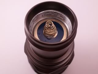

    The threads inside the tail cap are anodized, and the base of the inside is bare to make electrical connection with the rear of the body. A spring is used for the negative terminal, which again helps protect the battery during impact.

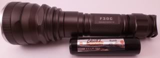

    When an 18650 battery is inserted, it will stick out just a few millimeters (especially if it's closer to actually being an 18700, like my Callie's Kustoms cells).

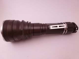

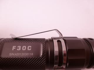

    The F30C includes a clip as a standard accessory, which clips onto the side of the light with a moderate amount of force.
    The clip is angled in such a way as to make contact with the body, which should help it hold the light firmly wherever you clip it.

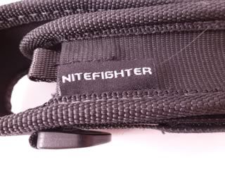

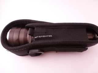

    A holster is also a standard accessory, with the Nitefighter brand name printed on a small tag on the side. The holster has a velcro belt strap and a velcro head flap. The F30C fits in the holster head up, but not head down. The F30C can be put into the holster while the extension tube is attached, but I was unable to get the cover flap to close properly in this situation, and the head sticks out significantly further.

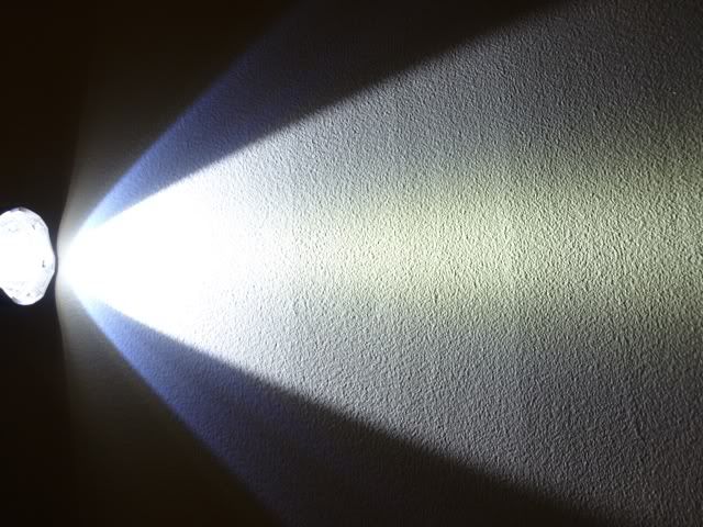

    BeamSlice
    (ISO 100, f/3.3, 1/10")
    As you can see here, the design of the reflector/emitter together focuses the warmer tones of the light towards the center of the beam, and bends the cooler blues and purples to the outside.

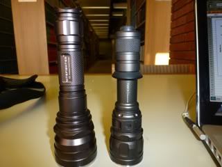

    Nice review Bigmac - how would you compare to the Sunwayman T20CS? I wound up getting the T20CS after your review as I wanted a non aspherical pocket thrower - of which I'm very happy with. But liking flashlights, always looking out for the next thrower... pocket sized. Cheers!
    I'm glad you asked! When I first opened this light up, I thought of the T20CS. I haven't done any direct comparison yet, but I've got a few observations. On 1x18650, their output is very similar. The T20CS has slightly better regulation, and a lower low. I can't really compare run time, because I've gotten higher capacity batteries since reviewing the T20CS. The T20CS has the side switch/tail switch combo, while the F30C uses a tail switch/head twist combo for UI. The T20CS has the low voltage indicator. The T20CS seems to be going for $110, the F30C has an expected price of $89.
    Most notably, the F30C is significantly larger, including having a larger reflector, so my money is on the F30C for throw. Here's some quick and dirty pictures.
    I might address this in subjective review or I might not, I'm not sure if I want to start putting comparisons in the actual review, or leave all that for the replies.

    What is the lux number as printed on the packaging?
    Thanks
    Default Re: Object/Subject Review: Nitefighter F30C (In Progress)
    Quote Originally Posted by jh333233 View Post
    Excuse me
    Thanks
    They don't give a lux value, but they give numbers in lumens and cd, or I think you could calculate ANSI lux from ANSI meters throw.
    Max 750 lumens, 27739 cd, 333 m
    Min 37 lumens, 1792 cd, 85 m

    I haven't heard any sort of timeline from Lumingear, but from how well this review sample functions, I'd guess they are pretty close to being ready for production. I know as a new company in the flashlight arena, it might take them some time to get dealers sorted out, I'm not sure how that is going for them.
    Alright, more outdoor beam shots are posted.
    I also did a shot comparing the T20CS with the F30C. As I expected, the F30C has a tighter hot spot than the T20CS, so with similar overall output, the F30C will throw farther. I also found the spill of the F30C was slightly less as wel.
    <F30C............................................. .................................................. ..............T20CS>

    More runtimes added: turbo on 18650 and 16340, medium on 16340. Next I'm doing high on 16340, then the two low modes.
    Seems this one is a much better thrower than T20CS despite being bigger
    ANSI range is .25lux@333m
    Calculation of lux @ 1m:
    0.25 * 333 * 333 = 27722.25 lux
    Much more than 18k of T20CS
    Any idea on the bezel diameter, MSRP of F30C?
    T20CS has 36mm of bezel diameter and i assume F30C is fatter
    Seems it is well constructed, at least it has a thick body
    Waiting for UI review
    Default
    The bezel diameter is the same as the head diameter, which I measured and listed in the review (end of the "construction" section). I don't know the msrp for sure yet, but I think the F30C thread in the marketplace mentioned an estimate of $89.

    Many thanks Bigmac! These are excellent beamshots and is a great review thus far! The comparison with the T20CS is also interesting - you can certainly see the tighter spot with less spill - it looks a bit brighter - perhaps it'll pick up an extra 50yds? It's still a small size and the price is good also for throwing so well. Will keep my eyes open on your longer term impressions - Right now, I'm liking my T20CS because I'm going to pick it up and head outside with the dog! Where does one buy an F30C anyway? any US distributors yet? Cheers and awesome review!!
    Default
    Quote Originally Posted by RCLumens View Post
    Yeah, the F30C is definitely going to have a longer throw. Hopefully I'll be able to take them both out to a darker place to get some better long range comparison shots.
    Ok, I've finished the notes in the Construction Quality section, and given a sketch of the UI. I'll have to come back and polish up the UI section later (the F30C is doing a runtime test on low right now, so I can't play with the UI at the moment).

    Yes, you move through H-M-L by the tail cap button.
    I don't know about PWM, I haven't tested for it yet (and like I said, right now it's in the middle of a run time test for low mode). If there is PWM, it hasn't been noticeable to me in my normal use so far.
    I added the run time data for High with 2x16340. The test of Low with 1x18650 is still going on, 50+ hours and output is still above 50%.
    another amazing review, thanks!
    so it looks like, based on the barn pictures, that it's got a decently noticeable ring outside of its hotspot. is that annoying at all in usage?
    also i really, for some odd reason, like how the tail cap has the keyed slot in it. for some reason that caught my eye and i like it

    Subjective review begun
    The subjective review is almost complete, I'll just add a few more impressions after the low mode runtime test is done and I get a chance to play with it some more. At that time I'll also add more details to the UI section. After that I'd like to get some more, longer range beam shots.
    The low mode run time test is currently almost to 65 hours, and is getting close to 50% of starting output, but isn't there yet.
    I haven't noticed a ring outside of the hotspot when I've been using the light, and I can't see it in the pictures, so I guess it's not that annoying in usage . After the low mode runtime test is done, I'll take it out for a spin and see if I can find it, maybe you've just got better eyes than me.

    Thanks for the complement! I'm going to be asking the folks at Nitefighter if they've got an idea on where/when these will be available.
    Time to 50% of starting output on Low mode, using 1x18650 Callie's Kustoms 3100mAh:
    2 days, 18 hours, 36 minutes, 26 seconds.
