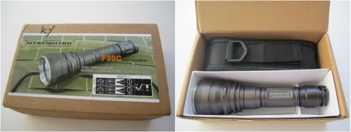

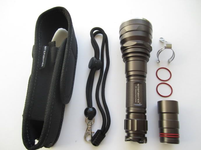

    Nitefighter is a new flashlight manufacturer on the scene. They sent F30C(XM-L T6 emitter) test sample to me. The sample light came in a cardboard box with cut-out cardboard packing insert, and a good quality holster.
    The wrist lanyard, pocket clip, spare o-rings, user manual, and extension tube came with my sample.

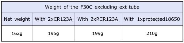

    - Weight : 210g(w/o battery and ext-tube)

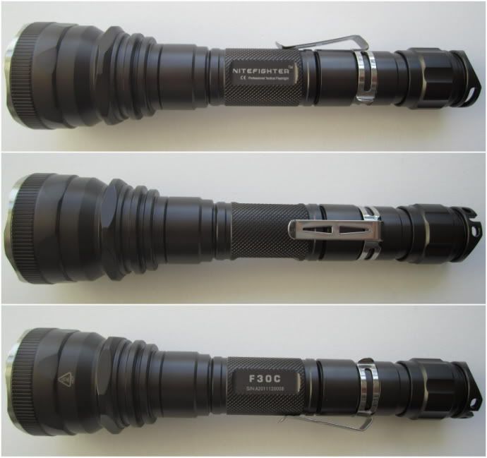

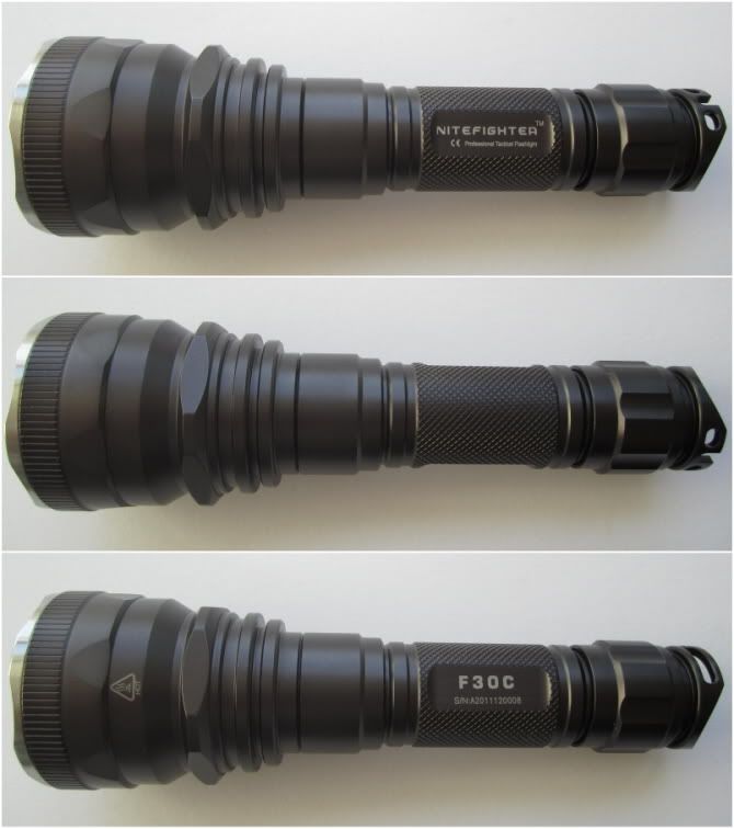

    Anodizing is a slightly glossy dark grey-brown color and HA(type III). The letterings such as maker, model name are marked on the battery tube.
    The clip is basic and simple, but my sample seems to be holding on well. The clip is head-facing, and not reversible.

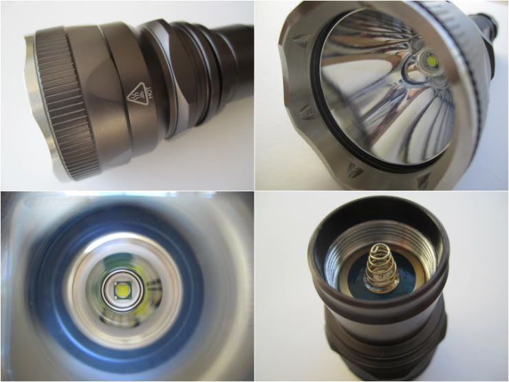

    The head of the light has a scalloped stainless steel bezel ring and two cooling fins. There are many fine fluted ridges on the bezel.

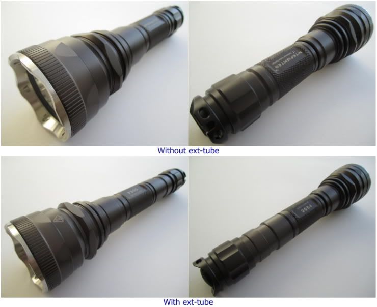

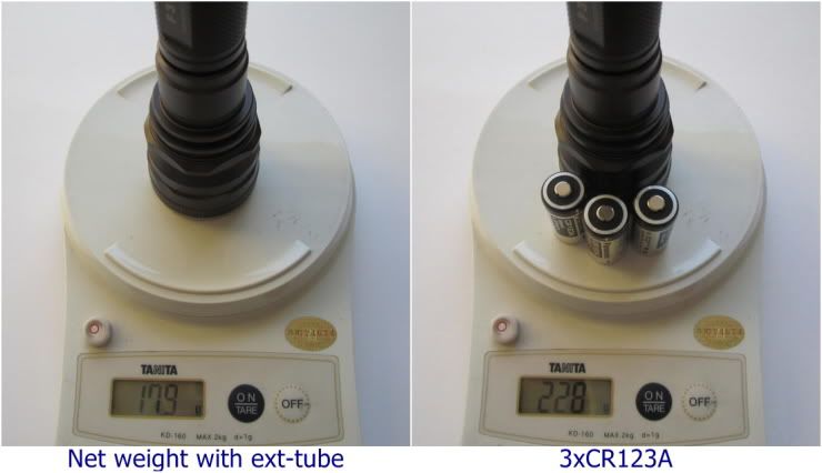

    [Edit : 2012.04.15]The included ext-tube allows the light to be used in a 3xCR123A configuration for extended runtime and better regulation. [Edit : 2012.04.15]

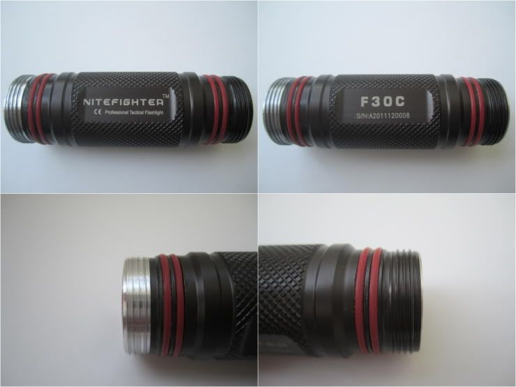

    Knurling is presented on battery tube, and is reasonably aggressive.

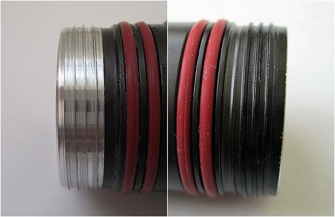

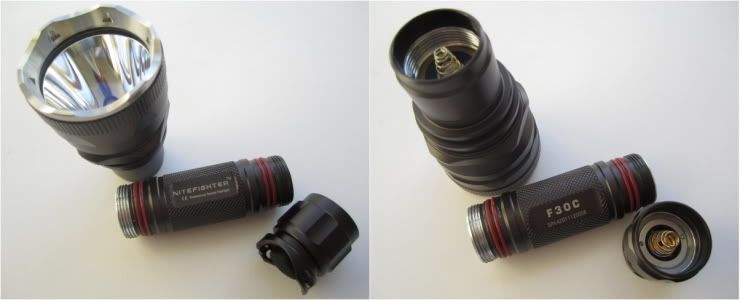

    The light has 3 parts(i.e. head, battery tube, and tailcap). There are square-cut threads at both ends of the battery tube.
    The F30C comes with a large reflector, and use a cool white XM-L T6 emitter. Centering of the emitter is perfect. There is a spring on the positive contact plate in the head, all my flat-top batteries work fine in the light.

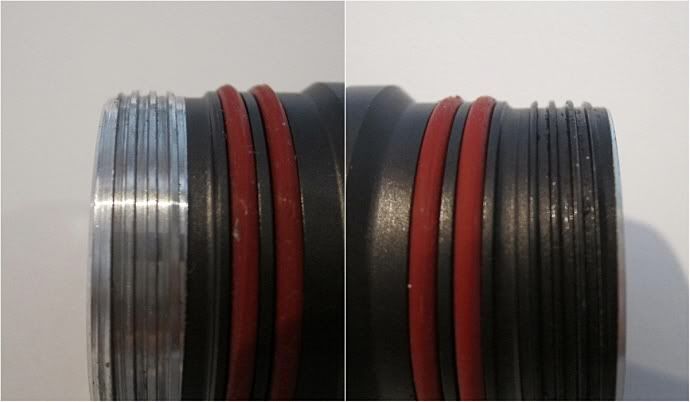

    There are square-cut threads at both ends of the battery tube. They are smooth with no cross-threading or squeaking. Tailcap threads are anodized for lock-out.
    [Edit : 2012.03.25] As you can see, the pitch of the head & tail side looks same, but the crest width isn't same. (I am not sure why they are different.) [Edit : 2012.03.25]
    [Edit : 2012.04.12] The above shows the screw threads which was delivered from Nitefighter again, the both pitch and the crest width looks same. [Edit : 2012.04.12]

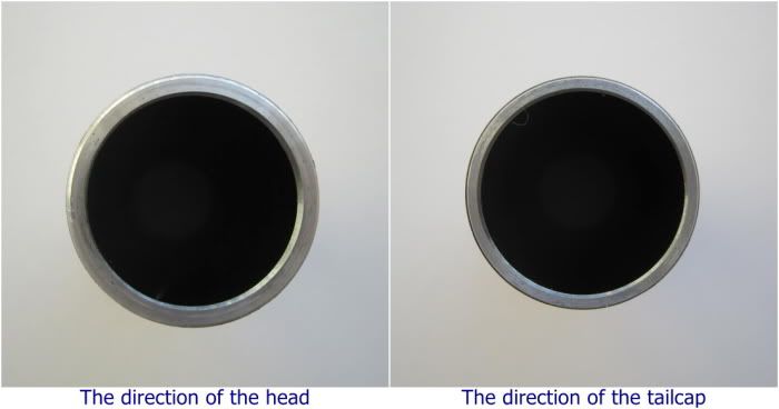

    [Edit : 2012.04.17] The thinnest part of the battery tube is 1mm thick. [Edit : 2012.04.17]

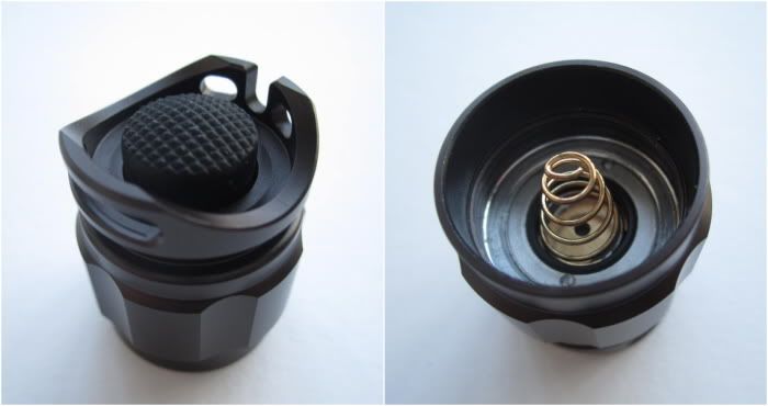

    The forward clicky on-off switch has a good feel and slightly stiff. The switch cap sits slightly recessed within the tail cap which mean the F30C is able to tail stand without problems.
    The switch is housed within the tailcap which allows the for momentary activation by half-presses.
    Overall build quality is nice.

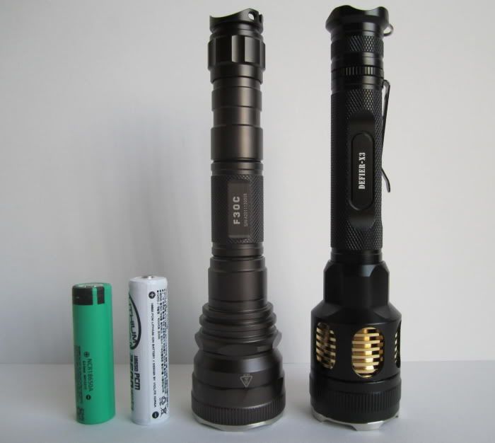

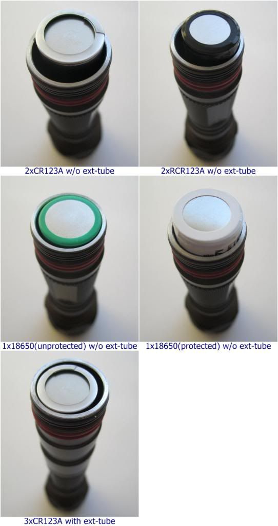

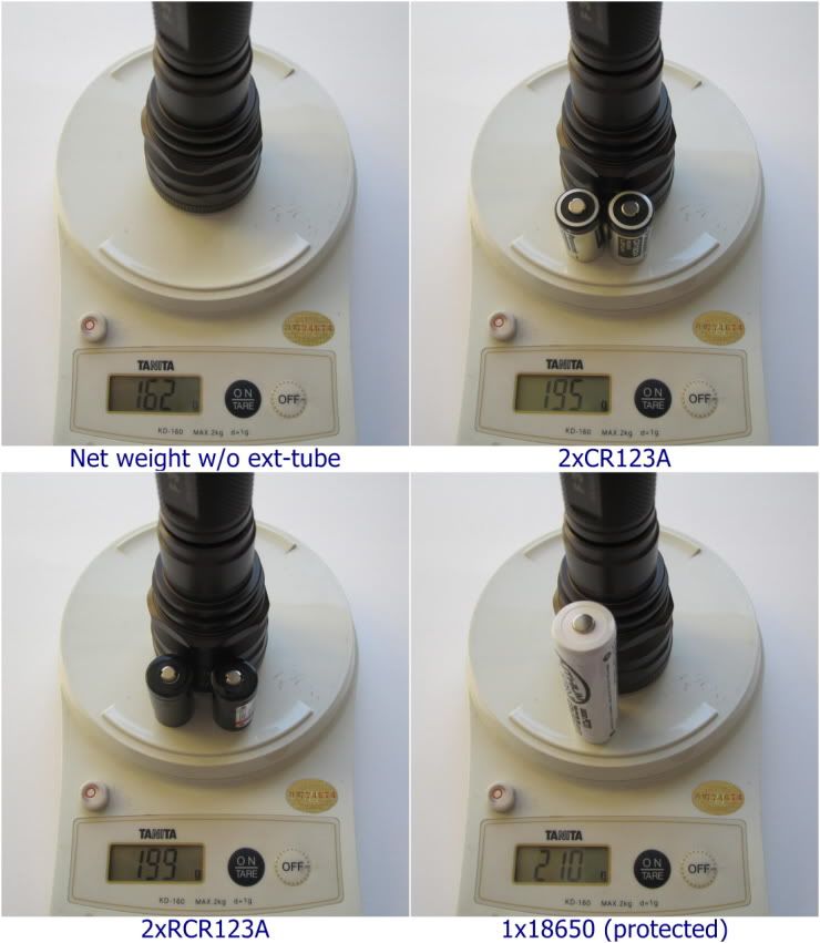

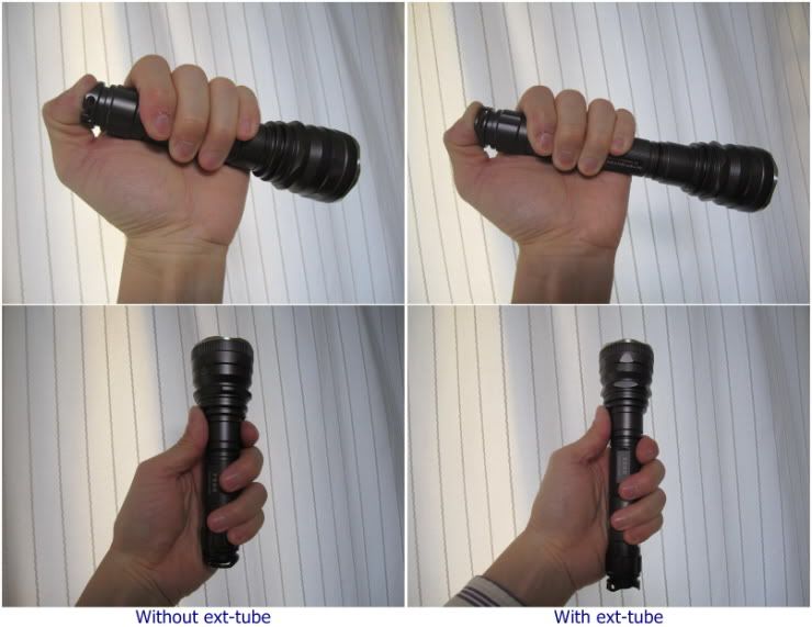

    The light can be powered by 1x18650 or 2xCR123A or 2xRCR123A. The battery tube can accept flat-top or button-top 18650 cells in my sample. Regular CR123A or RCR123A fit fine. Also the light can use 3xCR123A with an ext-tube. Nitefighter(Andy Wong) informed me that F30C can use 3xCR123A only with an ext-tube. Note it can't use 3xRCR123A due to high voltage.
    The light feels reasonablely solid and has a good grip.
    From left to right, Panasonic unprotected 18650, VicLite protected 18650, Spark SL6S-740NW, Jil-Lite Stern, Solarforce L2T, Nitefighter F30C, XTAR TZ58, ThruNite Scorpion.

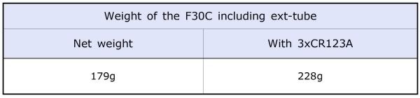

    The F30C including ext-tube is slightly longer than Skilhunt Defier X3 excluding ext-tube.

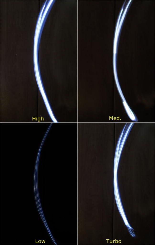

    PWM
    I was unable to detect any signs of PWM with my test(waving the light sideways). It appears to be current-controlled on all modes.

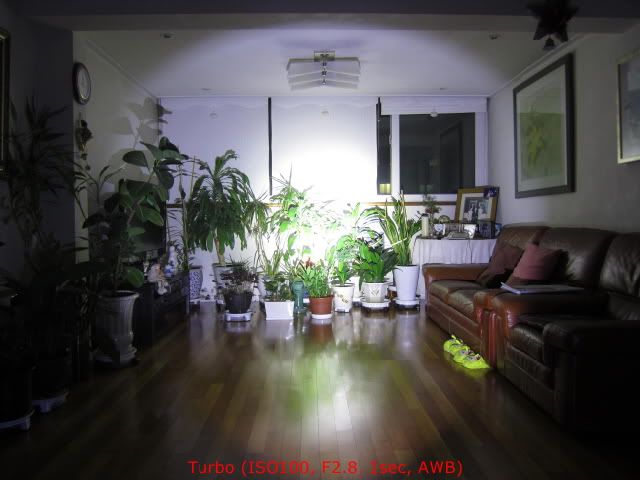

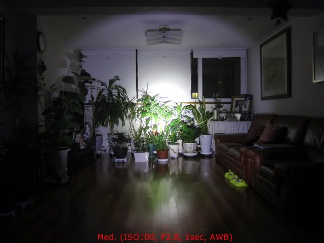

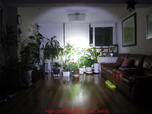

    [Edit : 2012.04.15] Addition of Beamshot
    Beamshot

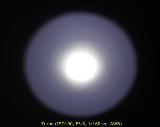

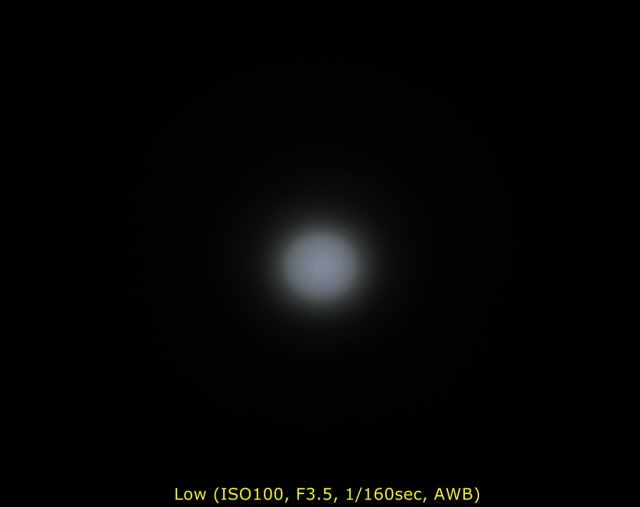

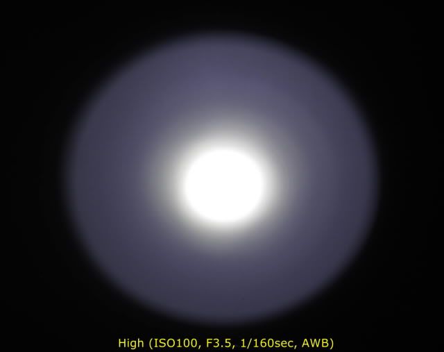

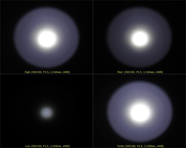

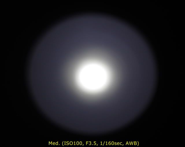

    1) White door beamshot (about 50cm from the white door, Auto White Balance)
    The light has a bright hotspot with a bit irregular small-sized corona area which show slightly greenish tint. The beam color temperature looks high on my sample. There is a very thin ringed banding both inside & outside of the spill region, but it doesn't affect practical use.

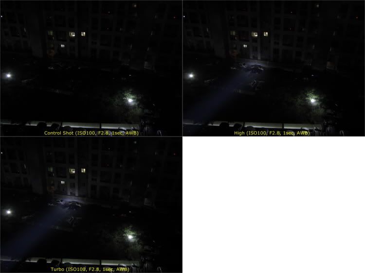

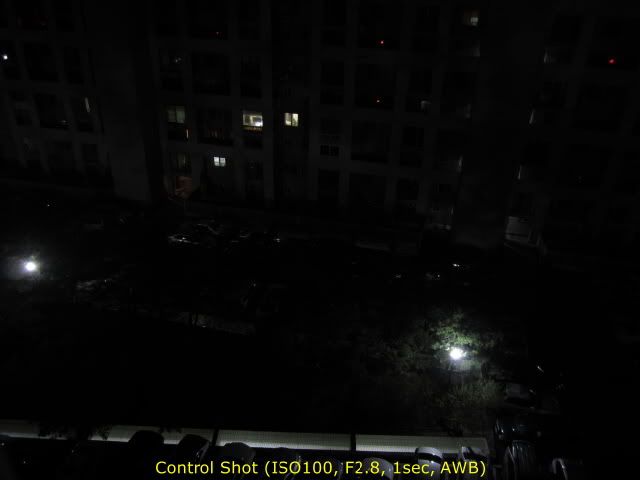

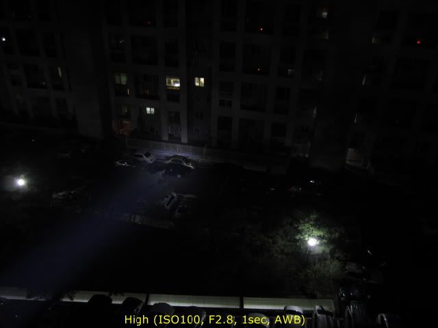

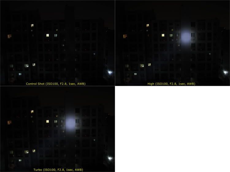

    2) Indoor beamshot (about 7m from the target)

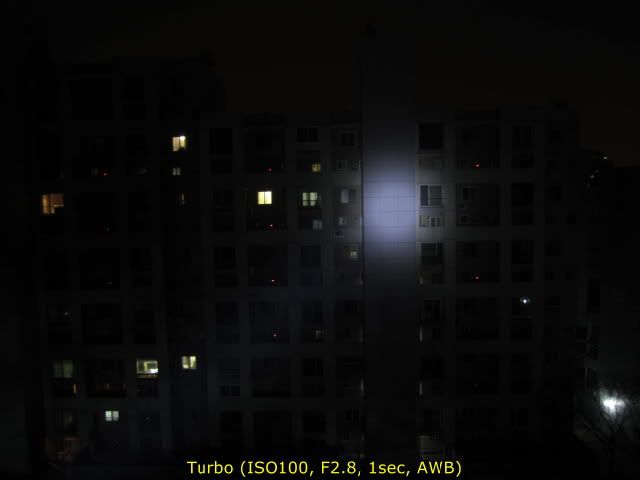

    3) Outdoor beamshot (about 55m from the target)
    4) Outdoor beamshot (about 60~65m from the target)
    The light has good throw as expected for such a large and deep reflector.
