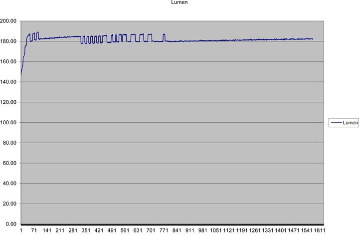

    js,
    You might also want to add in a link to bmstrong's current thread on revisiting the Classic PD. (I don't know about you guys but it's times like these that I really miss Bernie!)
    Back to the subject of the 3S McClickie lights and specifically the new 3S buck/boost converter I am using, a quirk in its nature has just come to my attention which I want to disclose. At this point I don't pretend to understand what is happening but it wouldn't surprise me if I never gain a good grasp on it. One of you recently purchased a Haiku XM-L from me and contacted me about the light flickering. I responded that this was not right or typical and requested the light be returned so I could identify the problem and rectify the situation.
    I anticipated that the problem would be obvious and that worse case simply replacing the light engine would bring about a solution.
    Knowing that I was looking for a flicker I was able to discern it but only after setting the light down so it was not moving and removing any other light in the room so I could concentrate solely on it. I wouldn't call what I saw a flicker. I could see what I would call a cyclic pulse in the intensity. This is something I had not noticed in working with this latest version of converter but in my defense it is not that obvious or blatant, at least in my perception. I also realized that this might not be unique to just this particular light and it's not. I built a couple more XML-LE's and confirmed that they too display this behavior. I am confident now that this artifact in intensity is inherent in the nature of the converter and possibly the programing of its control chip.
    I put one of the XM-L LE's in a Mule head and introduced it to my integrating sphere. I had the spectrometer software log the flux (lumens) with no averaging and scan sampling taken at 50 millisecond intervals. In graphing the flux on the y axis you can see basically a straight line and then a time segment where there is a flat sine wave repeating a number of times and then back to straight. In the sample tested, the low in the sine wave was about 178 lumens and the high around 185 lumens and the interval from low to high was around a third of a second to a half second in duration.
    I suspect that this artifact in intensity variation is a result of the converter compensating for change in heat and Vf but I will need to pass this information on through to the designer of the converter in hopes of getting a more informed answer and hopefully something I can understand.
    At any rate, I believe in all fairness and in the spirit of full disclosure I believe this quirk should be identified as a potential con as regards the buck/boost converter. In real use I would imagine this artifact would be viewed as a non issue for the most part but if the light is held steady and one concentrates on the beam and not what is being illuminated, it is apparent. I think my choice in words of calling it an artifact is appropriate here but that's just my opinion and perception.
    This quirk with the new 3S converter just came to light for me last night. I took a close look at a Nichia 119 LE using the same converter and was not able to detect any pulse in intensity but I haven't subjected it to the integrating sphere to see if indeed it is present.
    I suspect when the dust settles, this issue will be similar in nature to the PWM issue of the previous 3S converter in the sense that for some it is significant and for others, not at all.
    If I could speak Japanese I might be able to converse directly with the converter designer and possibly be more informed and even appear intelligent in discussing the nature of this converter with you guys.

    Don,
    So, after re-reading your post and running the numbers, it is my strong suspicion that this quirk or artifact is something that is pretty minor! I mean, obviously, I haven't experienced it myself, but a change from 178 to 185 lumens is only a change of 4 percent! And, you yourself couldn't even notice this until you set the light down so it wasn't moving and turned off all other illumination. Clearly this is something you would never notice in actual use! I mean, the 119 has a noticeable dark ring on the outside of the beam profile on a white wall, but it's never something I can notice in actual use. Same goes for the SunDrop. And these artifacts are CLEARLY noticeable.

    Don, based on your description of the intermittent sinewave pattern, it does sound like the circuit is periodically re-testing a range of voltages to determine the ideal one for the current conditions. There is a similar behavior in the GDuP drivers I installed in a few Lunasol lights, where significant changes in ambient temperature will cause the light to blink, adjust its brightness, and blink again the next time it's turned on. It doesn't re-test itself repeatedly while on, though, only once at the beginning. It's actually an incredibly useful feature and it allows me to install the drivers into a light regardless of which kind of emitter it has; if I could reprogram the current settings on my own, I'd just buy a batch of the drivers and never worry about finding a good driver again, just keep re-using the ones I have.
    Most likely the drivers you already have could be flashed with new software to remove the repeated re-testing if desired, or at least reduce the frequency to once a minute or something else more reasonable than once every few seconds, but only your vendor can say for sure.

    fyrstormer,
    I believe you are on the right track here and my understanding is that these converters are designed to allow for a variation in output current up to 10 mA. When the current exceeds 10 mA of current beyond the target level it steps in and corrects the condition. What can be seen with the XM-L is this correction process. To use probably a poor analogy, it's akin to a speed governor kicking it. I personally consider this quirk as an artifact of no significant consequence but am compelled to let it be known that it is there now that I am aware of its presence. Initially these converters were not programmed to evaluate a change in current to the LED as the Vf dropped by virtue of heating up and I saw the results of this on my bench and was able to measure the current to the LED climb significantly as it heated up. Now this was not apparent to the naked eye but something potentially detrimental to the LED and required addressing. If anything seeing the light level pulse is an indicator that the converter is monitoring the current to the LED and keeping it within design limits. Seeing this pulse in intensity is an indication that the converter is alive and well, as it were. I'm going to step away for a quick bench test...
    OK, I'm back. What I did was set my bench supply with a current limit at 600 mA and the supply voltage at 4VCD. I hooked up the bench supply to a XM-L mounted on a MCPCB. On initial fire up the bench supply was driving the LED at 600 mA with a Vin of 2.9 V. That is to say that this particular LED at room temperature has a Vf of 2.9 at 600 mA. So then I set the bench supply at 2.9 volts and went ahead and set the current limit at 1.5 amps. I attached the LED to the bench supply and watched the current to the LED grow from 600 mA to 800 mA, 37 seconds later. I shut the power off as I had seen enough.
    It is important to consider the fact that this test LED had only the MCPCB as a heat sink so it heated up quicker than it would with the MCPCB integrated into a Light engine and housed in a flashlight but the fact remains that the XM-L, Vf is significantly dependent on temperature as well as current. In a flashlight it might take minutes and not 37 seconds for this drift in Vf but the drift is still there and the greater you allow the current to increase the greater the difference in apparent output would be when it is brought back in line. It is my suspicion that other LED's may not have Vf drift as a function of temperature like the XM-L. Since the Vf drops as the XM-L heats up having this monitored and corrected is a good idea, IMHO and it's also cool that as the LED heats up, its resistance drops making it more efficient at generating light as it requires less voltage to maintain the same current level.
    If the designer of the 3S converter can come up with a program that will monitor the current to the LED in a less obvious manner than I will be receptive to a program change and implement such a change in a reasonable manner. I will also let you guys know if any change or revision comes about. But in the mean time I plan to go forward with what I have on hand and with the disclosure that there is now a known issue (artifact) in the sense of an apparent pulse type change in flux when the converter steps in and corrects for a temperature induced drift in LED Vf. To be clear, I have no plans on dismantling any existing light engines should a new program be developed because I don't think the fix warrants the surgery or shipping to and back from Japan.

    If the converter is in fact periodically recalibrating itself, perhaps the programming can be adjusted to perform the recalibration more slowly, and to start with an initial reading and then ramp the voltage up or down only in the direction that brings the current flow closer to the correct amount, instead of swinging above and below as it seems to do at present. That's how the GDuP behaves, so I have to imagine a similarly-complex circuit could be made to behave similarly as well -- minus the "I'm re-calibrating myself now" warning flashes at the beginning and end of the process.

    Quote Originally Posted by fyrstormer View Post
    Don, I was under the impression, from reading your post, that this correction was not happening as often as "once every few seconds." This is the relevant bit:
    i.e. when it is correcting, it adjusts a few times, with a heart-beat type pulse, each "beat" being a 1/3 of a second, but then it goes back to a straight line for however long. It's not like it's beating/pulsing every few seconds indefinitely, right?
    Please clarify, if you would.

    It would not be recalibration - that does not make sense to me from the strict meaning of what calibration means to me: to adjust the output and/or multipliers to match a specific/known voltage/current point, in order to minimize error/difference from part to part/circuit to circuit against the "golden standard" or theoretical value.
    However, the behavior you guys describe here does very likely sound like normal behavior (in general terms) to what any/all regulating circuits do. In this case (I am assuming it is a current regulated driver) the circuit is attempting to maintain a set current level, as the battery slowly drains, and as the vf of the LED changes (as Don stated above). But the regulator has some intrinsic step-size used to adjust the output voltage up or down to maintain the constant output current.
    My best educated guess based on my own experience with regulated drivers is that what you guys are seeing is the normal oscillation of the algorithm around a target output. The algorithm is going one step up and one step down, as it continuously adjusts the output voltage. Of course not knowing more about the driver makes it harder to guess if the step is hardware controlled or software controlled (as with my own regulator, but even then I am limited to the micro-controller that I am using), so it is hard to say if the step size can be adjusted, and/or how frequently/slowly this can/could be change/adjusted in order to maintain stability (it is after all a closed control loop): hopefully the circuit designer can tell/share with Don more about this behavior.

    js,
    We can all speculate on what is going on and some of you guys can do a more informed job of speculation than I but I'm not sure what that accomplishes. I certainly don't want to make a big deal out of this recently identified "artifact" for likely obvious reasons; namely because I don't think the artifact is much of a deal but more a curiosity.
    To answer your question though, I graphed the luminous output over time and from this we can guess what might be going on and see a representation of what light, in terms of magnitude, was coming out of the flashlight over the time period graphed. To make it easier, below is the graph itself:
    The y axis is lumens measured and the x axis represents scans which were about 50 milliseconds apart from each other so I calculate the graph represents a little under a minute and a half in duration.
    It is my understanding that the converter checks the current quite often and will not attempt a correction until the current is 10 mA above the set target level. On the very first fireup of the light engine, the converter goes through a calibration phase and sets its initial output voltage as based on Vf specific to the LED in the circuit. I believe that by the time the converter establishes this "starting point" the LED has had time to raise in temperature from room temperature and therefore a starting Vf is lower than what it really is at room temperature. I say this because I believe this explains why you see the initial lumens down below 150 in the graph. Now as the LED heats up, its Vf drops and we see the rise in lumens due to a constant current being provided to it coupled with a dropping Vf. At some point the Vf drops to a level that the Vin allows the current to rise in excess of the 10 mA ceiling allowed. We see three cycles starting at about 50 on the x axis where the converter makes adjustment and then the lumen curve straightens out but slowly rises due to temp increase and at about point 290 the converter again has to step in due to the 10 mA ceiling being reached again. It looks like it takes the converter fourteen steps in correction to stop the run away and then the lumen curve straightens out again and continues on until the end of the measuring period. You can see that the lumen curve is on the rise and no doubt due to the current slowly rising once again. At some point down the road it is likely that the current will again exceed the 10 mA ceiling and another correction will take place.
    I imagine that once the operating temp of the light stabilizes that no additional corrections would be evident as they would not be necessary.
    If I am reading this story correctly it seems to me that the best way to minimize the evidence of artifact associated with current correction would be to lower the ceiling allowed for current above target as this would presumably reduce the amplitude from low to high during the correction period. But I make assumptions here and it is likely that the converter would have to step in more often to make corrections. On the other hand, if the ceiling were increased the converter would probably have to step in fewer times for corrections but would these corrections be greater in amplitude and be that much more obvious?
    If anything, taking all this into consideration increases my appreciation for what these converters do as well as the designers who come up with them.
    Now if this artifact resulting from the LED heating up can be reduced with a programing change that would be cool but if it is what it is, so be it.
