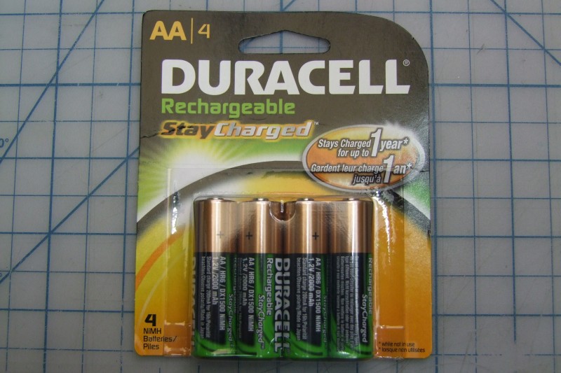

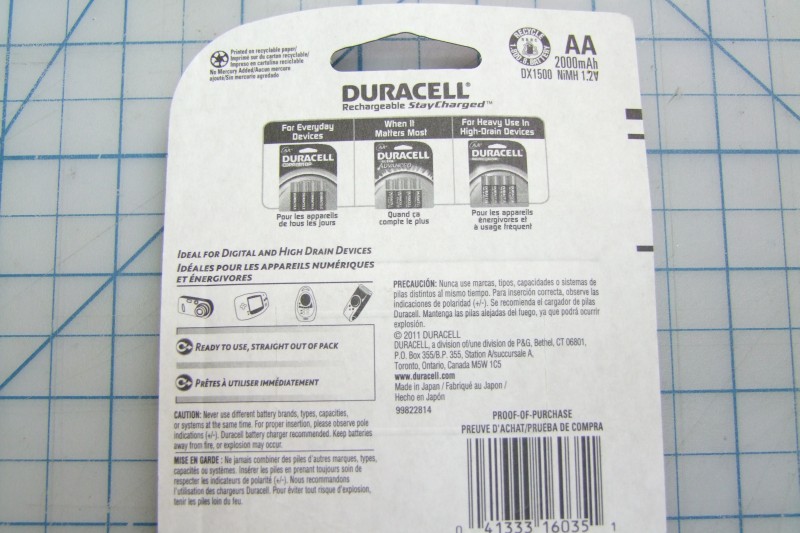

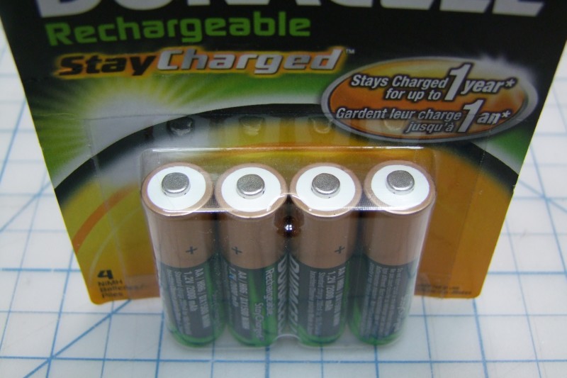

    Default Re: How green are you with your "used" AA cells?
    Quote Originally Posted by Lynx_Arc View Post
    Just do what a lot of us did that don't have local access to eneloops, buy white topped Japan made duracell precharged batteries.
    Quote Originally Posted by USACelt View Post
    I have seen them at Target and Best Buy for sure. But I'm sure most places that sell Duracell rechargable batteries will have them, Walmart, ect. The packages are marked, "precharged" and will of course have white tops. I have found a few white tops in with chargers. I'm personally watching to see when the newer Sanyos get sent out as Duracells.. The older versions have a white top, the new 1500 charge batteries have a grey top. No luck so far finding them.
    Finally!
    Cells came at 80% charged per ZTS battery tester, and voltage was 1.31 volts per my La Crosse BC-900U AA/AAA 4-bay charger. I am giving them a full charge now
    Also in the store was an almost identical package from Duracells, but with the dark grey tops (instead of white), but with the same identical part number (DX1500) but the marketing/package was different (plus they were more expensive as well). The dark grey package said "stayed charged longer" vs. the white tops that are branded "StayCharged" - again, they both had the same part number!
    Are the dark grey ones the new 1500 cycles model and the white top the older 1000 cycles model? (that would/could explain the price difference)
    Will
