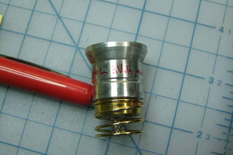

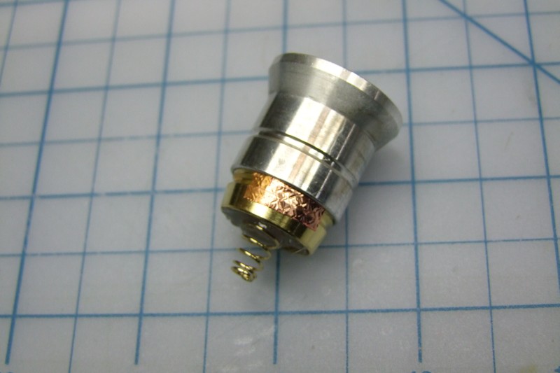

    First is the P60 drop-in. I bought a "kit" from Asia for the P60, so I started looking at what emiter would work well with the smooth reflector. I started with an older P4:

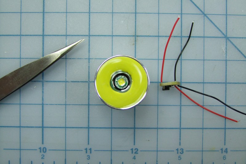

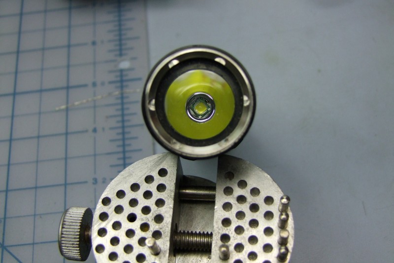

    But decided to use a more efficient LED instead. Looking at my parts bin revealed a neutral white XM-L, so I reflowed it into a datiLED 8mm board:
    When I tried it on the smooth reflector, I was able to get a great beam

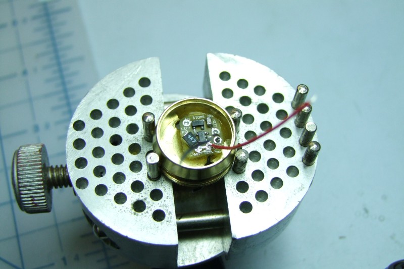

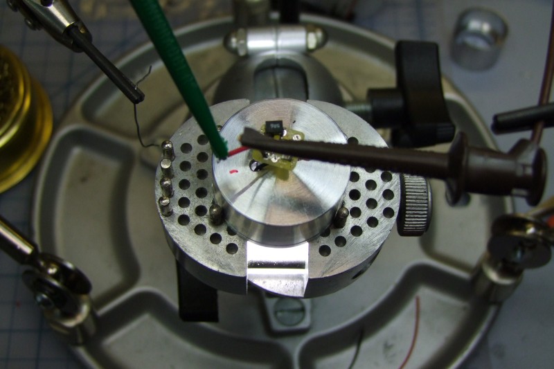

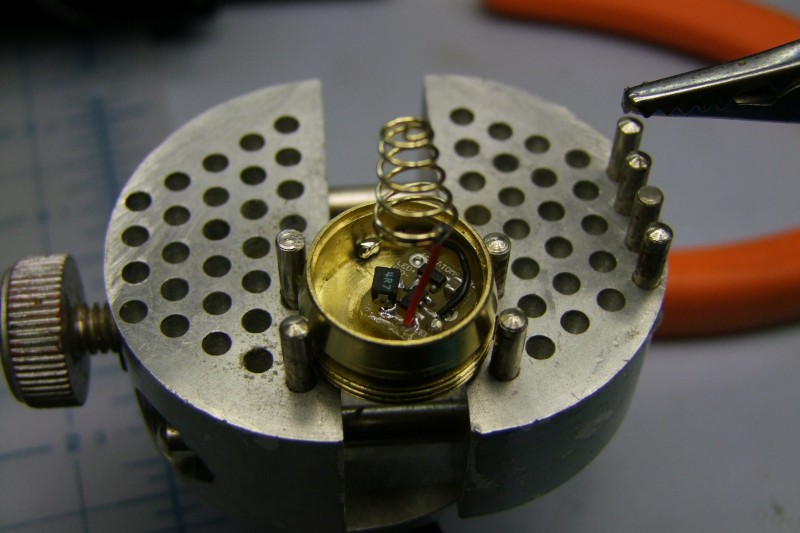

    So I soldered and epoxied the Joule Circuit on the back:
    And tried it with a few cells:
    I soldered a wire to the spring (Bat +) that comes with the kit:
    And simply (although not "pretty) used hot glue to keep everything in place - very solid, firm setup:
    The fit of the base to the reflector in these kits is horrible, so I used a thin piece of copper tape to set the focus to the right spot in a press-fit:
    And this is how it looks in the Solar Force host:
    Home made P60 drop in:
    Nice tint:

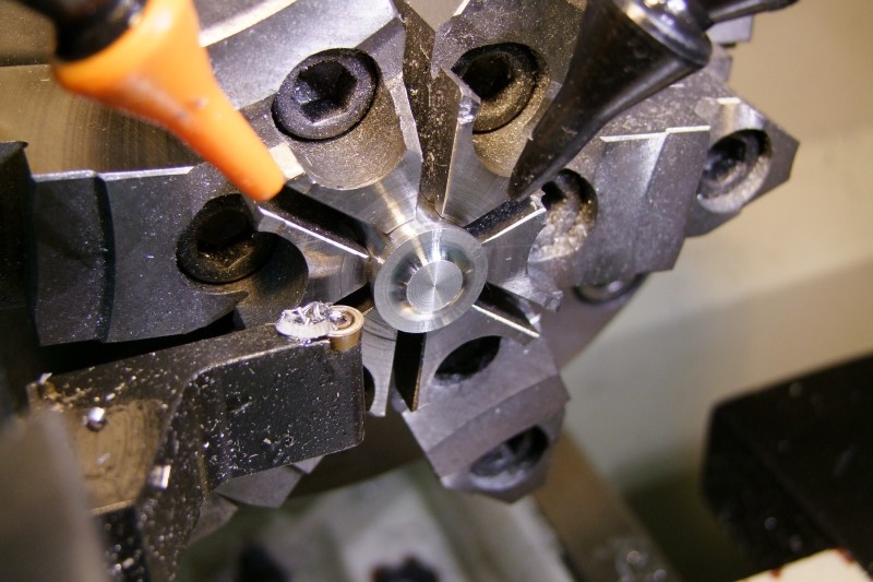

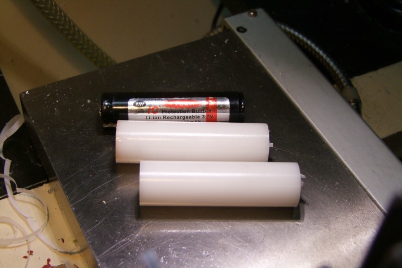

    I can use new or used CR123 cells, but since my circuit can operate down to 0.8 volts I decided to make an adapter/sleeve so that I can also use AA cells in this host:
    With an AA cell it was a tad shorter than an 18650 cell, but the springs more than make up for the difference:

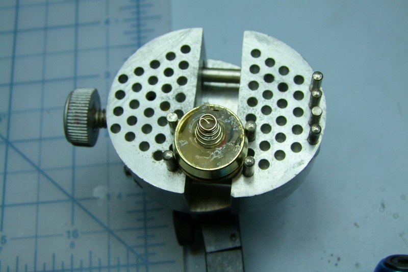

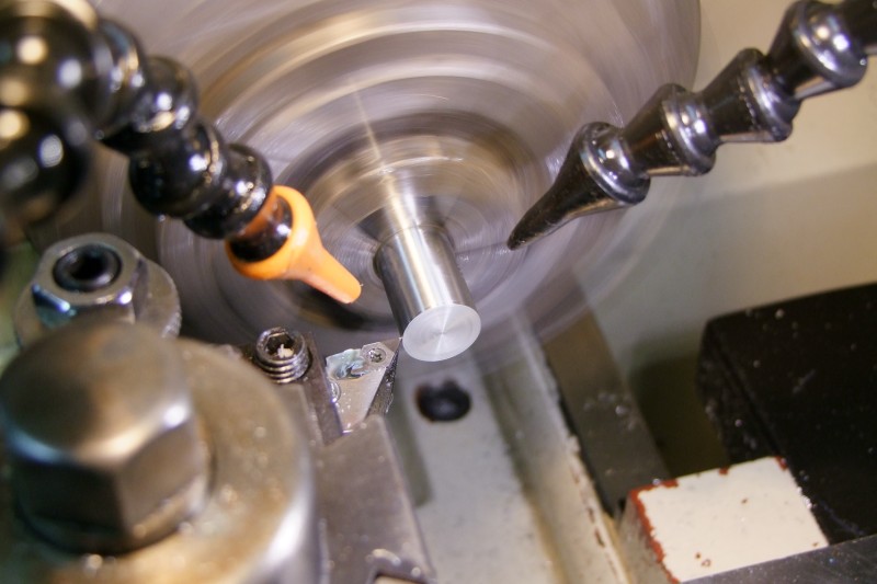

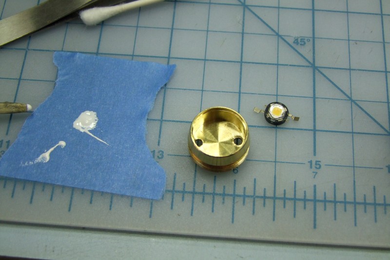

    The next light uses some really old 3W LED's that I got many years ago, but that were vf-matched to 3.5-3.6 volts), so I decided to build a floody light using 3x of these LED's, each driven by its own Joule Thief circuit, everything feed from 3xAA cells (using another of my own custom 1xD's as a host). Since I wanted to re-use parts I already had, and I did not have any reflectors for these weird looking LED's, I decided to modify a home-made Mag D P7 reflector and make a sort of "dish" reflector out of it.

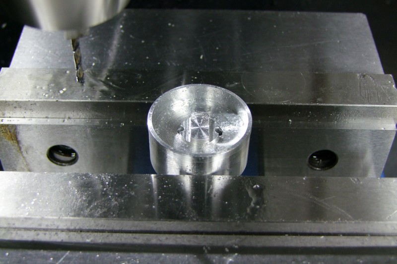

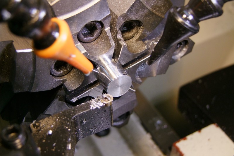

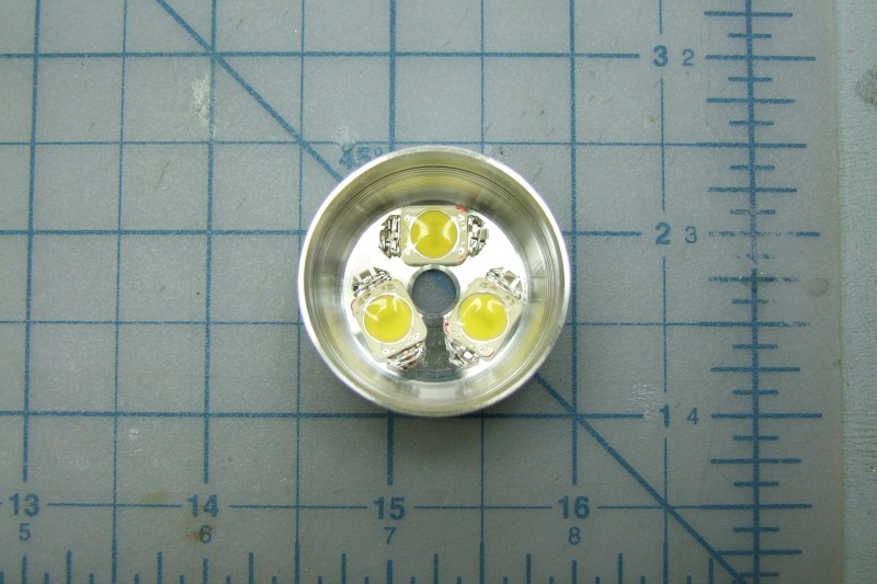

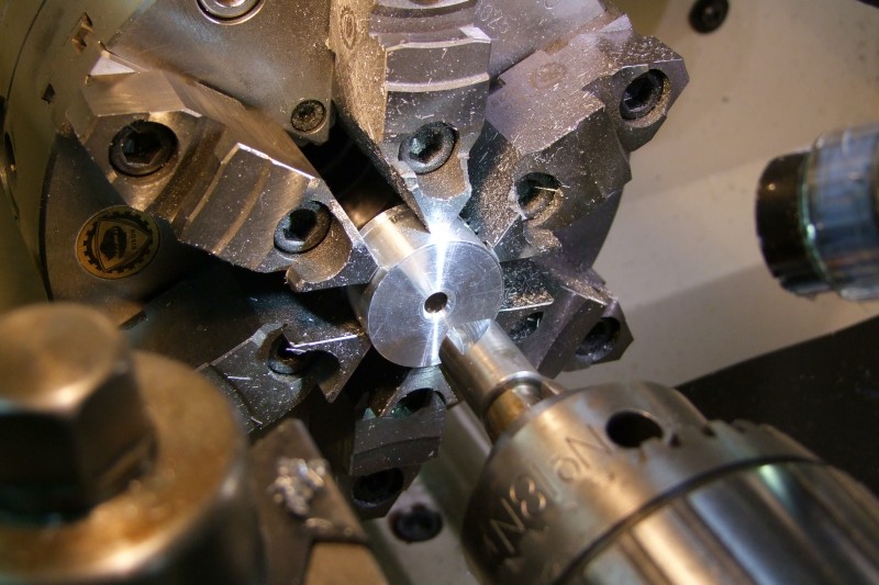

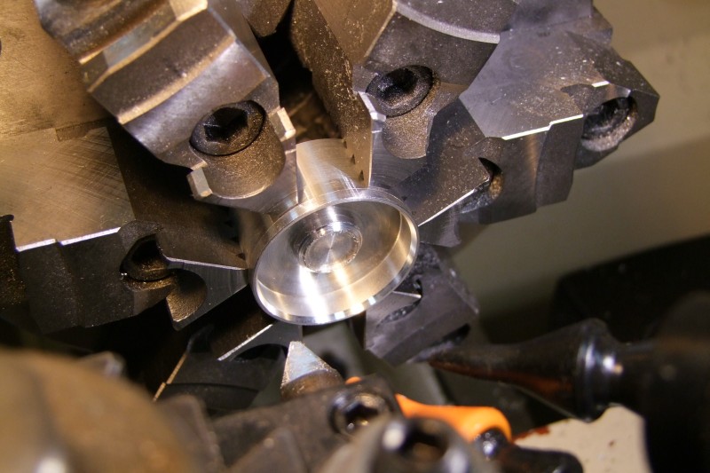

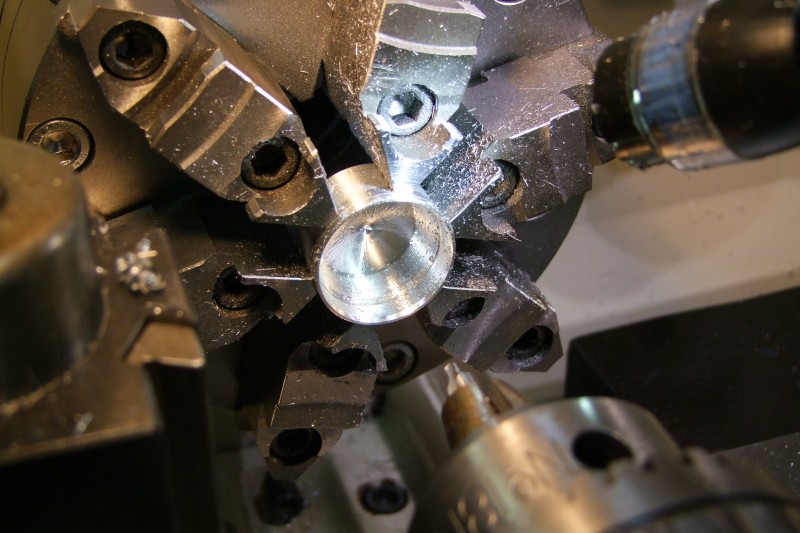

    I started with the P7 heatsink to hollow it:

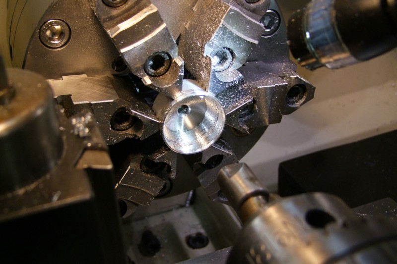

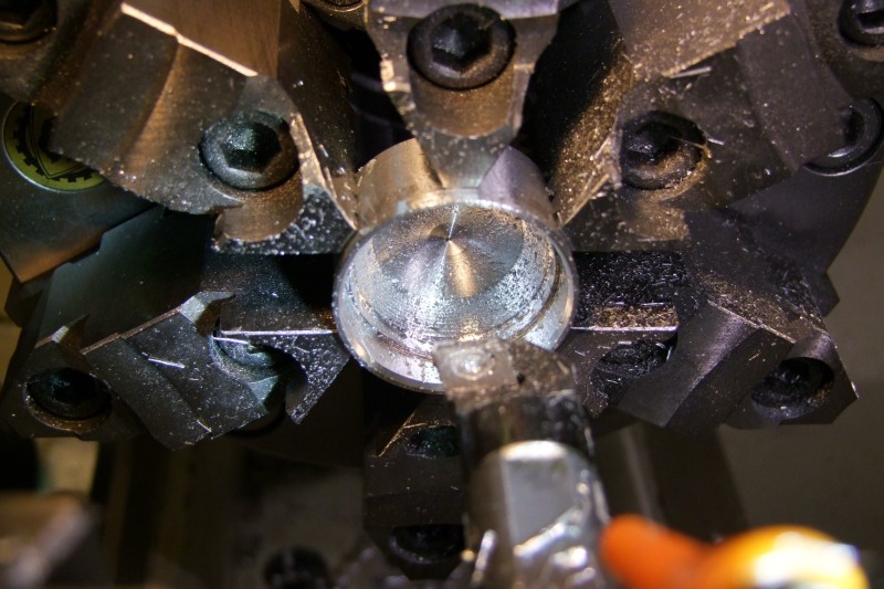

    It is hard to see in this picture, but I cut a lot of "facets" in the heatsink, going from outside towards the inside, using my very sharp PCD insert to achieve a polished effect on the Aluminum:

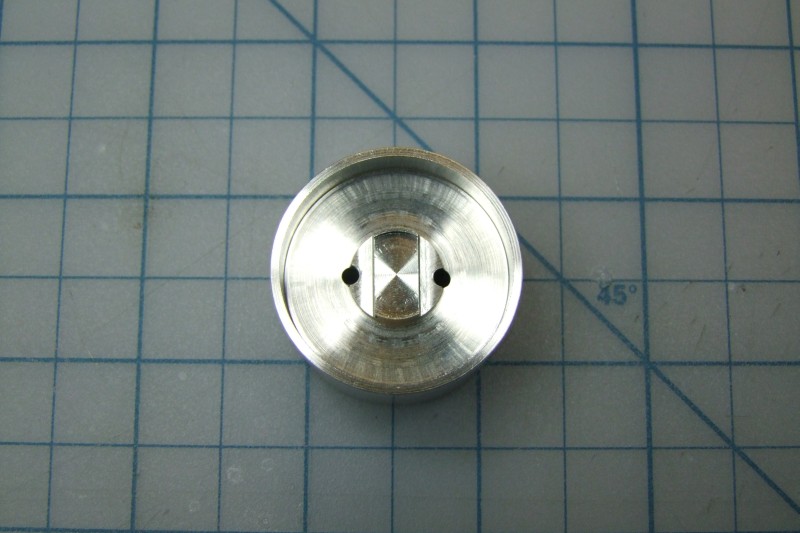

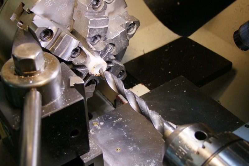

    Then drill and chamfer the hole for the wires on both sides:

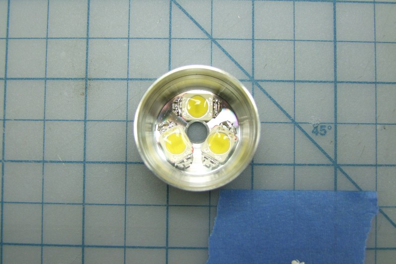

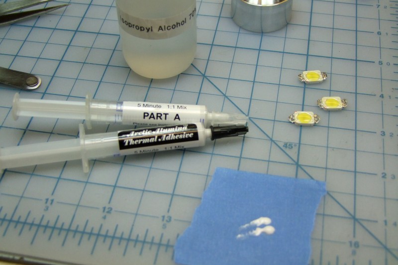

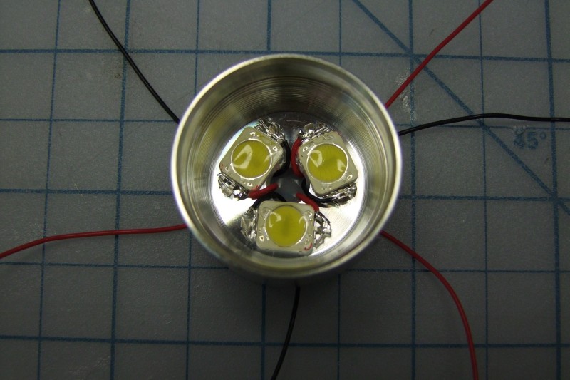

    I then did a dry fit to see how I can place the 3x "weird" emiters. Note that I had to cut/trim their wires to give me clearance:
    In this photo you can see a little bit better the facets in the heatsink - nothing too fancy but seems effective:
    I then proceeded to glue them:
    I then carefully solder the wires:

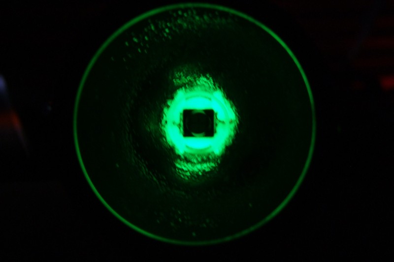

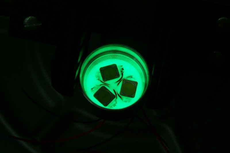

    And since this is going to be floody and very open, I put a good dose of glow in the dark powder with 2-part slow cure (30-min) epoxy:

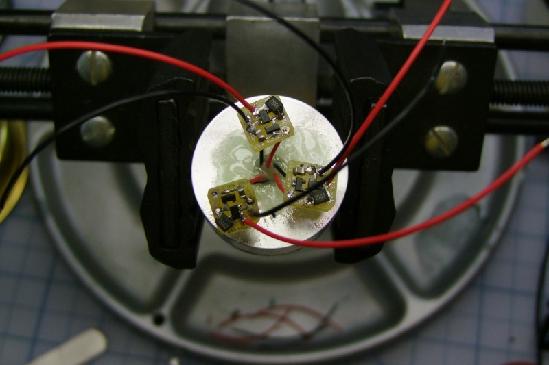

    I then solder each of the 3x Joule Thief circuits:
    And test it:
    Here it is running:

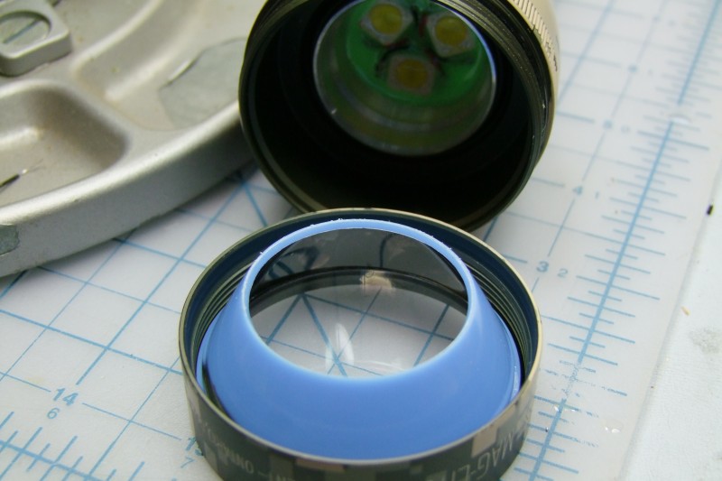

    Ready in the host (heatsink is a press-fit):

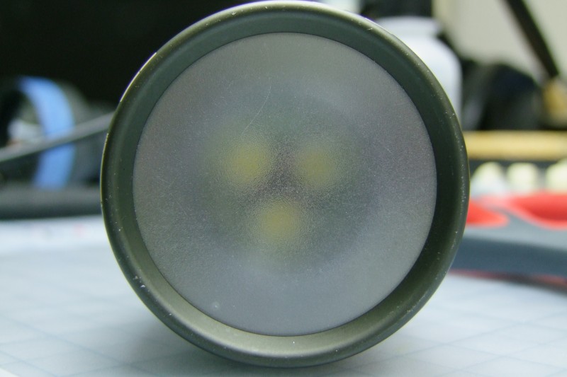

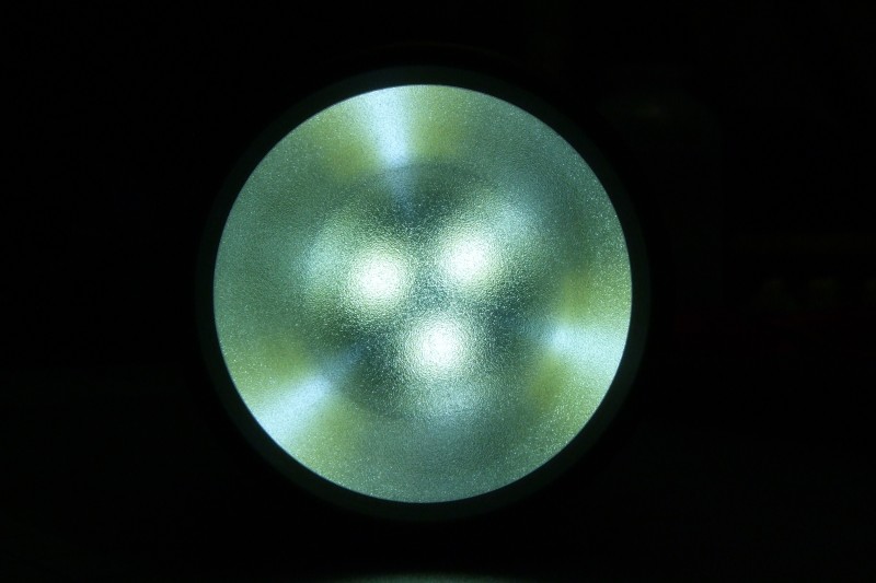

    I carefully cut/fitted the reflector so that it would line up over the heatsink, to provide additional "focusing" on the sides:
    Here is how it looks from the front after being turned off - notice how the heatsink reflects some of the light, as well as the cut Mag reflector:

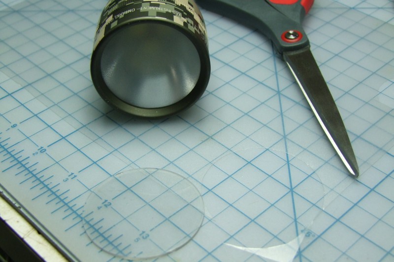

    Of course, in raw form the image is fairly "ugly", so I planned on using a diffusing film to even out things:

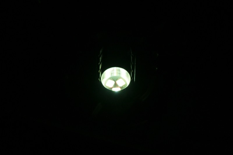

    Here it is OFF:
    Here it is ON:
    And although not quite focused, here is the afterglow:

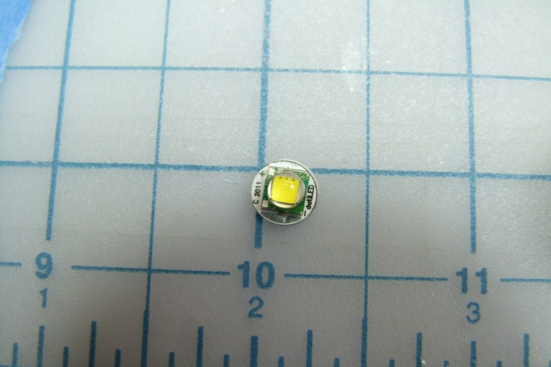

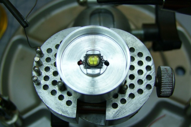

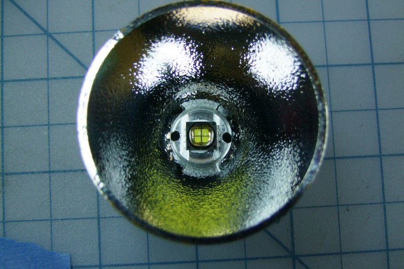

    OK, now for the last "emergency" light. I already had the floody light, so I decided I wanted one with more throw. So I decided in a neutral white MC-E, using another of my own custom 1xD's as a host, so it can be driven from a single D cell or a 3xAA adapter. First, I had to once again modify the P7 heatsink in order to facilitate installing the MC-E. Fairly easy on the mill thanks to the DRO:
    I am using a left over metal reflector for P7's that I had handy:
    So I prepared everything:
    And used the reflector to position/center the LED by eye as best as I could:
    I then solder wires:
    Wired a single Joule Thief circuit:
    Prepared the stock switch:
    Here is the finished product:
