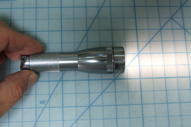

  5. #65
    Default Re: Couple of LED lights using Joule Thief circuits ...
    Alright! I finally got a solid working 1xAA Minimag working with the Joule Thief circuit
    That is excellent! I've been looking at your joule thief circuits and thinking of ways of putting them in a 2AA mag but always dreaming about a 1AA version.
    The picture says it all! No way I'll be able to that myself. If you ever offer this as a service, I'll be in line to get one.

  9. #69

  10. #70
    Lots of labor, all done on manual machinery. I would have to charge upwards of $100+ to even come close to breaking even
    Ouch, then again, I'm sure some collectors would hand over the cash. At times, the frustration of working with the size Zetec380 (don't know how similar it is to the 382), I've often felt like paying $100 for it. I've made some of the ugliest dead bugs
