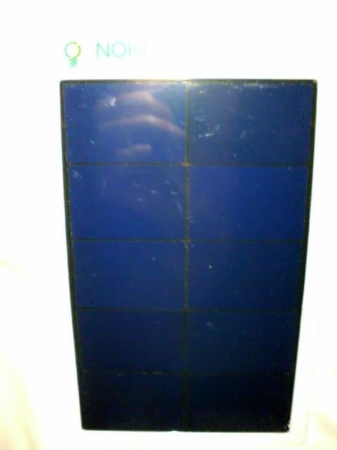

    They all use the same photovoltaic panels which is a high efficiency thin film that allows the capture of low light and as well as direct sunlight. This is nice as you usually have to make a choice between the two as past photovoltaic technologies were limited. I know its in the 20-22% efficiency rating and are manufactured by SunPower, which is one of the leading ones. This means that they will do the best all around job for charging as it depends on how big your device is what size you want to carry around. They are all compact as it varies from a shirt pocket to a back pocket which is nice.

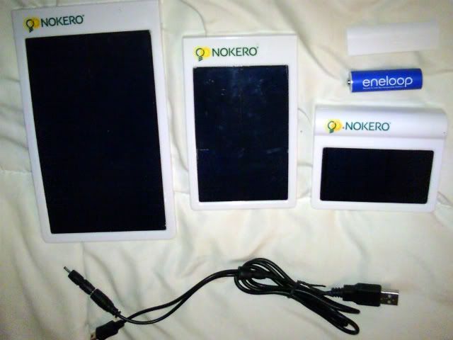

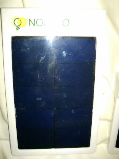

    I have done a small general review on each of the three products with pictures and they are listed below:

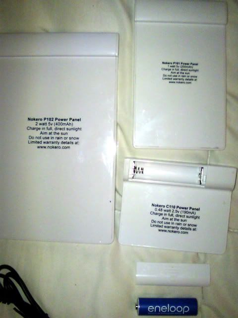

    Nokero P101 Solar USB Panel:
    Stated Specs: (Manufactures Website and printed on back of product)
    Voltage: 5V
    Current: 200mA
    Power: 1W
    Measured Specs: (Absolute best conditions so this is the best case scenario with sunlight and temperature 75F @ 1000W/M^2)
    Voltage: 5.29V
    Current: 230mA
    Power: 1.2W

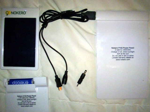

    This is their smaller panel that is geared towards smaller electronics like traditional flip phones(like the one I use) or electronics that have 3.7v li-ion 1000mah battery or smaller. It has a full size USB port at the top right of the panel and allows the use of any cord you might have as it comes with a nice cable with multiple tips. For charging indication it has a blue led that will tell you that the panel is capturing an ample amount of sunlight for charging, so this is a nice feature. It is light weight and thin so portability is possible.
    Nokero P102 Solar USB Panel:
    Voltage: 5V
    Current: 400mA
    Power: 2W
    Voltage: 5.30V
    Current: 450mA
    Power: 2.4W
    This is a little bigger panel as its going to do twice the work than the P101. It has the same features but is able to produce produce twice the current with little bulk added. This will enable the user to charge her or his device twice as quick in the same conditions. You should be able to charge a typical flip phone in 1-2 hours of sunlight, which is just as quick as some wall chargers. Then again when its hot out you have to make sure the device you are charging is shaded or not exposed to direct sunlight as you will ruin the internal battery(Li-ion etc.) of your device (VERY IMPORTANT & DANGEROUS).

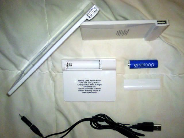

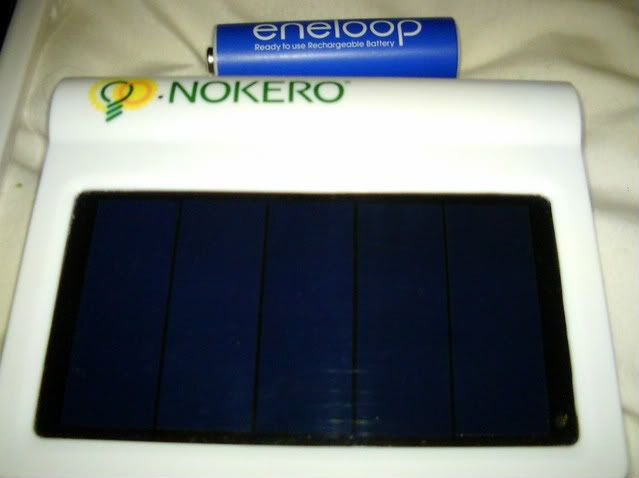

    Nokero C110 Solar AA NiMh Battery Charger
    Voltage: 2.5V ( I think they mean 1.5V not 2.5V)
    Current: 190mA
    Power: .48W
    Voltage: 1.42V
    Current: 200mA
    Power: .29W
    This has a nice form factor as its job is to charge one 1000mAh AA NiMh Battery in one days worth of sunlight. It has a sliding door on the back which is where the battery goes and is easy to operate. I used a AA eneloop battery and it had charged 820ma which is almost half in a days worth of sun without actively facing the panel to follow the sun. This is ensure that the device is seeing real world use as most do no track the sun, which is vital, to ensure shorter charging times.
