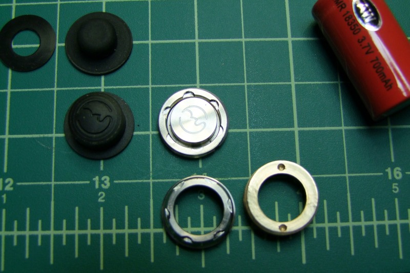

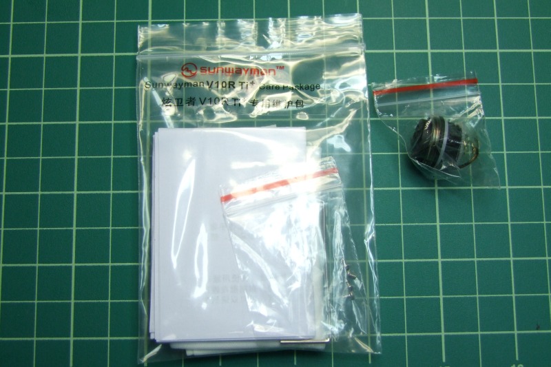

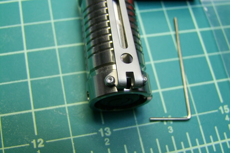

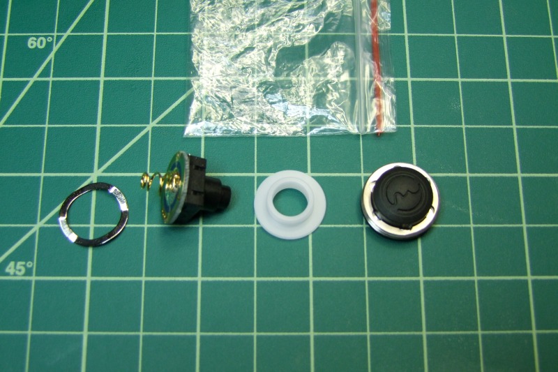

    Here are the kits I got in the mail yesterday.
    OK, here is the kit for the V11R:
    Detail of the new switch parts:

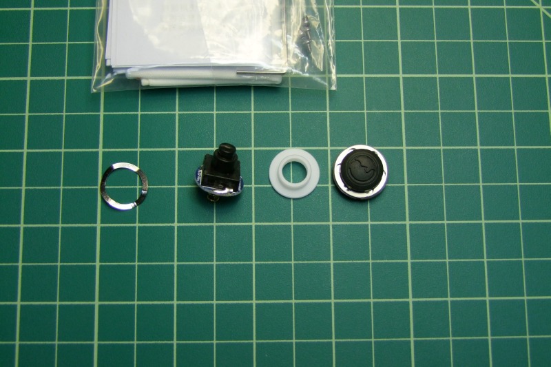

    Here is the kit for the V10R Ti+:
    Detail of the new switch parts (yup, same as with the other kit - which is expected):

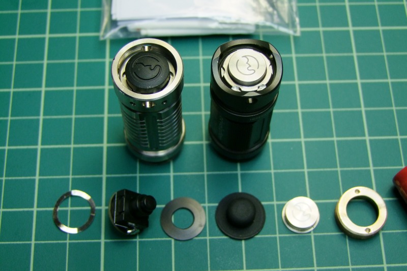

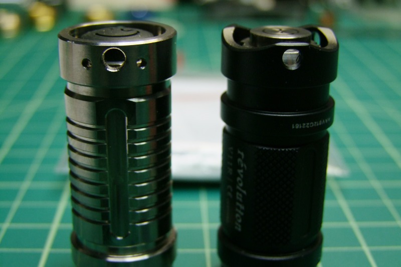

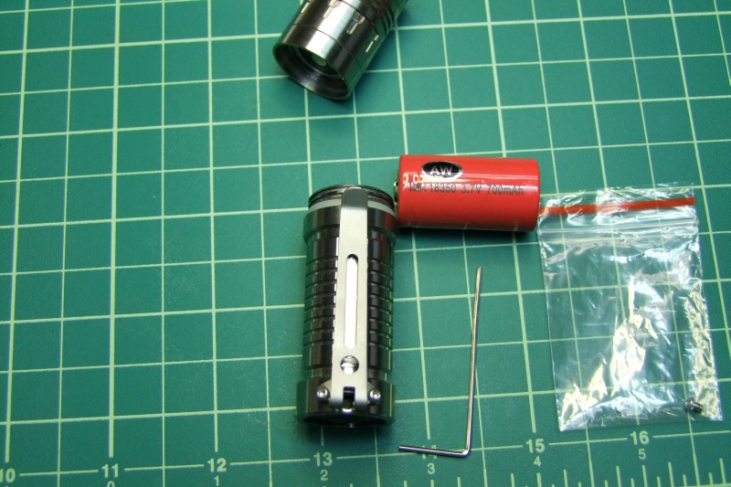

    New V10R switch parts on top, old ones (with my Bearing Brass ring) on the bottom - yes, host bored for the "fat" cell

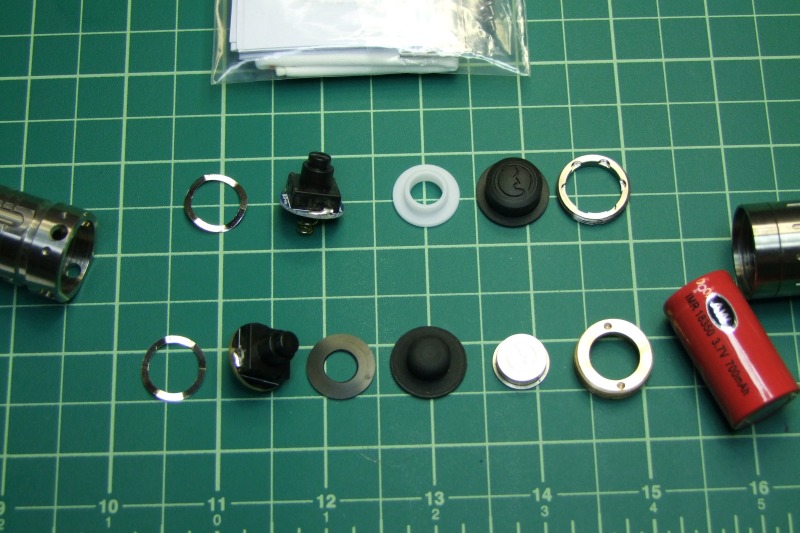

    I assembled the V10R Ti+ with the new parts, and on the right is the V11R "stock" (old/original parts):

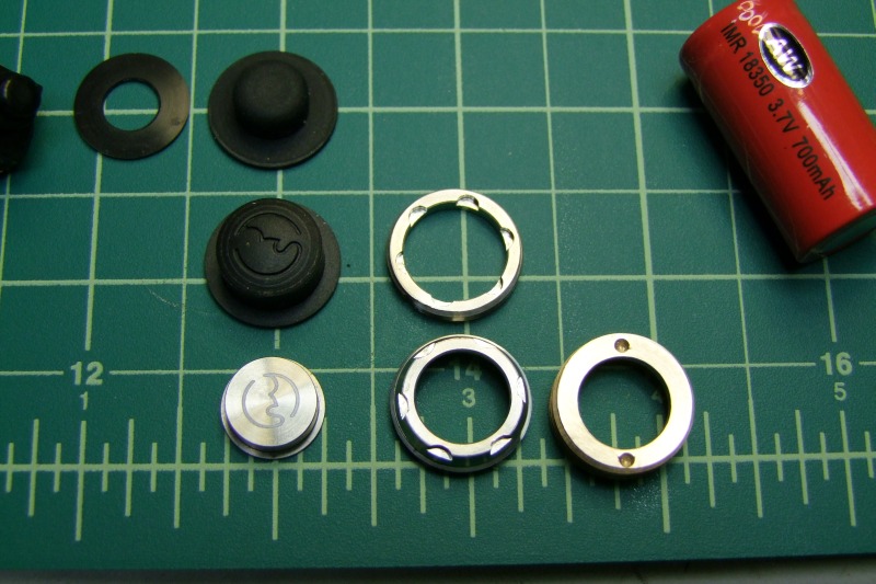

    Close up on the new (middle) vs. old parts (bottom):
    No, you can't use the old Ti button cover with the new retaining ring - the retaining ring's ID is slightly larger than the OD on the Ti button cover:
    Trying out the new screws on the clip:
    Will

    so, this should go without saying, but I'm sure your solution is infinitely better than the new "care package" SWM is giving out to owners?
    In the prior post I show the kits I got for my V10R Ti+ and V11R. I installed the new kit in my V10R Ti+ to test it for a few days, and so far I can say that the new rubber kits "do" work, in that there is no longer metal to metal friction, but the button press is longer now and needs more force than before and it does not have the neat metal button in the middle. So far I still like the feel/operation and look of the metal button cover and the Delrin replacement ring, but my solution (Delrin kit) is a lot more expensive than the free kit from Sunwayman.
    Which one is better? That is for each person to decide, but I feel the kit will be good enough for most folks (plus again, it is free) as it eliminated the single most frustrating part of these great lights - horrible sound from the original metal button cover and metal retaining ring.
