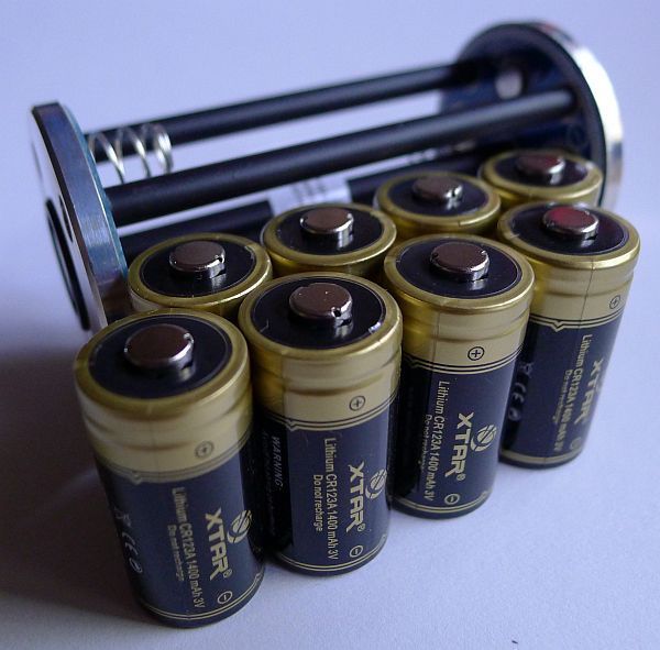

    Update - Using with CR123A cells
    As mentioned in the main review, the EYE30 can also run on CR123A cells, and with testing this in mind I have recently obtained a quantity of the reasonably priced CR123A cells made by Xtar.
    This is also an opportunity to see if the Xtar cells are up to the job of allowing the EYE30 to output its 2000 odd lumens.
    Lined up and ready to go next to the EYE30’s battery cradle
    And fully loaded..
    And the result is the full 1891 lumens, exactly as previously recorded using the AW 3100mAh cells.
    As the CR123A cells provide a slightly higher voltage, the EYE30’s battery meter shows higher charge levels than the 18650s. As the EYE30’s regulation is working well, it does not need to draw as much current from the CR123As as with the 18650s.
    The Xtar CR123As are rated at 1400mAh, so using them rather than 18650s gives you less overall capacity, but does give you the option of reliable disposable cells which will keep working down to lower temperatures than 18650s will.
    The EYE30 is optimised for 18650s as it has a cut off voltage of 6V, which will take the two banks of four CR123As down to 1.5V each (4S2P). Usually CR123A powered lights allow the cells to reach 1V, so once mostly depleted, you will likely need to work only at lower levels and the CR123As should still give you light.
    Look out for more testing of these Xtar cells coming soon.

    Just updated post 2 having got in a batch of new CR123As:
    http://www.candlepowerforums.com/vb/...=1#post3923572
