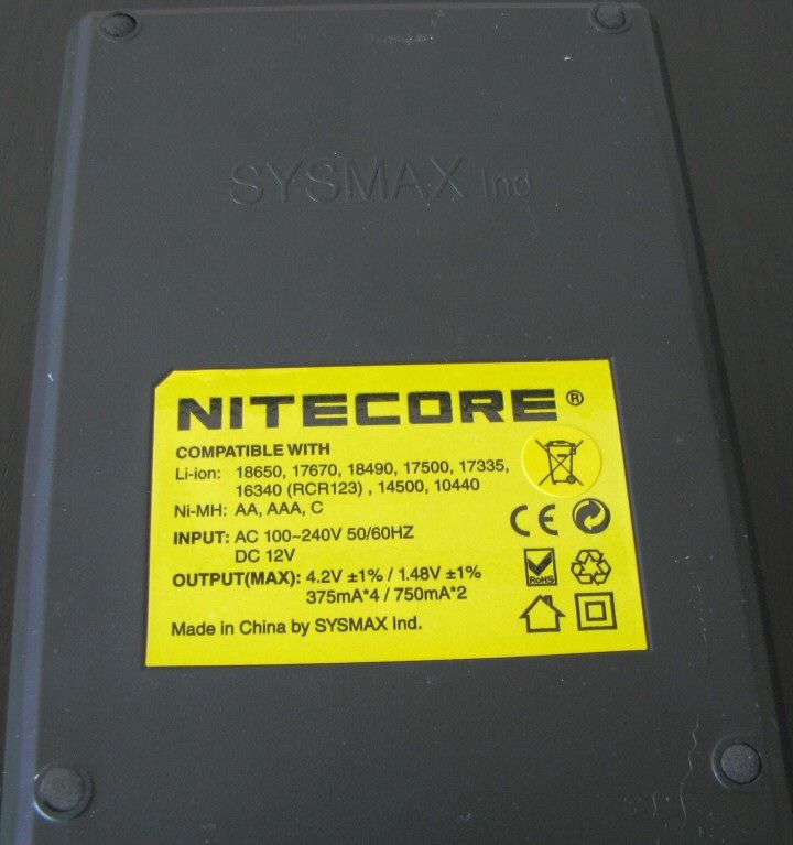

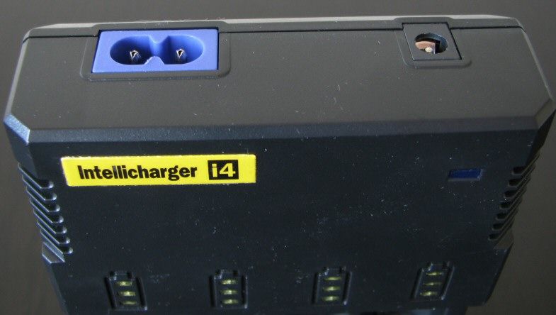

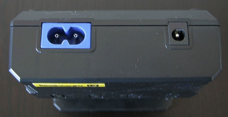

    My i4 V2 came with just a standard 110 AC power adapter. The unit supports 100 – 240V AC, 50/60Hz, so those outside of North America can use it fine (with the appropriate terminal plug). A 12V DC car adapter is available separately.
    The cabling and overall build seem good (good length on the cables, solid base unit). The battery trays are spring-mounted, and can easily accommodate any size from RCR to 18650 without spacers. However, I found the springs lacked lube on my sample, and a couple of them were very stiff to operate out of the box. You will likely need to add some lube yourself, which is an inconvenience for the general consumer.

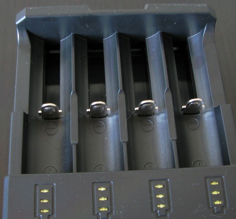

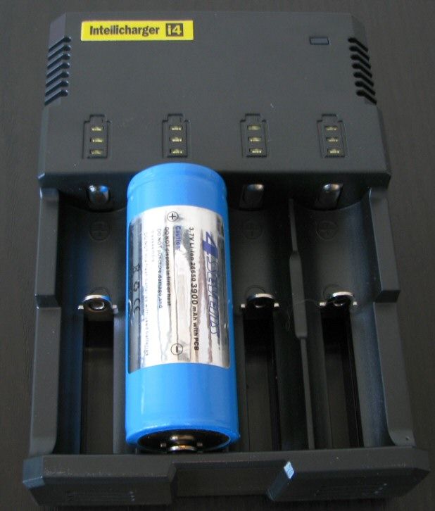

    As explained in the manual, while the charger has four bays, it actually only has two independent channels. If you want to charge two cells independently of each other (i.e., each charged at the full 750mA current the unit is capable of), you need to place the cells in bays #1 & #2, #2 & #3, #1 & #4, or #3 & #4.
    If you place the cells in the paired bays #1 & #3, or #2 & #4, the charging current will be split between the cells. Rather than just cutting in half (i.e., 375mA per bay), the current remains at 750mA for each bay – but it alternates charging by cycling off/on once every second for each battery. This effectively results in the same thing, but the cell is actually being charged at 750mA for a 1sec on, 1sec off, cycle.
    This is explained in the manual, but it would be good have the charger unit bays labelled somehow. Scroll down to see my actual testing results.
    Note: I didn't have the unit plugged in for these shots, which is why you don't see any of the indicator lights lit up.

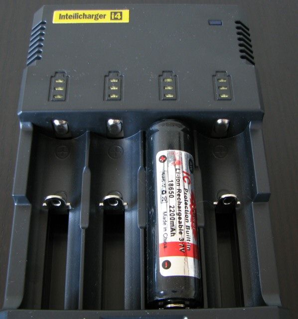

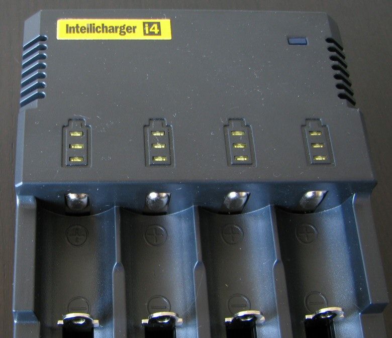

    There are three yellow lights located over each charging bay, and a blue power indicator at the top right hand side of the unit (lights up when AC/DC power is supplied).
    When you insert a battery into the charger, the three yellow lights over the bay indicate the charging status. One flashing LED on the bottom means the unit is charging, and the battery is less than 1/3 full. One solid on the bottom and one flashing LED in the middle means the unit is charging, and the battery is less than 2/3 full. Two solid and one flashing LED means the unit is charging, and the battery is more than 2/3 full. Three solid LEDs means the battery is fully charged and the unit has stopped charging.
    As you can see in the pics above, all standard battery sizes fit fine. I was able to get my longest high-capacity 18650s to fit (although they were a bit snug). I was even able to get the 26650 from my 4Sevens X10 to charge fine. I can't guarantee that all 26550 cells will fit, however (i.e., a smaller positive button on the cell may not be able reach to the positive contact plate in the bay).

    Default Re: Sysmax/Nitecore/Jetbeam i4 Intellicharger Review (V2): current/voltage comparison
    Thank you Selfbuilt....
    I am now a bit confused so please bear with me....
    My unit has a yellow decal on the front "Intellicharger i4" top left
    on the backside I also have a yellow decal that says "NITCORE"
    the output specs show 4,2v +/- 1%, 1.48v +/-1% 375ma *4 and 750ma*2
    no serial number
    This unit came with a two wire AC power cord not a wall wart cube.
    The AC cord is nonplarized and plugs into the blue AC socket on the charger.
    Using the charger I do not experience excessive heat or any noise or odors.
    The batteries charge is a reasonable amount of time.
    So.... you're saying the unit I have is version-2?
    and the original version-1 unit specs a higher charging current of 500ma? and 1000ma?-
    I look at various vendors and it's quite confusing as they show ver-2 as the higher current model.
    I also see some vendors showing the 375ma current spec
    I also downloaded user instructions from various sites and they discuss the 500ma rating
    my unit included a single sheet [both sides printed one side chineese] with the 375ma current spec.
    What is the reason for reducing the charging current?
    Thanks for your input

    6,936
    Quote Originally Posted by cactus man View Post
    That's right - you have the new V2 (375mA/750mA), and the manual online is for the original V1 (500mA/1000mA).
    I don't know why they dropped the current, but the charger now behaves as expected at the 750mA level.
