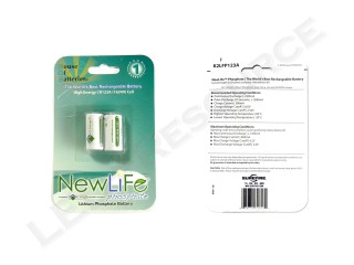

    These should be out soon...SureFire is waiting on packaging for the kit, and then it will be available on their website. I got an unpackaged kit of these and will post some pictures tomorrow. They're made by K2 Energy and are 600mAh.
    Flashaholic* Robin24k's Avatar
    Sep 2009
    California, USA
    1,753
    Default Re: Surefire Lithium Phosphate?
    Some pictures...

    294
    Interesting those pics have 2010 on them. I'll need to get a set I can never have enough batteries.

    Quote Originally Posted by ecrbattery View Post
    Quote Originally Posted by Robin24k View Post
    Some pictures...
    Okay... now I'm worried. Surefire's rebranding OEMs?
    Sep 2009
    California, USA
    1,753
    I don't know why, but yes, these items are not rebranded. Only the throw-away packing will have SureFire branding.

    Yes, for example SF123A's are rebranded Panasonic CR123's

    Default surefire rechargeable 123s
    just got an email from surefire. these look familiar. made here or china?
    Oct 2009
    Vancouver, BC
    1,171
    Default Re: surefire rechargeable 123s
    I just got that email too.
    Sep 2009
    California, USA
    1,753
    Both are Made in China. Cells originate from China, but are tested and packaged in the US.
