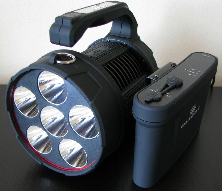

    This review is of the new high-output portable spotlight by Olight, the X6 Marauder.
    This light is distinctive for a number of reasons, including the 6x XM-L emitters and separate battery pack. Output is well into the realm of HID spotlights. Let's see how it compares …

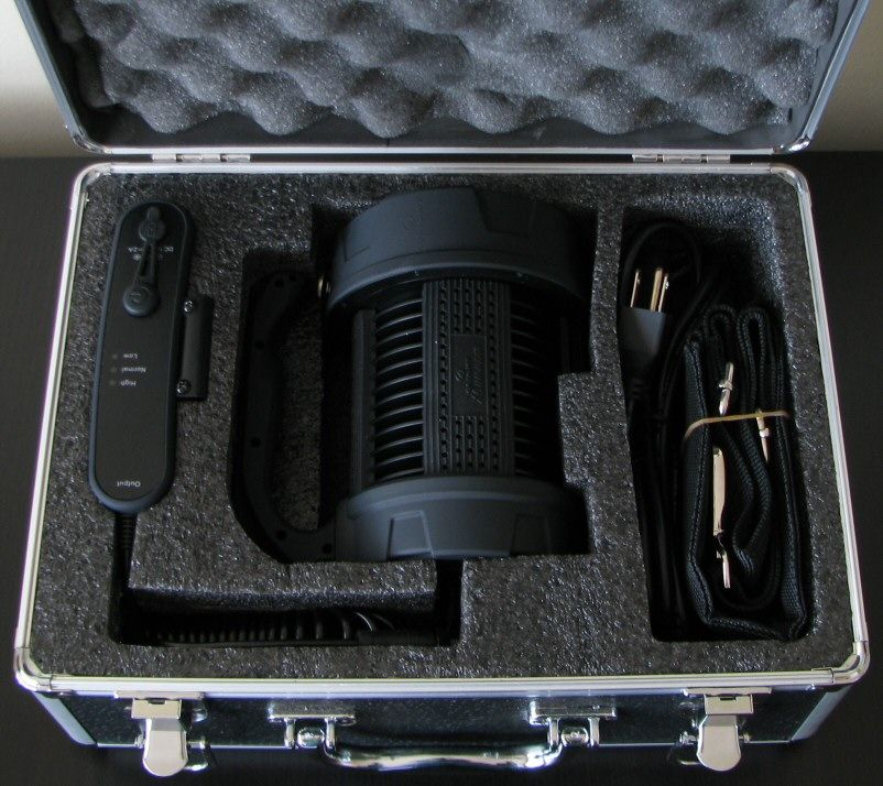

    As you might expect, the X6 comes in a high-end carrying case with cut-out foam. Included inside the case are the base X6 unit, battery pack, DC charging cable and transformer, AC adapter case, should strap and manual (not shown).

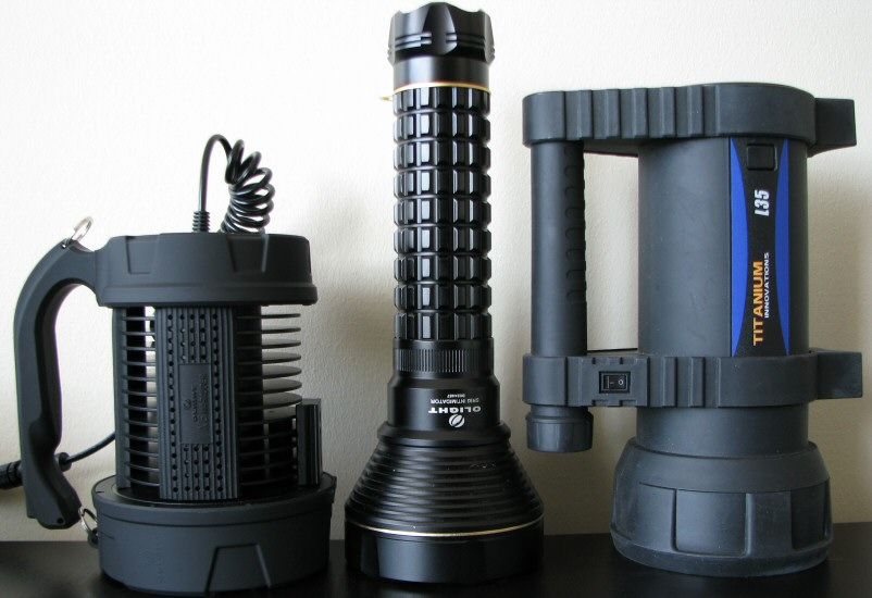

    From left to right: Olight X6, Olight SR92, and Titanium Innovations L35 HID.
    Olight X6 Base Unit: Weight 1.1kg, Length: 161mm, Width (bezel): 113mm
    Olight X6 Battery Pack: Weight 482g, Length: 144mm, Width (height): 100mm
    Other high-output lights:
    Titanium Innovations L35 HID: Weight 1.3kg, Length: 234mm , Width (bezel): 110mm
    Xtar S1: Weight: 876.0g (est. 1028g with 3x18650 protected), Length: 240mm, Width (bezel): 83.4mm
    Nitecore TM11: Weight: 342.6g (476g with 8xCR123A), Length 135.3mm, Width (bezel): 59.5mm
    4Sevens S18: Weight: 700g (800g with 6xCR123A), Length: 233mm, Width (bezel) 63.0mm, (tailcap) 25.6mm
    Olight SR90: Weight: 1.6 kg (with battery pack), Length: 335mm, Width (bezel): 97mm
    Olight SR92: Weight: 1.15 kg (with battery pack), Length: 271mm, Width (bezel): 98mm
    The X6 clearly falls into the size class of HIDs and other spotlights. As you will see below, so does the output.

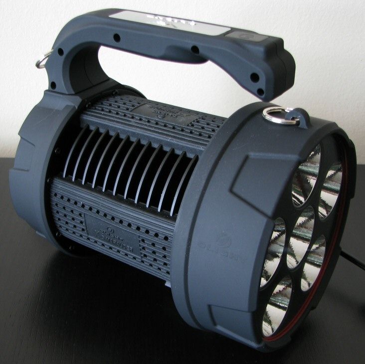

    The light features 6x XM-L emitters, each in their own textured reflector well (scroll down to the beamshots section for more info and close-up pics).
    The body has a rubberized grip coating over its exposed surfaces, which the manual describes as ABS with 20% carbon fiber. The core body and cooling fins are described as 6N01-T6 aluminum alloy with type III anodization (i.e., hard anodized). If you scroll back up through the earlier pics, you can see there is a lot space for air-flow over the cooling fins. Overall weight and feel is certainly good for the size, well-balanced when carried by the built-in handle.
    Note the weight of the base unit is still substantial (i.e., just over 1kg), which suggests the unit has good heat-sinking. The cooling fins are extensive and well-spaced, and allow a lot of air to move over the core of the light (the specs claim 140,000 square millimeters of exposed fin surface to transfer to air). Note there is also a built-in thermistor and the circuit will adjust output to manage heat levels. I will talk more about the thermal management under the runtime testing section.

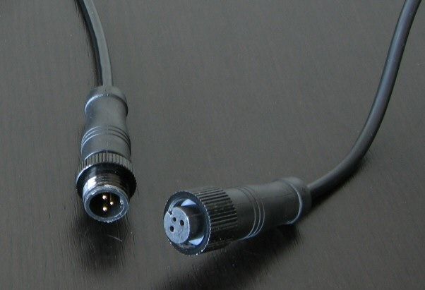

    There is a coiled cable coming from the back of the base unit, which connects with the battery pack. This allows for ~1m extension of the base unit from the battery pack (more on the connection aspect in a moment).

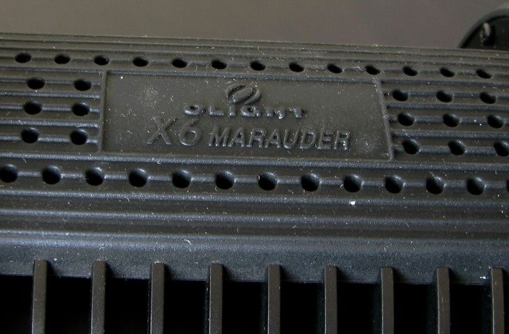

    Here are some close-ups:

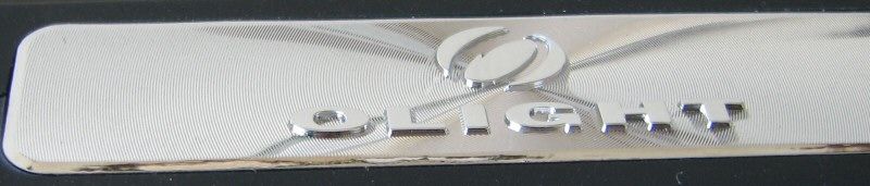

    Body logo:
    Handle logo:
    There is no printed labeling as such, but you can see the name and model number molded into the ABS sides of the light. There is also a shiny Olight label on the handle.

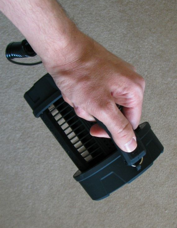

    Electronic switch on the handle of the base unit:
    The main switch on the unit is an electronic switch, with a fairly typical feel.

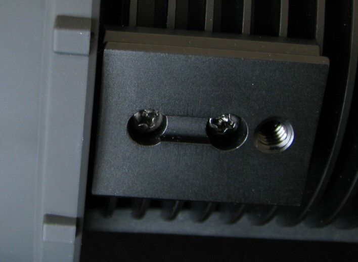

    Base/tripod dock:
    There is a solid metal base to the light, with a standard tripod mount.
    The light stands reasonably stably when laid on its base, thanks to two little protruding rubber "feet" under the bezel. I am not sure what sort of optional base holders will be available for the light.

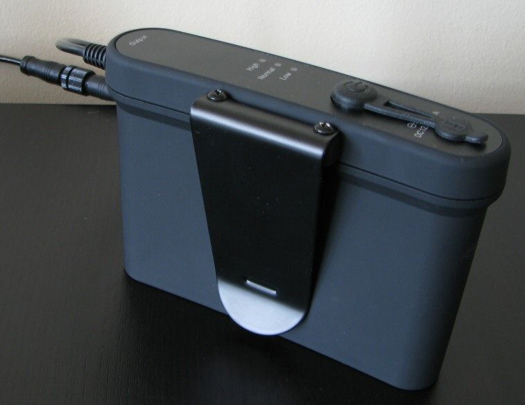

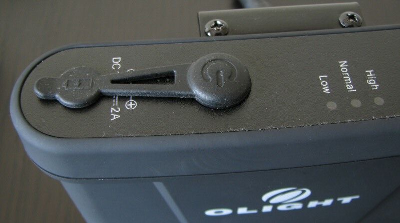

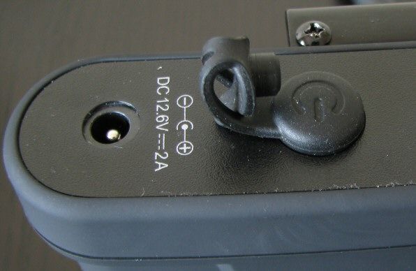

    And now the battery pack:
    The battery back is a solid unit, with again reasonable weight for the size (just under half a kilogram). There is a very substantial belt clip (although I recommend you wear a substantial belt to go with it, if you don't want your pants falling down),
    The button on the top is a forward-style clicky switch, with a solid feel and reasonable traverse. Attached to the switch cover is an extended rubber piece that covers the charging dock when not in use. A fairly typically looking DC-charging port is used for charging.

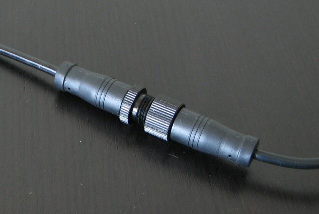

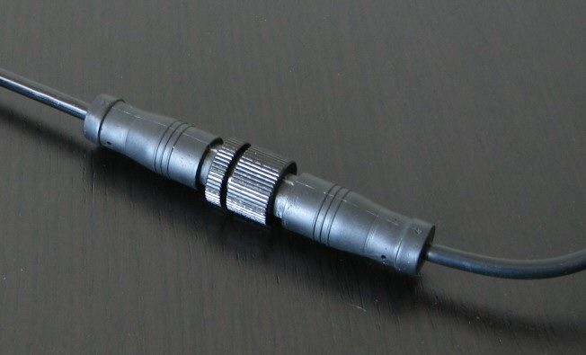

    Let's look at how the battery unit connects to the head:
    There are three little pins in the connector at the end of the coiled cable coming from the base unit. This connector mates with a corresponding piece coming from the battery pack. A pair of matching plastic screw threads on either end secure the two halves together. I will discuss this in a little more detail under the Potential Issues section.

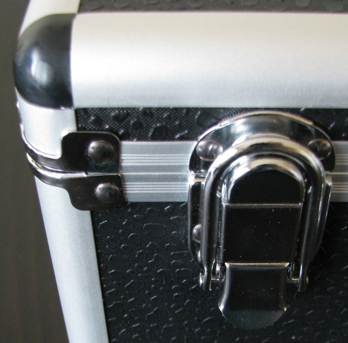

    Let's take a close-up look at the case:
    You can see metal hinges and metal closing clasps, similar to the other high-end Olight search & rescue style lights.

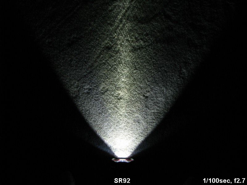

    And now, my standard white wall beamshots. All lights are on their respective max battery sources, about ~0.75 meter from a white wall (with the camera ~1.25 meters back from the wall). Automatic white balance on the camera, to minimize tint differences.
    Obviously, this is an insanely close distance that no one would be running the X6 at. But it does allow you to compare to other lights tested under my standard regimen.
    I am quite surprised to see how consistent a hotspot the X6 has at such a short distance from the wall.
    Note that the L35 doesn't fare well in the comparison above because it is more focused for throw than the other lights, and has a much wider spillbeam (i.e. the overall spill is dimmer, because it is spread out over a wider area not captured by the camera). This is illustrated below, using my famed "integrating carpet."
    As you can see, the X6 has a fairly even "floody" style beam for a multi-LED light (i.e. there is a lot of light in the spill, not just the hotspot). But it doesn't have as wide an overall spillbeam pattern out the front as a typical HID.

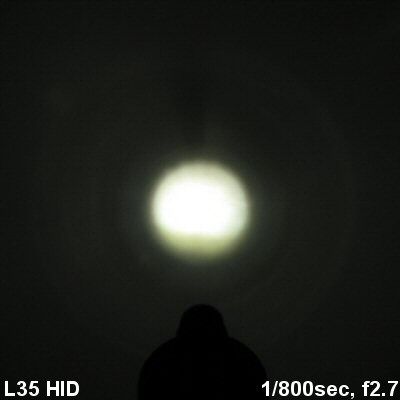

    For those of you wondering how it compares to the Titanium Innovations L35 HID:

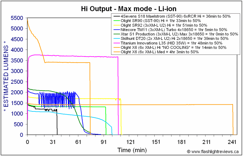

    Output/Runtime Comparison:
    Alright, this is going to take some explaining.

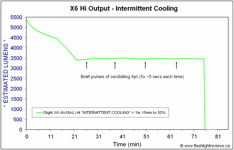

    To start, I ran a Hi mode runtime test under my standard testing regimen of constant cooling using a small fan. Note the output scale (y-axis) has been converted to estimated lumens to improve visual comparisons across graphs.
    The pattern above is what you would expect to see for a well-regulated light without a step-down feature.
    There is a slight drop-off in output over the first ~10 mins or so, as the emitters heat up. This is a standard aspect of how emitters work – their efficiency drops as they heat up (i.e., this has nothing to do with any circuit thermal control). Runtime was a respectable 49 mins at this level.
    But the X6 has thermistor to monitor real-time temperature, and the circuit is supposed to gradually reduce the output when internal temperature increases above 85 oC. Presumably, my cooling fan was keeping it too cool to see that.

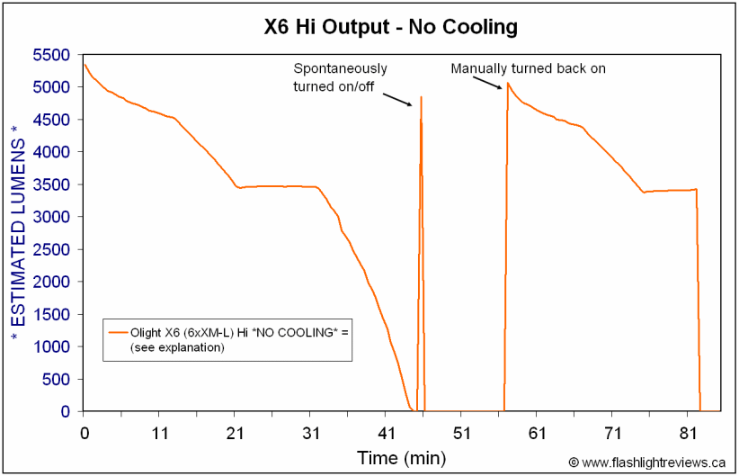

    So what happens if you run the light without any cooling whatsoever? Keep in mind, the corner of my office with no fan is NOT the same as running the light outdoors (i.e. this test is being done in a relatively cramped, small space with absolutely no air flow).
    Here is my first attempt with no cooling:
    To start, the first ~12 mins or so looks exactly the same as during the the cooling run. But starting at this point, the output gradually drops off in a visually-linear way until it levels off at ~60% original output by 20 mins into the run. This exactly what you would expect, based on the included documentation from the manufacturer (i.e., presumably the internal thermistor has exceed 85 oC at ~12 mins, and the circuit has limited output in a regulated way).
    What is interesting (and is likely due to my cramped office environment) is what occurred at ~31 mins into the run. At this point, the light had been stably limited to ~60% original output for over 10 mins. Now, it started dropping down in output in very discrete steps (you can't really see it in the trace above, but it was very clear steps). Over the next ~12 mins or so, the light stepped down all the way to off.
    After a minute or two, it suddenly came back on to original Hi output for a few seconds, then abruptly shut off. Touching it at this point, the head unit casing was quite hot. I let it cool down for >10 mins, until it was quite comfortable to the touch. I then manually turned it back on. It came on at Hi mode, and showed the expected early pattern (i.e., slow drop-off as the emitters warmed up, a gradual step-down to ~60% starting ~10 mins into the run). The light then ran until the battery was exhausted.
    The results suggest that the initial circuit-controlled step-down to 60% output was insufficient to keep the light operating <85 oC for the extended run in my cramped office.
    Since I know everyone will ask, I did a second run the next morning where I measured temperature concurrently. For the temperature probe placement, I attached it to the head of the ABS bezel, near the opening.
    Ok, this time it didn't shut-off, but stayed at the ~60% output level over the course of the entire run. I guess it was a little cooler in my office that day.
    Note that I'm sure the absolute temperature reading would have been higher off the aluminum fins. In any case, this pattern is exactly the thermal management that I would have expected to see, based on the manufacturer's reported specs.
    The surface temperature leveled off at just over 50 oC as the light output leveled off at its stabilized ~60% output level. But you can also see the temperature continued to slowly drift upwards over the course of the run at this level. Presumably, on that earlier run where the light shut-down, it got hot enough to trigger an additional shut-down routine.
    Note also that runtime with this single circuit-controlled step-down was 1hr and 14 mins, consistent with the manufacturer's reported specs.
    Since the cramped corner of my office is an unusual situation to run a 5000 lumen light (i.e., an indoor environment with no airflow), what should you expect to happen if you were carrying the light around outdoors?
    To test this, I set up an oscillating fan at 6 feet from the light, and gave a few very brief bursts of intermittent cooling once the first step-down had occurred:
    Note that my cooling regimen above is very, very mild. Each burst of cooling is just a few passes of an oscillating fan (i.e., the light is only getting a few seconds on each pass). Yet even this was enough to cause the output to start to rise slightly (look carefully at the output level after each arrowhead). As a result, I suspect more extensive cooling at this point would have allowed the output to climb back up to the max level.
    All this tells me that the internal thermistor and control circuit are exquisitely sensitive to temperature, and respond in a very dynamic, real-time way.
    Here is what it all looks like on the same graph, so you can compare to the other cooling states:

    • The blue line is what to expect if you had constant air moving over the light (e.g., riding with it on the top of your car or bike, always in motion)
    • The green line is what to expect if you are using the light outdoors - especially if you are walking around with the light, or there is at least some wind (i.e., typical usage where there is at least some normal intermittent air flow over the fins).
    • The orange line is what to expect if you lay the light down in an area with no air flow for an extended period (although you could potentially see a second drop-off if it is really warm in the surrounding environment).
    IMO, the thermal management feature of this light works well, and should help protect the light from damage.
    So, how does runtime performance compare to other high output lights? Here is Hi and Med, under typical cooling conditions:
    The X6 is definitely in HID spotlight territory. Compared my 35W L35 HID, the X6 is measurably brighter for the first 15-20 mins, then just slightly less bright for the rest of the thermally-managed run. Total runtime is less than the L35, but I presume the L35's battery pack has higher capacity (i.e., it is heavier, but I don't have specific mAh ratings for it).
    The X6's performance on its 5200mAh battery pack certainly blows away the SR90/92 (which is presumably based on a just slightly lower capacity pack of 6x 18650 cells). It also handily beats out the 3x and 4x 18650 solutions, such as the Xtar S1 and Nitecore TM11.

    The connection between the head and battery pack feels a little delicate. It would be hard to line up and connect the pieces in the dark. I would worry about damaging one of the little pins, but there is at least a physical guide inside the connector to facilitate the process. The securing screw pieces also feel a little light-weight. Note that while many may prefer a simple plug/dock interface, the tension on the coiled spring section of the cable would likely cause such a plug to easily pull apart. I can therefore appreciate that a screw-together style of connectors are likely required for this sort of cable - I would just like them to feel more robust.

    And here you go - outdoor beamshots have now been added to the review (quoted below).
    Note that these are done in the style of my earlier 100-yard round-up review. Please see that thread for a discussion of the topography (i.e. the road dips in the distance, to better show you the corona in the mid-ground).
    As you can see, on Hi the X6 has a lot more output than the other Olight S&R-style lights, or some of my other recent 3xXM-L lights. The X6 beam pattern is very even - a true "wall of light".
    It's fankly hard to capture just how crazy bright this thing is with conventional camera settings. In real life, it seemed to evenly illuminate the entire scene, from the edges of the periphery to the tops of all the trees.
    P.S.: I should mention that the air was a little misty last night (Spring in Canada ). So there is a bit more dispersion/reflection in the beam paths due to moisture than usual in these pics. It's hard to find a good, clear night with no wind, little cloud (or high ceiling), not too bright a moon, etc.

    Thanks for the review, looks to me X6 has blew the Titanium out of the water.
    I hope no owls or squirrels have come to harm during those shots.
    6,936
    Default Re: Olight X6 Marauder (6x XM-L, Rechargeable) Review: RUNTIMES, BEAMSHOTS, VIDEO + m
    Quote Originally Posted by Zeruel View Post
    I think any wildlife would have had the good sense to stay out of this particular beam path.
    But in fairness to the L35, it does have a much wider spillbeam (check out my "integrating carpet" shots in the main review). In this outdoor setup, a certain amount of light is lost outside of the camera frame - and more for the L35 than the X6, given its wider spill.
    Unfortunately, I settled on the current method for comparing single-emitter throwers, where everything is captured within the camera's frame of reference. If I had a second tripod with a suitable base for all the lights, I'd position them a bit more in the foreground (i.e. with the camera behind). That would allow you compare the max spillbeam widths for these floodier lights. But while I'm at it, I think I'm going to have to knock down the exposures a little too .. the X6 is definitely washing things out at this level.

    Do you know the capacity of the battery pack?
    Yes, the preliminary spec sheet I was sent lists the pack as "11.1VDC, 5200mAh Rechargeable Lithium Battery." I also understand from public comments by Olight that it is lithium polymer. But I have no additional details, and am waiting for official final spec sheet before updating that part of the review intro.

    Something I forgot to update yesterday - here is a comparison of the X6 Med mode to the Skilhunt DT-20, a 2xXM-L light that I estimate does very close to 1200 ANSI-FL1 lumens:
    As you can probably see above, it looks like the X6 Med mode is a bit higher than the 1200 lumen spec. On the basis of my ceiling bounce data, I would estimate the X6 Med is something closer to ~1500 lumens.

    Your specs indicate it would out throw the SR90 but in the pictures it appears the SR90 hotspot may be brighter. I know pictures can be deceiving so in real world tests do you see it out throwing the SR90?
    Thanks again for a great review.
    6,936
    Quote Originally Posted by 357mag1 View Post
    It's really hard to say.
    I don't think there is any real difference between the X6's 104,000 lux@1m and SR90's100,500 lux@1m. Note there was a typo in the original table - beam distances are 645m and 634m, respectively. That's only a 1.7% difference in throw, likely well within measurement error. Also, in terms of those lightmeter measures, one confound is that I do all my measures at 5m and work back. It's possible there lights would have benefited from 10m (or more), to really allow the beams to converge. But again, I don't think the meter would have found much of a difference.
    By eye, it is also hard to say. The very different beam patterns (and to an extent, the different relative tints) makes it hard to say with any certainty which throws further in this locale. I didn't go further out than 100 yards, and my best "subjective" guess is they were really the same at this distance.
    By camera, here's a way you can compare yourself - this is a crop of the higher resolution beam pics, showing just the center of the beams:
    Again, the tint differences make it a little tricky, but it really seems to me like the center throw is about the same.
    It is just a "gut" feeling at this point, but I think if you took the lights out to several hundred meters, the SR90 would have an advantage. That's just my personal experience with really throwy lights - I haven't tried it yet.

    Just a comment about your video, at 7:30 I think you mixed up the definitions behind DC and AC power. Cars run off 12-14V DC power, not AC.
    6,936
    Quote Originally Posted by trevordurden View Post
    I was making the comment that the light should run direct off AC or DC. The car comments refer to the DC power option.
    As yet, I haven't seen the accessories.
