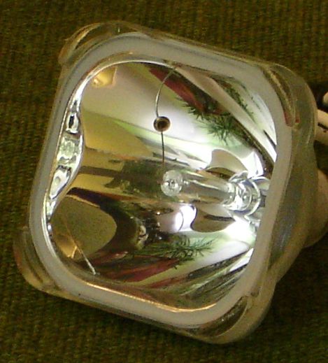

    Some time ago, by pure coincidence I got hands at
    - a 120W UHP bulb
    - including the invaluable ballast (Osram)
    And in connection with
    - a modified 24-30V/230V stepup converter, to provide the required 300V for the ballast
    - two 4S 14.8V 5Ah LiPos in series
    - volt warners
    - and a bunch of parts within reach for the chassis, the most prominent being
    - a nice green pvc sewer tube!
    ...I could start all this.

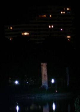

    Here's the long shot, looking along the Donau (danube river) in Ulm, southern germany, where I am located by the way,
    The distance to the higher white building in the background is about 635m/2080' (according to google earth)
    and the stone column below (located on an isle in the river and illuminated by default) about 315m/1030'.
    I couldn't see the EagleTac on the building anymore, so here's the far distance without it
    (ISO 100, 2 sec, F5.2, 23.7mm, earlier sony cybershot)
    635m -- control shot | POB 35W | home-made 120W UHP
    and here, targeting the column,
    315m -- EagleTac XM-L | POB 35W | home-made 120W UHP
    I'd say I'm more than happy with the result!
    Not until later, when puzzling with the pics, I noticed three guys sitting in the front of the stone column!
    (enlarged snippet),

    Perhaps a few more words about the bulb,
    specs
    . UHP (ultra high pressure), mercury vapour (instead of the automotive mercury metal halide type)
    . electrode gap 1.0mm
    . reflector about 60x53mm which corresponds to a circular shape of about 62mm diameter
    . power 120W
    . working voltage about 60V
    . 7000 lm -> ~58lm/W
    . light output typical (bundle lumen at 2.4m): 3200 lumen
    . working pressure ~200bar
    . colour temperature: CCT: 7600K, CRI: Ra 57
    killer features of these bulbs are
    - small electrode gap which allows for an astounding throw, given such a small reflector,
    - and very high pressure, which means broader spectral lines, and more red light
    which results in a nice neutral white despite the high color temperature
    It's an an Osram ballast and originally I had started with an Osram bulb, too.
    However, it was an elliptical type by accident and I ended up with a parabolic one from Philips.
    Thanks to Ot10St! who is responsible that I was able try such a build at all.

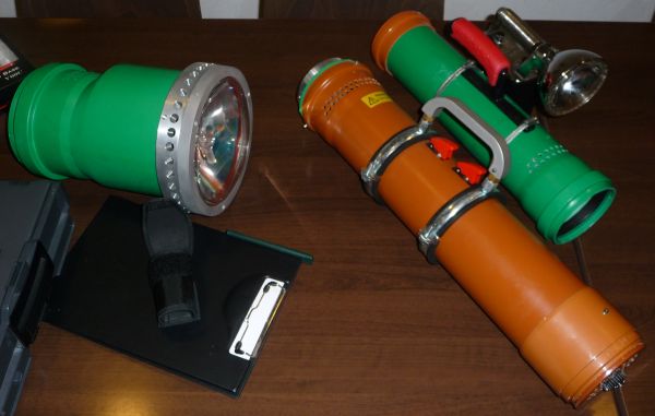

    Welcome on board Sven m, did you purchase the German sewer pipe from Ot1st?
    Here are some pictures he posted on CPF a while ago.
    By the way, if you are in contact with him, please tell him to come back to CPF & check it out,
    he donated a 260W ballast to me a years ago, I finally finished my light with it. What a nice guy!
    http://www.candlepowerforums.com/vb/...260W-Short-Arc
    My Mods.. http://www.candlepowerforums.com/vb/...5&postcount=78
    thanks. hehe - no, pure coincidence. I already knew his 300W light, got the inner parts for mine,
    didn't really like grey or brown tubes from the hardware store,
    and then "found" my beloved green tube on a construction site (in a lattice box with clipping parts)!
