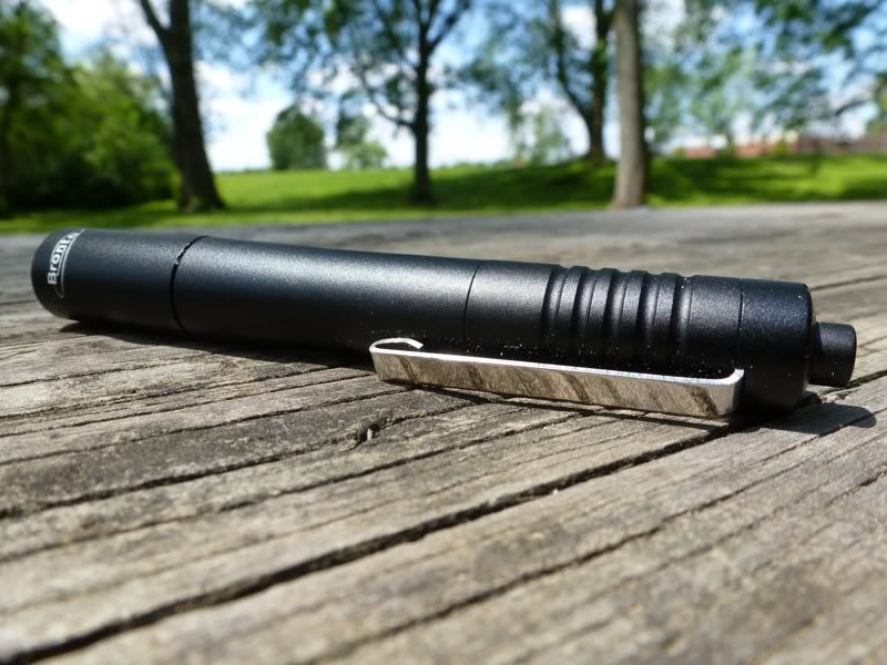

    A few ridges cut into the tail of the light give it a little bit of grip and style. The clip and clicky switch seem designed to resemble those of a pen, so that when clipped in your pocket it can pass as an ordinary pen.
    Also, the clip is removable by hand, with no tools, if you so desire.
    Simple unscrew the end of the tail and pull out the clip. To put it back in, unscrew the tail again, put the clip on, and make sure to line it up with the notch in the tail as you screw it back together.
    There are no flat parts on the body, it's completely round. So, if you choose to remove the clip, you will have no anti-roll and very little grip.
    Being designed to resemble a pen, this light is prevented from a stable tail stand by the switch. The end of the switch is flat, so the RA02 will do a tail stand if you are very careful, but it will fall over very easily, so it's not much use as a candle.
