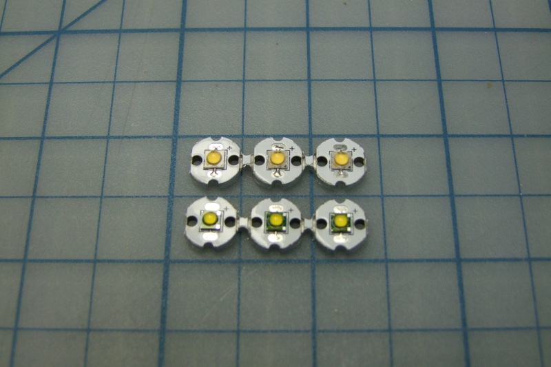

    By the way, here I have some Nichia 219 and Cree XP-G that I reflowed into the same 10mm XP-G boards - Nichia on top:
