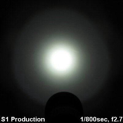

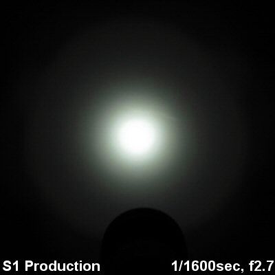

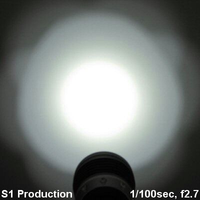

    And now, what you have all been waiting for. All lights are on their respective max battery sources (3xAW protected 18650 for then TN30/31), about ~0.75 meter from a white wall (with the camera ~1.25 meters back from the wall). Automatic white balance on the camera, to minimize tint differences.
    Output is slightly greater initially on the TN30 than most of my other multi-emitter lights. Scroll down for a comparison of estimated lumens.
    Also as expected, the overlapping emitter wells produce visible patterns in the spill. This is particularly noticeable at close-range distances.
    For outdoor beamshots, these are done in the style of my earlier 100-yard round-up review. Please see that thread for a discussion of the topography (i.e. the road dips in the distance, to better show you the corona in the mid-ground).
    The TN30 produces a lot more light than the TN31 (1xXM-L), with a wider spillbeam. But it lacks the dedicated throw of the more focused TN31.
    The TN30 has more output than my other 3xXM-L lights (at least initially). Scroll down to my Summary tables for more details on relative output and throw.
