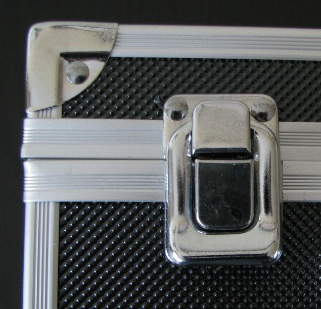

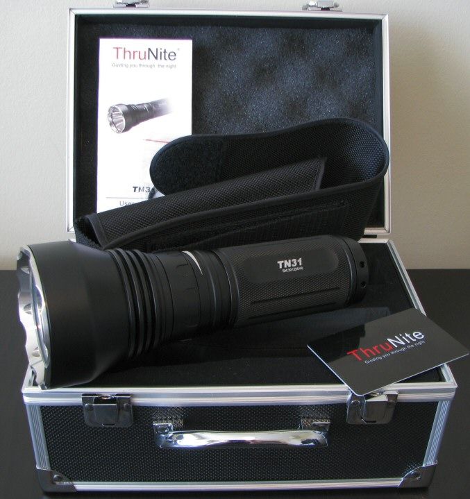

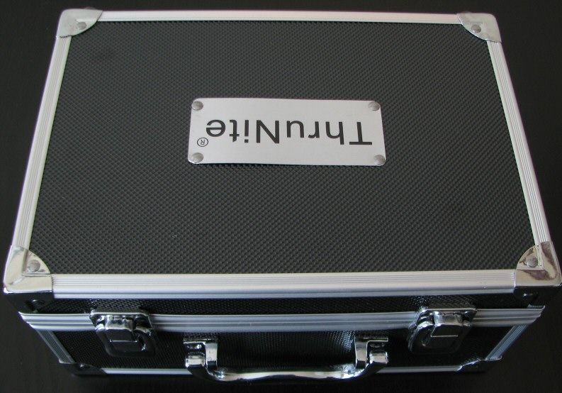

    The TN31 production version sent to me came in the full presentation case, with metal hinges and closing flaps. Inside were the light, belt pouch, wrist lanyard, manual, warranty card, and extra o-rings and spare boot cover. Note the case is larger than the TN30 that I have recently reviewed.
    Also, the cut-out foam had a noticeable acrid smell when the case was first opened, likely due to some sort of outgassing that had built-up inside the sealed case. It took several days of leaving it wide open before it dropped to undetectable levels. My TN30 sample case was affected by this too, but to a much lesser extent.

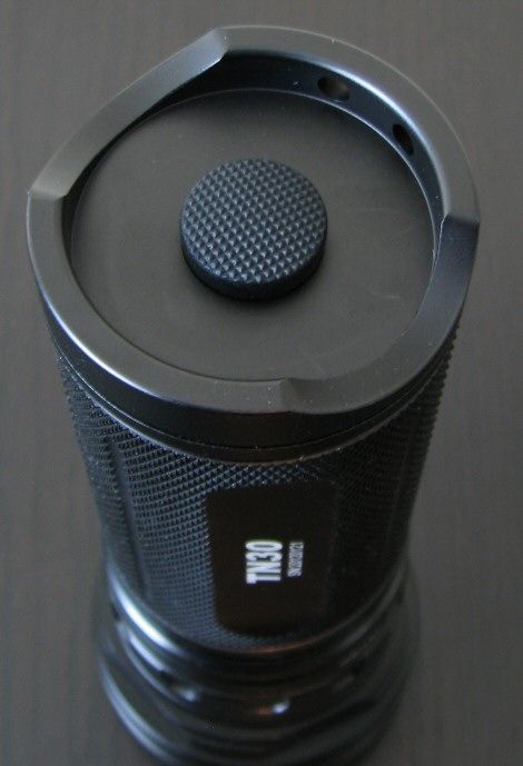

    Thrunite TN30: Weight: 468.2g, Length: 179mm, Width (bezel): 64.3mm, Width (tailcap): 49.0mm
    Thrunite TN31: Weight: 572.1g, Length: 203mm, Width (bezel): 79.0mm, Width (tailcap): 49.0mm

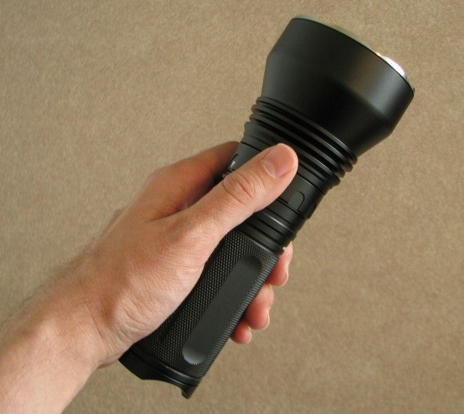

    The TN31 is a substantial light, closer to many Search & Rescue style lights than typical 2x18650 "thrower" lights.
    Let's start with the case:

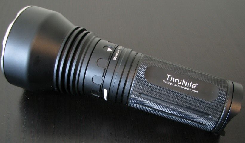

    Anodizing is a glossy black, and seems to be good quality – no chips or damage on my sample. Labels were sharp and bright white against the black background. Knurling is fairly aggressive on the handle, helping with grip. Scroll down for a discussion of the control ring feel and use.
    Screw threads are anodized for head lock-out. Threads are standard triangular cut, but seem of good quality.

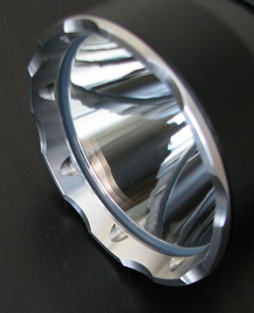

    Light has a scalloped stainless steel aluminum bezel ring. For more details on the reflector, scroll down to the beamshot section of the review.

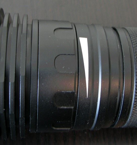

    Here are some close-up shots of the control ring:
    There are slight indents on the control ring to help with feel. There is a label mark on the control ring that lines up with the labels on the head. The six constant output modes are not individually labeled, but there is a graded output bar pictogram over the first four levels (i.e., shows the direction to turn to raise or lower the output). There are firm detents at each level, with a slight click as you enter into each one.

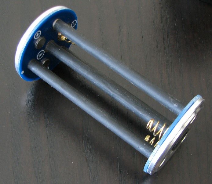

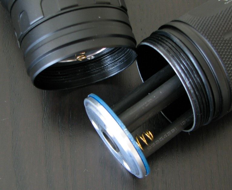

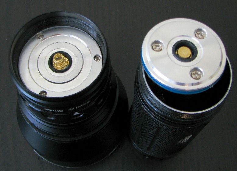

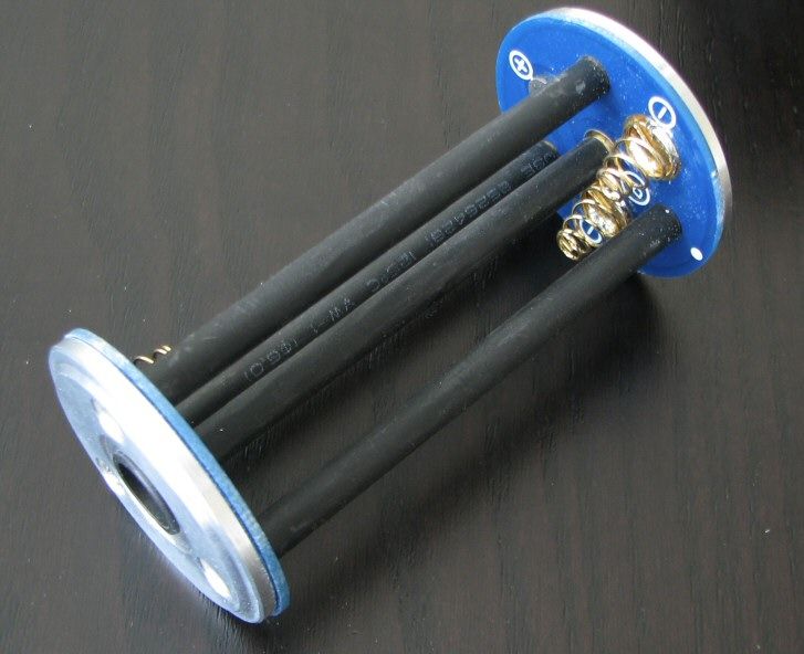

    There is a metal battery carrier that holds 3x 18650 cells. The positive contact plate is slightly raised, so all types of 18650 cells should work fine (i.e., true flat-tops, wide and small button-tops). Longer cells may be a bit tight, but my protected 3100mAh cells all fit. The carrier can be inserted either orientation into the handle. Note that particularly wide cells may be a tight fit into the handle.
    (from my TN30 review, but it looks the same here - the battery/body handles are the same).
    The light can tailstand stably, and the tailcap cut-outs facilitate access to the switch. Switch is a forward clicky switch (i.e., press for momentary, click for locked-on). Switch feel is fairly typical, with a definite click. But there's more to it than meets the eye ...
    There is a double set of springs in the base, in addition to the spring in the head. The double-set of springs in the tail is a tip-off that something interesting is going on with the tail-switch and the battery carrier. Here is what the tail switch looks like in detail:
    There is clearly a circuit along with the forward clicky switch. This is presumably to provide some sort of assist to the switch, modifying the load on it. The dual springs is how it draws power from the battery carrier, irrespective of the head. Scroll down to my Standby Drain section for more info.
    Turn the light off/on by the tailcap clicky – press for momentary, press and release (i.e., click) for constant on.
    Change output modes by turning the control ring in the head. Arranged from left-to-right (looking down at the light, held in traditional flashlight carry), the modes are level 1 (moonlight) > level 2 > level 3 > level 4 > level 5 > level 6 (max) > standby > tactical strobe.

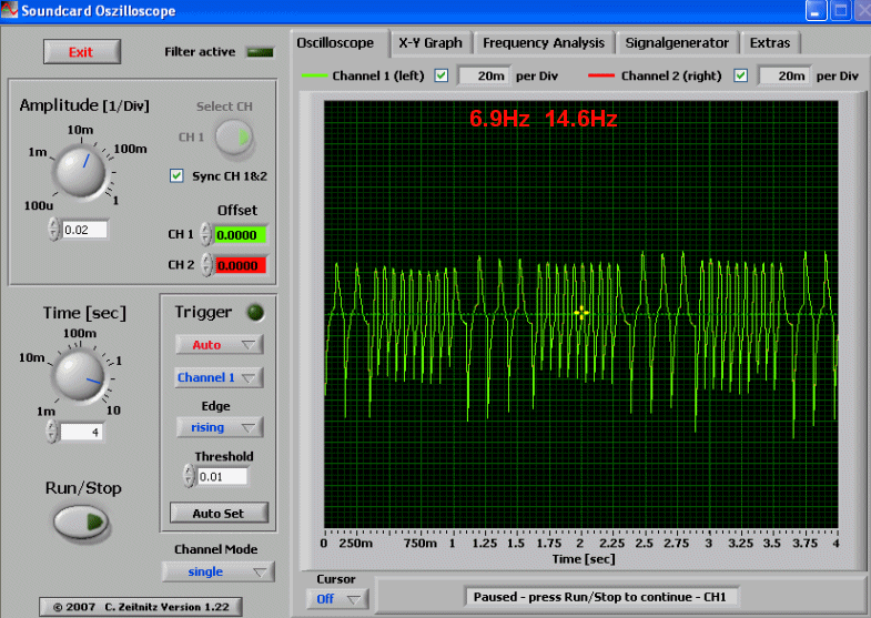

    PWM/Strobe
    There is no sign of PWM on any level – I believe the light is current-controlled.
    Strobe is an oscillating frequency strobe, switching between 6.9Hz and 14.6Hz on my sample. Each frequency lasts for about 2/3 of a sec. Here is a blow-up of each strobe frequency individually:
    There is a bit of a ramp-up to the peak strobe output, but it is not something you could see in practice. Strobe is quite blazingly fast to the eye.

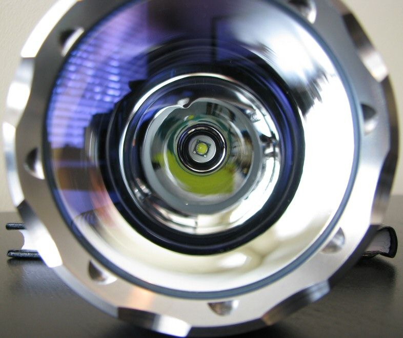

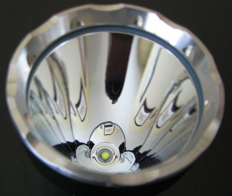

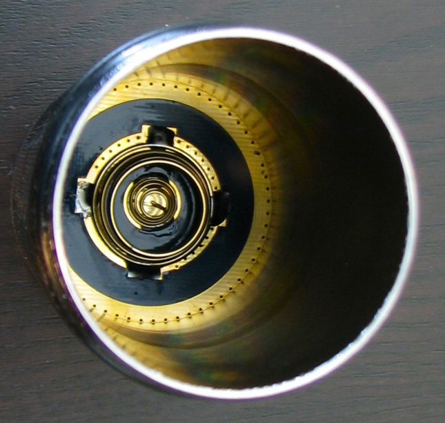

    The emitter was well-centered at the base of a very large and deep reflector. The reflector is smooth finished, and should provide excellent throw. And as you can tell from the reflections of the blind in my office, there is a very nice anti-glare coating on the lens.

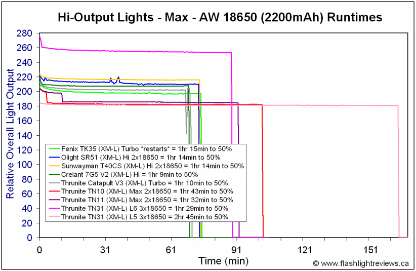

    Output/Runtime Comparison:
    Output/runtime performance was quite good for the TN31 when taking into account the 3x18650 battery source. It was certainly well in keeping with other current-controlled lights at these levels.
    You will note the TN30 typically outlasts it at lower levels, but that's because the 3xXM-L emitters are each being driven to a lower level for comparable output (i.e., emitters are more efficient at lower drive levels).
    As with the TN30, the light steps down slightly after exactly 69 secs of runtime. Unlike the TN30, however, the TN31 remain perfectly stabilized throughout the remaining Max output run. Flat regulation is evident at all output levels.
    Although it doesn't show in the runtimes above, the TN31 would flash a few warning flashes shortly before hitting the built-in battery protection circuit shut-down.
    One quirk – instead of shutting off when the battery protection circuit was reached, the light dropped down to a moonlight mode (similar to Level 1). Not sure why this happened, but it was a consistent observation. And this was different from the TN30, which completely shut-off (as expected).
    In terms of reported ANSI FL-1 runtimes, the Thrunite numbers seem pretty good, though perhaps slightly inflated at some levels. Remember that my runtimes are done on 2200mAh cells. On 3100mAh cells, I would expect runtimes fairly close to the reported Thrunite specs.
    Here is a Hi mode runtime comparison, on 3100mAh and 2200mAh batteries:
    No real surprises here - the 3100mAh cells perform better.
    Oh, and those little blips near the end of the L6 run on the TN30 are from the low-battery warning system of the light.
    Here is a comparison of the TN31 to typical single-emitter 2x18650 lights:
    As you can see, the extra 18650 provides a lot of extra runtime. But it also allows for greater overall output on the highest level.

    The greater output is part of the reason for greater throw. But a lot of it is also bound to be due to the reflector. Note that it is a lot more than just the overall reflector width - depth and overall shape/design matter greatly.
    For example, the TM11 and TN30 have similar sized heads, but the reflector well geometry is completely different. The individual TN30 reflector wells are more than twice as deep (looks closer to 3x as deep), with the 3 emitters much closer together. This obviously gives good throw. Note that the TN30 reflector wells are not as deep as Xtar S1, which is an even better relative thrower.
    A nice review as usual, but you got the switch wrong. It does not turn the power 100% off, it has some electronic assistance that needs a small amount of power.
    Interesting. Do you have a measure of its current draw, or a suggestion as to how I can measure it? I'm guessing it has to do with the large spring in the base making separate contact with the carrier?
    FYI, when I was measuring the ring standby current in th head (96-114 uA for the two lights), I tried turning the light off at the clicky - it dropped my current reading to zero (i.e. undetectable on my DMM's uAmA port). For all intents and purposes, it looked to me like the switch completely cut the circuit.
    But of course, I wasn't measuring between the tailcap and the carrier. I was suspicious of why the secondary spring was there, but couldn't get any specific reading.
    *Flashaholic* HKJ's Avatar
    Mar 2008
    Copenhagen, Denmark
    9,680
    Default Re: Thrunite TN31 Review (1xXM-L, 3x18650): RUNTIMES, VIDEO, THROW, BEAMSHOTS and mor
    I measured 20uA to 50uA, depending on on/off status. If you open the back you can also see the electronic. I did that in my review.
    The two springs are to supply current to the tailcap circuit, you need to measure the current from the battery to them.
    When off the current to the head is zero (or at least well below the uA range).
    There was a bit of blue lock-tight on the threads, but I got it open. I see what you mean, there is clearly a circuit there. That clearly explains the presence of the second spring. I'll update the review with pics later and a revised description.
    Unfortunately, my DMM's uAmA port seems to be on the fritz all of the sudden, I am not able to get any readings on any light. Not sure how that happened, but I will see about getting a replacement fuse to see if it helps. So, until I get a replacement, I will go with your estimates as to the current draw.

    How do feel about inserting the battery carrier into the battery tube? Is it too tight or suitable fit?
    6,936
    It was fine on my samples, as long as you are careful to make sure the batteries are all firmly installed in the carrier. Tolerances are tight, but not unreasonable for the cells i tried.
    Great review as always.
    Also can someone assist in identifying the reason for the circuitry on the tail switch?
    I see what appears to be a couple small N-channel mosfets, 2 resistors, and a few diods of some sort? Reverse polarity diodes perhaps?
    Mar 2008
    Copenhagen, Denmark
    9,680
    Quote Originally Posted by jasonck08 View Post
    As I wrote in my review it is probably to reduce the wear on the mechanical switch. This is mostly useful in the TN30, but because the TN31 uses the same body it gets the same construction.

    Some concern was expressed in another thread about a thermal step-down in output if no cooling was applied. I have tested this on AW 18650-2200mAh, and here's what I got:
    Note the left Y-axis is estimated lumens converted from my lightbox (for the two output runs). The right y-axis is the surface temperature in degrees centigrade (celcius), measured with a probe attached to the base of the head for the no cooling run only. Hard to put those numbers in context since I don't usually measure temp, but subjectively I can tell you the light got quite hot.
    As you can see, the lack of cooling caused a small drop in output over time - but nothing you could ever see visually.
    With fan cooling, output dropped from ~1150 estimated lumens at activation to ~1050 lumens right after timed step-down, and never dropped below ~1000 lumens.
    With no cooling, output dropped from ~1150 estimated lumens to ~1050 lumens as before, then gradually dropped to the ~900-950 lumen range. This resulted in marginally longe runtime.
    As always, take my lumen estimates with a grain of salt - they are based on a calibration of my lightbox to ceiling bounce values of other heavy output lights of known calibrated lumens. But they do seem remarkably consistent with Thrunite specs.
    Also, note that my office was quite warm for this test (i.e., resting temp for the light was 28 degrees), and no cooling was applied (although a window was open in the room). Frankly, I can't imagine a real-world scenario that would be worse than indoors with poor ventilation, as done here.
    Either way, you would never be able to see any of this visually.
