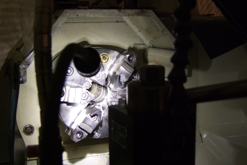

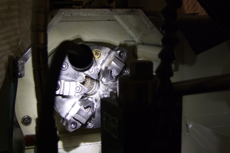

    One thing I neglected to do was to post "before and after" pictures so that folks can see the dramatic improvements.
    Stock light on the left, upgraded light on the right - stepped down exposure so that you can see the beam, but camera on manual exposure so that you can compare the relative brightness. First the stock lamp - the beam is horrible and uneven:
    Then the upgraded lamp - much, much better beam profile, plus much brighter as well:
    Now the lights are aimed at the chuck on my lathe. Again, camera on manual exposure. First the stock lamp:
    Then the upgraded lamp - again, much better coverage and much brighter:

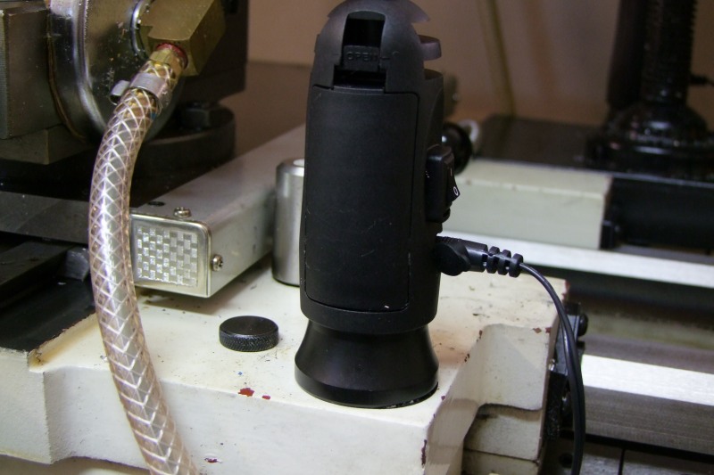

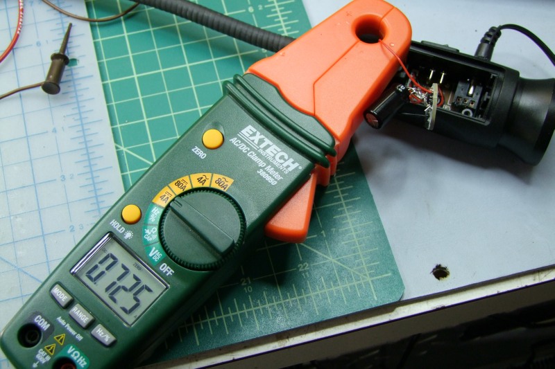

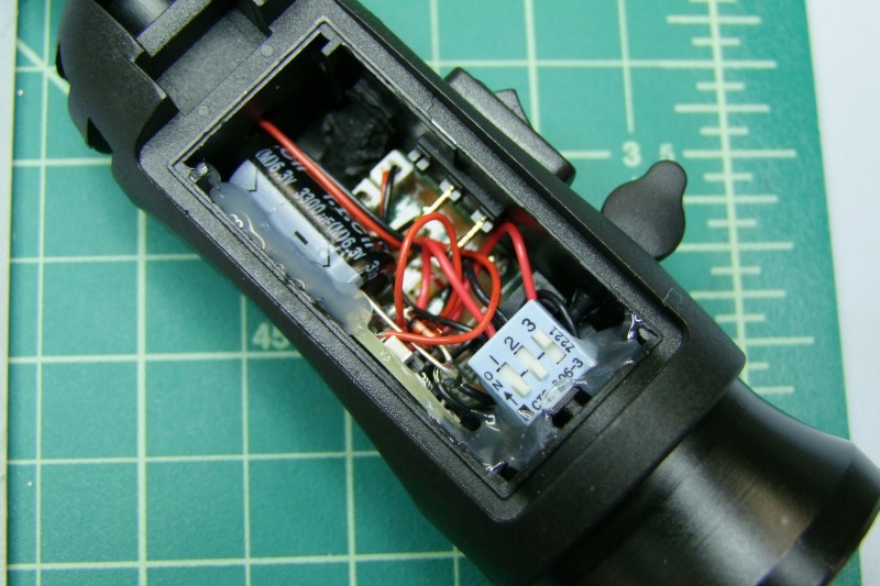

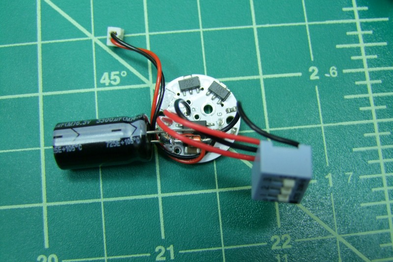

    I have now been using these lights for almost two months, and I have found that in a few cases the 700-800mA of direct drive is a tad too bright. To give me more versatility, I decided to use my just-finished LED drivers:
    Since the voltage from the wall-wart sags quite a bit and I don't need anything fancy, I am using the board with 2x 7135 chips on it, and using a dip switch for selecting the output level (via PWM at about 1000Hz):
    Initial testing was excellent:
    Since the power on the DC side of the wall-wart is rather noisy with AC, I used a zener diode and a rather large cap to clean it up so that the tiny85 would have decent, clean power:
    I was able to fit everything inside of the factory battery compartment, giving me 8-levels
    When the lamps are in use, the cover protects the electronics:

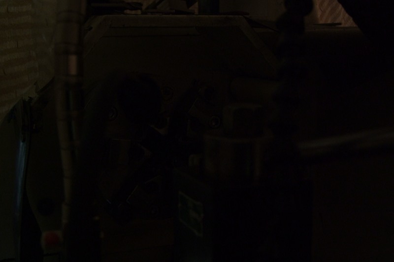

    After playing with various levels, I found that about 500mA was enough, instead of the max/hi of about 700mA. Here is the photo with no light (reference point) - camera on manual exposure):
    Here at about 700mA
    Here at about 500mA:
    Now I can fine-tune each of my 4x shop lights (2x in the lathe and 2x in the milling machine) to the job
