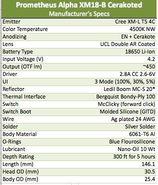

    Manufacturer's Specifications

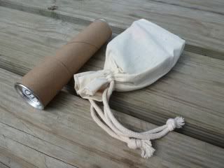

    Jason's philosophy on his lights is that any cost for packaging gets passed on to the customer, so he uses a minimal packaging to keep the cost of the light as low as possible. My review sample along with the Apprentice package and titanium zipper pull arrived in a box padded with paper.
    The light itself arrived in a simple cardboard tube with Jason's logo on the end, and the accessories of the Apprentice package arrived in this small drawstring bag.
    [EDIT: I've just been informed by Jason that this packaging is pretty new, and only the most recent lights shipped out have it. He has been getting a lot of feedback from customers that he should use packaging, so he's picked this packaging that will look good and still be cheap enough that he doesn't have to increase the cost of the light.]

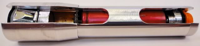

    As a quick side note, Jason has given me permission to use this picture from his blog of an Alpha cut open from end to end:

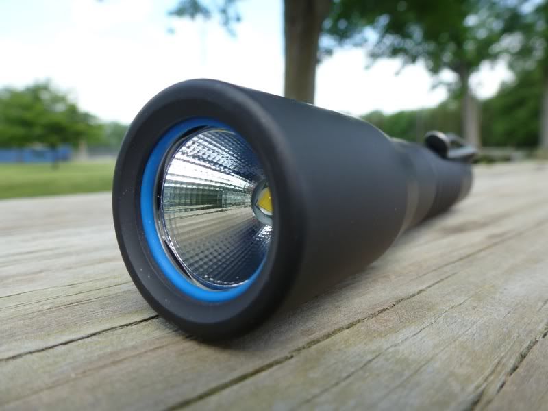

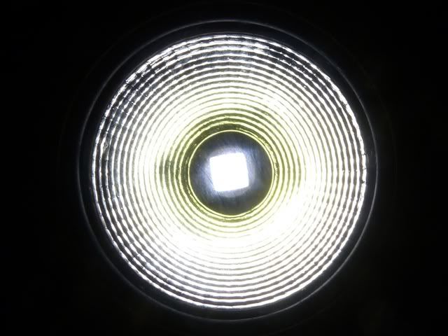

    The Alpha is available with a choice of emitters: XM-L, MC-E, or XP-G in multiple color temperatures. This review samples uses a 4500K XM-L. The XM-L emitter is known for it's high efficiency and high output capability, and is mostly a "flood" type emitter. The Alpha is also available with either a faceted "Boom" reflector, or a TIR (total internal reflection) optic of about 20 degrees. This sample uses the boom reflector. The facets, apart from adding style, also serve to smooth out any rings or artifacts from the beam. You can see this effect in the beam shots further down. The glass lens has an anti-reflective coating on each side to ensure the maximum possible amount of light makes it through. Between the lens and the bezel is a blue fluorosilicone o-ring that keeps water from getting into the light. (Note: Jason has tested the Alpha to a pressure equivalent to 300ft deep for 5 hours, with no water entering the light).

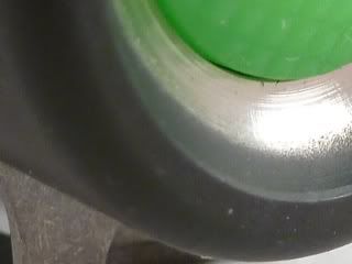

    The tail cap features a recesses button, which is easy to press but maintains the ability for a solid tail stand. The button cover is available in orange, black, or glow-in-the-dark green. As you can see, Jason has left an area where the electroless nickel plating is still showing. The purpose of this is to add some style to the light, and also leave room for a possible metal switch cover upgrade in the future. You can see a close-up of the cerakote fade out in the picture on the right.
    Below are some pictures of the GITD switch cover in action:
    The two dark shots were taken at different exposures so you could get a good idea of what it looks like. What I usually see with my eyes is somewhere in between, closer to the picture on the right.

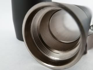

    The threads are thick and very well formed. Jason pre-lubes them with nano-oil before sending them out, and includes a bit of nano-oil for maintenance. These threads are extremely smooth. It's recommended to do battery changes by removing the head, not the tail. I've found this to make sense to me, as the larger spring makes battery changes more difficult at the tail.
    Also, you can see that the all the threads are non-anodized, but they are nickel plated, so they can maintain great electrical conductivity and still hold up to use over time.

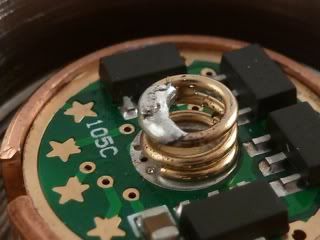

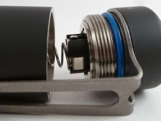

    Inside the head you can see the circuit board sitting on a large copper tube. the copper tube acts as a heatsink, and quickly moves heat away from the emitter and circuit board to the body of the light, where it can be dumped into your hand.
    In the middle picture you can see the gap in between the heatsink and the rest of the head. This is where the body slips in and the head overlaps. This area is designed specifically to take pressure off of the threads and protect them in the case of impact or force applied.
    The picture on the right is a close up of the spring that makes contact with the positive terminal of the battery. You can see a small bit of solder has been applied to the end of the spring, to help prevent the spring from scratching up your battery. This design means that both flat-top and button-top cells will make electrical contact. I've tested with AW, Callies' Kustoms, and Trustfire cells, and they all work.

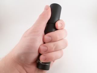

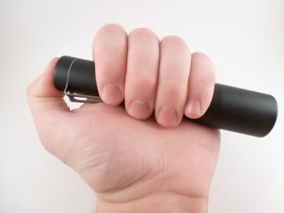

    Light in Hand

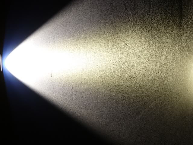

    White Wall (Low, Medium, High)
    ISO 100, f/3.3, 1/10"

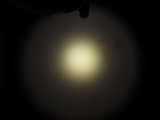

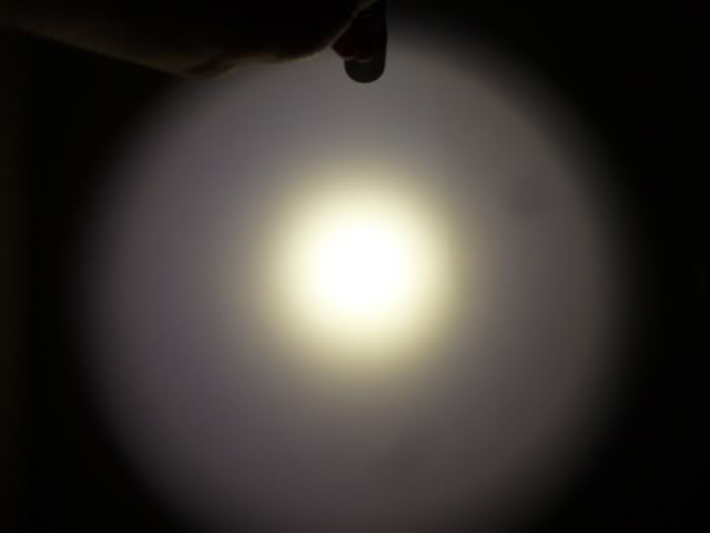

    BeamSlice
    MugShot

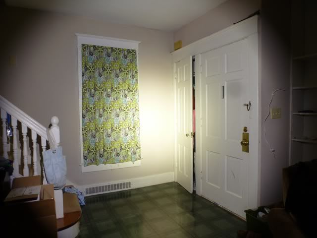

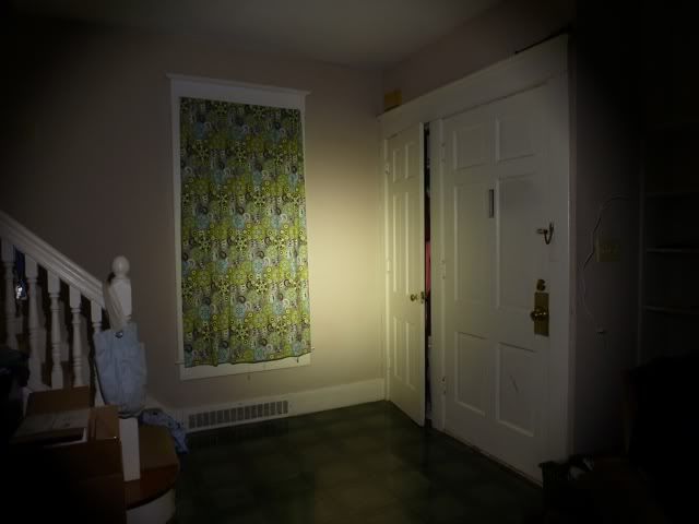

    Indoor Shots (Control, Low, Medium, High)
    ISO 100, f/3.3, 1"

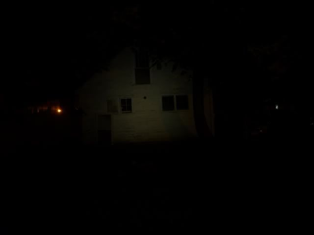

    Outdoor Shots (Control, Low, Medium, High)
    ISO 100, f/3.3, 2.5"

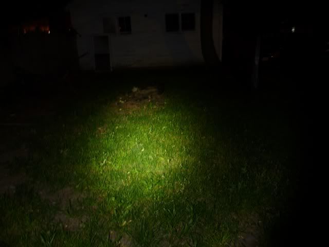

    More Outdoor Shots (Control, Low, Medium, High)

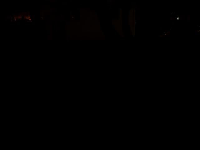

    Mid-Range Shots (Control, Low, Medium, High)

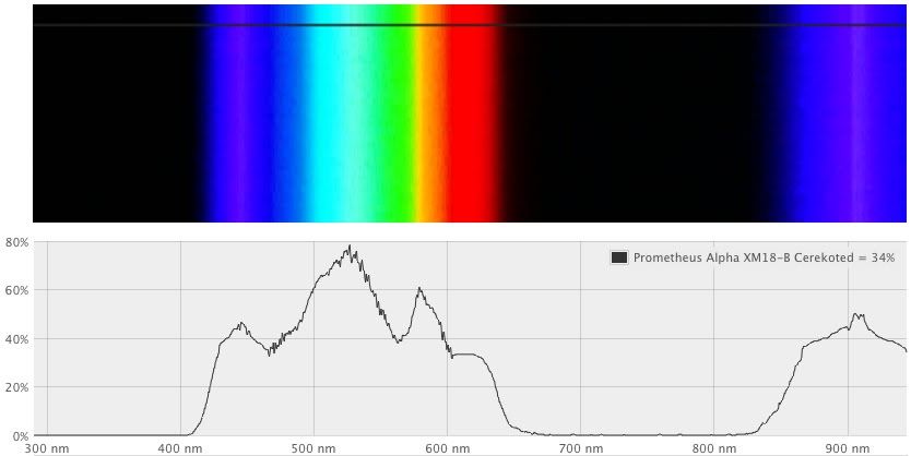

    Spectral Analysis
    All light that we see as white is actually made up of several different colors put together. The relative intensities of the different colors in the mix are what determine the tint of the white we see. For example, cool white LED's have a lot of blue, and warm white LED's have more red or yellow. This measurement was done on a home made spectrometer. Note: the peak in the 900nm region doesn't really exist, it's a piece of the second-order spectrum that's showing up here because of the high intensity of the light source.

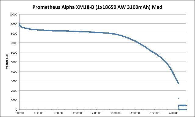

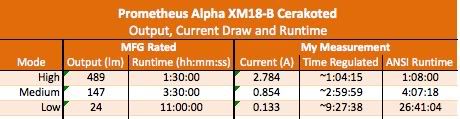

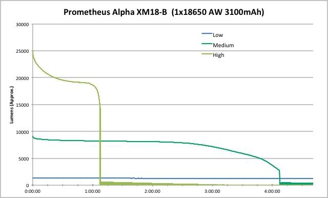

    Output, Current Draw and Runtime
    Note: For this light, you'll see the manufacturer's claimed output is higher than listed in the specs above. Jason rates his lights at the lowest possible output for the range possible in the emitter bin he uses, then includes a card with each Alpha stating the max output he measures from that specific light. So, he claims a minimum of about 450 lumens from an XM18-B, and he measured my specific sample to have a max output of 489 lumens. The medium and low mode claims are 30% and 5% of max, as claimed by the specs for the driver.
    Current draw was measured at the tail cap using a fresh AW 18650 3100mAh ICR battery. ANSI runtime ratings are the time it takes for a light to fall to 10% of it's original output.
    Note: The vertical axis of this chart represents a relative brightness measurement using a home made light box. The horizontal axis is time in hours:minutes:seconds. Runtimes are stated in hours:minutes:seconds. These graphs are truncated to show detail.
    Another Note: these runtimes were taken using a 3100mAh AW cell (for consistency with my other reviews), the cell provided in the Apprentice package is a 2900mAh AW cell, so you can expect slightly shorter run times if you use that cell.
    Mode Comparison
    I did not show the full extent of the low runtime on this graph, so that you could more easily compare the medium ond high modes. To see the full plot of the low mode, scroll down just a bit.

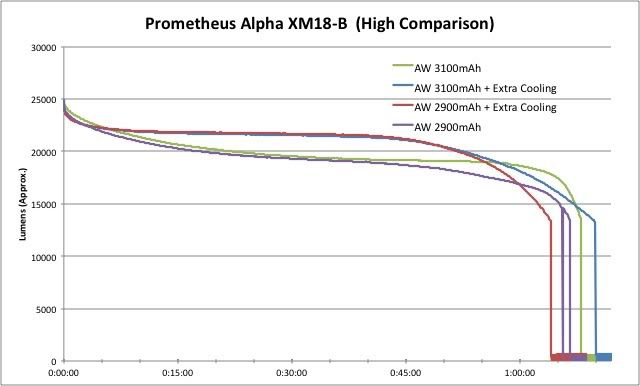

    High
    Time Regulated: 1:04:15 (approximate)
    Time to 50%: 1:08:00
    Full Runtime: 1:08:00
    [EDIT: After receiving some feedback that my plots weren't quite as flat as might be expected, I re-ran my test on High mode with some slightly different conditions. Normally, I use a 3100mAh AW battery in all my reviews to provide consistency, but just to be safe I ran a test on High with the 2900mAh AW battery included in the Apprentice package. Also, I normally run a fan on the light to cool it during a test, but my equipment is kept in a room without air conditioning. So, to see if the heat was affecting the output I moved my equipment into a room with air conditioning. The trials noted with a "+ Extra Cooling" are the two new ones, done in the room with air conditioning. You can see the regulation is noticeably better when the light is kept cool.]
    Medium
    Time Regulated: 2:29:59 (approximate)
    Time to 50%: 3:52:32
    Full Runtime: 4:07:18

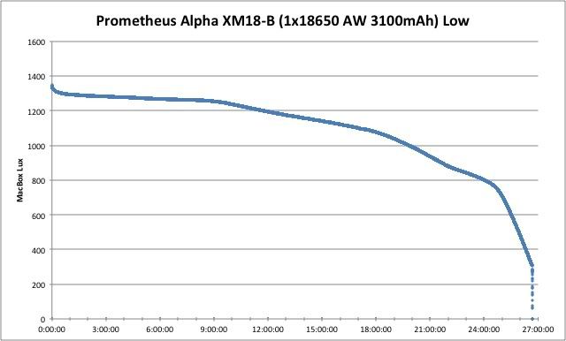

    Low
    Time Regulated: 9:27:38
    Time to 50%: 25:10:24
    Full Runtime: 26:41:04
    At the end of each test, the Alpha has a sharp drop in output, then quickly activates the low batter indicator flash. During this time, the light is very dim, and it flashes off once every two seconds or so. It will continue doing this for several hours if you let it, but it is important to recharge the battery at this time, or ideally before the LBI activates. It's not healthy for a lithium ion cell to be deeply discharged. Try to charge your cell before the LBI turns on, but definitely stop using the light when you see it start flashing. It won't be too bad to do it once or twice, but don't make a habit of letting your battery get that low.

    I really like the beam pattern on the Alpha, the faceted reflector is fun to use. At one point Jason had an aspheric lens available for the Alpha, which could make this really great as a thrower, but his source for those no longer has them available, so we can hope he finds them available some place else.

    [EDIT: I re-ran some tests on High mode with some extra cooling, and found that the regulation looks a lot better, maintaining high brightness for longer. See the note and chart in the "Performance" section above.]
