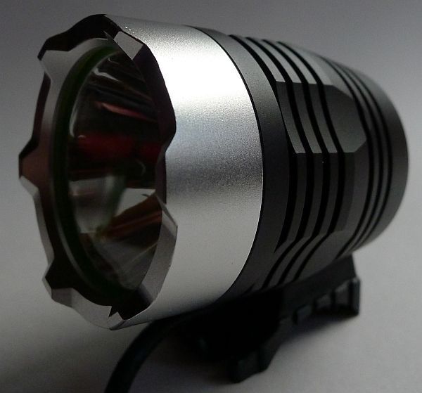

    The S14 is well finished and having seen many of this type of light, immediately has several finishing touches that show thoughtfulness in the design.
    The crenelated bezel, seems unnecessary as this is a bike light and will not be used hand held, so not sure why that detail is present, but all the other features are positive.
    Customer expectations are growing, and with the S14, Xeccon are certainly keeping up with these. I’ll cover these in the main review, but so far I’m pleasantly surprised with the S14.

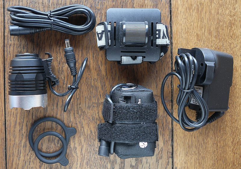

    The main S14 light head is accompanied by its o-rings (with tabs to hold onto), battery pack, charger, head mount, and cable extension for when it is used on the headband to allow the battery pack to be on your belt.

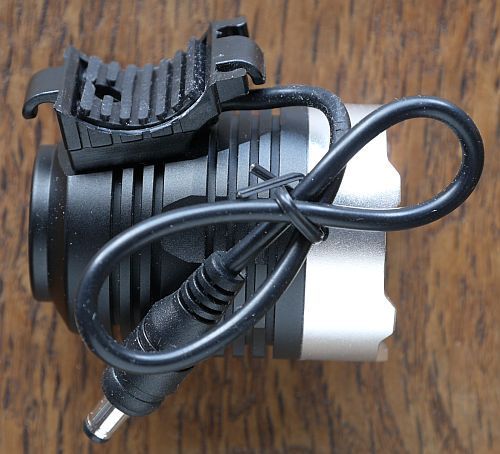

    As seen in the previous photo, the o-rings used to secure the S14 to your bicycle, now have tabs to give you something to grip when stretching the ring into place. The underside of the mounting block has a ribbed rubber insert, which conforms to and grips the bar. The hooks on the mount for the o-ring are well defined and shaped, with the front hook having lugs to retain the o-ring while you take it on and off the bike.

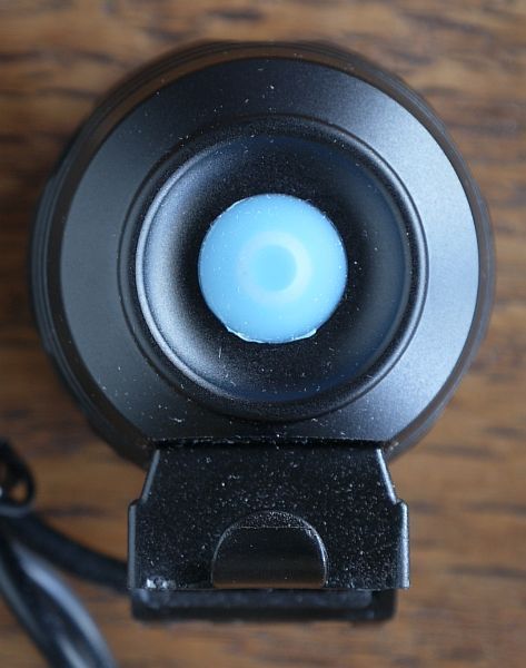

    The rear of the light unit has an illuminated button. One new feature is the inclusion of a low battery warning light which shows a red light in this button to remind you to charge the light. In normal use the button is illuminated when the battery pack is connected a turquoise colour.
    The S14 uses a Cree XM-L U2 LED in a deep reflector
    Removed from the mounting pouch, the Xeccon has a 4 x 18650 pack. The pouch is well finished with the Xeccon branding embroidered on the side, and dual straps for attaching it to just about any tube size you will come across.
    There are several cooling fins machined into the body.

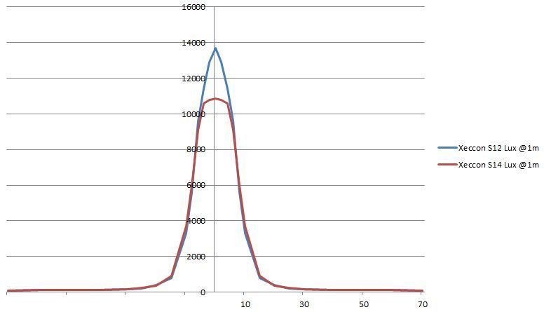

    In an attempt to quantify the actual beam profile I developed the following test. There are probably many flaws in my method, but it is simple and easy to carry out and seems to provide a good enough comparison.
    The method used was to support the light 1m off the floor and 1m from a wall, with a tape measure on the wall. The zero of the scale is placed in the centre of the hotspot and a lux meter is then positioned at points along the scale, with the measurements recorded. Beam shots are often taken with the light shining on a flat white wall, so this method is simply measuring the actual intensity across the beam on a flat surface, not the spherical light emission.
    The results are then plotted on a graph.
    For the best throw you want to see a sharp peak with less of the distracting spill. For the best flood light the trace should be pretty flat.
    The beam of the S14 is compared here to the S12. As seen in the previous section, overall output of the S14 is higher, but the central beam peak is lower as the S14 has a wider hotspot.

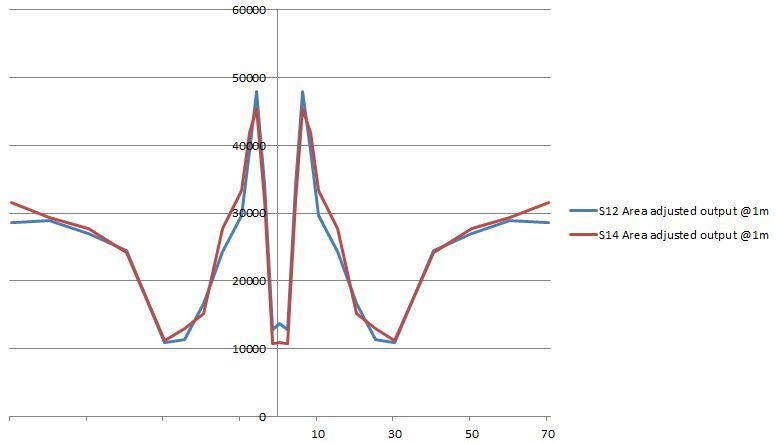

    Taking this a little further, I calculated an approximate factor to apply to the lux measurements, as each measurement gets further from the centre of the beam, it corresponds to a larger area onto which the light is falling. It seems to me that this should also be taken into consideration, so I applied these area corrections and came up with this odd looking graph.
    The key quantity here is the area under the graph line. This should correspond to the total light output.
    The S14’s wider hotspot and brighter outer spill can be seen in this graph.
