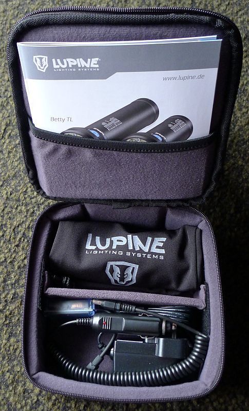

    The Lupine transport case is included as part of the Betty TL S kit
    Moving the twin zip fasteners fully open, the case lid lifts to show the neatly arranged kit consisting of the Betty TL head with Short Battertank, the Microcharger and both mains and car adaptors along with the Betty TL and Lupine charger manuals
    The Betty TL S is supplied in a cloth bag and this is shown with the mains and car adaptors, and the Microcharger.

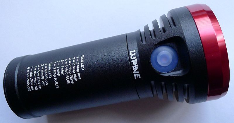

    Looking straight at the side of the Betty TL S showing the domed control soft click button (rated at 500,000 operations plus), cooling fins and the printed list of programs.

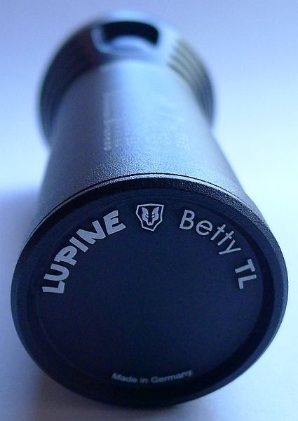

    Views of both ends of the Betty TL S

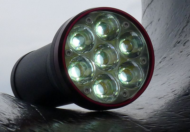

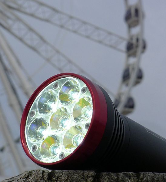

    And a closer look at the 7 XM-L head
    There are two surface finishes with the main body and head having a matt finish and the lens ring being smooth anodised.

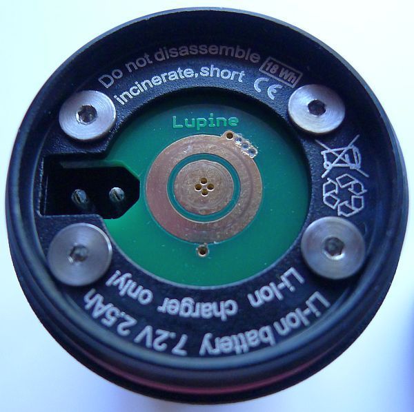

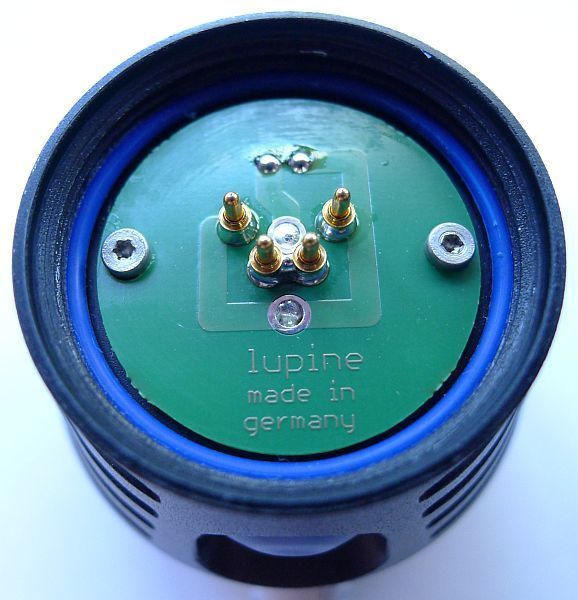

    The batterytank unscrews from the head of the light. Here the contacts of the light’s head are shown.
    And here the contacts of the batterytank. At 9 o’clock, you can also see the charger port which is only accessible with the batterytank removed from the head.

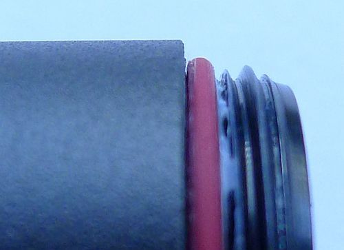

    The batterytank has a coarse heavy duty thread. This is very strong, and reduces the number of rotations required to remove the head.

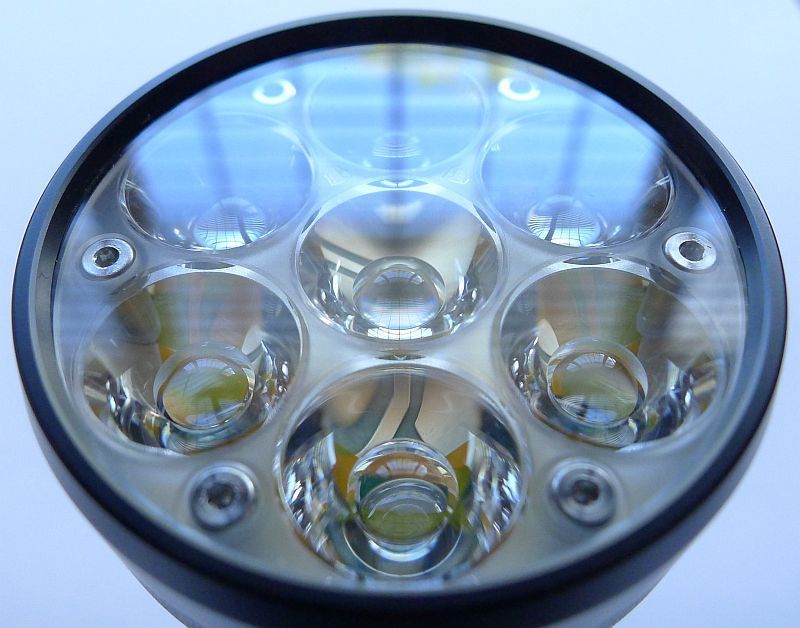

    One of Lupine’s excellent features is the upgradability of their lights. As you are buying into a quality system which should serve you for many many years, it is likely that new components will be able to deliver better performance. The Betty system is user upgradable and the lens/cap can be changed for a different colour. In this photo, you can see the lens removed which exposes the optic.

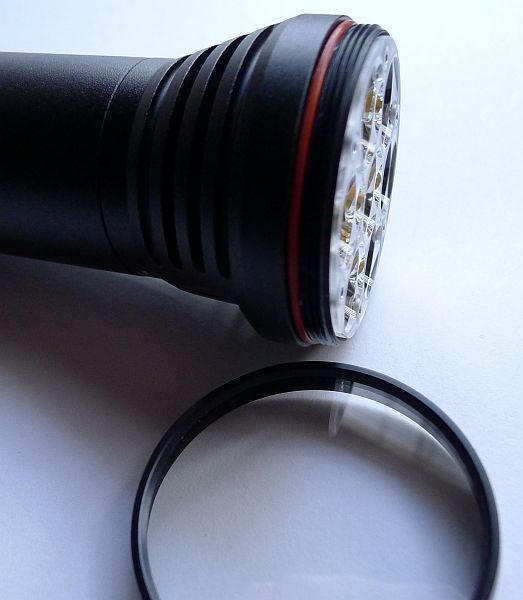

    The precision high-purity polycarbonate optic is held in place with six torx bolts. These can be removed to expose the LEDs and heatsink board which can be replaced with an upgraded board with different LEDs and the optic can be swapped for a different beam angle.
    Replacing the lens with a different coloured cap gives the user a choice of two-tone effect. The cap and lens are a single piece, so should the mineral glass lens ever be damaged, replacing it is very easy.

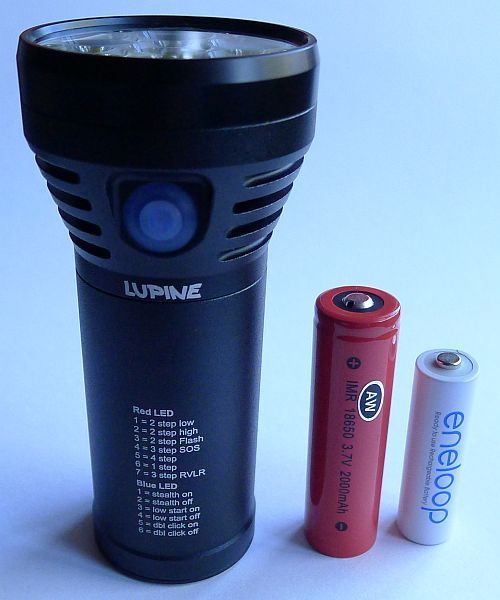

    With the Betty TL S standing next to an AW unprotected IMR 18650 (so slightly smaller than most 18650s) and an AA Eneloop, you get an idea of how compact this light is. And remember, there are 7 XM-L U2 LEDs up font!
    With a low level selected some of the optic’s detail.

    The user interface is all based around the single soft click button with red and blue lighting which:
    Switches on and off
    Changes output mode within the active program
    Selects the programming
    Provides status information
    To program the Betty TL, starting with the light off, you hold down the button. While holding it down, it will flash red, the number of flashes corresponding to the output programs listed on the body of the light. One you have reached the number of flashes matching the program you want to use, let go of the button.
    For example, is you want the 4 step program which has 26W, 15W, 10W and 1W output levels, simply hold down the button until it has shown 5 red flashes. Now when you switch it on it will have the four output levels available.
    The blue programs are for selecting the way the Betty TL functions and allows you to switch stealth, low start, and double click on and off.
    Double click means that you need to double click the button to switch on the light. This protects against accidental switching on of the light. If you want only a single click to switch on, simply select the double click off program by holding down the button until 6 blue flashes have been shown.
    Low start makes the Betty TL turn on in the lowest of the available output levels within the selected program.
    Stealth allows the information flashes to be mostly suppressed and prevents the button being illuminated when the light is on.
    Lupine light-heartedly explain stealth in the manual that “stealth on“ does not mean that the Betty TL will become invisible.
    Switching off requires the button to be held down until the light goes out. Once on, cycling through the output levels of the active program is by single click.

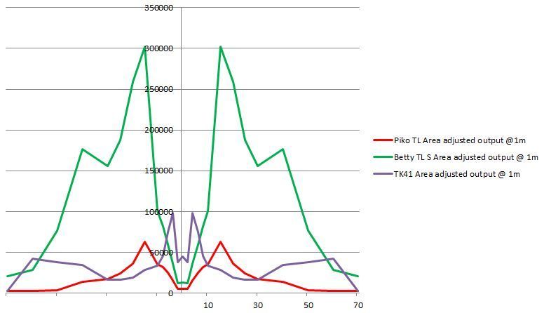

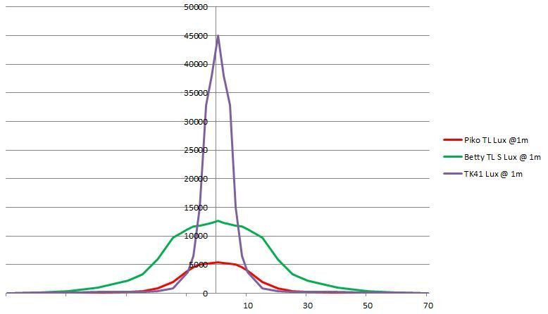

    In an attempt to quantify the actual beam profile I developed the following test. There are probably many flaws in my method, but it is simple and easy to carry out and seems to provide a good enough comparison.
    The method used was to support the light 1m off the floor and 1m from a wall, with a tape measure on the wall. The zero of the scale is placed in the centre of the hotspot and a lux meter is then positioned at points along the scale, with the measurements recorded. Beam shots are often taken with the light shining on a flat white wall, so this method is simply measuring the actual intensity across the beam on a flat surface, not the spherical light emission.
    The results are then plotted on a graph.
    For the best throw you want to see a sharp peak with less of the distracting spill. For the best flood light the trace should be pretty flat.
    The Betty TL S beam profile is shown here compared to the Fenix TK41 and to the Lupine Piko TL Mini.
    The Betty TL has a nice smooth bump of a profile smoothly transitioning from hotspot to spill.
    Taking this a little further, I calculated an approximate factor to apply to the lux measurements, as each measurement gets further from the centre of the beam, it corresponds to a larger area onto which the light is falling. It seems to me that this should also be taken into consideration, so I applied these area corrections and came up with this odd looking graph.
    The key quantity here is the area under the graph line. This should correspond to the total light output.
    This is the widest version of the Bettl TL’s beam being the 26° version, so although it does not have the sharp peak of the TK41, it swamps it as far as overall output.

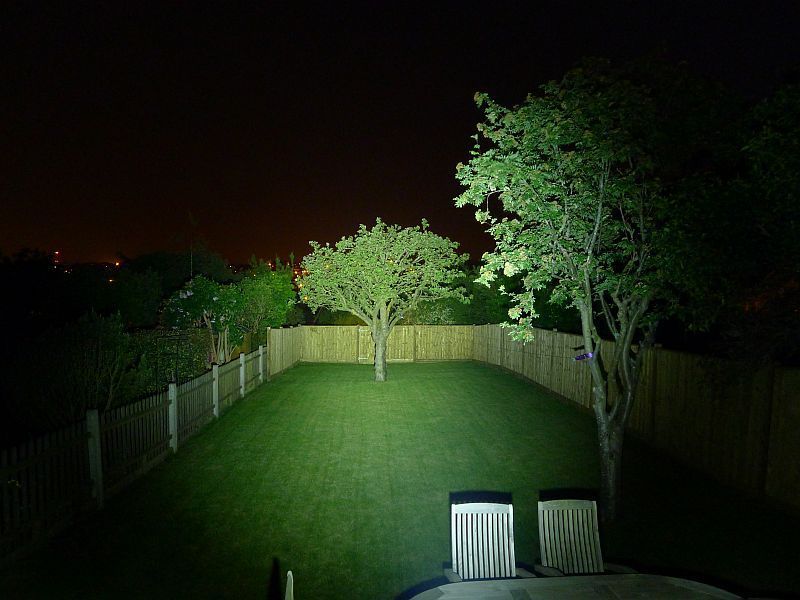

    Now for some comparative photos using the well-known and impressive Fenix TK41.
    Starting in the garden with the TK41 and using the same exposure for both shots.
    And then the Betty TL S, and yes the exposure is the same.

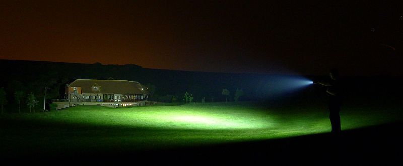

    Then out to a tree line track again starting with the TK41
    And you can see that although the TK41 does throw better, the Betty TL S lights up everything else!

    2) No, it is not 'user serviceable'. Lupine will replace the batteries for you at a nominal cost once they are no longer providing good usable life, or you can buy an extra tank.
    3) The LEDs are permanently attached, being soldered to the heat-sink backing board. For the upgrade kit, you replace the entire heat-sink board with LEDs.

    Those familiar with Lupine will automatically know that their looking at a top quality product just as anyone reading a review from subwoofer will know that they're getting a first rate report.
    I am a bit negatively biased against this particular design right up front since triple XM-L lights from China are routinely producing 1800-2000L OTF. It seems to me that they could have utilized 4 'properly' (subjective) driven XM-Ls, attained the same output, reduced materials and manufacturing cost, (if only a little) and reduced the head size thus making the light more compact. I'm not sure what advantage, if any, Lupine had in mind when they decided to use 7 XM-Ls to reach 2350L. Thermal concerns aside, Olight has attained 5000L with 6 x XM-Ls in the X6 design. If using a greater number of under driven LEDs is the way to go, why not use 14 XP-G's? Certainly, the beam quality and construction are of the highest order, I just question the formula.
    It would be neat to see comparison beamshots to the EYE-30, TM11 or RRT-3.

    I don't know for certain, but I suspect there are two main reasons Lupine use 7 emitters:
    Historical upgrade path - The Betty was designed from the start to take upgrade boards. Some of the original versions were about 1000lm output with 7 emitters; the emitters have improved and the layout has remained the same.
    Efficiency - LEDs in general become less efficient when driven harder and hotter. XM-Ls are no different, so by keeping the output relatively low the LEDs are not generating too much heat and maintain their efficiency. A knock on effect of this is to maintain more consistent output over the life of the light as the LEDs will degrade at a slower rate.
    Although not a perfect comparison, if you open my EYE30 review in a tab next to this one, you will be able to compare the EYE30 and Betty TL S beamshots of the tree lined track:
    http://www.candlepowerforums.com/vb/...Edition-Review

    Default Re: Lupine Betty TL S Review (7 x XM-L U2!)
    If I understand what you're pointing me to...that's the EYE-30 vs. TK41 though, not the Betty?
    Hove, UK
    2,468
    Quote Originally Posted by Patriot View Post
    No, the intention is that you have both reviews side by side (in browser tabs) and you will find that they have the same beamshot photos. Yes both the Betty and EYE30 are being compared to the TK41 as a point of reference, but if you put the reviews side by side you get the Betty and EYE30 comparison.

    This is a German light. German technology is known for quality and efficiency. They had to use an efficient design like this because the light is too small for this much power. Even all the less bright triple xm-l lights are bigger than this light.
    Another thing to note is that in general Lupine lights are almost always rather floody. Making a floody light (which still has enough throw) is much easier with multiple emitters. There was only one light until now that had only one led and the that was the predecessor of this light: the 1200 lumen Betty TLS with an sst-90 led. And even this light was not very throwy.
    Ok, got it, assuming the exposure and ambient lighting is the same or similar. Yeah, the Lupine is a flood monster but is certainly producing more light.
    What you and The Driver have stated about thermal concerns makes perfect sense. By driving more LED's with less current we're more efficient thus less heat is produced but with more light output. It was the only way to at XM-L technology, staying within thermal limits to make a LED light this size with this output.

    Tactical Reviews by Subwoofer
    Nov 2011
    north carolina
    919
    do they really put all that crappy looking writing on the handle ?
    id rather look in a manual myself......
