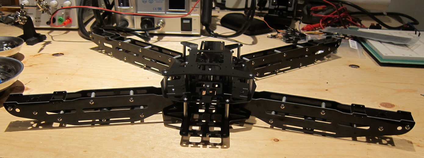

    I'm currently designing and building a new multicopter, which I indent to mount a camera on to and fly with goggles. My plans currently include putting a string of red 5050SMD LEDs on the back of the rear arms so I can determine the direction the copter is flying, but I am also looking to put head lights on the front to light up in front of the copter, and I want them to be bright. The goal is to be able to fly at night, and I also like the idea of really bright LEDs on an RC aircraft.
    I've ordered a pad of 24 5050 White SMD leds to go on each of the front arms, but I'm not sure if that is my best option. I was originally looking at mounting P7 LEDs or equivelent on the front, but heat would be an issue, no? SST-90's would be ideal.
    My ask is. What is the best way to get the brightest LEDs on the front of this thing, with the least weight. This will only be flown outdoors. The frame is made of G10 (glass-reinforced epoxy laminate). The battery is a 12v lipo.

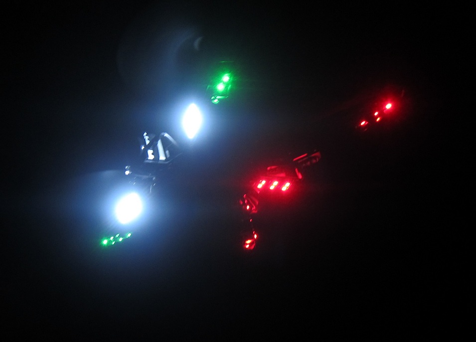

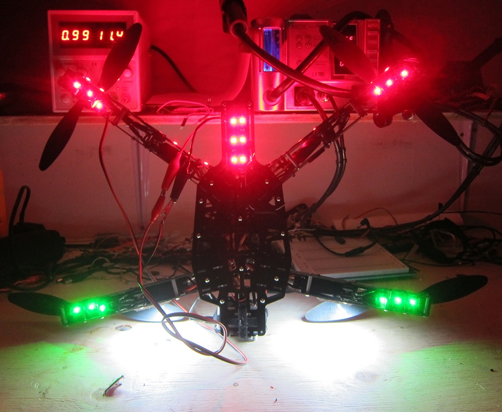

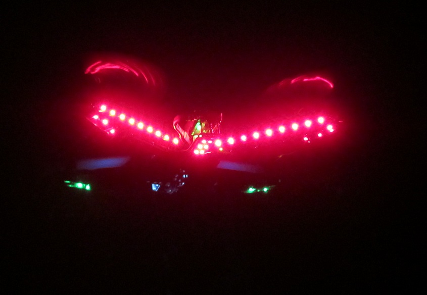

    I figured I should follow-up with the result here.
    No where near the brightness I was going for, but it does light up my back yard fairly well. I added other LEDs around for orientation and visibility (for night flying).
    Here is what you see from below.
    Nothing too impressive, but I'm fairly pleased for my first custom LED job :V
