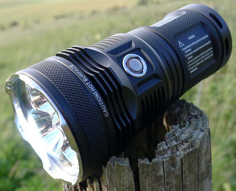

    Triple XM-L lights have become commonplace, which a testament to the strengths of this formula. NITECORE’s TM11 was an early adopter of this format and has been around for a little while now. With minor improvements being implemented along the way, the TM11 is still standing tall (metaphorically only as it is very small – tiny even) and showing that it is one of the strongest performers in this class with a measured 2457 ANSI Lumens!
    Initial Impressions:
    NITECORE’s unassuming packaging belies how good the tiny monster that lurks within will prove itself to be.
    With its reputation and the manufacturers claims to live up to, can this small light, no bigger than a can of soft-drink, really be that good? In the hand it seems far too compact to do so.
    With no cells in it, the TM11 feels solid but not over engineered, and with four 18650s loaded (the heavier of the power sources) it suddenly feels full of potential as the compact package is now quite weighty.
    Click it onto turbo, and if you haven’t yet experienced a 2000lm triple XM-L light first hand, expect jaw dropping to ensue. Even if you have, the very compactness of the TM11 and amount of power on tap should still bring a smile to any lumen junkie.

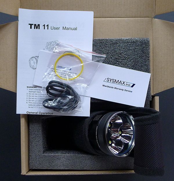

    What is in the box:
    The large box is plain cardboard with a printed label on the card. No frills, but neat.
    Inside is a closed cell foam liner holding the TM11 firmly and providing excellent protection. The TM11 is supplied fitted into its quality holster and includes a spare o-ring, lanyard and instructions.

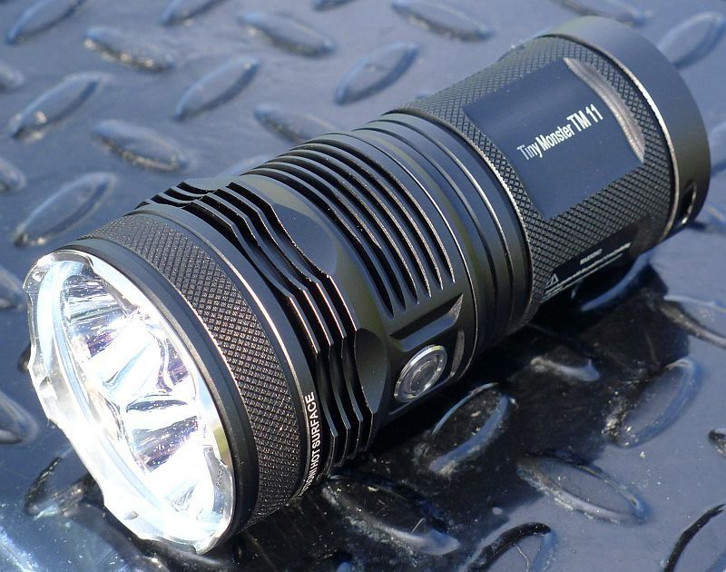

    The TM11 out of the box

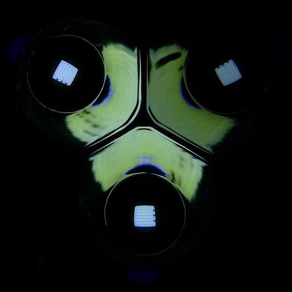

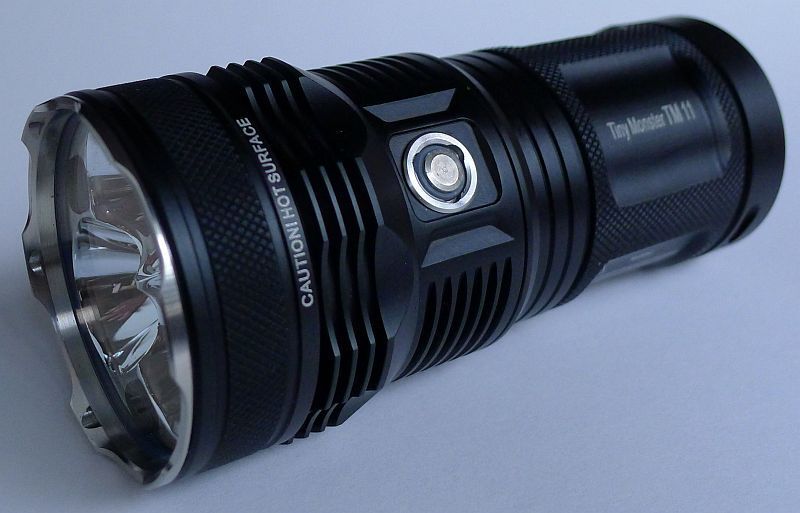

    Multi-emitter lights combine the LEDs and reflectors in different ways. The TM11 has a single reflector, in a single housing, but this reflector is made up of three shallow overlapping reflectors.
    The lens has an anti-reflective coating and is held in place with a stainless crenelated bezel.

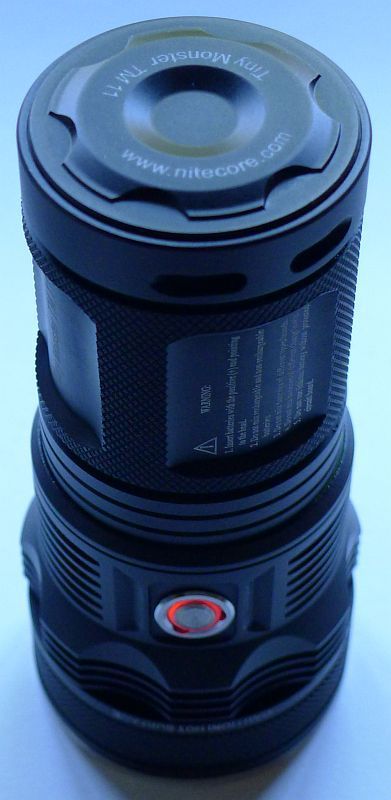

    The tail has nice detailing which appears to be a cosmetic feature, serving no practical function I can determine.

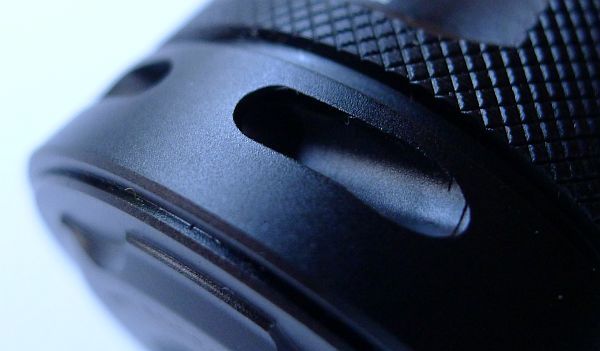

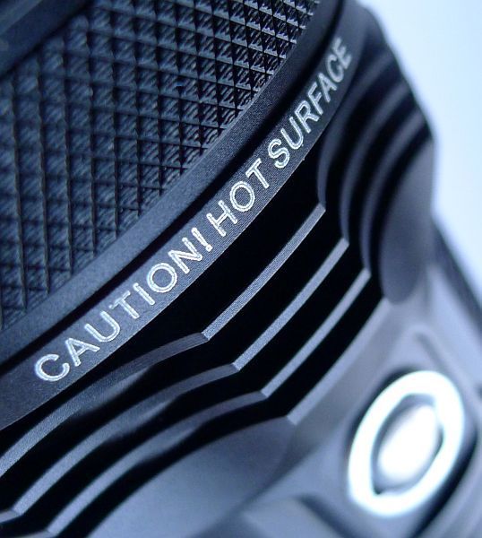

    The TM11 has plenty of crisply executed knurling around the head and body of the light. The battery tube has four panels cut into the battery tube to give very positive grip and each panel has text etched into it. Here the model name is shown
    A second panel

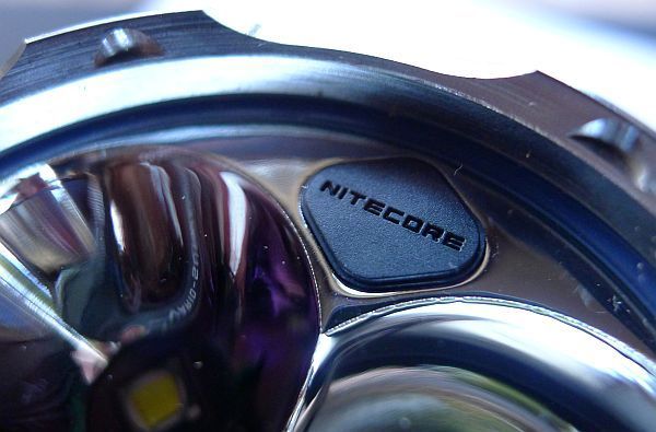

    Looking into the business end shows the shallow merged reflectors forming a compound reflector. In the spaces between the individual reflectors have black panels with ‘NITECORE’, a nice detail.

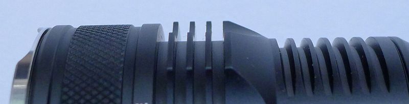

    Heat-sinking fins are relatively sparse considering the TM11’ s output, but precisely machined. The warning is laser etched.

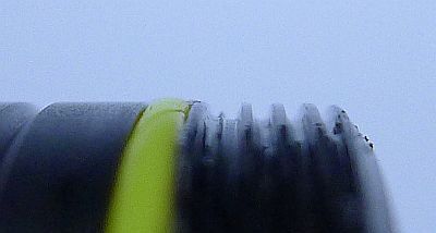

    Photographing the threads of the battery tube proved a little difficult as they are reasonably fine and the diameter of the tube meant the camera lens kept hitting the tube. The threads are a trapezoid form and fully anodised.
    Looking into the battery tube (on the left focusing at the negative contact at the bottom of the tube) shows the flat plate spring contact used for the negative cell terminals, and focusing higher up shows the machined cell separators and central support pin meaning a single 18650 or 2 CR123s can be used if necessary.

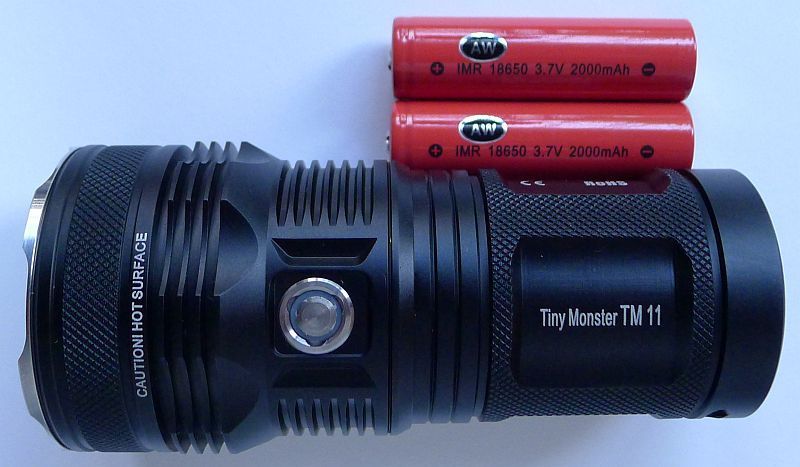

    To give an idea of size, there are two AW IMR 18650 cells next to the TM11. Remember these are unprotected, so around 4mm shorter than a typical protected cell.

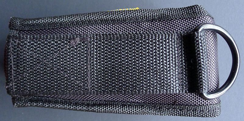

    The supplied holster is very well made and fits the TM11 well. The front flap is held in place with Velcro.
    There are three possible fixing choices, a metal D-loop, a fixed belt loop and a Velcro belt loop.

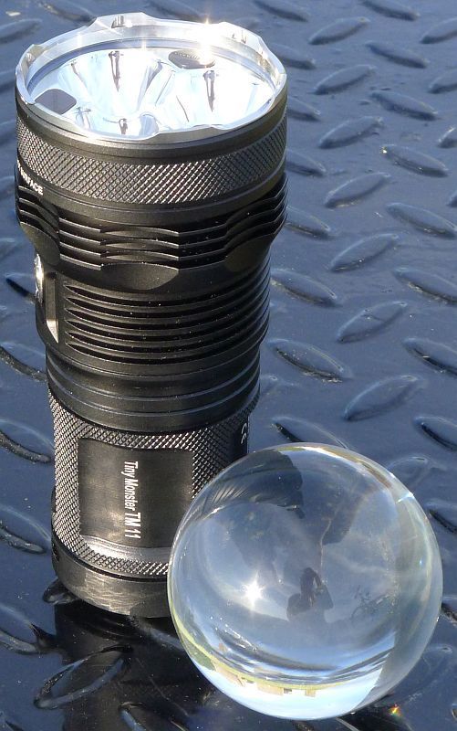

    To measure actual output, I built an integrating sphere. The sensor is a photo-diode restricted to visible light only (so Infra-Red and Ultra-Violet will not register). This was chosen as our eyes can only use the visible wavelengths of light so this is generally the only useful output. The integrating sphere was calibrated using 12 different reference sources and taking an average of the factor used to convert the measured voltage output to Lumens. Output figures are quoted as ANSI lumens where the measurement is made 30s after turning on the specified output level. Initial figures when first switching on are always higher, but all quoted measurements are ANSI.
    Please note, all quoted lumen figures are from a DIY integrating sphere, and although every effort is made to give as accurate a result as possible, they should be taken as an estimate only. The results can be used to compare outputs in this review and others I have published.
    The TM11 on test…
    For the Turbo runtime graph a cooling fan was used. In this set-up, the maximum temperature the head reached was 50C

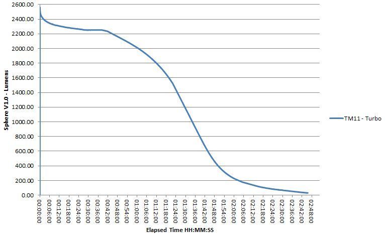

    Loaded up with Xtar 18650 3100mAh cells, the TM11 has the following output curve on Turbo
    This gives an amazing 1 hour at over 2000lm, then a further 36 minute with over 1000lm and another 30 minutes before the output drops to 200lm. Following this there was a further 40 minutes of usable light. This is a light you can rely on not to leave you in the dark and gives a fantastic performance on continuous maximum output.
    When the batteries get very low the LEDs just dim gradually. I got bored waiting for a complete shut off and here used an exposure of 1/3200s to capture the LEDs in detail.

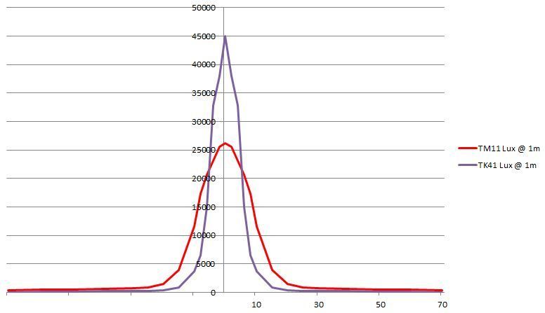

    In an attempt to quantify the actual beam profile I developed the following test. There are probably many flaws in my method, but it is simple and easy to carry out and seems to provide a good enough comparison.
    The method used was to support the light 1m off the floor and 1m from a wall, with a tape measure on the wall. The zero of the scale is placed in the centre of the hotspot and a lux meter is then positioned at points along the scale, with the measurements recorded. Beam shots are often taken with the light shining on a flat white wall, so this method is simply measuring the actual intensity across the beam on a flat surface, not the spherical light emission.
    The results are then plotted on a graph.
    For the best throw you want to see a sharp peak with less of the distracting spill. For the best flood light the trace should be pretty flat.
    The TM11 beam profile is shown here compared to the Fenix TK41 as this is a well-known high performance light.
    The TM11 has a very strong peak, however it also has a wide hotspot and smooth transition into a nice bright spill area.
    Taking this a little further, I calculated an approximate factor to apply to the lux measurements, as each measurement gets further from the centre of the beam, it corresponds to a larger area onto which the light is falling. It seems to me that this should also be taken into consideration, so I applied these area corrections and came up with this odd looking graph.
    The key quantity here is the area under the graph line. This should correspond to the total light output.
    This shows just how much light the TM11 outputs, and it overwhelms the already impressive TK41 especially the spill and outer spill. The TM11 is also a flood monster.

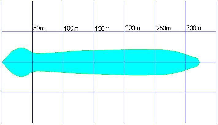

    As the reviewing wheels are starting to turn again I've decided to try something a little different as an update to this and future reviews.
    I'm looking for a little feedback on whether this is a useful change or not.
    As a replacement to the beam profile graphs you can see in the main review, which are intended to represent how the beam intensity changes across a cross-section of the beam, I have produced this prototype image.
    In this plot, the ANSI beam range (the distance from the light source that the intensity drops to 0.25lux) has been calculated across the width of the beam and plotted as if viewed from above (for some lights there may also be a side view produced - more on than another time).
    Please bear in mind that this is a prototype and is not the final version. It has been drawn in a CAD package to give the precise ANSI beam range 'shape' of the beam.
    In this case there is a 50mx50m grid and about 120° of beam angle (60° either side of the beam centre) is represented. The local intensity throughout the beam is not represented, only the limits of the beam's range according to ANSI standards.
    The difference here is that whereas in the beam profile graphs, the peak intensity across the beam cross-section is shown which clearly shows the width and strength of the hotspot and spill, in this representation the peak intensity is shown as the greatest beam range. I am not intending to do both, it is one or the other.
    Comments please...

    It looks like the side spill is a contender to your HID blinding Pete with he's PH50.
    The drop in output is a little better than I would have expected. Did you use a cooling fan.

    Quote Originally Posted by BLUE LED View Post
    The side spill/flood-light of the TM11 is good for the user, and is not as bad as the evil eye stabbing spill of the notorious 65W HID (but is quite bad when tail standing the TM11 on a table to light up a room).
    A cooling fan was used in the runtime test (and should be visible in one of the review photos). If just left sitting on a table on Turbo with no cooling fan, the TM11 gets very hot, but in normal use with your hand acting as a heat-sink and outdoors with normal air movement, I've not come across and overheating issues.

    I don't think NITECORE sell the TM11 holster separately, but they might if you contact them directly.
    The equipment was all bought from various online sources including ebay, but the integrating sphere requires you to design, assemble and calibrate it yourself. (Having a Master's degree in Engineering helps with this :-)
