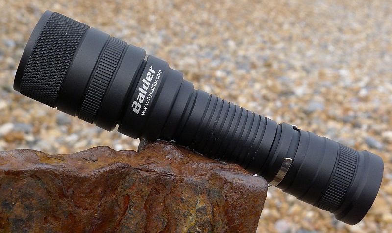

    Despite the many choices in this format of light, Balder have managed to create a distinctive look. The battery tube, so often made to be the 1” tactical standard, is actually smaller than this at around 22mm. This combined with the head, which is slightly larger than the common P60 hosts, give the SE-2 its distinctive look.

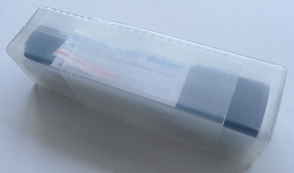

    Being a bit of a tool geek, I even like the unusual packaging, as it is just like the packaging many machine tools are supplied in; simple, reusable and useful.

    The SE-2, like most of the other Balder lights, comes in a two part plastic case.
    It is supplied with a replacement switch cover, o-ring and instruction card.

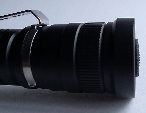

    The clip is very well finished and the contrast of plain polished stainless and the anodised body looks good. The body has a series of grooves to provide grip rather than knurling.

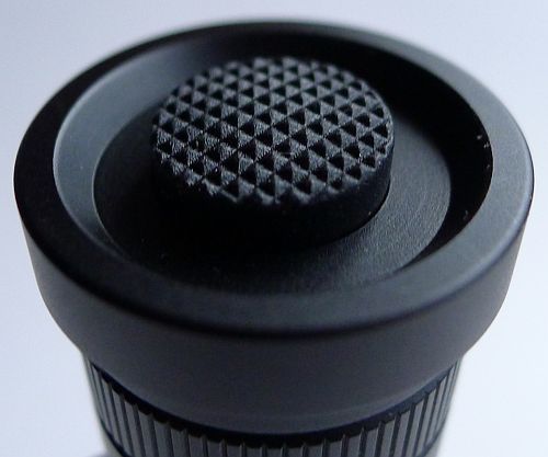

    Looking at the tail switch, there is a wide ring of metal surrounding the forward-clicky switch. The switch is slightly recessed.
    But still protrudes enough to make tail standing unstable.

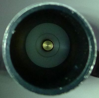

    Looking deep into the battery tube shows the positive contact which is again a sprung brass post allowing flat top cells to be used.

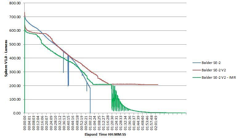

    The following runtime graph includes the initial version of the SE-2. I have included this to show the improvement in output characteristics implemented in the second version.
    For the second version there are two lines, one using a 3100mAh Xtar cell, and the other using an AW IMR.
    Notice that the SE-2 V2 has a high level regulated output around 580lm which is maintained for around 20 minutes, then the output gradually declines to the next regulated level around 210lm.
    In this graph the 3100mAh output is terminated at the point the output starts to pulse. This characteristic can be seen in the IMR curve all the way down to a few lumens.

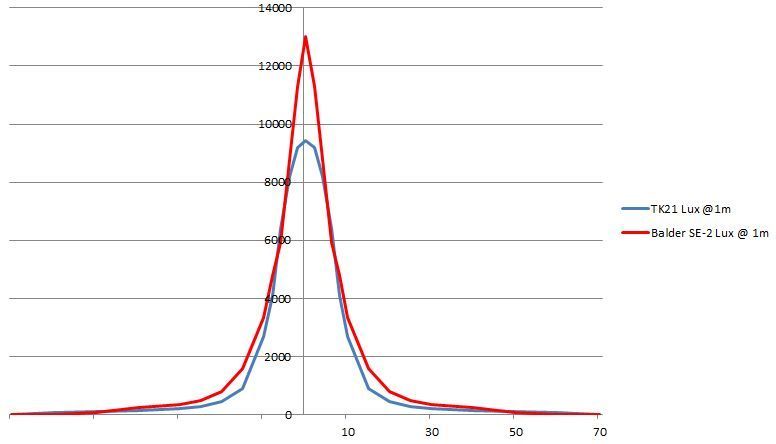

    In an attempt to quantify the actual beam profile I developed the following test. There are probably many flaws in my method, but it is simple and easy to carry out and seems to provide a good enough comparison.
    The method used was to support the light 1m off the floor and 1m from a wall, with a tape measure on the wall. The zero of the scale is placed in the centre of the hotspot and a lux meter is then positioned at points along the scale, with the measurements recorded. Beam shots are often taken with the light shining on a flat white wall, so this method is simply measuring the actual intensity across the beam on a flat surface, not the spherical light emission.
    The results are then plotted on a graph.
    For the best throw you want to see a sharp peak with less of the distracting spill. For the best flood light the trace should be pretty flat.
    For comparison the SE-2 is shown next to the Fenix TK-21. The SE-2 has a sharp peak, giving it good throw, but coupled with a good amount of mid-spill.
    Taking this a little further, I calculated an approximate factor to apply to the lux measurements, as each measurement gets further from the centre of the beam, it corresponds to a larger area onto which the light is falling. It seems to me that this should also be taken into consideration, so I applied these area corrections and came up with this odd looking graph.
    The key quantity here is the area under the graph line. This should correspond to the total light output.
    Compared to the TK21, the SE-2 has less wide spill, but the central area is brighter.

    The battery tube grooves do not provide as much grip as knurling, but for the stylistic element this is an acceptable compromise.
    Its proportions make the SE-2 comfortable to hold and the wide tail provides a comfortable grip.
    Considering the value Balder has achieved with the SE-2, one slight disappointment is that the switch is pretty stiff and although the momentary action is easy enough, it needs either a fingertip to jab it on, or a very firm press.

    The light doesn't seem to be well regulated. I'll understand if there was a step down from high due to heat build up but, output steadily declines over time. Is the light's performance on Med output any better?

    I was expecting better regulation on high than seen in the output test. The test was run with a cooling fan and although it did get pretty hot, it was not so hot that I would expect and safeties to have operated. The best regulation was when the light level dropped to the medium output as you can see in the non-IMR SE-2 V2 the output levels out nicely at 210lm, until regulation can no longer be maintained.
    Oh, and remember I also included the SE-2 first version (the blue line) to show how the first version didn't exhibit any hint of regulation, but the second version does, even if this is limited to around 20 minutes on high before it drops off. The 20 minutes is at around a real 580OTF lumens, so is not that bad. Allowing the cell to rest might give more runtime at this level, but the test is monitoring a single uninterrupted output for a fully charged cell being run down to nothing with no rests.
    PS: In using the SE-2 regularly, I've found I rarely need the maximum output. When I do use it, it is very bright, and the gradual drop in output not noticeable or of concern.
