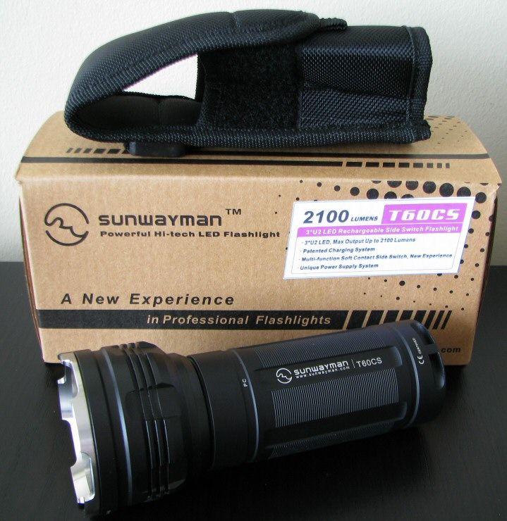

    Final shipping packaging wasn't available when my sample was sent out. Included with mine was a holster, wrist lanyard and extra o-rings (not shown in the pic above). A copy of the manual was supplied electronically, but I am sure that will be included in the shipping version.

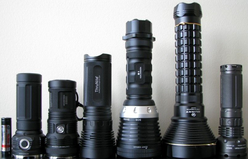

    From left to right: AW Protected 18650; Sunwayman T60CS, Nitecore TM11, Thrunite TN30, Xtar S1, Olight SR92, Sunwayman M60C.
    All dimensions are directly measured, and given with no batteries installed:
    Sunwayman T60CS: Weight: 338.9g (est 477g with 3x18650), Length: 145.0mm, Width (bezel): 60.0mm
    Thrunite TN30: Weight: 468.2g (est 620g with 3x18650), Length: 179mm, Width (bezel): 64.3mm, Width (tailcap): 49.0mm
    Xtar S1 Production: Weight: 876.0g (est. 1028g with 3x18650 protected), Length: 240mm, Width (bezel): 83.4mm
    Nitecore TM11: Weight: 342.6g (476g with 8xCR123A), Length 135.3mm, Width (bezel): 59.5mm
    Foursevens S18: Weight: 700g (800g with 6xCR123A), Length: 233mm, Width (bezel) 63.0mm, (tailcap) 25.6mm
    Olight SR51: Weight: 405g, Length: 190mm, Width (bezel) 62.0mm

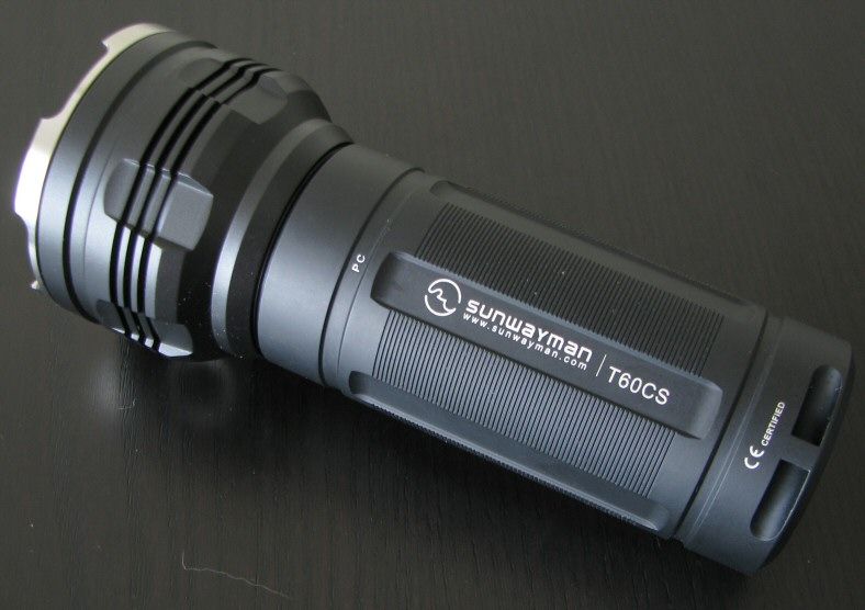

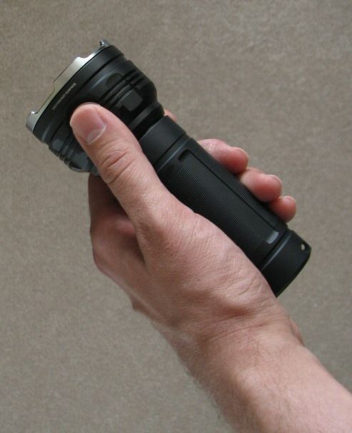

    The T60CS is fairly compact for this class of light – a bit longer than the TM11, it is still shorter than all the other multiple-emitter lights in my collection.
    Anodizing is the traditional dark gray natural finish of Sunwayman lights – very high quality, with no chips or damage on my sample. Labels were sharp and bright white against the dark background. No real knurling as such, but there are fine ridges along the handle, as well as number of indentations over the body and head. Overall, I would describe the grip as fairly good.
    Screw threads are anodized for head lock-out. Threads are square cut, and seem of good quality. Could use a little lube, though (mine came very dry).

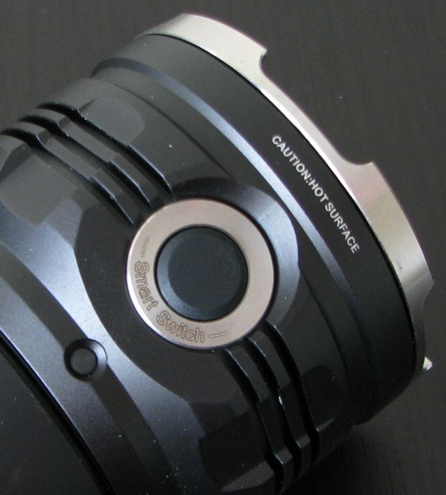

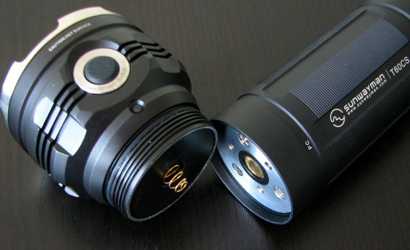

    Rather than a control ring, the T60CS is controlled by an electronic switch in the head (under a rubber button cover). Switch feel is good for this type of switch, with a definite "click" upon activation. Scroll down for a discussion of the UI.

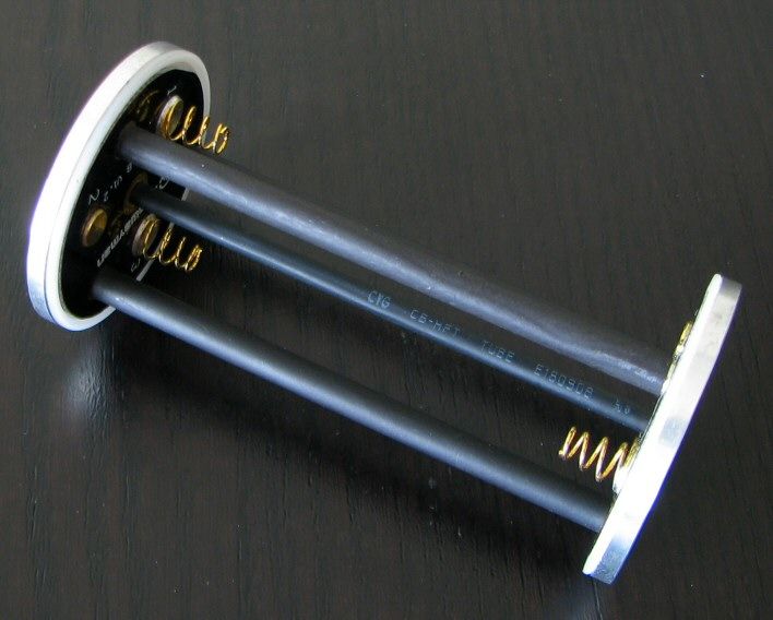

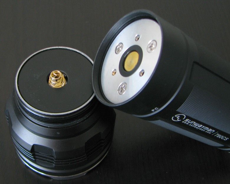

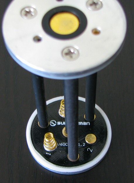

    The T60Cs uses a metal battery carrier that holds 3x 18650 cells or 6x CR123A. The positive contact plate is slightly raised, so all types of 18650 cells should work fine (i.e., true flat-tops, wide and small button-tops). Longer cells may be a bit tight, but my protected 3100mAh cells all fit. The carrier can be inserted either orientation into the handle.

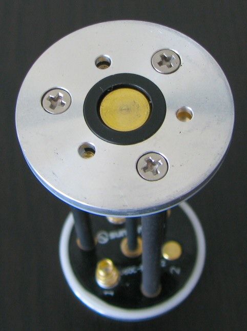

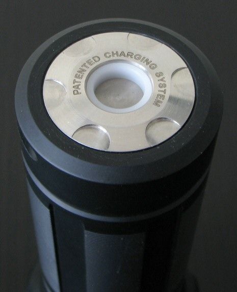

    The T60CS can use the optional charging cradle-dock sold by Sunwayman. The way this works is that the center and outer metal areas of the base are connected to the positive and negative terminals of the carrier (note center spring and metal contact disc inside the light). You can thus charge your batteries right inside the light, if you get this charging stand.
    To help protect against accidental shorting of the batteries, the center positive terminal is recessed by over half a centimeter. However, as the bare metal is exposed, it is still possible to short the batteries. I strongly recommend Sunwayman supply some sort of non-conductive cover for the center contact when the light is not being charged (or the user fashion something themselves). As it stands right now, you could potentially short the batteries if you carried the light in a pocket with metal keys, etc.
    I understand there is some sort of fuse in the battery carrier to help prevent a catastrophic outcome from accidental shorting, but I don't recommend you rely on that. Also, any such fuse is not user-replaceable, so you would need to get a whole replacement carrier if were tripped accidentally.

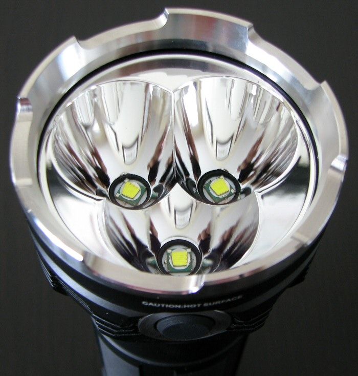

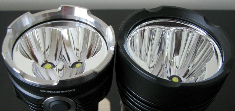

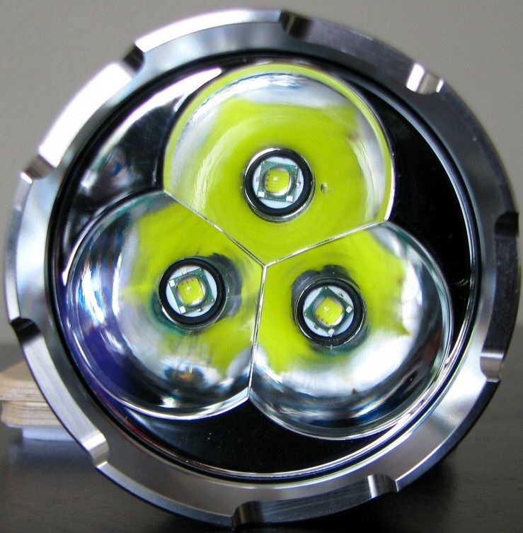

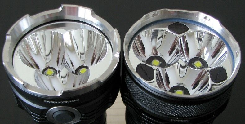

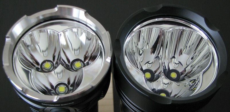

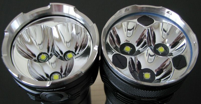

    The T60CS uses an over-lapping well design for the 3 XM-L emitters, similar to a number of other lights. In keeping with the overall length, I find the emitter wells are slightly deeper on the T60CS than the Nitecore TM11, but not as deep (or overlapped) as the Thrunite TN30.
    T60CS on the left, TN30 on the right:
    T60CS on the left, TM11 on the right:

    With the head fully-connected against the handle/battery carrier, turn the light off/on by the electronic clicky switch (i.e., press and release).
    First time you activate the light, it comes on in Turbo mode. Change output modes by pressing and holding the switch. The light will cycle between constant output modes in the following order: Turbo > Hi > Med > Lo, in repeating order. Let go off the switch to select the mode you want.
    Light has mode memory, and will retain the last constant output used when turning off and on.
    There are a "hidden" strobe and SOS mode, activated and double-clicking the switch rapidly. On first double-click you get strobe, on second double-click you get SOS. Single click to turn off. Light returns to the memorized constant output when clicked back on.
    As this is an electronic switch, a standby current is required (see below for measurements). To reduce the risk of accidental activation, Sunwayman provides a switch lock-out mode. After waiting a minimum of 7 secs with the light off, do a quick click followed immediately by a press-hold. After 1 sec, the light will shut off and cannot be re-activated until the lockout is deactivated. To restore full functioning, double-click the switch followed by a press-hold. Alternatively, you can twist the head to physically lock out the light (i.e., no current).
    Note that you have to be really quick on the press-hold to engage the lock-out mode (basically, you have to do the click, press-hold as fast as you possibly can). If you hesitate for even a fraction of a second between the two, you will instead just enter regular mode-changing.

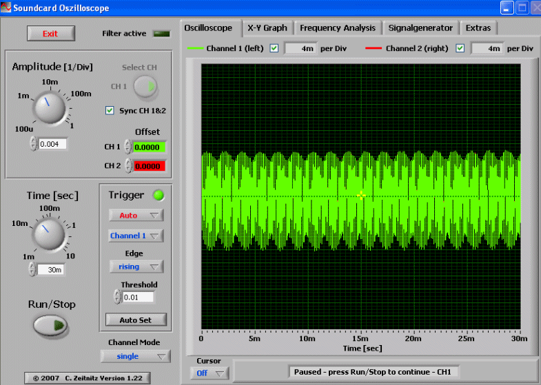

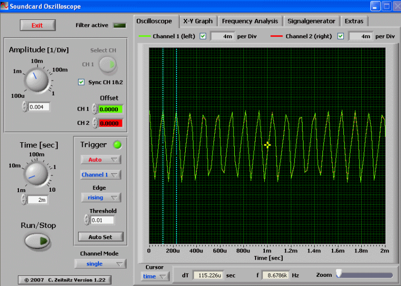

    PWM/Strobe
    There is no sign of PWM on any level – I believe the light is current-controlled.
    I did detect some high-frequency noise on Turbo and Hi (around the 8.7 kHz range), but was unable to detect it on Med/Lo (although it may still be there at an undetectable level in my setup). In any case, this is not detectable by eye, and it not a concern.
    I also detected some audible hum on the Hi mode, when switching between levels. This is generally believed to be due to inductor whine, and can be highly variable between samples of a given model. However, turning the light off and back on in Hi mode restored silent operation, so I am not clear as to the source of the hum during mode switching.
    Strobe is a standard "tactical" high frequency strobe, measured at 12 Hz.

    Each emitter was well-centered in its own reflector well – but the wells overlap with each other to some degree. Expect some peripheral artifacts in the spill, but these shouldn't be too bad given the relatively shallow reflectors.

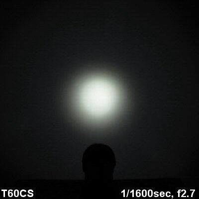

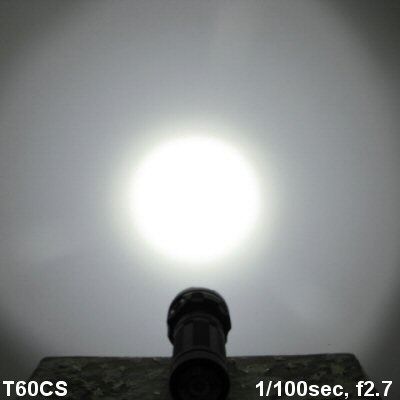

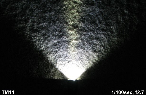

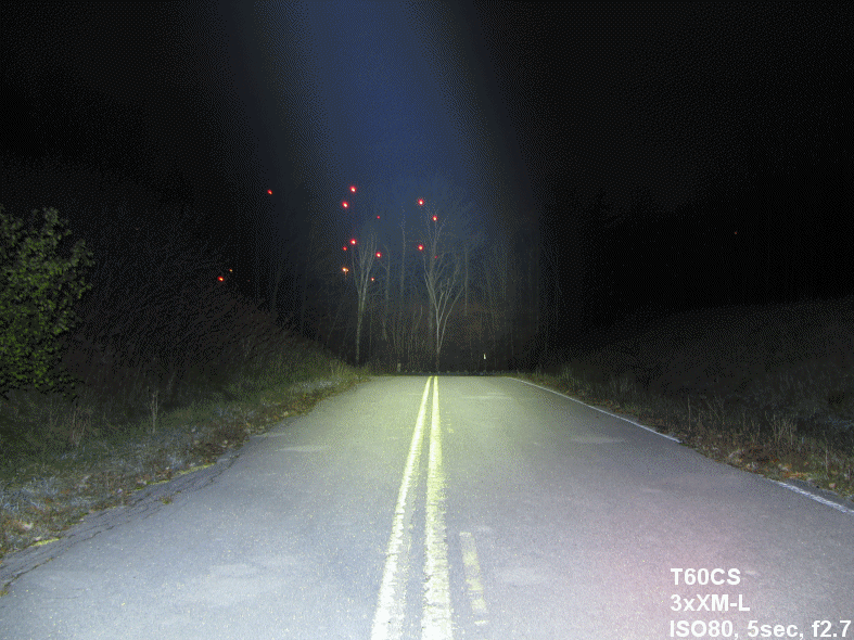

    And now, what you have all been waiting for. All lights are on their respective max rechargeable battery sources (i.e., 18650s), about ~0.75 meter from a white wall (with the camera ~1.25 meters back from the wall). Automatic white balance on the camera, to minimize tint differences.
    Output level on Turbo is quite high (scroll down for my lumen estimates). Although there is some "daisy flower" effect in the spillbeam (due to the overlapping well design), this isn't very severe – it is less than most lights in this class.
    To show the spill a little better, here are some side shots on my famed "integrating carpet".
    The T60CS is not quite as wide in spill as the original Nitecore TM11 - but it is still pretty broad.

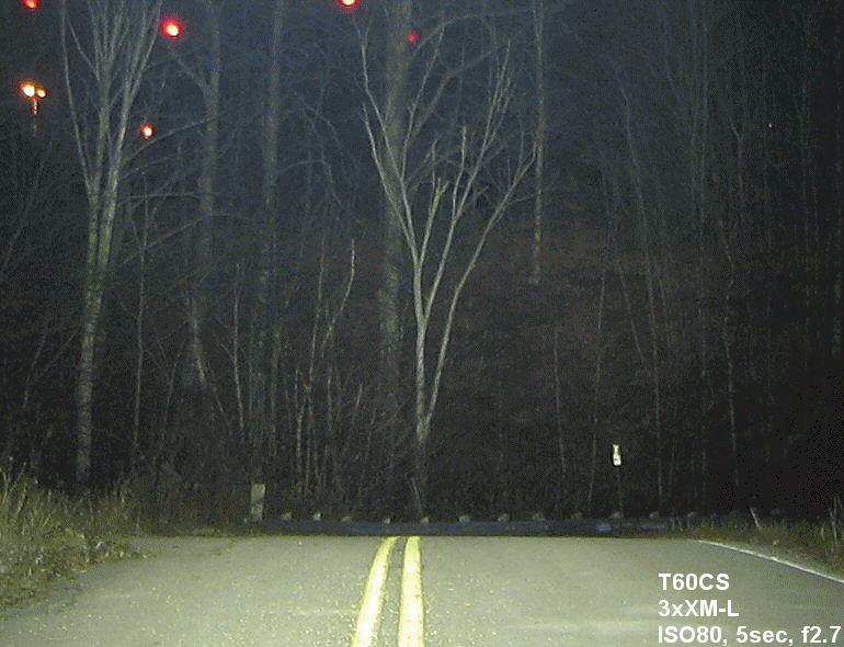

    For outdoor beamshots, these are done in the style of my earlier 100-yard round-up review. Please see that thread for a discussion of the topography (i.e. the road dips in the distance, to better show you the corona in the mid-ground). Please ignore the red-tint in the lower-right corner these shots (I was wearing a brighter-than-usual red headlamp during this excursion ).
    Here are zoomed-in pics of the hotspots:
    I know it can be a bit hard to compare, given the slight variation in angling of the lights. But as you can probably tell, the T60CS is not as much of a thrower as the TN30, but it does throw better than the Nitecore TM11.

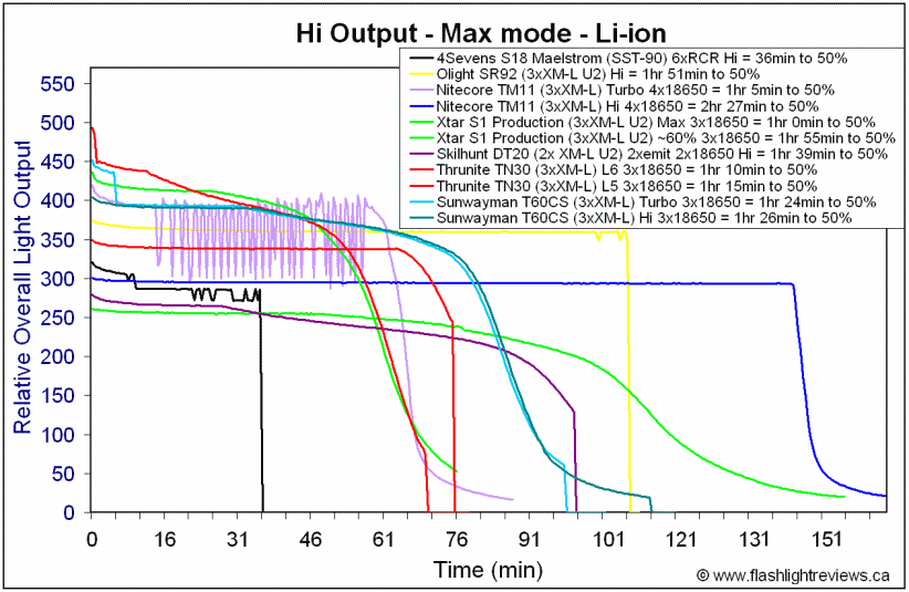

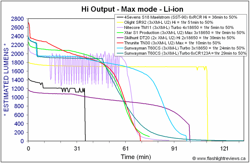

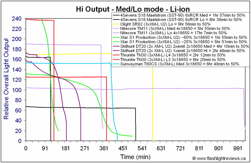

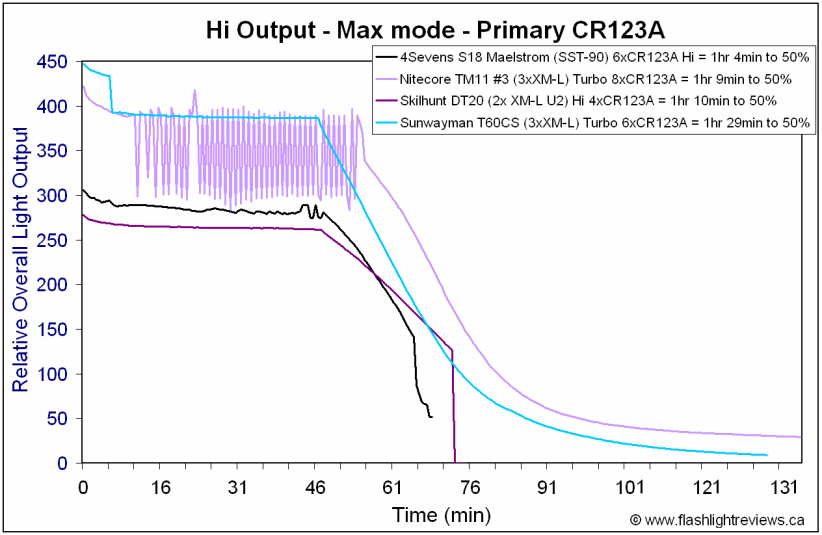

    Output/Runtime Comparison:
    Note: All my 18650 runtimes are done using AW protected 2200mAh.
    The Thrunite TN30 does have a slight advantage in overall output on its max setting, but I will leave it you to decide how significant the differences in the above curves are. Interestingly, the Hi level of the T60CS is about the same as the Turbo of the Nitecore TM11.
    One notable feature – the T60CS is slightly more efficient than the TN30, at all comparable output levels.
    Note also that the step-down from Turbo seems to be timer based (i.e., steps down after exactly 5 mins).
    Here is a comparison the various lights, on Max, in an estimated lumen output scale:
    Due to the overlapping reflector design, there are some artifacts in the periphery of the spillbeam (as with other lights that use a similar design). But I find them relatively minor in this case.

    Light uses a battery carrier, and very long or wide cells may be a bit tight. But all cells I tested worked in the carrier, including protected flat-top cells.
    Because the T60CS supports the optional Sunwayman charging cradle/dock, there are exposed contacts on the base that are directly connected to the battery carrier's terminals. There is thus a risk of shorting the cells if you bridge the tail contacts with a metal object. While Sunwayman has recessed the center positive contact to reduce this risk, it is still a concern if you were to rest the light on an irregular metal surface (or if it comes into contacts with keys in a pocket, etc.). I recommend Sunwayman (or the end user) fashion a non-conductive "plug" to cover the inner terminal, to reduce this risk. Note that there is a fuse inside the battery carrier to help protect against accidental shorting, but triggering this fuse would require a complete replacement of the carrier. This is a potential long-term reliability issue, as you may not be able to get a replacement carrier in the future.

    What's the capacity of the 3x18650 cells used in your runtime test?
    According to the MFG. spec., the working voltage is ~25.2v. So 6xRCR123A's may be used in theory. But I think they don't recommend to use them due to high discharge ratio. What do you think of it?
    All my 18650 runtimes are done using AW protected 2200mAh, to insure comparability to earlier review and ensure maximum compatibility with all flashlights. I usually have it listed in the figure titles, but I see I didn't this time - just added it as a note.
    I notice the voltage range as well, so 6xRCR should work (i.e., right at the max range). However the specs only officially support 18650 and CR123A, so I limited my runtime testing. I don't like testing non-supported batteries ... it may give casual reader the impression those cells are supported when they aren't, just because they see a graph.

    Default Re: Sunwayman T60CS (3xXM-L, 3x18650) Review: BEAMSHOTS, RUNTIMES, VIDEO and more!
    Does it have a good combination of flood and throw? In other words, does it have a medium size hot spot and a fairly wide spill beam, and how does it compare in beam profile to the "King of flood", the TM-30? Because in your chart the TM-30 seems to have a significantly higher lux reading, and maybe thats just a product of the TM-30's higher lumen measurement.......But if that is true and the TM-30 has a much higher lux reading, then the T60CS might even be more floody than the TM-30. I would prefer a nice happy medium between flood and throw, not too much of either.
    Some days you are the bug, some days you are the windshield.
    6,936
    Quote Originally Posted by HighlanderNorth View Post
    The T60CS is very similar to the TM11 in beam pattern. The TN30 has a noticeably narrower overall spillbeam (but the spill is brighter than the other two lights). It is also slightly more "throwy" than the other two, because of the reflector shape (but at the cost of more spill artifacts)
    I hope to get to the outdoor shots this week, which should show it better. At the end of the day, all the lights are extremely bright.

    Just an update. Going through my notes, I see that I forgot to mention a potential concern (added to the review):
    I don't recommend you run the light for extended periods on Turbo/Hi with primary CR123A cells. After my max CR123A runtime, all six of my Titanium Innovation cells came out of the light with body labels at least partially or fully split open. In my experience, that usually indicates a lot of heat build-up during the run.
    In my comparison testing of various battery brands, I've noticed that the point at which Titanium Innovation cells show this kind of stress is usually around the time that most American-made cells will trip their PTC safety circuits. See this thread for a discussion of that issue.
    Again, this is something I've seen a lot of on 4xCR123A lights (and some heavily-driven 2xCR123A), so it is not a surprise to see it here. I am sure you will be fine for regular usage, but I don't recommend you do a full runtime on Turbo/Hi on primaries.
    P.S.: I hope to head out soon for the outdoor beamshots, just waiting for the right climactic conditions, and schedule permitting.

    Sunwayman says low is 20 lumens but your chart says low is 75-ish. Is Sunwayman not meeting their goal of 20 lumens?
    In another thread regarding the recharger port or battery carrier, IMSabbel said:
    "No safety issue, as it is pretty recessed, and its not a light you can carry in a pocket with keys or something. What is annoying is that mine corroded while it was in water, especially the tiny screws. Those are now stuck, i already stripped the hex by trying to remove them. Now the battery carrier has a piece of duct tape at the bottom to de-power the charging connector."
    Do you know if Sunwayman is fixing this issue?
    I second that question, as I would actually prefer a 40-80 lumen setting over a 20L setting in a big, floody light, because the beam is so wide, 20 lumens would probably seem too low for basic stuff like walking around in the forest behind my house because the wide beam would dilute the 20 lumens, but a wide 75 lumen beam should be more than adequate. That was one of the factors that was steering me towards the TN-30, because its low2 setting is around 38L. This may be a clue as to the real brightness measurement on low, its run time at 20L is listed at 60 hours, whereas the TN-30's low2 runtime of 38L(almost double) is 75 hours, even though they both use the same batteries, LED's etc. That discrepancy could exist because of how SWM is running the circuitry, or the Low is actually significantly higher than 20L.
    I re-read my earlier post, and realized that I was confusing the Thrunite TN-30 with Nitecore lights, some of which have the TM designation. But you obviously understood which light I was referencing anyway.
    Hard to say from one sample - but there is no way my TC60S is anywhere near that low. As a general rule, manufacturers have more trouble keeping consistency at the lowest level. The circuit tuning is more complicated. I've seen a few lights fall over the otherway, and wind up in a moonlight mode instead of the reported low lumen mode. It is likely just a question of sample variation, but I have no way of knowing for sure.
    Quote Originally Posted by carl View Post
    In another thread regarding the recharger port or battery carrier, ... Do you know if Sunwayman is fixing this issue?
    They tell me they are working on a plug for the inner contact port. In the meantime, I have cut out a round disc of electrical tape and put it over the recessed contact.

    hey selfbuilt, i am at a toss up between this and the the tn30. i already have the tn31. what light would you say has the upper edge as far as fit and finish or build quality, the t60cs or the tn30? thanks.
    6,936
    Quote Originally Posted by veedo View Post
    Hmm, hard to say. Both seem to have quality construction. But I would probably have to give the nod to the T60CS for overall styling and finish appearance.
    Refer to:
    It is unnecessary to replace the carrier when the fuse is burnt.
    It might void warranty tho.
    http://www.candlepowerforums.com/vb/...-of-SWM-lights
    Besides, you can shield the positive terminal on one side of the carrier to prevent it from shorting at the tail, just remember which side did you insulate.
