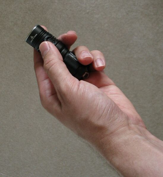

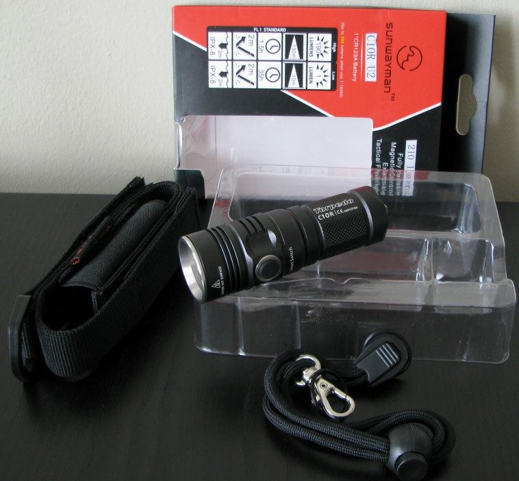

    My review sample was an early release, so it doesn't have the full packaging (the box above is the standard V11R packaging, with a "C10R U2" and "210 lumens" stickers added, so ignore the rest of the labels). I expect standard Sunwayman packaging will include a belt holster, lanyard strap, extra o-rings, manual, warranty card and product insert.
    By the way, I understand Sunwayman will be dropping the "Torpedo" label on future batches of these lights. So I guess that makes these early production run samples limited editions …

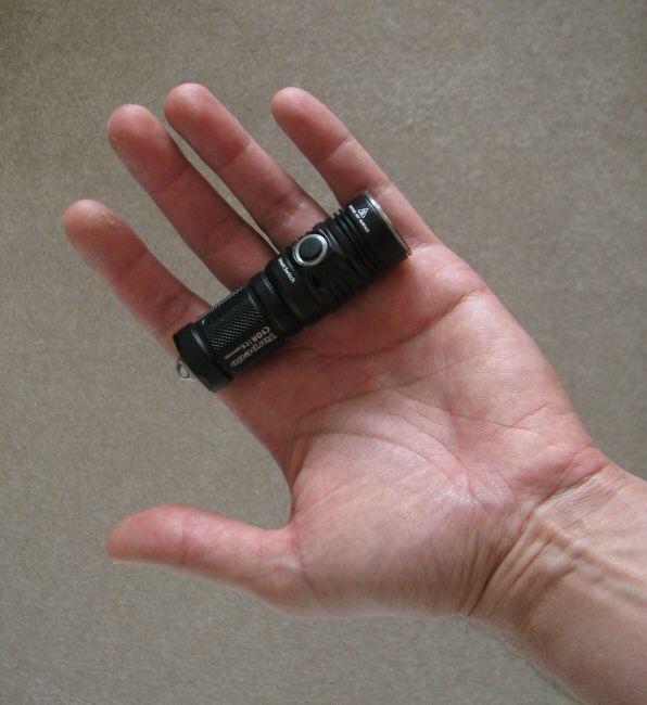

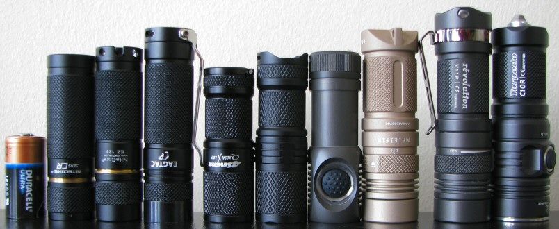

    From left to right: Duracell CR123A; Nitecore SENS CR, EZ 123; Eagletac D25C Clicky; Foursevens Mini 123; Lumintop ED10; Zebralight SC30; , V11R, C10R.
    Sunwayman C10R: Weight: 57.3g, Length: 76.2mm (no lanyard plug), 82.3mm (with plug), Width (bezel): 25.6mm, Width (head at widest part): 28.6mm
    Sunwayman M11R: Weight 45.8g, Length: 76.4mm, Width (bezel): 23.1mm
    Sunwayman V11R: Weight 50.5g, Length: 84.3mm, Width (bezel): 23.1mm
    Eagletac D25C Clicky: Weight: 30g, Length: 76.0mm, Width (bezel): 20.0mm
    Rofis JR10: Weight 75.0g, Length (max): 110.6mm (angled): 92.9mm, Width (bezel): 24.8mm
    Jetbeam PC10: Weight: 50.5g, Length: 93.6mm, Width (bezel): 22.6mm
    Thrunite Neutron 1C: Weight: 45.2g, Length: 91.5mm, Width (bezel) 22.0mm

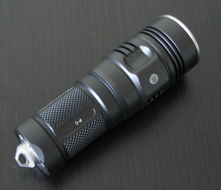

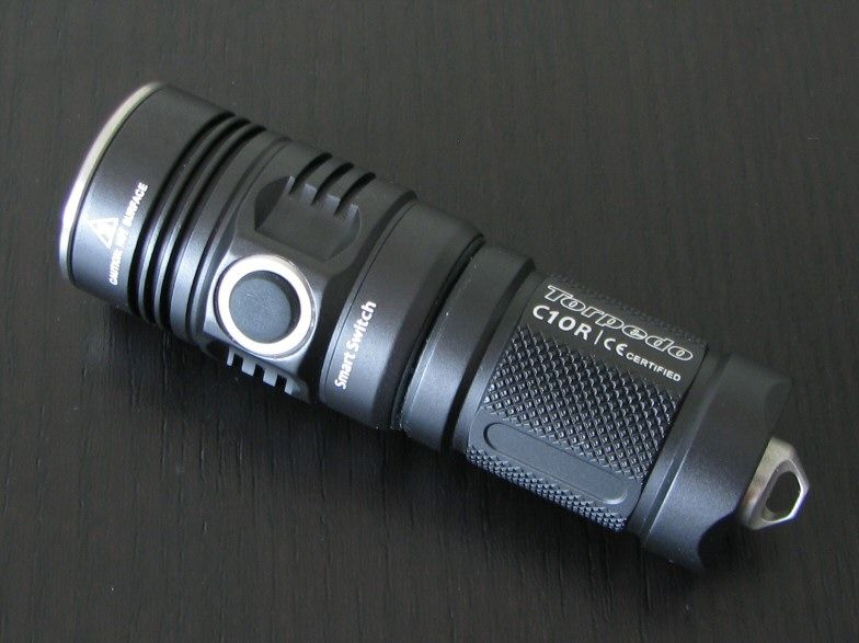

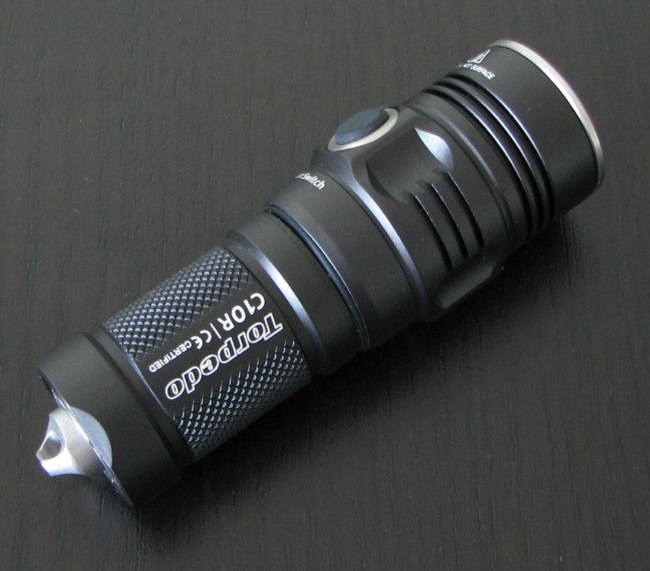

    As with other Sunwayman lights, you still get the same rich, dark gray natural finish anodizing on the C10R. Sunwayman has always had one of the best quality finishes. As always, all labels are fairly small and bright white against the dark background. Overall build impression is similar to the T60CS I reviewed recently.
    Like the M11R/V11R, Sunwayman has knurling or reasonable aggressiveness on the C10R. With other build elements (ridges, raised areas, etc), I would say overall grip is good.

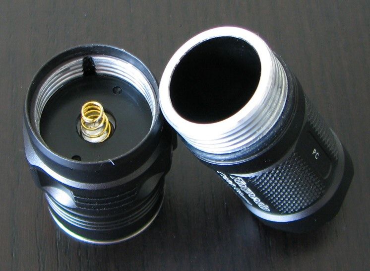

    The body tube is wide enough to take all primary CR123A and 16340 (RCR) Li-ion rechargeables, but 18350 is too wide to fit.

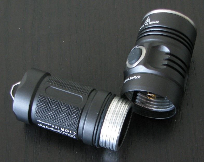

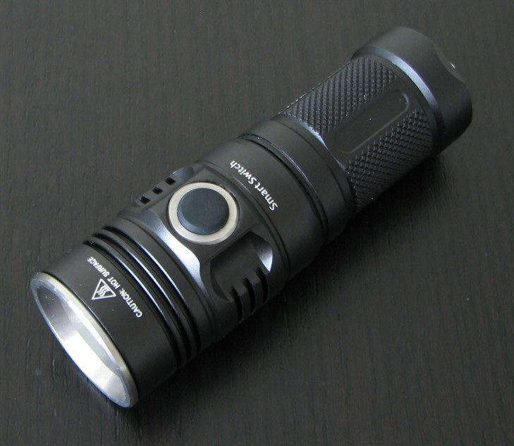

    Rather than a control ring or tailcap clicky switch, the C10R is controlled by Sunwayman's new "Smart Switch" - an electronic switch in the head (under a rubber button cover). Switch feel is good for this type of switch, with a definite "click" upon activation. Scroll down for a discussion of the UI.
    There is a red LED on the other side of the head from the switch, which serves as a low voltage indicator for the battery. Note this only works with RCR (16340). See the UI section for a discussion.
    Body diameter is different from M- and V-series lights (i.e., head/body parts are no longer interchangeable). There are more screw threads on the C10R than those other 1xCR123A/RCR lights, but they are no longer anodized for head lockout. They remain square-cut though.

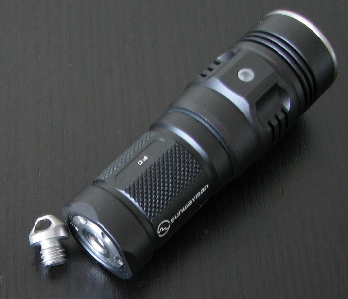

    The tail region is interesting – there is a removable lanyard attachment ring. With the ring in place, the light cannot tailstand. With it removed, not only do you restore tailstanding, but the plug diameter perfectly fits a standard tripod mount (1/4-20 UNC). This means you could mount the light stably on a tripod base.
    With the head fully-connected against the body, turn the light off/on by the electronic clicky switch. The C10R has two options – click (i.e., quick press and release) for constant on, or press-and-hold for momentary.
    As with some of the Spark and Zebralight models that use a similar interface, it may take you a little time to get the timing just right (i.e., too slow on the release, and the light will shut-off, thinking you wanted momentary). But this does give you option to signal with light if you want.
    First time you activate the light, it comes on in Hi mode. Change output modes by pressing and holding the switch from clicked on. The light will cycle between constant output modes in the following order: Hi > Med > Lo, in repeating order. Let go off the switch to select the mode you want.
    Light has mode memory, and will retain the last constant output used when turning off and on.
    There are a "hidden" strobe and SOS mode, activated and double-clicking the switch rapidly. On first double-click you get strobe, on second double-click you get SOS. Single click to turn off. Light returns to the memorized constant output when clicked back on.
    As this is an electronic switch, a standby current is required (see below for measurements). To reduce the risk of accidental activation, Sunwayman provides a switch lock-out mode. After waiting a minimum of 7 secs with the light off, do a quick click followed immediately by a press-hold. After 1 sec, the light will shut off and cannot be re-activated until the lockout is deactivated. To restore full functioning, double-click the switch followed by a press-hold.

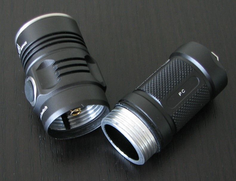

    Unfortunately, you cannot physically lock out the light by a head twist, as the threads are not anodized.
    There is a secondary red LED on the other side of the head from the switch, which will warn you when a RCR battery is running low. Note that RCR cell has to be charged >3.3V when first installed, or the circuit will assume it is a CR123A and not respond (i.e., there is no warning for CR123A cells). There is a brief double-flash when installing a fresh RCR cell, indicating it will monitor the battery charge.
    In my testing, the indicator activated and glowed a constant red once a cell reached ~3.0-3.1V resting voltage. By this point, output had already dropped to ~10% initial output (see my runtimes below). On a protected RCR, it was a matter of a few seconds before the protection circuit engaged and the light shut-off. So the indicator is not so much an advanced output warning - you will already be well aware that the battery is nearly exhausted by the time the indicator comes on. It is really more of an indicator to let you know the protection circuit is about to trip, or that you should shut-down down to preserve an unprotected cell.

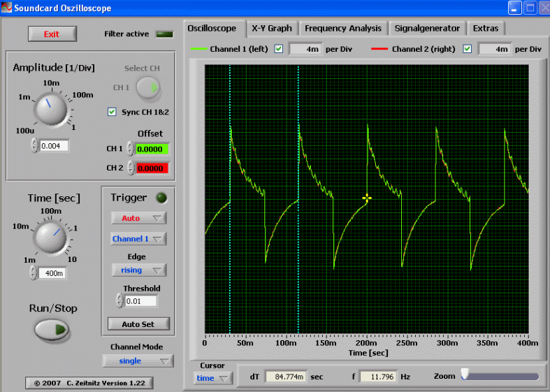

    PWM
    There is no sign of PWM that I can see, at any output level – I presume the light is current-controlled, as claimed.
    I did detect some high-frequency noise on Hi and Med (around the 14.3 kHz range), but was unable to detect it on Lo (although it may still be there at an undetectable level in my setup). In any case, this is not detectable by eye, and it not a concern.
    Strobe is a standard "tactical" high frequency strobe, measured at 12 Hz.

    Unfortunately though, you cannot physically lock-out the light – due to the lack of anodized threads. However, as explained above, Sunwayman also provides a switch lock-out mode that is activated by a quick click followed by a sustained press (see UI section). This would at least help prevent accidental activation.

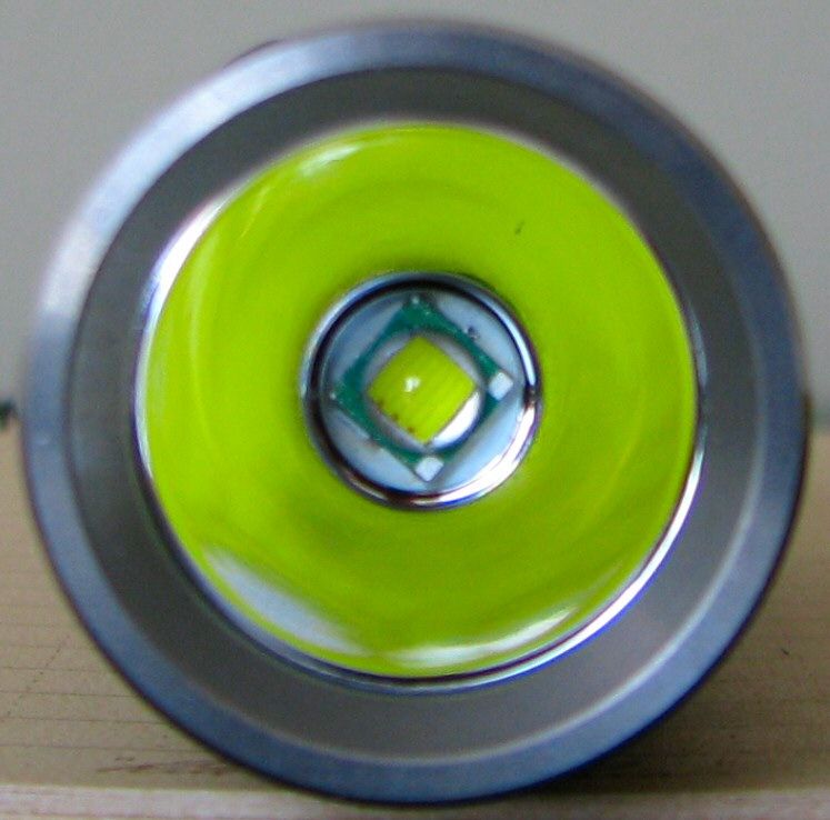

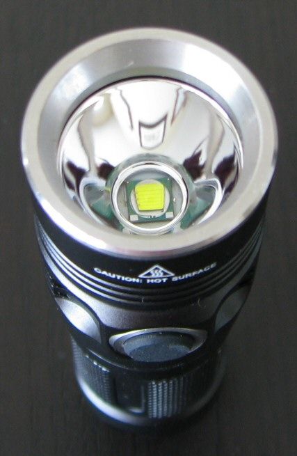

    The C10R has a slightly larger head than typical for this class, with a smooth reflector. The reflector isn't very deep, so I would expect a wide spill beam (i.e., likely something similar to a number of Zebralights). Emitter was well centered on my sample.

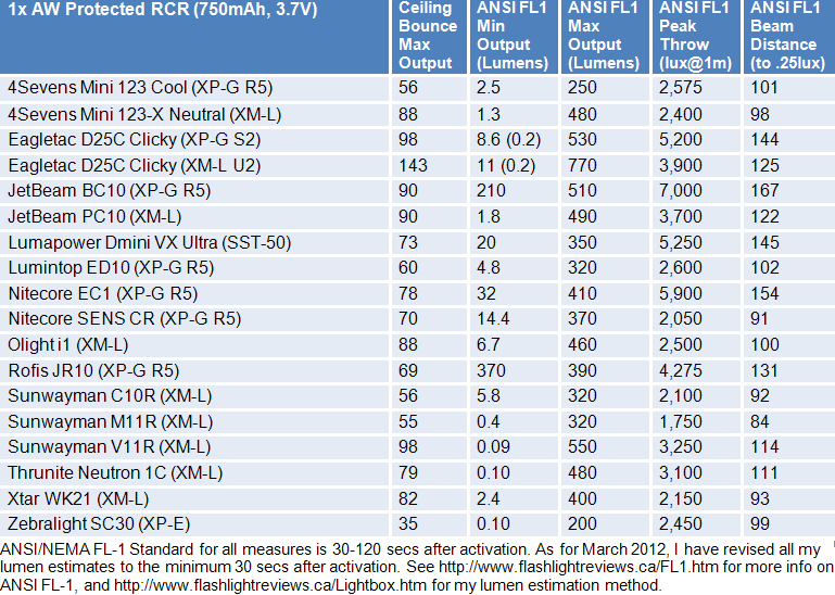

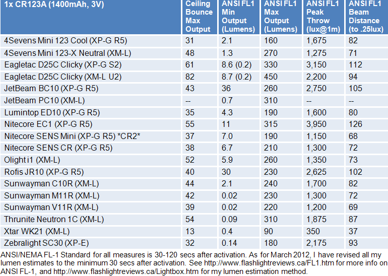

    And now, the white-wall beamshots. All lights are on Max output on the identified battery type. Lights are about ~0.75 meter from a white wall (with the camera ~1.25 meters back from the wall). Automatic white balance on the camera, to minimize tint differences.
    1xRCR (AW Protected 750mAh) Li-ion Comparison:
    1xCR123A Comparison:

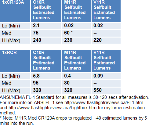

    The C10R is a slightly "throwier" than the Sunwayman M11R or V11R for the same output, with a more defined hotspot. But the C10R also has a wider spillbeam, and a clearer separation between hotspot and spill (i.e., less of a corona). It also has fewer beam rings than my M11R and V11R samples.
    Note that actual overall output is pretty much the same on all three lights on 1xCR123A, and comparable between the M11R and C10R on 1xRCR. Scroll down for full output tables.
    My summary tables are reported in a manner consistent with the ANSI FL-1 standard for flashlight testing. Please see http://www.flashlightreviews.ca/FL1.htm for a discussion, and a description of all the terms used in these tables.
    Sunwayman reports 190 lumens Hi output spec on 1x CR123A in the manual (although the temporary packaging box also has a 210 lumen sticker on it). Regardless, output seems pretty close to this in my testing – quite similar to the M11R, in fact. The 50 lumen Med and 13 lumen Lo modes seem a little off though – see my detailed estimated lumen table below.
    The report 130m beam distance seems rather optimistic (even though I know my standard light meter tends to under-report somewhat).
    On 1xRCR, the max output on the C10R increases to a comparable level of M11R. Again see my tables below for a comparison of output levels across all Sunwayman models, on both CR123A and RCR.

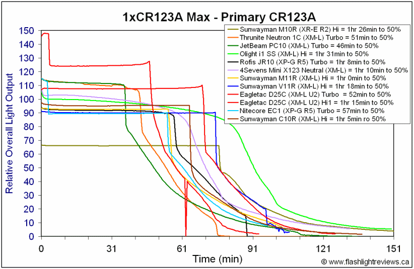

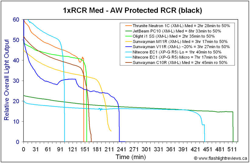

    Output/Runtime Comparison:
    The Hi output level and runtime pattern is virtually identical between the C10R and M11R, on both CR123A and RCR. My C10R has slightly longer runtimes, but that is likely just natural variation between emitters/circuts (e.g. emitter Vf can have a big effect on runtime efficiency).
    Efficiency also seems at least as good as the M11R on the Med levels, but output is a little higher on the C10R.
    In fact, the C10R seems to have a more typical set of output levels for a Lo/Med/Hi light than the M11R (which had more a Moonlight low). C10R outputs don't exactly match the specs, though, as shown in the comparison table below.

    Unfortunately, there is no way to physically lock out the light, as screw threads are not anodized. There is however a way to temporarily lock out the switch using a button-press sequence. I recommend you use it, as the protruding switch will likely be prone to accidental activation.

    The lanyard attachment ring in the tail seems to hold fairly well when fully screwed in. But you should watch to make sure it doesn't loosen up if you plan to use it with the lanyard (i.e., once it loosens, it can be unscrewed fairly easily).
    I am not sure what final packaging will include, but there was no clip bundled with my sample - and I don't see any obvious attachment points for one.

    Can I confirm that the reflector is SMO?
    The specs seem to say that it is an OP reflector?
    So with a shallower, but bigger diameter SMO reflector, the C10R's wall shots see: the bigger reflector leading to a smaller but more intense hotspot over the M11R, but the shallower reflector leading to a wider spill, and that wider spill is dimmer.
    However the C10R doesn't seem to have any dirty rings, which are more prominent on both the M11R and V11R.
    Could the SMO reflector design also be causing a brighter hotspot, yet a rather dim spill?

    Quote Originally Posted by peterharvey73 View Post
    Yes, that is an inconsistency. But as you can see in the pics, it is definitely smooth on my sample. It may be the specs aren't final yet - I will check with SWM to see what they say.
    However the C10R doesn't seem to have any dirty rings, which are more prominent on both the M11R and V11R. Could the SMO reflector design also be causing a brighter hotspot, yet a rather dim spill?
    I doubt it has to do with the SMO - it's really a question of the reflector shape. The smaller heads of the M11R/V11R are a hold over from the earlier M10R/V10A, which were originally XP-G-based (actually, the original M10R was XR-E ). The original reflector design was better suited to small die emitters, and just adapted for XM-L.
    The C10R looks to have a new design optimized for the XM-L emitter.

    The lanyard attachment ring in the tail seems to hold fairly well when fully screwed in. But you should watch to make sure it doesn't loosen up if you plan to use it with the lanyard (i.e., once it loosens, it can be unscrewed fairly easily)..
    Would an o-ring tucked underneath the lanyard screw help it from loosening on its own?

    Quote Originally Posted by orbital View Post
    ...btw..How's the heat in Canada??
    Maybe, but it doesn't really seem to be necessary - with the screw fully tightened, it is pretty stable. It is just once you start to loosen it that it spins very freely.

    Eagletac's D25 Clicky series has set a pretty high bar concerning efficiency, cost and size.
    I wonder how Sunwayman thinks this is a competitive product.
    To be fair, the Sunwayman light fully supports all defined output levels on both RCR and CR123A (the D25C looses all medium modes) - there is an efficiency cost to that broader voltage support. The C10R also uses a head-mounted electronic switch - again incurring an efficiency hit over a traditional clicky. Finally, there is a low-voltage sensor, which again should have at least some minor drain. Taking all those aspects into account, the output/runtime efficiency seems quite reasonable (and consistent with current-control).
    As always, it comes down to what feature set matters to the end user. But to facilitate that comparison, I've added the D25C XM-L form size measures and beamshots to the main review.

    Quote Originally Posted by Colonel Sanders View Post
    No 18350s = deal breaker for me nowadays.
    Colonel Sanders,
    the battery compartment of the C10R has really thick walls. I assume it will be no problem to bore them out to make 18350 fit. The head does already fit 18350.
    Inside anodisation of course will be destroyed. But here I don't see any issues.
    Maybe SWM takes this as a chance to improve the next series.
    Andreas

    Selfbuilt, I really appreciate your commenting on whether this light takes 18350s. It's something I find myself wondering every time a new 16340 EDC comes out. VERY nice review as always!
    And I hope I don't come across to harsh about lights not taking 18350s...it certainly is a rare thing that they do. There was much to like from the looks of this light so I was really hoping that this light might take them. It certainly looked fat enough that it might.
    I won't be going through the trouble of boring this light. If someone else does and offers it for sale then perhaps I'll bite. And if this light offered some serious performance (I've really grown accustomed to some XM-L lights blasting out 500-750L even in EDC size) then it would be worth the hassle to bore it.
    This is a nice looking light with some neat features. Make it 18350able, GIVE IT A REALLY LOW MOONLIGHT SETTING (come on folks...gotta have the moonlight mode right these days!), and perhaps a "turbo" mode would make it all the more better.
    SPY 007 XM-L2, BVH 150w Vec192 HID, Gen III Maxabeam, Barn Burner, FireFoxes III & IV, Mac's Customs 3840L & Damascus/Cu/Al Tri-EDCs, ma_sha1 FrankenMag, Drake, MF Scorpion 4x XM-L2, Tri-219 EYE10, XP-G2 X10
    6,936
    Default Re: Sunwayman C10R (XM-L, 1xCR123A/RCR) Review: RUNTIMES, VIDEO, BEAMSHOTS and more!
    Quote Originally Posted by AILL View Post
    Hmmm, not too sure how easy that would be. I measured the internal diameter of the C10R as 16.7mm (21.3mm external at the widest outer screw threads, ~20.9mm external at the inner thread groove). Given that my AW 18350s are at least 18.4mm at their widest point, you would need to shave off nearly 2 full mm (to give yourself a bit of margin).
    Even if you only bored to 18.5mm, that would reduce wall thickness to 1.4mm at the thickest part of the thread, and <1.2mm at at the inner part of the thread. In theory, that should still be strong enough, but might be tricky to actually do the boring.
    No argument on the moonlight mode, it's definitely something I like to see on all my EDC/pocket-sized lights.

    Hi, i just buy C10R but the engraving said 'ESPRESSO' instead 'TORPEDO'...
    what is the difference ?
    Flashaholic* Eric242's Avatar
    Jul 2006
    [-Mad in Germany-]
    2,880
    The engraving
    Eric
    No need to hope, it´s fact. If you search the marketplace you´ll find a thread that reveals the problem with the name Torpedo, that was already taken for another flashlight.
    Eric

    Selfbuilt which you think has better beam , sunwayman c10r or sunwayman m11r ? From your pictures is looks like the c10r does not have a good flood compared to m11r . Also I don't know if your chart is wrong with cr123 med but according to sunwayman both light should have 10h on med but c10r only has 5h .
    6,936
    Quote Originally Posted by GehenSienachlinks View Post
    Well, the C10|R has a wider spill and a more sharply defined hotspot than the M11R (for equivalent overall output). The M11R has a brighter corona, so this provides a more even beam at close range (i.e., it is slightly less focused than the C10R).
    As for the chart, those are the actual runtimes observed on the same batch of batteries. The C10R is brighter than the M11R, hence the shorter runtime on my sample.

    May I ask you if you've some output AND/OR runtime figures with AW's IMR?
    Thanks again
    6,936
    Quote Originally Posted by daberti View Post
    Astounding review Selfbuilt, as always
    No, I typically only do IMR tests on very heavily-driven lights (where the discharge rate would seem to exceed the 2C specs for standard ICR chemistry). There's no real need to use IMR in the C10R, since it is not heavily-driven on max.
    But in the few cases where I've done both AW protected ICR and AW IMR, I typically find one of two outcomes:
    • For direct-drive-like discharge patterns, the IMR cell usually starts out a bit brighter than the ICR cell, but decays more rapidly
    • For flat-regulated discharge patterns, the IMR cell usually has the exact same regulated brightness, and is able to maintain the regulated state slightly longer than ICR.
    Not sure which would be most applicable here, as the C10R isn't completely flat-regulated, but I expect the second outcome is most likely (i.e., I wouldn't expect a higher output on IMR).
    Flashaholic daberti's Avatar
    Sep 2004
    Italy
    457
    I've done some comparative test (fully charged AW cells to red led blinking): on max level both chemistries perform the same. On Medium RCR123 had a great advantage 2:40' against 1:58' of the IMR.
    I've nothing to complain about C10R as far as regulation on rechargeables is concerned when at max power.
    Yet IMHO regulation at Medium is ...welll...uhm...
    This flashlight adds something to the 1x123 form factor: real support for RCR/IMR chemistries (yet no auto low voltage cutoff), very good regulation at max on every chemistry, very good beam (no artifacts). Yet no superlow setting. A lost chance
