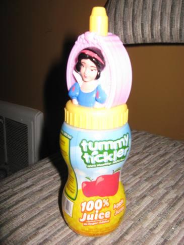

    After searching high and low for a solution I made a diffuser for the LD41 from a $1 bottle of juice sold at most mini-marts/grocery stores. After a tiny bit of shaving around the inside of the bottle's neck it fits the LD41 perfectly!! The narrow part of the bottle grabs a lot of light and sends it outward. Necessity is the mother of invention.
    Genius.
    You're one smart guy man
