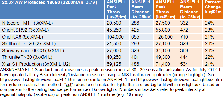

    If you have been following my recent high-output/multi-emitter light reviews recently, you may have noticed some discussion (on my part) of the accuracy of my standard lux light meter for throw measures.
    I have a custom set-up with a permanently-mounted sensor for my lightbox, where I continually monitor the internal calibration for my relative output measures. I derived estimated lumen conversions from that setup using the method discussed here: How to convert Selfbuilt's Lightbox values to Lumens
    But in terms of direct beam intensity measures and beam distance, I have been using one of the inexpensive lux lightmeters available at a number of deal sites (the common Ceto model). The problem with these sorts of meters is you never know how good their internal calibration is. Note that all meters will go off calibration with time, but I can compensate for that with my reference standards. I recently picked up a second inexpensive meter (the V&A VA800), and found it typically gave ~15% higher lux readings than my long-standing Ceto meter.
    As a result, I decide the break open the piggy bank and get a good quality Extech light meter (the EA31 in this case). But I also paid the extra $75 to have its specific calibration tested and certified according to NIST standards.
    Note that there is nothing magical about NIST certification - it just means this specific unit has been tested (and tuned if necessary) so that its calibration matches an agreed-upon reference standard. But I do have a nifty looking calibration certificate (good for one year). Again, all meters will drift out of calibration over time, but at least I have a good starting point with this meter - and I can monitor its performance over time to reference standards I've set up.
    The other thing I've done recently is to invest in a copy of the ANSI FL-1 testing standard. The actual standard is a protected document, and details the laboratory methodology used for testing (available from NEMA for $60). Although I am most definitely not a proper laboratory, I can at least try to follow the methodology as closely as I can in my testing. The details matter here - the closer I can replicate testing conditions, the more consistent my results will be.
    Up until now, I've been working back from intensity measures at 5m (for convenience sake) using my old Ceto meter. From now on, all beam measures will be taken at the full 10m distance and worked back, using the NIST-certified Extech EA31 meter. To designate this change, I will be color-coding my summary tables with orange-highlights for the new measures.
    Below is a comparison of my high output lights, broken down by single or multiple emitters. Let's see how the new meter and methodology compares. Note: blue is the old Ceto meter, orange is the new EA31-NIST meter.
    I'm showing the percent change for each light, as I believe it is instructive. I know from directly comparing various lights using the same technique that my Extech EA31-NIST reports about ~10-12% brighter than my Ceto meter (and ~3-5% dimmer than my V&A VA800 meter).
    However, when using this new 10m measuring distance, I am seeing anywhere from ~10-25% increase in raw lux measures (converted back to 1m). In particular, the multi-emitter lights are all showing a fairly consistent 21-26% increase in beam intensity. I suspect a big part of the reason for this is how long it takes the beams to fully converge in multi-emitter lights - 5m just wasn't enough. This is likely also a contributing factor for some of the higher output single-emitter lights.
    The other factor is the larger hotspot when projected to 10m - this gives me more opportunity to hunt around for the area of peak intensity. Recall that the ANSI FL-1 standard for beam intensity/distance is based on absolute peak values. I suspect some of my earlier 5m measures were lower because the diffuser cup over the light meter sensor was integrating too wide an area.
    You can really see this effect on aspherics - my peak intensity measures from regional hotspots are much higher now (one example is shown above). That said, I believe you really need to go out to 30m to get a true measure of aspherics - these 10m readings are just too heavily influenced by those hotspots. But it illustrates the principle of why some lights are increasing in intensity readings at 10m compared to 5m.
    I will begin updating all my tables in upcoming reviews with the new measures, and wanted to provide a reference here for those who were curious about the change.
    Keep in mind one thing hasn't changed – I typically only have one sample of each light I test. ANSI FL-1 requires a minimum of 3 lights be tested for beam intensity/distance (under fully controlled conditions). As always, you should NOT take my results as representative of a given model. It is simply the most accurate picture that I can provide of the one given sample in my possession.

    Sorry to bring back this thread but I was just wondering about what the raw lux reading is in your lightbox tend to be?
    To be honest, if I were starting out today, I wouldn't recommend the milk carton lightbox approach (which was common when I started). Although I was able to calibrate my lightbox to estimate lumens (based on my fairly extensive dataset and comparators), it is not starting out with the best tool. While a sphere would be better, I am personally intrigued by the twisted PVC "tube" designs people are experimenting with today. Whatever method used though, you will need to develop your own calibration standard (i.e., none of the home-made contraptions are going be properly linearly integrating over all ranges).
    In terms of the raw lux measures, 40K range should be fine. Due to the fact that the sensor is only receiving indirect reflected light (i.e., in any design, the emitter should not be "visible" to the sensor), even heavy output lights are well below that (with most designs).
    Default Re: Revised Selfbuilt beam intensity measures: new NIST-calibrated Extech EA31 lux-m
    The main reason why I was going to go a milk carton was to try and get as close to your set up and calibrate off your numbers as I have a subset of the lights you have tested. In the past I've tried other homemade designs, including sphere type ones, tents, cardboard boxes, eskys, but my graph points stretch and curve away from yours way too much. I know it wasn't going to be linear but at the high output end, they curve!
    Cheers for the confirmation of the raw lux numbers. It saves me from having to build an ADC as the sensor above has one built in.
    6,936
    Ah, well, then you should definitely see my comments on the lightbox design that I use (on my Methods page). One thing I may not have mentioned - I modified Doug's original design from flashlightreviews.com to have my lights enter from the bottom of the carton, with the sensor located on the side just up from the base. This way, the light's own bezel acts a baffle, and I have various size cut-outs that I use to surround the bezel (and prevent too much light from escaping back out of the box). This arrangement facilitates my ability to automate runtimes easily, since the light lies on the ground.
    I did notice that and I've done the same thing. The only difference is that there is a pouring hole at the other end that I have taped over and painted the inside white to get it as uniform as I can. I didn't realise that you lie the light on the ground though. So the cut outs are not in the centre? Just wondering about that as I was considering various holders and platforms to raise the light to the centre of the light box.
