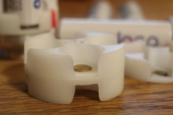

    Default Re: source for high discharge aa nimh?
    I used to have my FiveMega 12AA-3D folder loaded with flat top CBPs and they worked fine, no button top was needed needed. Being a 4 wide holder it looks like the 16AA-4D uses the same design as the 12-3D, the cells sit on little separators which have brass inserts. This is different then the 3 cell wide Fivemega holders I have seen where the cells fit onto holes in the holder and there is cell to cell contact and a button top may be needed.
    Here is the little button top built into my FM 12AA holder.
