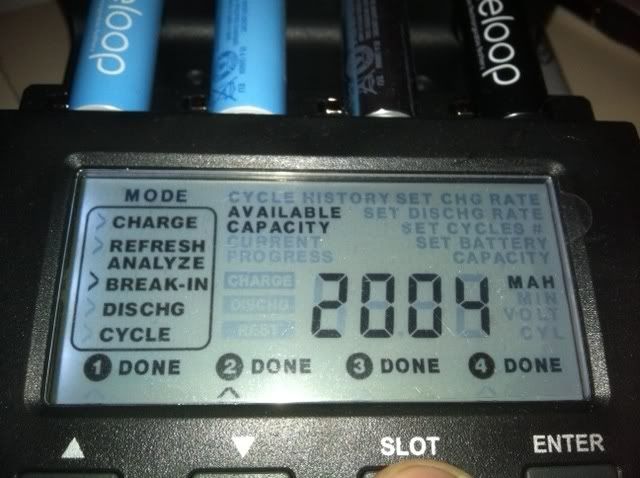

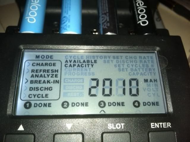

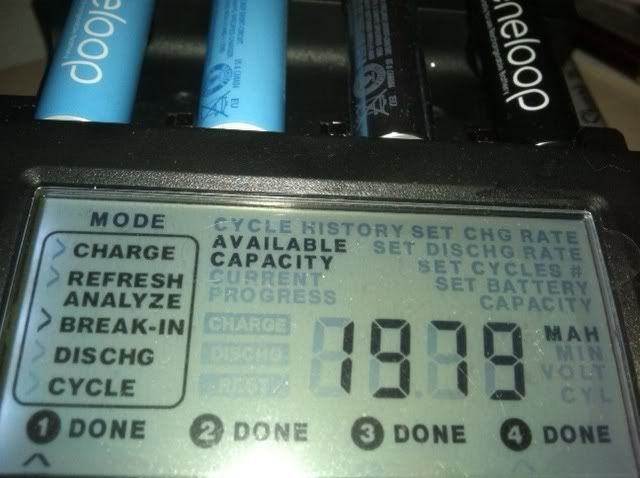

    So I'm running all of my Eneloops through a break-in on my Maha Powerex MH-C9000. So far I've cycled 12 unused cells. 6 of which I purchased on either Ebay or Amazon, I'm not sure which, and they came as a 10 pack with 5 light blue wrappers and 5 dark blues, also 2 plastic storage cases.
    The other 6 came from an 8 pack of Eneloop 5th anniversary Glitter cells. I'm not sure if you've seen them, but they come in 8 different colors and are also numbered on the wrapper 1-8. The colors are a bit much for my taste, but different colors do make them easier to identify.
    I've had some interesting results that I thought I'd share. It seems the Glitter cells have a slightly higher capacity. The difference? Just over 2%. Not exactly Earth shattering news here, still, my strongest NON-Glitter cell isn't as strong as my WEAKEST Glitter cell (so far), so I thought it was worth a mention. In terms of run-time, you'd be looking at about an extra 2 minutes on a light with a 90 minute run-time.
    These may actually be a bad switch for you. If all of your cells are at or below the 2000 mAh mark (and you use a lot of cells), these won't really pair up well with any of your other cells. Also, now that I know these cells are obviously different, I have to wonder about longevity. The package claims 1500 recharge cycles, LSD, etc., just like normal Eneloop AA's.
    I've compiled my results below, as well as 4 pictures. These pictures are of 4 cells on a charger. The first 2 are the blue wrapper Eneloop AA's, the second 2 are Glitter cells. I didn't think to snap shots of all of the cells. I didn't realize these were abnormally high numbers early on in my testing. Has anyone else noticed this difference on the Glitter cells or am I the only one? I've searched the web a bit and realized other people out there are claiming high numbers on Glitter cells. Thanks!

    I'm surprised. I ran a total of 34 cells. 6 glitter cells and 28 regular Eneloops. Only one of the regular cells had the capacity of the lowest glitter cell. I'm completely dumbfounded as to why my results were so abnormally high on these cells, especially now that you've shown a more normal number. Did you do a break in or just a charge/discharge? Could the use of a break in cycle on a new Eneloop explain an extra 100 mAh of capacity? I wouldn't think so, but I'm not experienced enough to know for sure. Thanks!!
