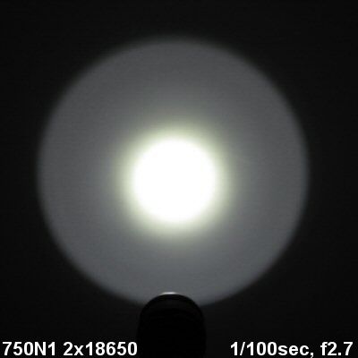

    The 750N1 uses a Cool White XM-L emitter, well centered on my samples (with a white centering disc around it). Reflector is smooth finish and extremely deep – one of the deepest I've seen (likely accounting for the overall length of the 750N1). Throw is likely to be very good.
    And now, what you have all been waiting for. All lights are on 2xAW protected 18650, about ~0.75 meter from a white wall (with the camera ~1.25 meters back from the wall). Automatic white balance on the camera, to minimize tint differences.
    Note: The 2nd generation engineering sample is labeled as "NWK750-II" below.
    The 750N1 seems pretty similar in output and beam pattern to the 2nd generation engineering sample. As you would expect for such a deep reflector, you get excellent throw, with a fairly narrow spillbeam.

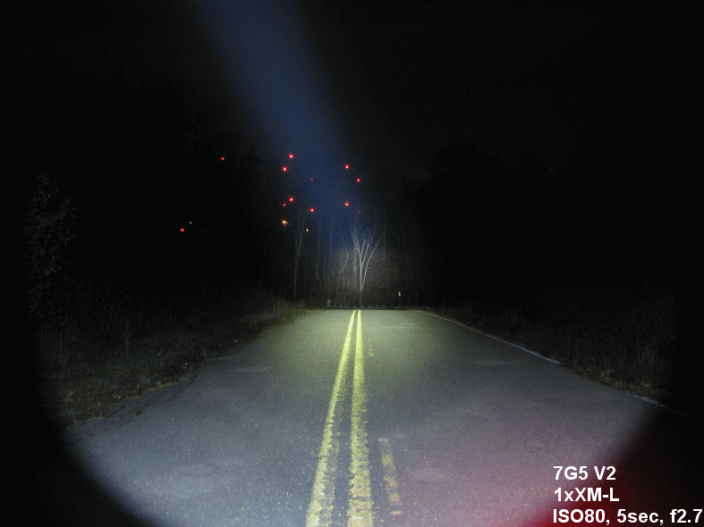

    Of course, these sorts of reviews are never complete without outdoor beamshots. These are all done in the style of my earlier 100-yard round-up review. Please see that thread for a discussion of the topography (i.e. the road dips in the distance, to better show you the corona in the mid-ground).
    To start, here are some shots of the second NWK750 engineering sample that I tested (which looks exactly the same on Hi):
    And now a new comparison, including a zoomed view of the hotspot. Please ignore the red-tint in the lower-right corner of the first panel of shots (I was wearing a brighter-than-usual red headlamp during this excursion ).
    As mentioned above, spillbeam width is narrower than typical, due to the deeper than usual reflector. But you certainly get plenty of throw.

    I finally made it out for some additional outdoor beamshots. Please ignore the red-tint in the lower-right corner of the first panel of shots (I was wearing a brighter-than-usual red headlamp during this excursion ).
